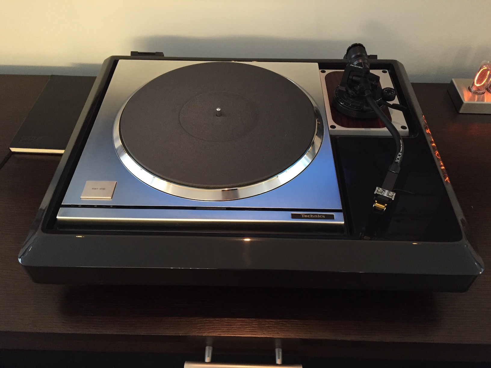

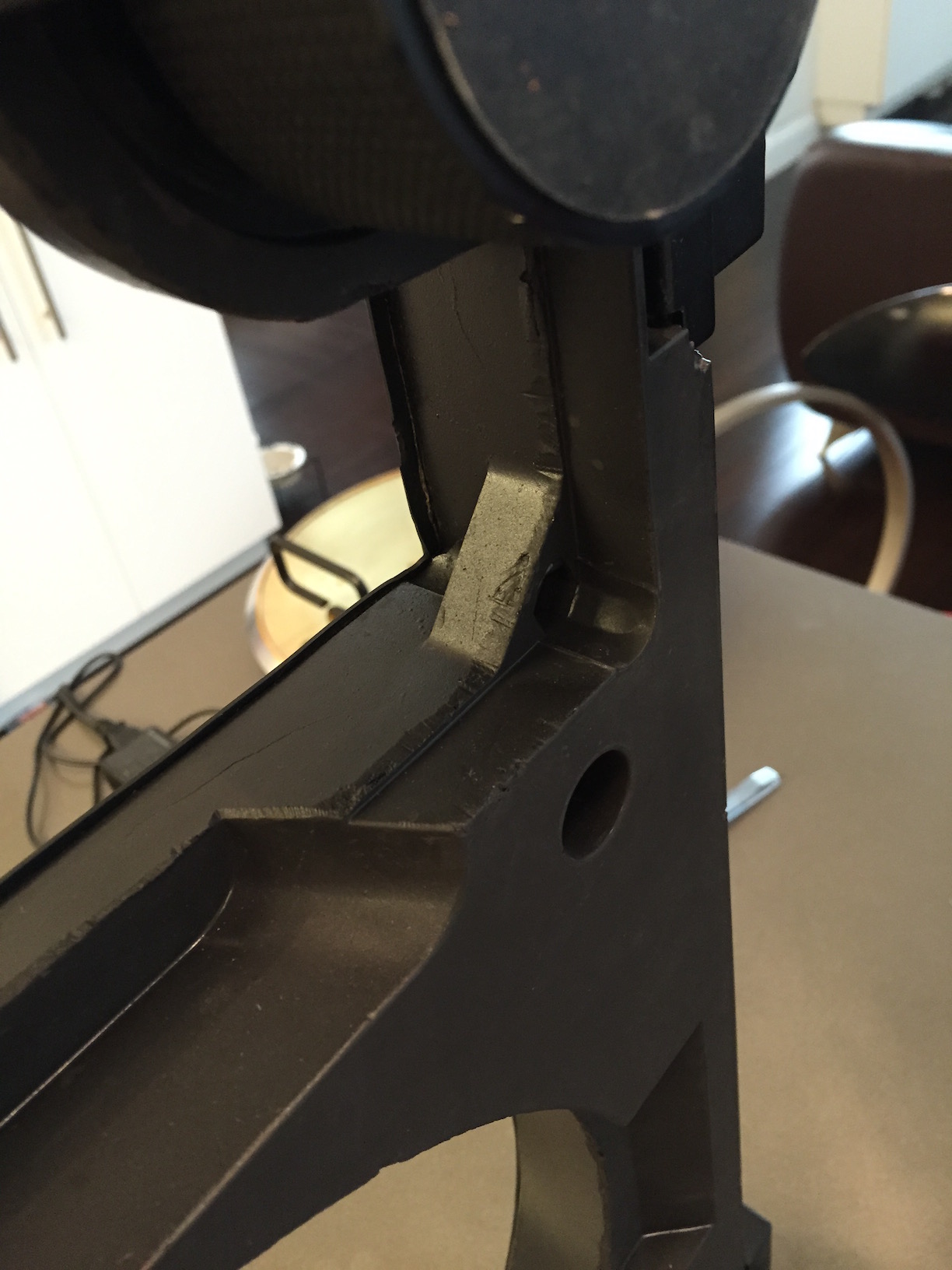

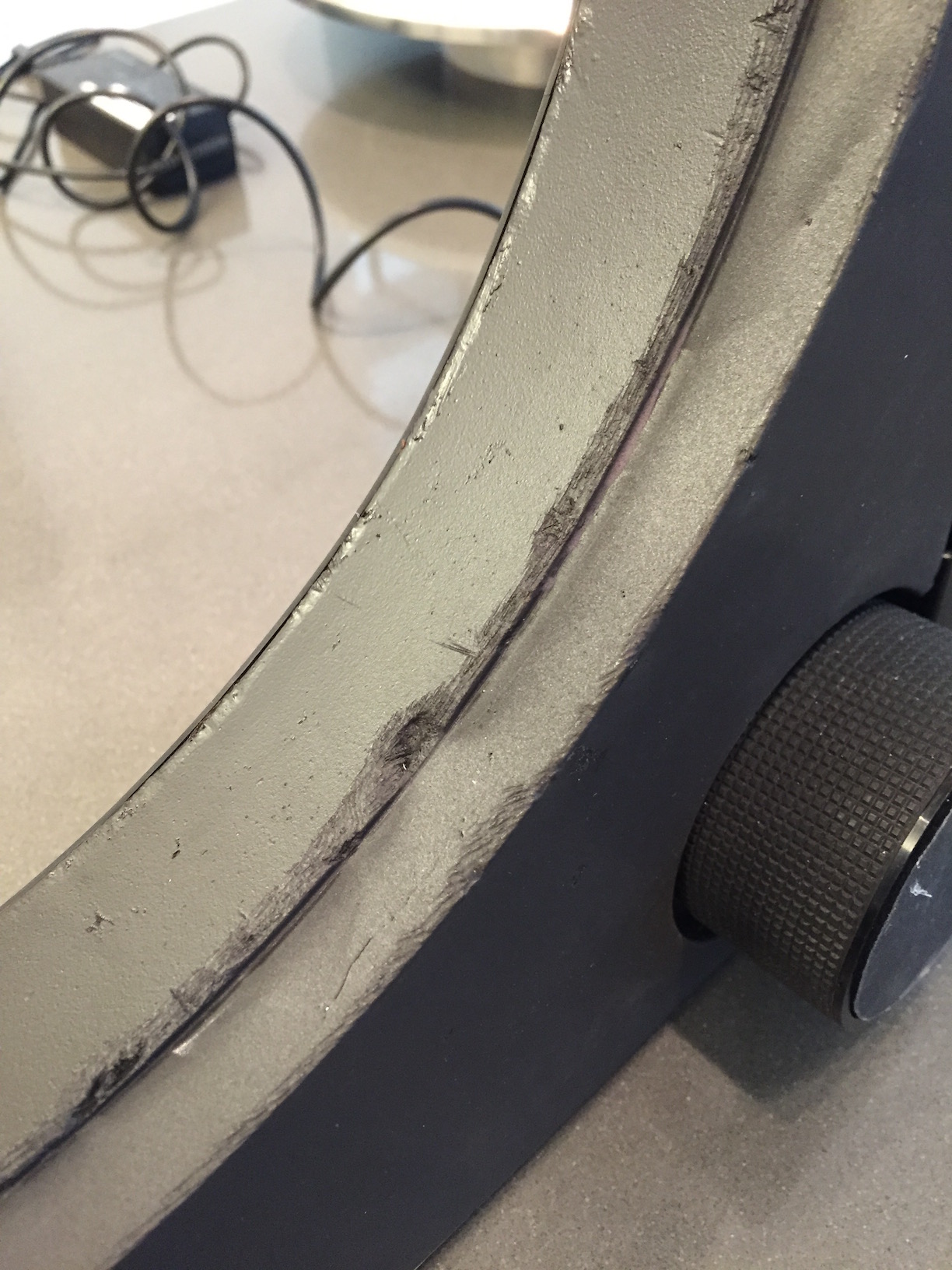

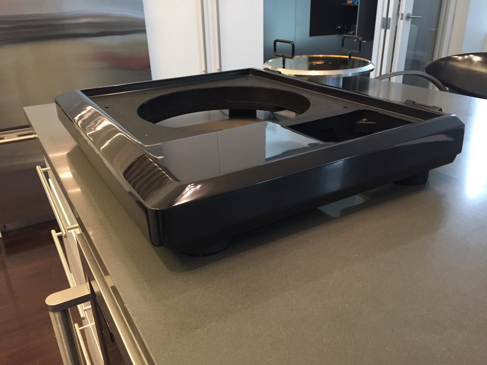

The SH-10B5 isn't made of obsidian composite like the SH-10B3 is - it's TNRC (Technics Non-Resonant Compound). The same stuff the sub-plinth in a 1200MK2 is made of, and many others. The finish isn't as smooth as the B3, but it's a brute at 41 pounds.

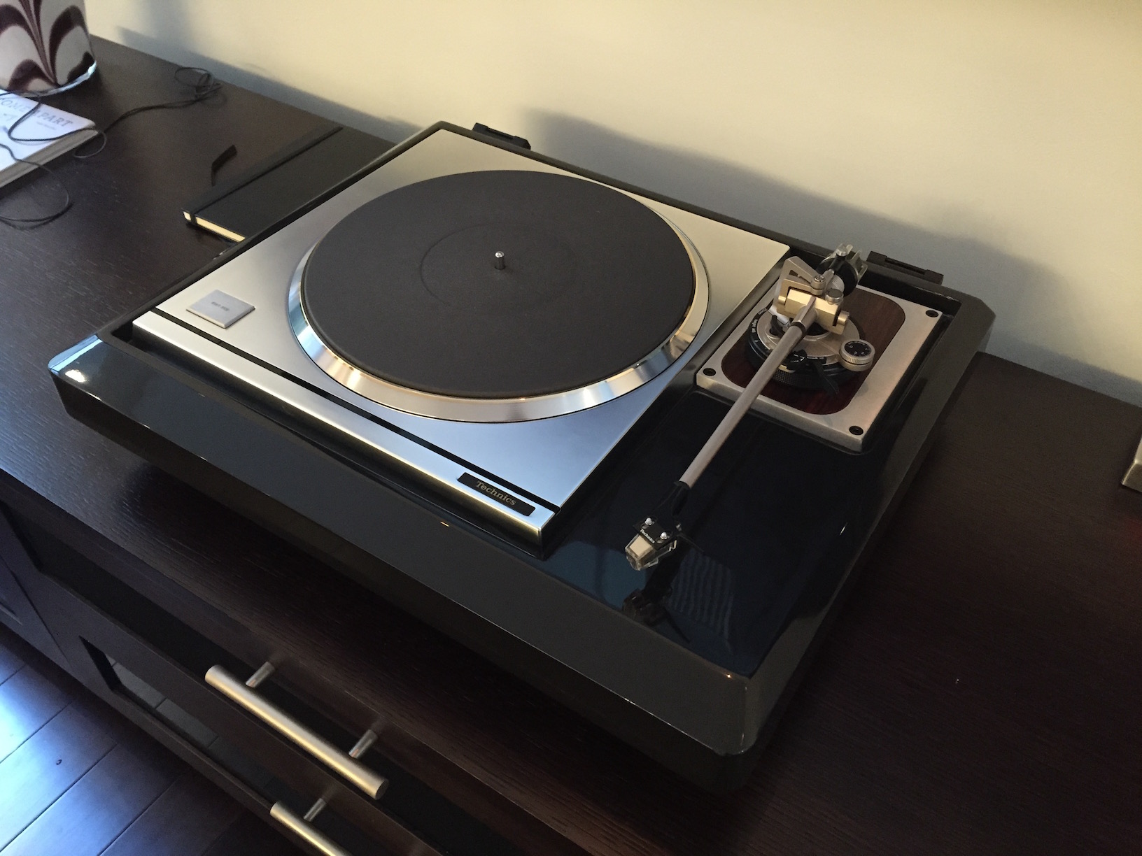

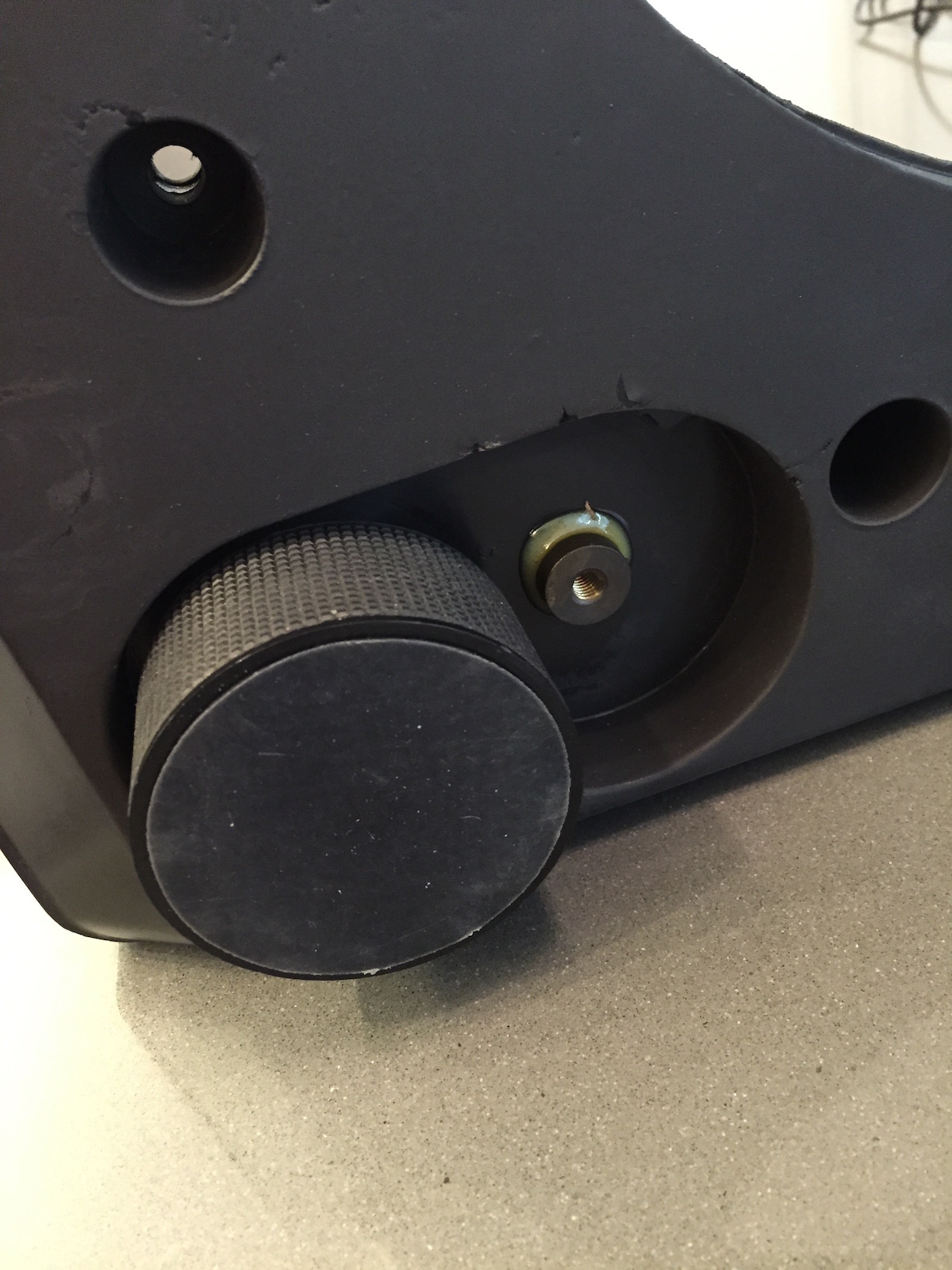

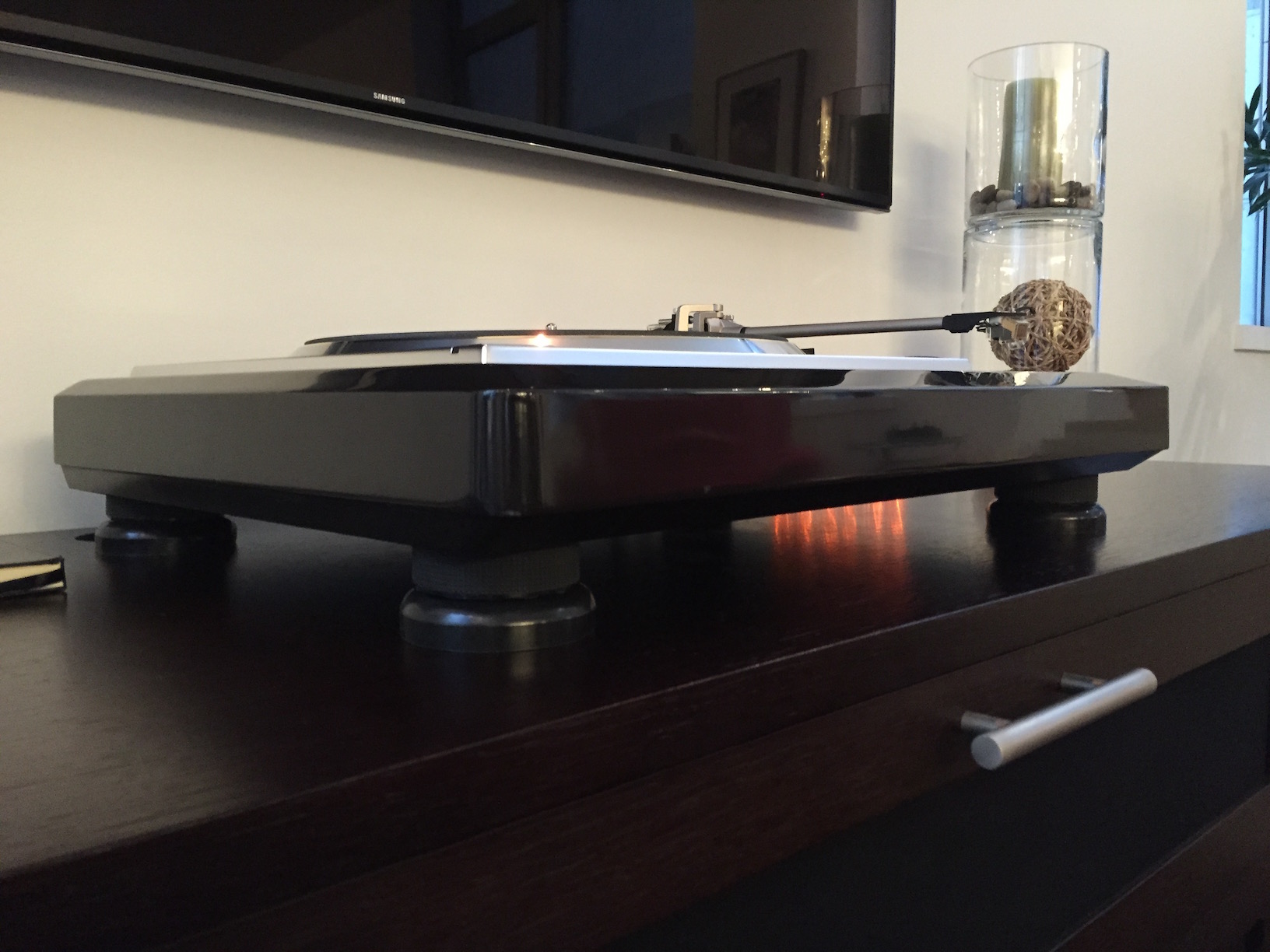

And here it is all together. Now 81 pounds and change. It was a b*tch putting those sorbothane boots under it.

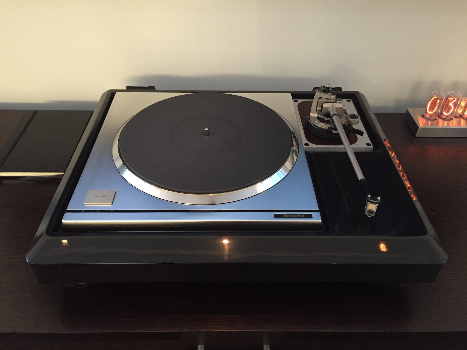

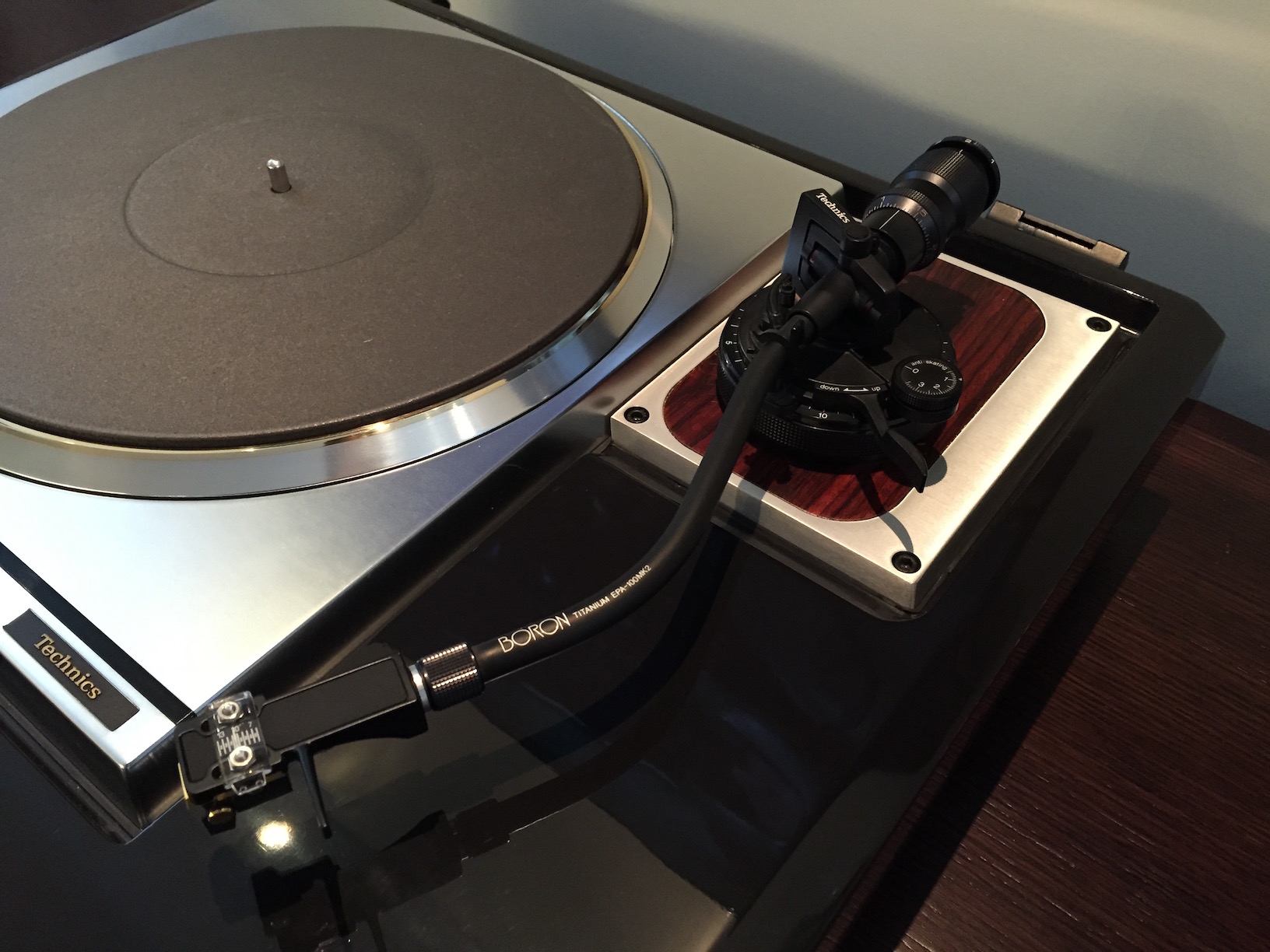

Thanks, all! I agree Calvin, it's a superb looking design.

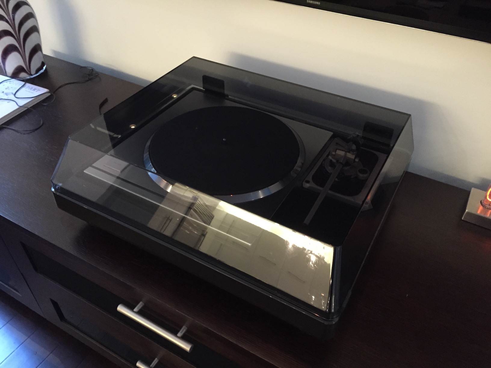

It just had to be done - I put it in full SL-1000 'regalia' today, or as close as I can get it. I'm short a badged headshell and black armboard, but it's close enough for me.
I'm still a bit dumbstruck that this thing is sitting in my living room. Though, I think Jim is the happiest about it - he doesn't have to listen to me trying to talk myself out of finding one anymore! 🙂

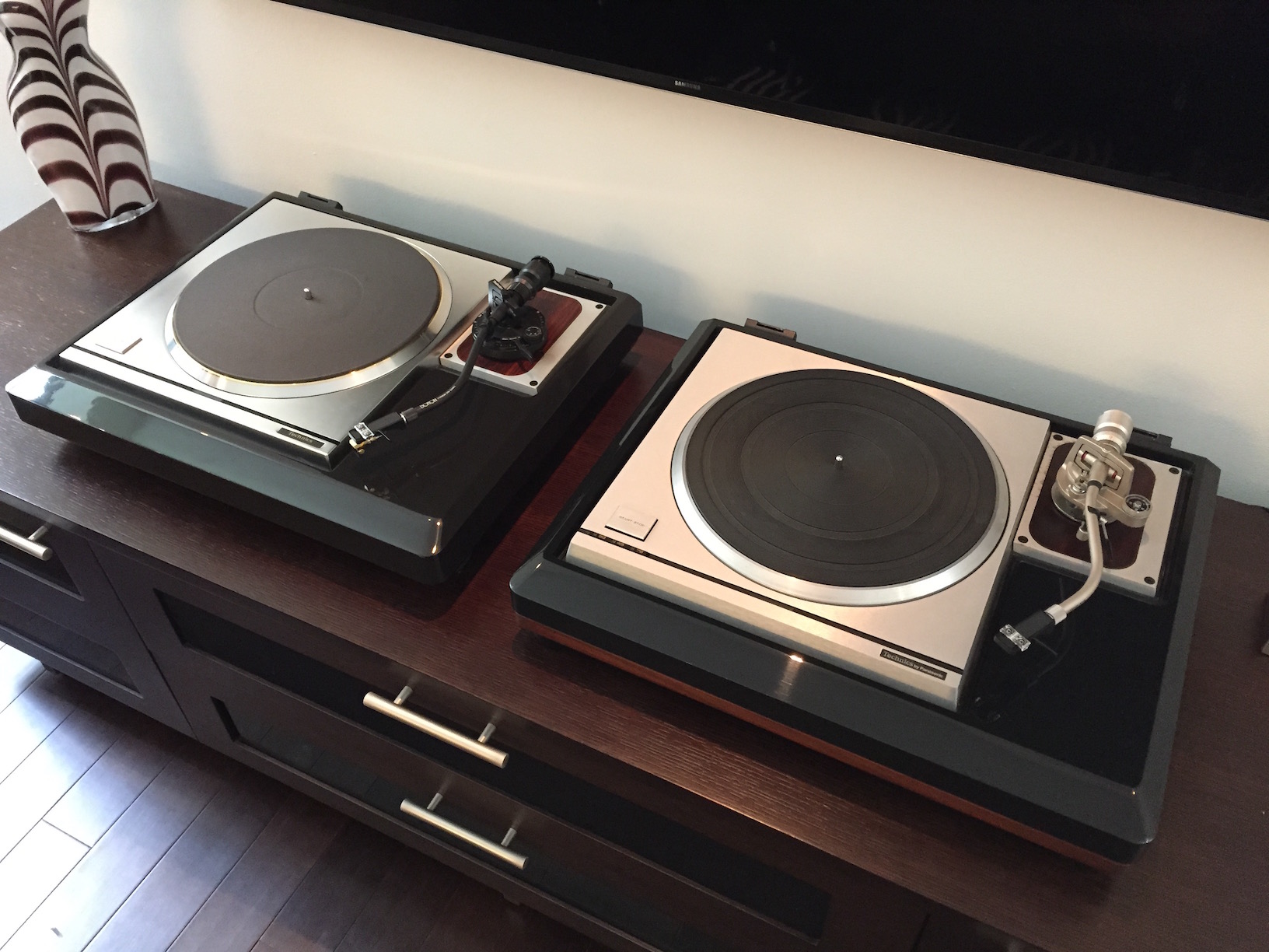

I haven't listened to a MKII yet. By the time I got the plinth, I had the MK3 ready to go so I went straight to this. I'll get around to setting up the MKII sooner or later, but I wouldn't expect much of a real difference.
Spent a little time today setting up the MK2 for some comparisons. It'll be a while before I get a chance to do anything - just doing bits as I've time. That, and I'm running out of storage space!

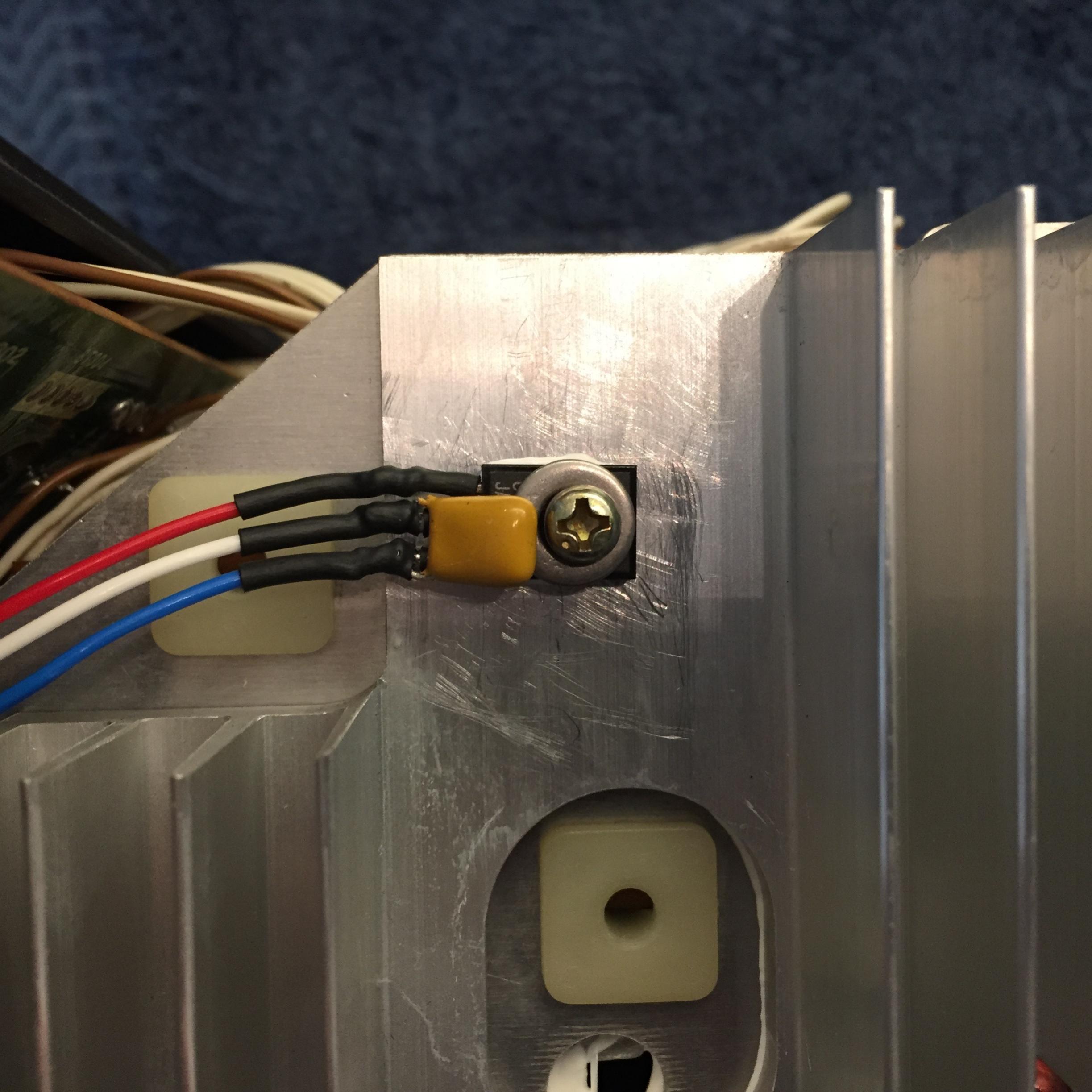

I was going through the posts on sp-10.jp and found some text that said later production units came with Q260 attached to the heatsink, and also mentioned oscillation problems when doing so which I assume is the problem I ran in to.
Well, it's a simple emitter follower voltage step down, so 100n should be fine. If I had designed it would be from base to emitter, but either way is OK.
Bourns never came through with the sample VR, but it's been running so well I'm not really motivated to replace it and have to readjust everything anyway. I went ahead and put Q260 back on flying leads today, this time with 100n across the collector and base to stabilize it. I'm pleased to report everything is running great!

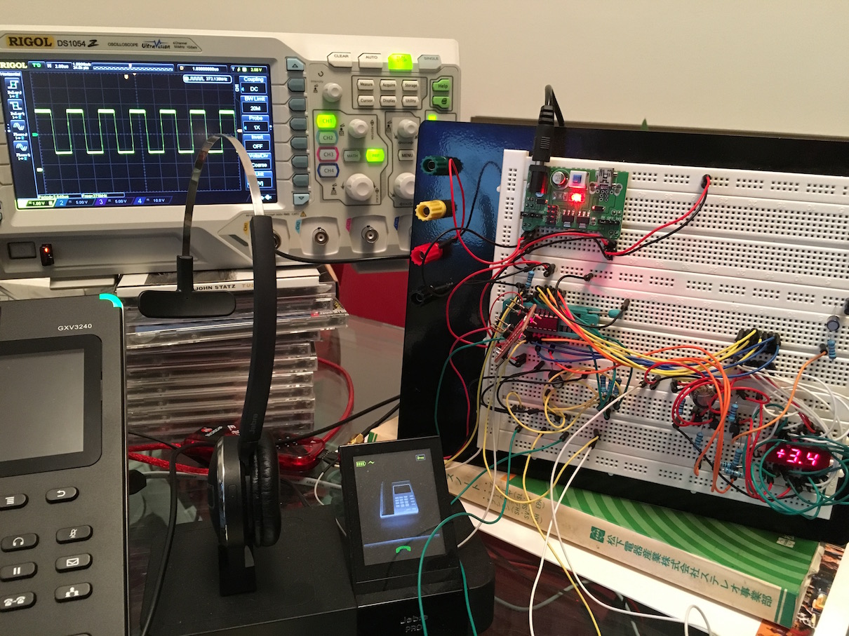

I noticed the output of the 'reference frequency' from the MN6042 is moving around ~15Hz for most pitch settings, including 0.0, and nearly 30Hz for some of the settings. That's a lot of movement in the clock.
The output of the DN860 is rock-steady in the eyes of the hardware counter in my scope (1Hz precision) so it would seem the issue is the MN6042. These are very early CMOS and prone to failure, and as it would appear they can also suffer from degradation.
While I have a couple spares, I'd bet there's more than a fair chance they've some degradation as well, and I really don't want to swap a bunch of 28 pin dips through my control unit. I've decided the only logical thing to do here is to make a replacement.
attachment.php
Excuse the mess - I don't have a bench since we moved to NYC, and it was easier to do this at my desk due to the programming work.
I had the board from a junk SL-1500 MK2 I picked up to strip the ICs, so I pulled the components to setup the supporting environment on the bread board. Nothing too difficult here - a PIC16 to drive the display and buttons, and a DDS to generate the clock.
I've decided to abandon the clock generated by the DN860, as using it would add components and complexity with no benefit. I don't think we'll do any worse using a DDS to generate a new clock, and it simplifies everything quite a bit. The MK3 would still use the DN860 clock to drive the strobe, though this should be fine as you'd need rather significant drift between the two clocks to be able to visually see an issue. This, of course, won't affect the bits that actually matter.
The code is done and everything is running I'd expect on the bread board. Next is to clean up the circuit a bit, and do the board design.

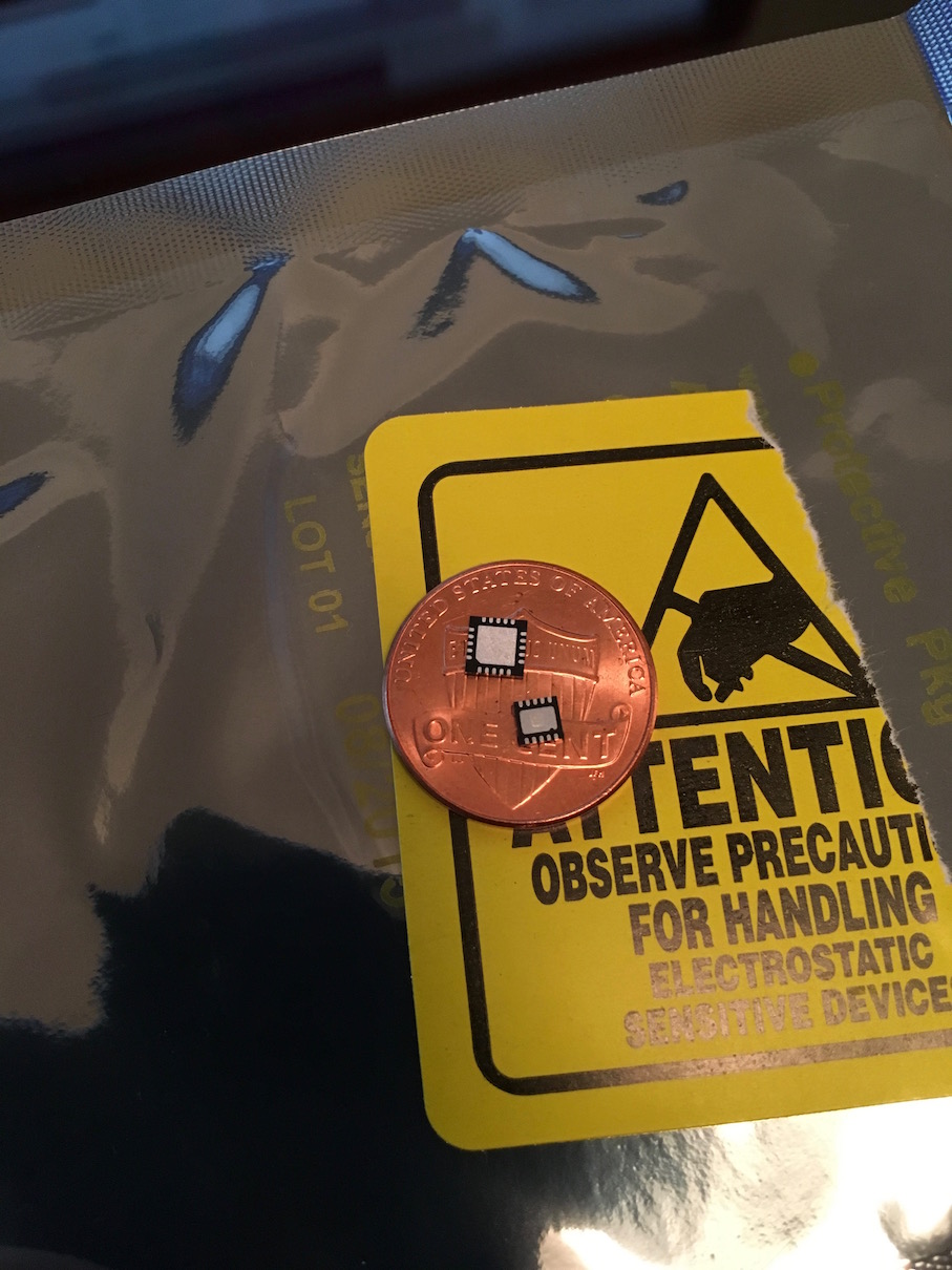

Soldering may prove to be the most difficult part of this project. This will certainly put my SMD skills to the test.
