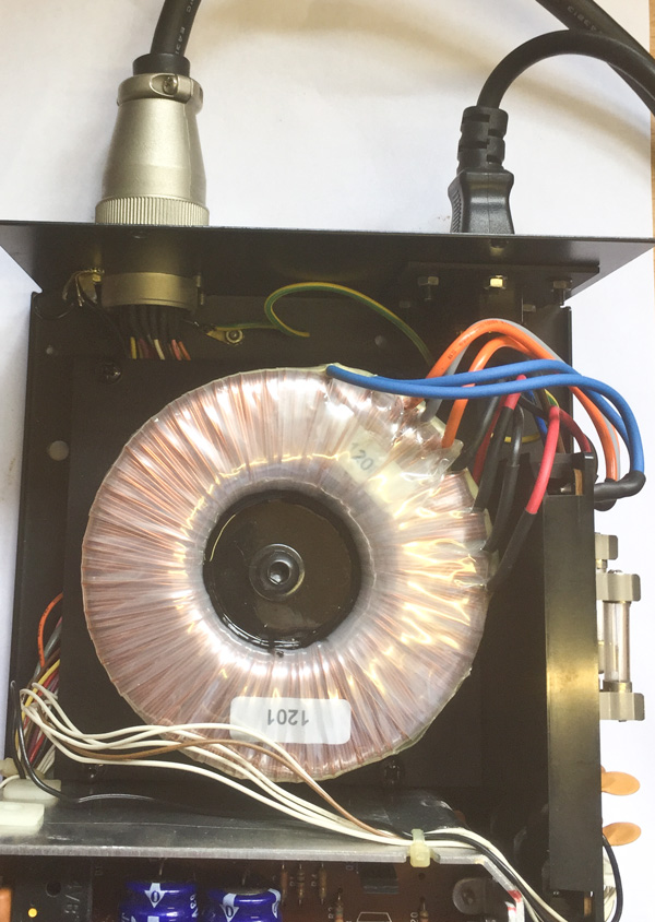

Transformer swap for 120V

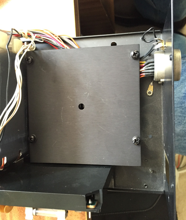

A few people have asked me about the 120/240 volt conversion so here are three of photos of it. All the wires are the same colours and it stands on a plate that uses the same fixing holes and allows more air through the controller.
Regards
Dave
Dave:
I just purchased a Mk3 100V version which has an external transformer to do the 120 to 100V step down.
I would like to do the 120 V conversion.
Is this a custom transformer or an off the shelf unit ?
if the former, please PM me to let me know how to get one from you.
If the latter, is there a part number or specs you can share ?
Best Regards, J

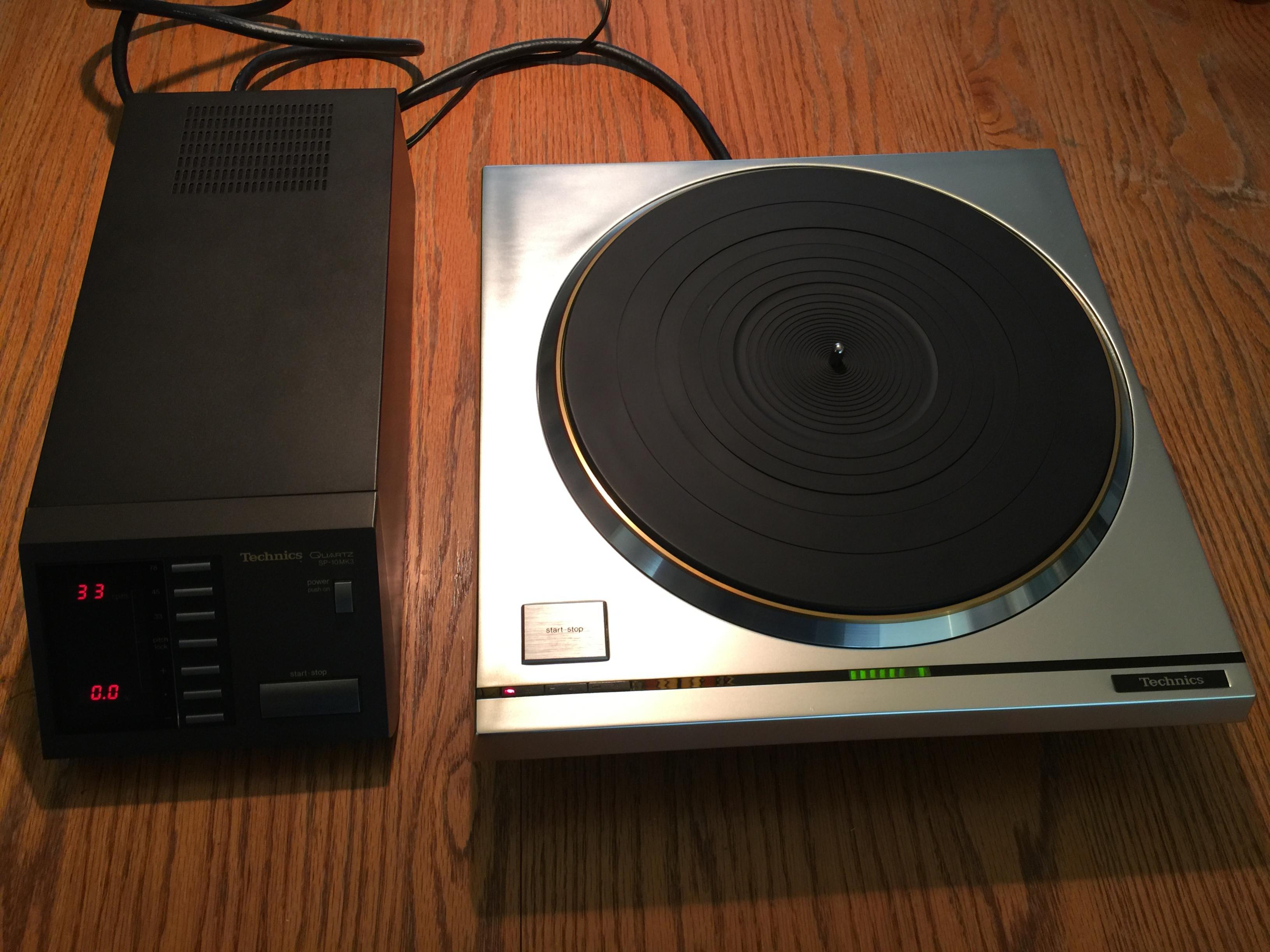

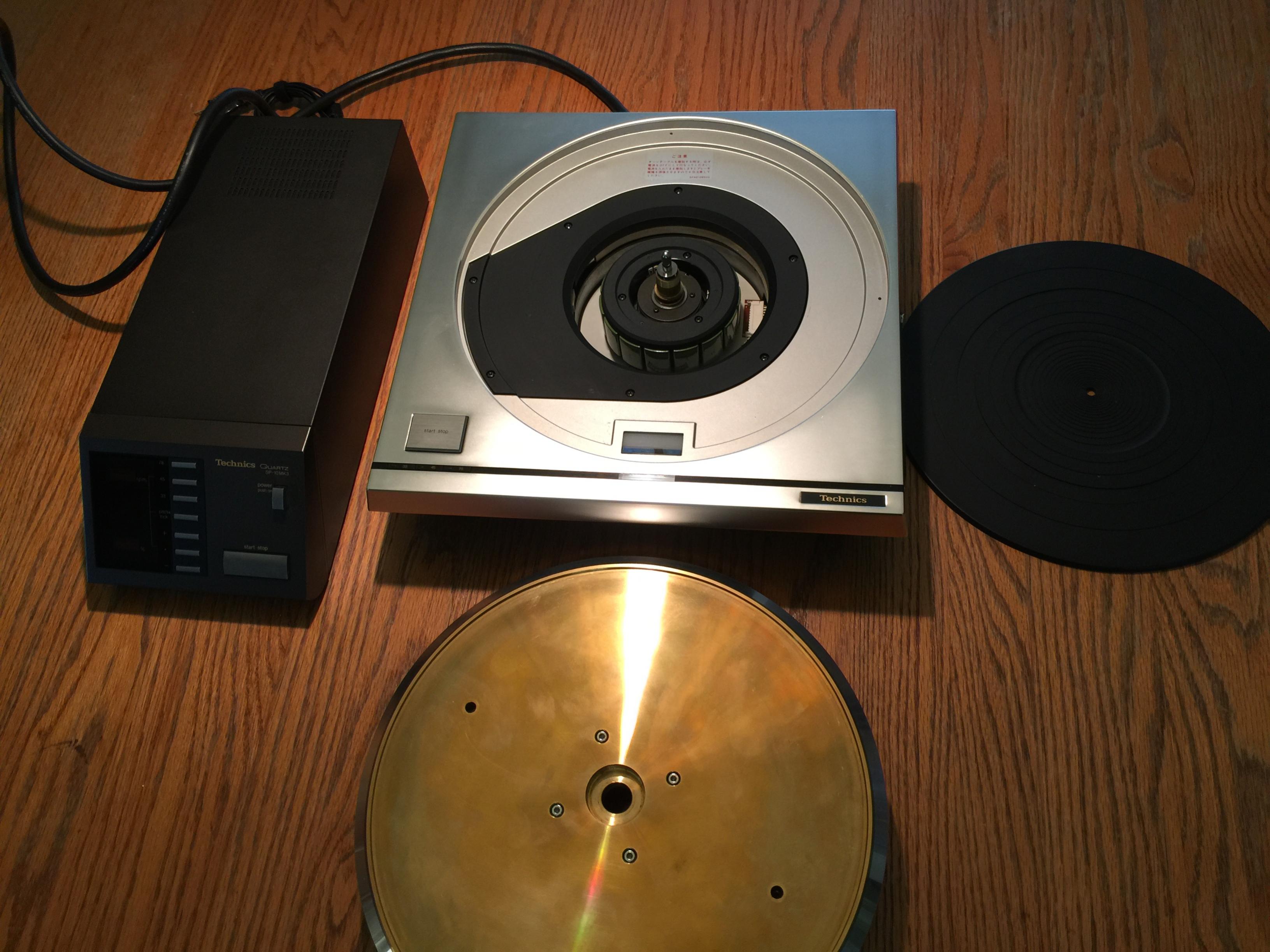

A new to me Mk3 - just arrived.
Whoo hooo!, what a great day!
I just received a new to me Mk3 😀😀😀
It is in really good shape cosmetically and it ran fine at all three speeds when I did a quick speed test.
The previous owners reported that it was just serviced and re-calibrated.
I don't have any reason to doubt him but I plan to look under the hood at some point to make sure all looks ok.
I have yearned for a Mk3 for quite a while and I finally picked one up.
The Next step is to build a custom plinth for it.
For now I am just going to use 4 layers of 3/4" baltic birch ply while I accumulate the right materials.
I also have an Analog Fidelis chip but am not in a big hurry to swap out the old chip unless you guys feel it is a must do right away thing.
Comments and thoughts welcome.

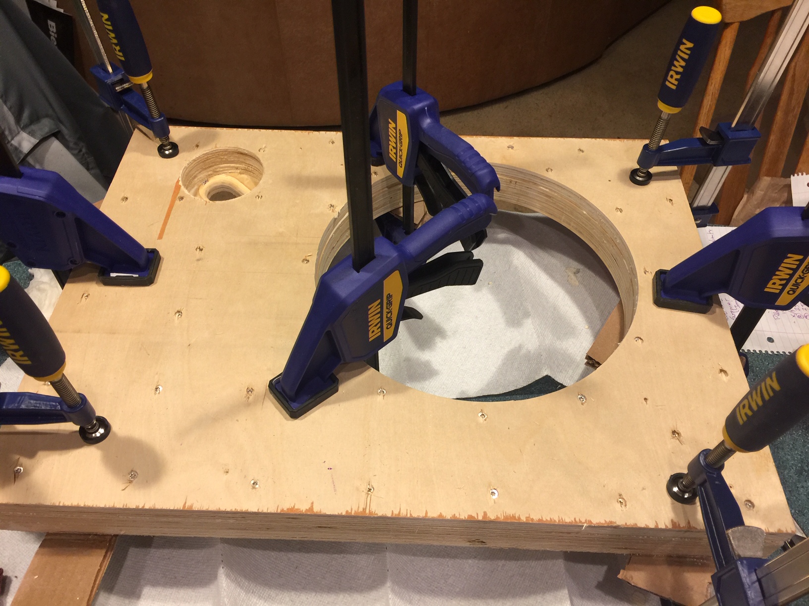

Yesterday afternoon I put together a plinth from some leftover Baltic Birch ply.
Your basic quick and dirty rectangle made from 4 layers of 3/4" ply glued up and clamped / screwed together with SS decking screws. (18 x 23 x 3").
Just naked plywood and I have not filled or sanded anything beyond knocking off the big chunks.
BTW: This birch ply is a PITA - it has really thin outer veneer that splits out if you even look at it cross ways.
It sure is ugly but I had it in the garage and Birch ply sounds way better than MDF.
If I keep it for long I'll bevel the corners and wrap it in a nice veneer.
The arm board is a 4" diameter x 0.5" thick piece of graphite.
This gets the arm up a bit and the graphite provides some damping between the arm base and the plinth.
I brought the clamped up plinth inside to let the glue dry overnight.

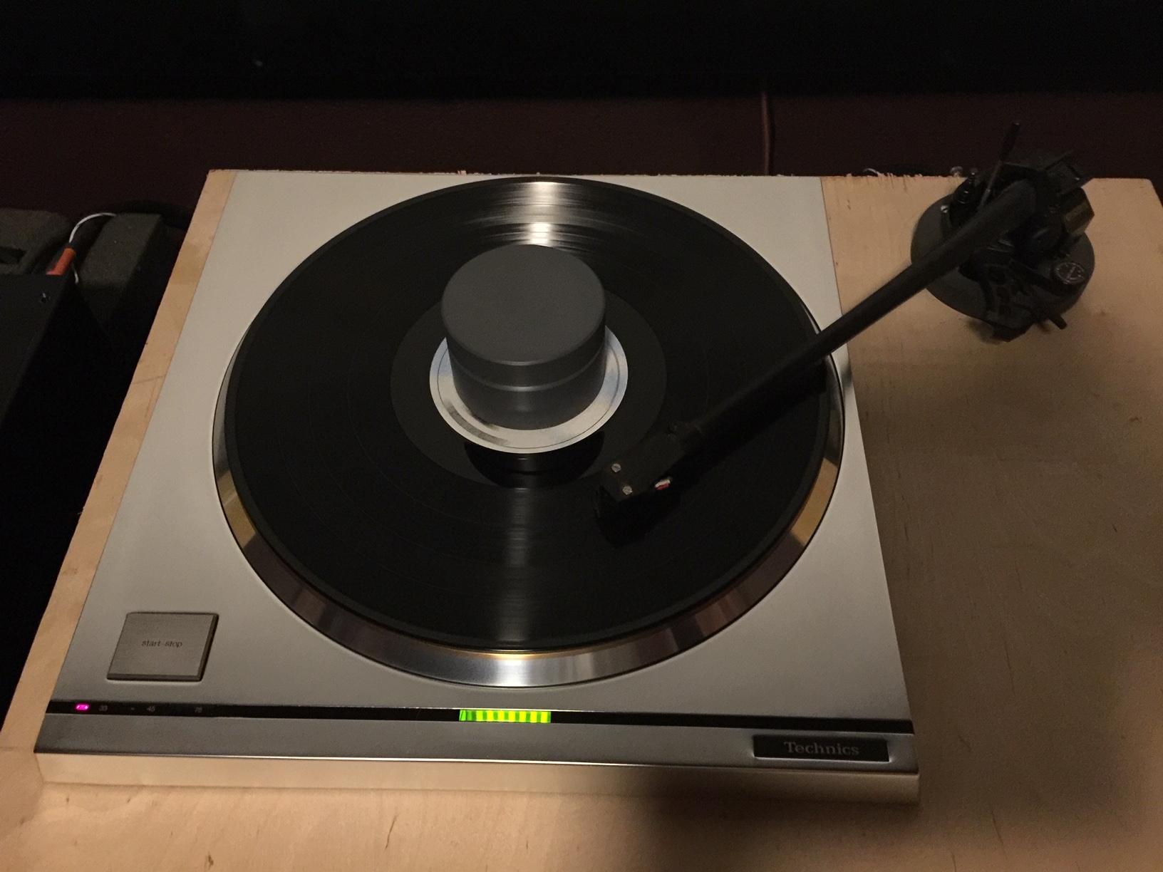

This morning I mounted the arm and table then did a basic cartridge alignment.
I fired it up and sat down to listen to some old favorites.
Wow, I thought my TD-124 was pretty good but the Mk 3 is in a whole different league.
All the stuff folks talk about with Mk3 were immediately evident.
Pacing and drive - Check
Tight, well defined bass - Yep
Tone stability on piano - You betcha
Blacker / quieter backgrounds - yessiree.
I also noticed a deeper soundstage.
Yada, yada, yada.
The thing I found most surprising was that the Mk3 seems to lower the perceived playback volume.
With the TD-124 I would listen to music at a level of mid 60's to low 70's on the XP-20 volume display.
Occasionally I would crank it up to high 70's but that was way too loud to listen for long.
This morning I was listening and I wanted to turn it up to see how music it sounded when I turned it up loud.
I pressed the volume up button on the remote and nothing happened - what the heck?
I turned on the display (it was off) and the volume was already at 83 (max).
I thought I was listening at the same level I normally do but the system was turned up much higher.
This is the identical cartridge, arm, cables, electronics, speakers, etc.
Literally the only thing I changed in the system was swapping the SP-10 Mk3 (in a 4 layer BB plinth) for the TD-124 Mk2 (in a 5 layer BB plinth).
The same music played on Mk3 seems quieter and at the same time more dynamic.
I am thinking this is about reducing the noise floor both from noise generated by the table itself and perhaps better attenuation of feedback mechanisms.
I really like what I am hearing but I would not have expected a turntable to create such a big change in perceived listening volume.
Have any of you guys experienced something similar with the Mk3 (or another table) ?
Any theories ?
