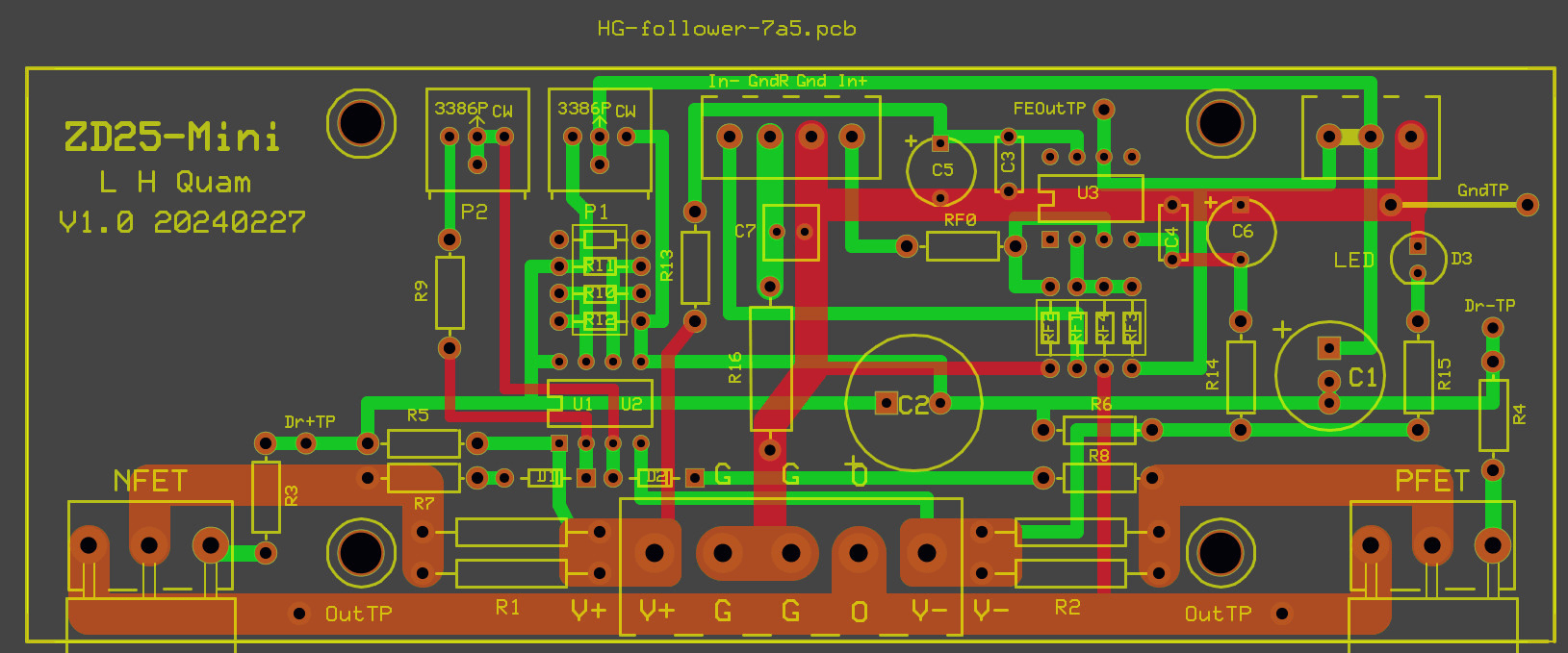

I managed to directly edit the Gerber bottom layer file using a text editor. This is the needed correction. I will put together a zip file for collection of layers.

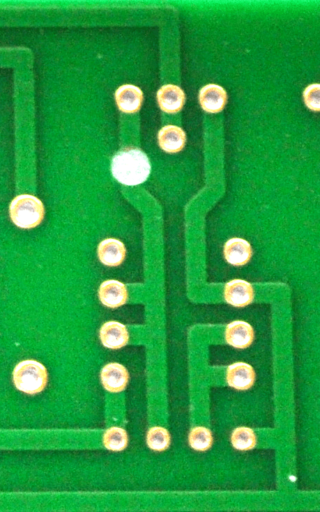

The poll has closed. I decided to do the easy part of the repair on all 100 PCBs. I used a 2mm flat end mill in a drill press to cut the trace. (It only took about 1 hr.) The PCB recipients will need to add a wire, as shown in the first image of post #190, after the components have been soldered into place.

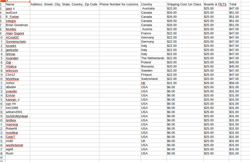

Hi @lhquam
Thanks for the list.
Are the shipping fees of $26 usd accurate, I’m finding it odd that it’s cheaper to send your package to Australia and Europe at $22…Canada and US are neighbours after all. Thanks.
It’s likely the Canadian side pushing up the cost. I sent a tonearm lifter (featherweight) in a bubblepack (also featherweight) from Toronto to Montreal - $14.00. Compare that to boards & FETS at $6.00 within the US. Ouch!
