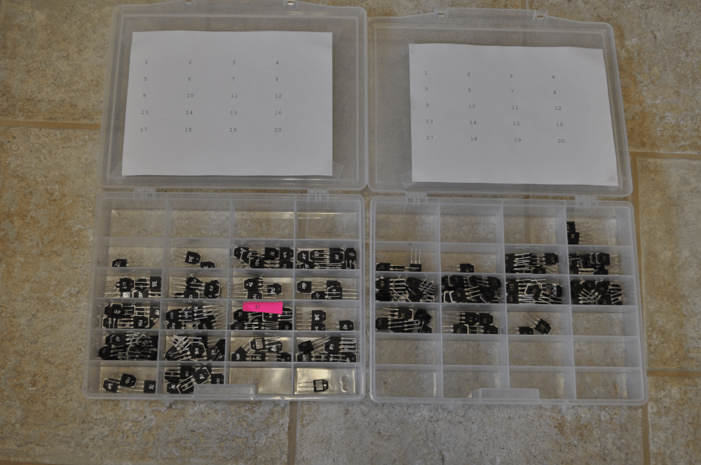

Progress Report:

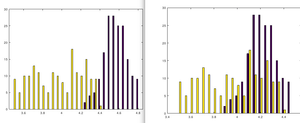

FETs sorted into bins by gm.
black=#28N15 FETs, yellow=#36P15 FETs
Left image: gm with 8R load line. Right image: gm with 8R load line and -.3S shift of black
- I now have over 170 each of the FQA28N15 and FQA36P15 FETs. The last shipment of 100 each has a more favorable parameter distribution and will improve the sorting process.
- 100 PCBs have been fabricated and shipped.
- I have measured and sorted all FETs. The FQA28N15 FETs have a much better parameter distribution than the FQA36P15, which limits the good matches to not much more than 36 stereo channels, about the present count of sign-ups.

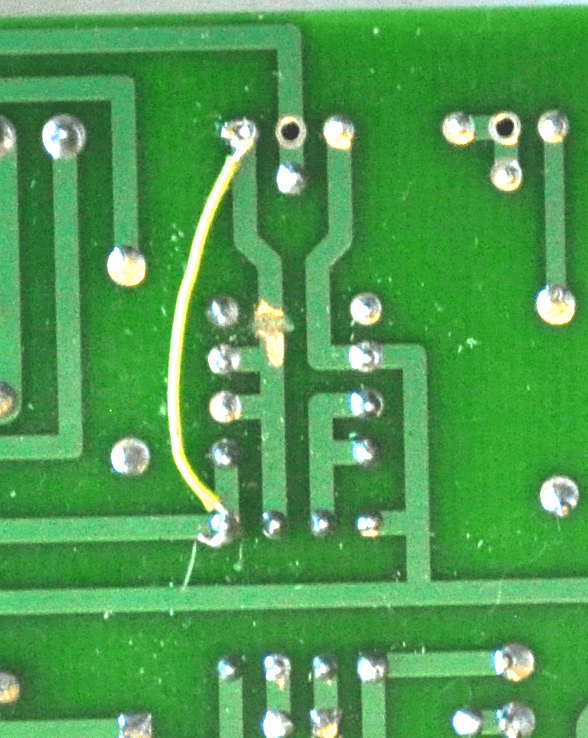

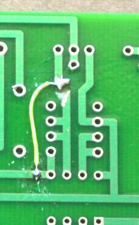

- To correct the error requires cutting a trace and adding a wire. These two images show two alternatives to correcting the error. The first image is the easier way where the wire is added after components are soldered into place.
- The requires cutting the trace and removing solder mask in two places for wire attachment. This is a more tedious operation.
