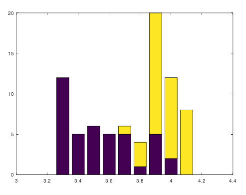

Here is a stacked histogram of the FQA28N15 and FQA36P15 gm (transconductances) for the relatively small number of FETs I currently have. Dark purple shows the number of PFETs (FQA36P15) and yellow is the number of NFETs (FQA28N15). The x-axis values are gm in Siemens (S) for the PFETS. The NFET values are offset 0.4S (10%) to provide a total of 13 pairs that have gm values within 10% of each other. With the small sample size of only 37 NFETs and 41 PFETs, 13/37=35% yield.
I have 50 more FET pairs on order and due for delivery by Mar. 11. With the 10% gm difference pairing criteria, those new fets will be enough for about 9 stereo channels. Either I order 100 more pairs or I widen the gm difference pairing criteria.
In a future post I will explain the consequences of having a greater difference in gm between the NFETs and PFETs.

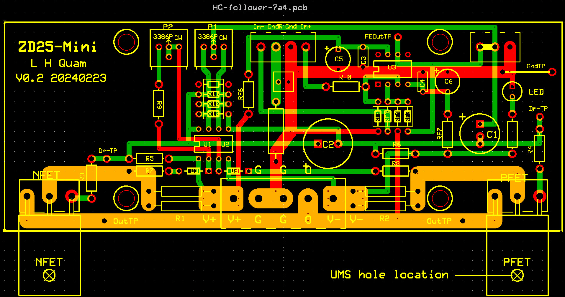

I am about to finalize the PCB layout and get the prototypes fabricated and tested. Then I will place a bulk order for PCBs to provide to the diyers. I will soon post the schematic and PCB layout for comments.

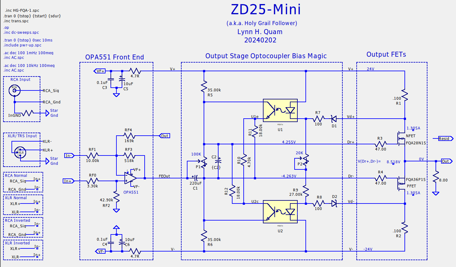

Here is the PCB layout and the schematic. There are many options for resistor values, depending on the desired global feedback level, closed-loop gain, and opamp input impedance.

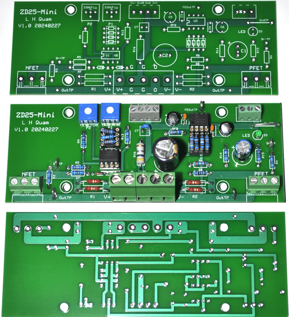

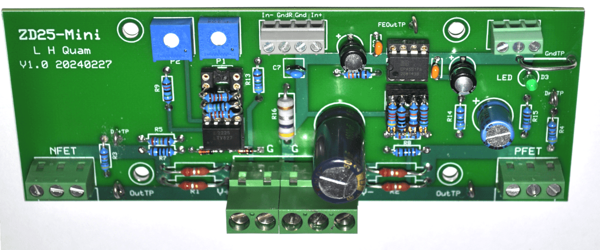

Good news:
- I received, measured, and sorted 50 each of the FQA28N15 and FQA36P15 FETs. 100 more each are are in transit.
- Four of the revised PCBs have been fabricated, stuffed with parts, and tested. Everything looks good.
- One hundred boards are now on order.
- I do not know if I will have more than 70 FET pairs (35 stereo channels) for them.
Amazing work, thanks a million for your time and dedication.
So far there are 32 members so if you can get to 35 stereo channels that would be great 👍
P.s. for some reason post 174 shows all USA members from SUA…
In anticipation of a new name for the country? 😱P.s. for some reason post 174 shows all USA members from SUA…
Yes. When I have the final BOM available I will post it and the Gerbers.
The PCBs from the offshore fab are so cheap in quantity (<$2 per board including shipping), why why would you fab your own?
- The Holy Grail Follower Output Stage
