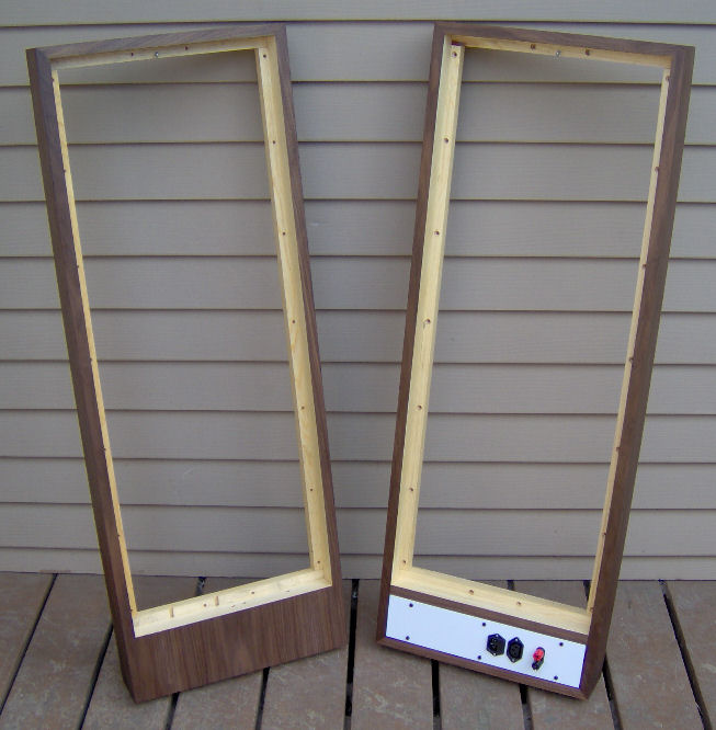

Here's a photo of the frames with walnut veneer applied. They have two coats of tung oil and still need a topcoat of polyurethane. After that, a buff with fine steel wool and the finishing will be done. It has been humid here so I'll let them sit for another day before topcoating.
The frame on the left is a front view. I'm going to use a neon lamp on the output of each high voltage power supply. I was going to mount the neon lampholders on the front and centered in the lower part. I'm not sure if I want to drill through the front after seeing the frame with veneer on. The lampholders might end up on the back cover.
The frame on the right is a back view and shows the white back cover with IEC and speaker connectors. The IEC connector on the left is the power in and has an integral 5mm x 20mm fuseholder. The other IEC connector feeds power to the second speaker through a male-female IEC cord.

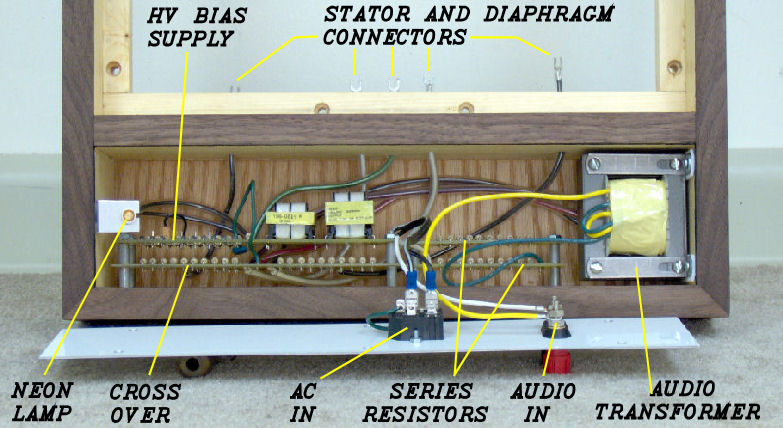

Here's a look at the electricals for one speaker. The rails that hold the back cover in place aren't shown in the picture. The high voltage wire is 18 GA sheathed in 7/32" diameter clear aquarium tubing to give a bit of insurance against arcing.
Follow the link to the .pdf file of the power supply. I measured 360 volts with a VTVM at the output of the step-up transformers, less than I expected. No problem, though. There's still enough voltage at the output of the voltage multiplier at the X10 setting to arc between two test plates of perforated steel 0.080" apart.

Hi Bill H,
nice work !
I looked at the power supply. You shouldn't connect the output of T2 directly to the ground of the cascade, but implement a 20Mohm resistor to avoid hum by capacitive coupling.
What size is your stepup ? it looks like EI 84. I guess with this small sized stepup you wont drive your ESL fullrange ?
Capaciti
Thanks, Capaciti. You can't tell from the picture, but the 20 meg resistor is on the HV bias supply board farthest away from you in the photo. It's made up of ten 2 Megohm resistors. It's a modification I made to Roger Sander's design to use readily available components.
The transformer core measures 73mm wide x 64mm high. The manufacturer recommends a low frequency cutoff of 225 Hz. It won't be used as a full range, I've got a TL woofer to provide the low end.

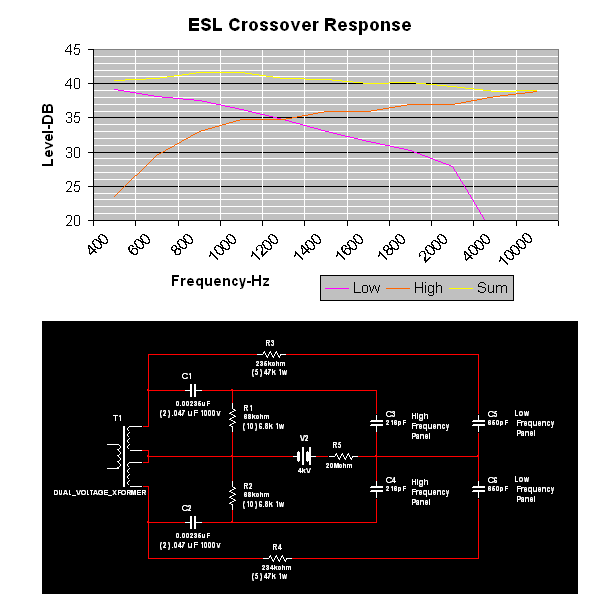

The picture below shows a crossover frequency response chart and the simplified ESL circuit. All resistors shown are made up of multiple 1 watt units to withstand the voltage and current demands of the ESL panels.
The frequency response test setup was frequency generator --> audio transformer --> crossover --> VTVM with capacitors of close to the calculated ESL capacitance installed where the ESL sections would be. Although my method was crude, the graph shows the crossover overlap and cutoffs that gave the smoothest summed response without excessive current draw from the amplifier. Note the linear frequency scale on the chart. It's done with MS Excel and I don't know how to get a Log scale on the x axis.

Capaciti writes: You shouldn't connect the output of T2 directly to the ground of the cascade, but implement a 20Mohm resistor to avoid hum by capacitive coupling.
I haven't seen a second 20 Meg resistor used in that position before. I could be wrong, but the ground of the cascade seems to be at 0 volts DC in relation to the output. I'll measure the output after the first rectifier to see if there's any AC signal there when I get home later.
I looked onto your schematic. What is the purpose of R1,C1,R2,C2 ?
They are RC high pass filters for the high frequency sections of the ESL, based on this.

Hi Bill,
is the tweeter-panel with the same d/s as the bass-mid-range panels?
Than I wouldn´t use any high-pass-filtering, because You need every peace of area for a good efficiency of the speaker. In case the tweeter-panel is designed with smaller d/s You my use an RC-filter, but I´d suggest smaller values for C as well as R.
C can be chosen smaller, but not less than 10 times the speaker capacity. A quick simu based on Your speakers capacity value showed that 10nF + 30kOhms give -3dB freq of ~500Hz, 20kohms ~730Hz and 10kOhms ~1.4kHz.
