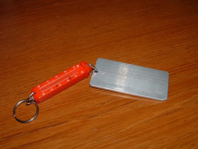

Tension tool
Here's a tension tool that I've been using in stretching the mylar
with great success. It works around the membrane stretching
it as I go around, fixing the stuff with a strong tape. After done
all I have to do is to glue the frame to it, it remains stretched
forever....
This is a smart tool bought from Eraudio.com.au sometime ago.

Stretcher
Hi Few
Unfortunately I wasn't able to get a better image of the stretcher
no matter what I did, I have a hell of a time trying to get a good
picture every time due to the constrains of size.
Anyway the strecher is a very pratical device that does the job,
the red part is a dinamometer calibrated in kilograms, the white
part is an aluminun plate where you tape the membrane temporarily until you stretch it to your wish. Once you attain
the desired tension you untape the membrane and tape it again against the surface you have it down. And you go around the
membrane doing the same and paying attention to the desired tension
which should be the same around the perimeter of the mylar.
At the end you'll have a tensioned membrane to your requirement
taped all around. Then you need to glue the the structure of the stator to the membrane, that's all.
I hope this long explanation described the stretcher to your contempt.
