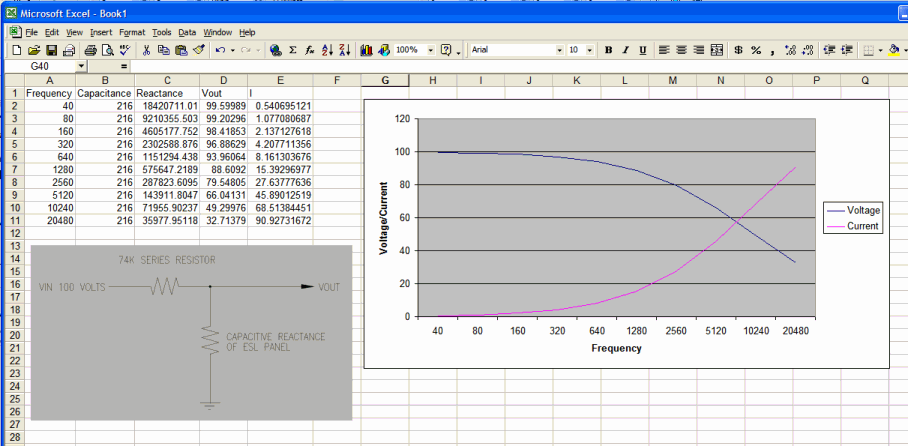

I tried applying some math to the resistor situation. It didn't show what I expected to see, though. I must be overlooking something.
I do believe the series resistor is forming a low-cut/high-pass filter with the ESL panel, even though my math doesn't show it happening that way.
Here's an Excel sheet with a graph of voltage and current versus frequency using the capacitance of my narrow panels (216pF) and a series resistor chosen to give a useable scale. The current plotted assumes a constant voltage and is scaled to read easier.
A resistor and capacitor in series form a low pass filter.Capacitor's reactance decreases with frequency.Resistance R remains the same , therefore there will be more voltage drop at resistor at higher frequencies.
Standard 1st order LP filter formula should work here :
R = 1/(2*pi*f*C) , where f is the frequency at which output pressure will be 3 db less(i hope my memory serves me well 🙂.
C is the capacitance in farads.
You could even take LTSpice and make all the simulations with graphs automatically.

As bazukaz mentioned the resitors work as a filter.
If you watch the picture in Bills post you recognize several resitors:
1. there is a center segment havin just 0,8 inch width running fullrangewithout resistors.
2. adjacent left and right to the center segment there are segments of 1 inch width. The signal passes an array of resistors in serie to those segments. Cut off frequency is about 5Khz. The resistor array consits of more than one resistor for a simple reason. The voltage drain can be significant and can exceed 600 Volts. In order not to overload the resistors voltage handling, three resistors are connected in serie, thus drop it to 200 Volt each. Its important to select high quality resistors and such types cannot handle much voltage. Never use high voltage types or carbon ones.The show unacceptable tolerances and thermal drift
3. there are another two outer and wider segments withcut off at 800 Hz.
Segmentation needs a lot of iteration steps (width and cutoff of segments). If setup correctly the result is flat frequency response, very good high frequency dispersion and imo most important very good impedance matching.
