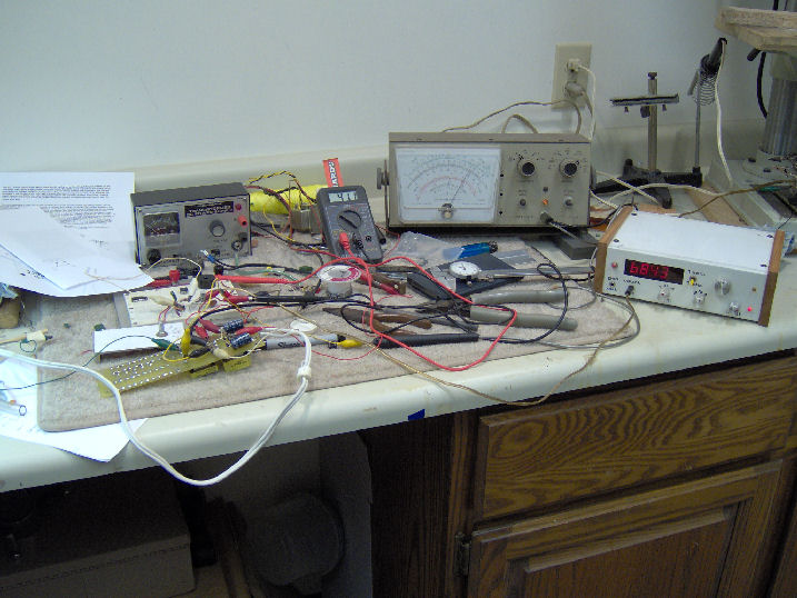

Ah, success finally. I've got a prototype high voltage power supply working on the breadboard. I went back to Sheldon Stokes' original power supply (pdf file) and altered it a bit so I could modify my first power supply attempt and use new parts I have on hand.
Here's a photo of the work in progress. It's hard to see , but the power supply is on the bottom left.

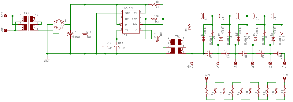

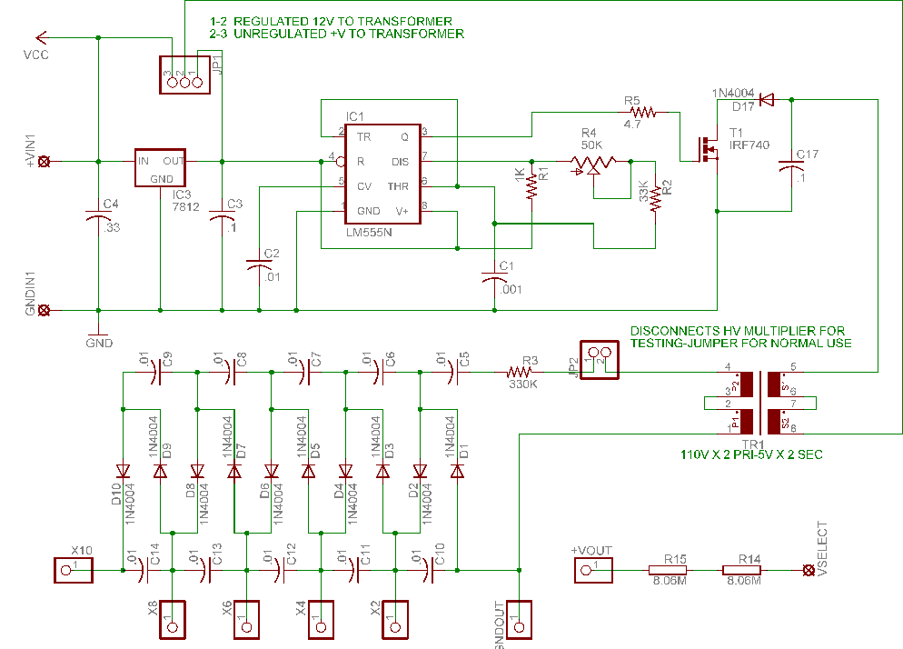

Here's the schematic. Instead of using two transformers directly connect to step up the voltage, there's a bridge rectifier and an LM555 chopper between them. The frequency of the chopper is set to the resonant frequency of the second transformer, 6630Hz.

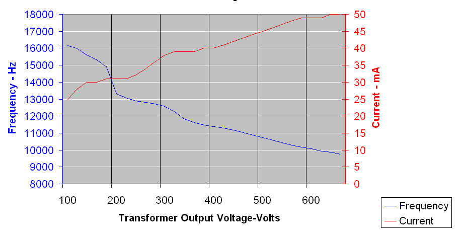

I'm getting 410V RMS at the output of the second transformer and both transformers are running cool to the touch. The first 110V:12.6V transformer feeds a bridge rectifier and filter capacitors to give 19.1V DC when running. The circuit draws 42mA, well within the current limits of the first transformer and the LM555.
The LM555 section is a standard astable multivibrator. I'll replace R2 with a series connected 6.8K resistor and 5K trimpot when it gets built. The circuit detunes a bit and output voltage drops when a load is connected and I'll need to trim the oscillation frequency to keep the voltage up. The circuit that this is based on had an LM317 regulator before the LM555 that I left out. It was there to adjust output voltage, but I find that I can do that just by changing the oscillator frequency.
The transformer feeding the second transformer is wired for 10V:220V. I tried wiring it for 5V:220V, but only gained 10% more voltage for a 50% increase in current draw.
The only change I have to make to the current power supply boards is to break the connections between the two transformers. All the components between the transformers will be on a small perfboard. Now I need to build a pair of them.

Here's the schematic of the chopper. The changes to Sheldon's design are minor. I used a 7805 regulator I had on hand and lifted the ground with 3.3K resistors to get between 15 and 16 volts from the regulator. The chopper has a variable resistor to fine tune for maximum output voltage to the votage multiplier. The capacitor on pin 3 of the LM555 was changed from 10uF to .0047uF to raise the resonant frequency of the transformer/capacitor to get it out of audible range. With the original 10uF capacitor, I could hear the transformer oscillating.
The power supply did end up to be Sheldon's v1.0 with some changes. I started with his v2.0, but it didn't work. I could use all of v2.0 and add the chopper circuit from v1.0.

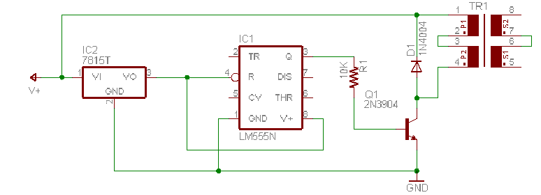

Capaciti writes: I am wondering about the LM555, as it feeds the 2nd transformer directly. Wouldn't it be better to implement a transistor ?
The chopper operates at well under 200 ma so the 555 is safe. You have given me an idea, though. Adding the regulator dropped the output voltage from the transformer from 410V to 300V. I'd like to see if I can use the transistor as a level shifter, controlled by the 555, but fed from the unregulated and higher input voltage and maybe get a a few more volts out of it.
Here's a simplified schematic.

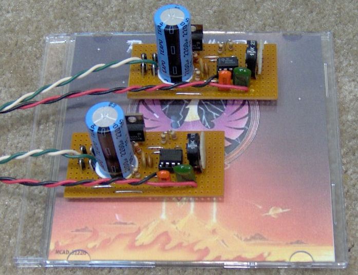

Hi, all. The build is still alive!
I took some time off from posting to completely rebuild a pair of HV bias supplies. Rather than turn the thread into a long 'How to design and build a high voltage boost power supply', I'll try to keep it short.

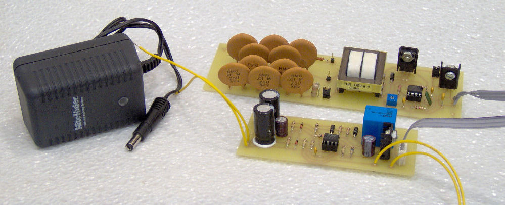

The picture shows one complete system. There's a 16.8VDC 300 ma wall transformer on the left. That feeds an Elliot Sound Products Project 38 'Signal Detecting Auto Power-On Unit'. It has only been changed to use a single speaker level input and added dropping resistors on the 9V relay that I had in the junkbox. The 'Power-On Unit' feeds unregulated DC to the next board, a DC chopper and voltage multiplier, when it detects speaker activity.

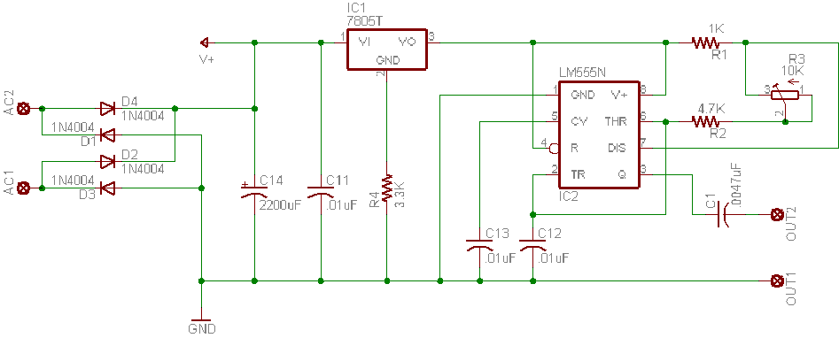

Here's a schematic of the DC chopper and voltage multiplier board. It has an LM555 astable multivibrator with a variable frequency of about 10KHz to 20KHz. The frequency determines the output voltage from the transformer. My prototype puts out 80V-660V RMS depending on frequency. Lower frequency=more voltage.
There's a couple of options built into the board that can be used if you wanted more output voltage. I didn't, but they could be helpful if anyone wanted to use this circuit with a transformer with a lower turns ratio. JP1 selects either 12V regulated or input voltage unregulated to the step-up transformer. Use the input voltage unregulated for more voltage. Use capacitor C17 for more voltage. 0.1uF(100nF) is a good starting point with the astable part values as shown. The values of C1 and C17 may need to be tweaked to resonate with a different transformer.
The X2-X10 pads are not used. They were there to tap the of the voltage multiplier for lower voltages, a remnant of an older design. I connected VSELECT to X10, the highest voltage tap and adjust the output voltage with R4 instead.

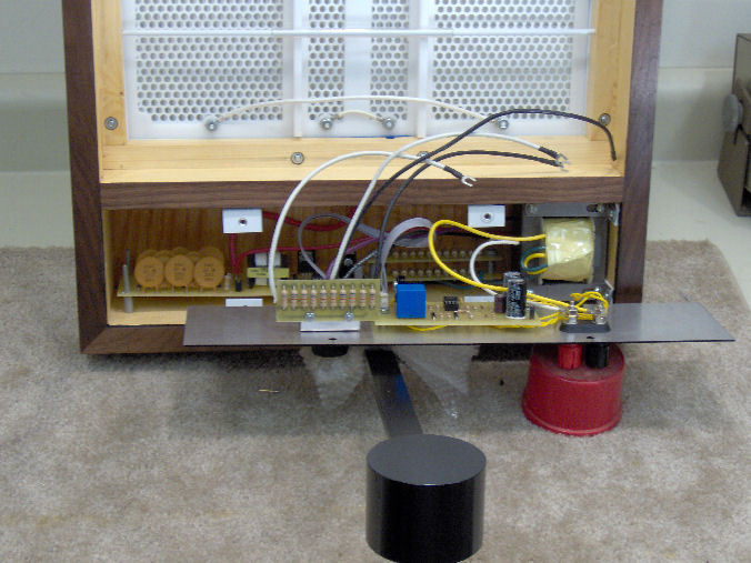

Here's a photo of the back of one of the ESLs with the back cover off.
On the left of the cover is a bank of series connected 6.8K resistors salvaged from my original crossover and behind it is a two-pole six-position switch that forms a variable high pass filter on the narrow stator sections. It will switch between no filter or from one to five series resistors. At first listen to the ESLs with no filter, the midrange seemed a bit too strong. The 6.8K resistors give a subtle adjustment and I'm using a string of three at the moment. The wide stator sections are running fullrange.
The automatic turn on-turn off board is in the middle. To its right you can see the speaker input. Behind the input, but hidden is a 2.5mm connector for DC in from a wall transformer and an LED pilot light to show when the high voltage supply is on. I haven't been shocked yet and the pilot light was a last minute addition to make sure I know when the high voltage is working.
The black and white wires with terminals on the free end will connect to the perforated stators.
Inside the ESL, the new high voltage power supply on the left. There are two boards of resistors near the middle that form a series resistance for amplifier protection. They form a 2 ohm, 20 watt non-inductive resistor. The audio step-up transformer is on the right.

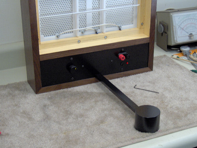

And a photo of the back with everything closed up.
The ESLs at 43" high and 3-3/4" deep was an accident waiting to happen. It was only a matter of time until I bumped one of them or one of our dogs hooked one with a tail and down it went. The block sticking out the back is there to keep the ESL in an upright position.
It's about three pounds of weight cantilevered out 12". Very effective.

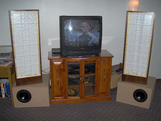

I've had a chance to listen to the pair together with woofers for the first time this weekend.
Short review:
I really like them. Voices sound lush, drums have a nice attack, and cymbals shimmer. It seems like I hear more detail in the music than I'm used to. Complex music is easier to listen to and I suffer no listening fatigue. After a while I found that I was listening to the music instead of listening to the speakers. The soundstage extends past the speakers and performers seem precisely positioned.
Long review: Everything above is true, but there's still room for improvement.
The ESLs don't like to have a wall behind them. The farther away they are from the wall, the better they sound. Too close and there's some serious comb filtering happening. 24" is too close, but that's about where I'd like them to be. I need to try some wall treatment behind them.
One of the ESLs has some leakage. When it was first turned on, I could hear arcing and a loud hiss from a small area. It's coming from the stator with the diaphragm glued to it. I've been able to partially fix it with small strips of paper between the front and back insulators and reducing the bias voltage. There's still a slight hiss that I can live with for now.
Efficiency is good. Certainly not like a dynamic driver, but my 100wpc amplifier drives them as loud as I want to listen to them.
High frequency dispersion is practically non-existant, typical of a flat-panel ESL. I thought that two 1-1/2" wide panel sections would help that, but physics wins again. It predicted dispersion dropping near 3000Hz. With careful aiming of the ESLs and precise recliner positioning, there's a 3"-4" front to back sweet spot, but what a spot!
I still haven't got a good crossover point between the ESLs and woofers. According to the frequency response of the ESLs, a 12Db/octave filter on the ESLs and a 24Db/octave filter on the woofers at 500Hz should give a smooth transition between drivers. It doesn't work so well. I'm using DSP software on a computer sound card to do the crossover now, so changes are easy to make. At the moment a 300Hz, 24Db/octave crossover sounds better, too high and voices start sounding wrong.
I think the woofers are the problem. They're transmission lines with 8" woofers that are lightly stuffed now and work with a lower crossover frequency, but there's too much midrange coming from the terminus at a 500Hz crossover point. I'll have to add more stuffing to get the bottom end in line and do some more listening.
Here is the setup. The ESLs still need grilles.
Short review:
