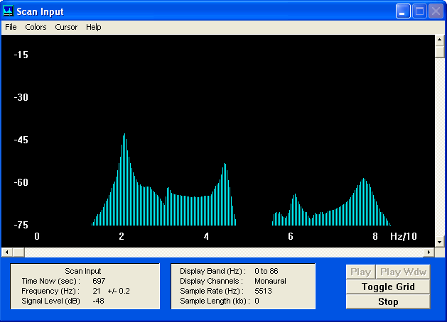

The stretching jig worked very well. I checked the resonance of the diaphragm with a microphone into my computer's sound card and this software. After I had tightened the film until there were no wrinkles, I tapped the diaphragm in the middle and got a resonance at 17Hz. I had calculated that it should be 21Hz to get the segmented ESL sections to resonances of 89Hz for the larger 4.5" wide sections and 267Hz for the 1.5" wide sections. Tightening the stretcher slowly, the resonance got to 21Hz after four tries.
The screenshot below shows the result. The fundamental resonance is at 21Hz, but as I_Forgot said there are several other resonances above that.

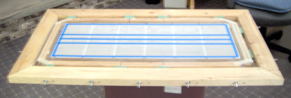

Here's a picture of the stator in the frame with the diaphragm glued on and blue painter's tape masking the area to receive the EC coating.
The diaphragm is glued to the stator with 3M 4693H Plastic Adhesive. After testing on scrap, I went with a thin film of adhesive on the stators, dried, but still tacky. Then the whole stretching jig was lowered on to the stator and the film pressed in place with my fingers. The assembly sat overnight and I cut it away from the waste film and checked the resonances again on all the sections.
The resonances were not what I expected, but if correct, should be fine. The tap test showed 66Hz on the wider sections and the 660Hz on the narrow sections. I'd like to recheck this with an impedance measurement later. I thought the 4.5":1.5" width would give a 1:3 spread, not 1:10.

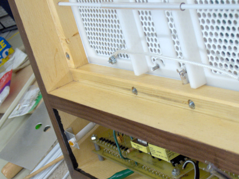

I'm doing some troubleshooting tonight. I chiseled out some more room between the frame and diaphragm connection and added insulation between them to stop the arcing. There's still some high voltage leakage between the diaphragm and ground, though.
The neon lamp HV supply mod makes a good tool for diagnosing the HV system. The faster the lamp flashes, the more charge is going to the diaphragm. With the voltage multiplier on the HV power supply set to X2, ~1018V, the lamp flashed 2-3 times a second. At X10, ~5900V the lamp was on constantly and the larger transformer got too warm to run it for more than a couple of minutes. The diaphragm was the only thing connected so far. The stator connections were left hanging in the air.
At X8, ~4720V the power supply arced between the X10 trace and another trace on the board. I'll have to fix that.
By attaching a wire to ground, I could probe with the other end at different points to check for leakage. The final leak to ground is coming from the screws that hold the frame together. I'm not sure why. The conductive coating on the diaphragm stops about 1/8" from the stators and the edge of the screws should be about 1/8" from the stators. The connection to the diaphragm is done with two narrow strips of copper foil near the center of one of the stators. I don't see a path for the HV unless the conductive coating got under the masking tape I used when coating and the 3M adhesive is conductive.
The picture below shows the bottom left corner of the speaker. The ESL panel is sandwiched between wood frames and insulated with white craft foam between the frames and panel. You can see three of the eighteen screws that hold it together. I'm going to try taking it apart and insulating the screws with aquarium tubing.

Hi BillH,
1. if you test your voltage you might drop High Voltage significantly. So what you measure might not be the true value.
2. i do not know your D/S spacing, but 4000 Volts appear too much. If you exceed about 2300 Volts per 1mm spacing the air gets conductive and as aresult your neoen lashes constantly. Under humid conditions it even drops down to about 1600 Volts per 1mm.
3. In your picture the stators look poorly isolated. There is no corner rounding visible. I would expect that there are some small needle like edges, which will arc at lowest voltages. Take a look at Martin Logan homepage and watch out forstator pictures. You will recognize thick isolation about 20 mill thick.
4. Your construction is quite impressive, but you are right to isolate the screws. Since the forces to hold the stators are not very high, you coulduse nylon screws.
5. The neon lamp isa great feature. Could describe mor detailed (Neon type........) ?

Hi Capaciti and thanks for the suggestions.
True, I can only measure the output of the second AC transformer and that is 360 volts RMS. 360 X 1.414 = 509 volts at the input to the voltage multiplier. The voltage multiplier has taps at X2, X4, X6, X8, and X10.
D/S spacing is about 1.4mm and it has been humid here lately, but I'm seeing leakage even at 1000 volts. I tested it with no connections to the stators and was still getting leakage to the wood frame.
I'm not sure what you mean by poorly isolated, could you explain? There are a lot of needle like edges on the perforated stators. I found it very difficult to remove them all and ended up rounding them over with a wire brush. The edges are still made up of points that are partial holes that remain after shearing to size. If that turns out to be the problem, all I could do now is try to insulate the edges.
The ESL panel is held together with the screws around the edge and horizontal steel round bars that clamp everything together quite solidly. I had thought about using many small nylon screws through the panel to hold it, but didn't have enough room in the center of the panel to do it that way.
I've got most of the day today to see if I can figure out what is wrong. I'm going to try removing the ESL panel completely and check it for leakage outside the wood frame.

Hi BillH,
the stator need to be perfect without any edges. Professionals perform chemical edging or polishing to round all edges from the manufacturing process.
Even the smallest edges or any other sharp residual will compromise insulation. The smaller and sharper those are, the higher the field density at this location. This results in arcing at low voltages.
If you tell us that there are some visible needles on the perforated plates i think you wont get rid of your problems. The only way is to debur the plates mechanically with a rotating steel brush prior to coating. Make them as rounded and polished as you get them with the brush. If there is just a single needle left it will arc !!

Hi, Capaciti.
There are points on the edges of the perforated steel. I consider the points to be the only drawback to using the perforated material. That doesn't appear to be the problem right now, though. I took the panel out and with nothing connected to the power supply and crossover, the leakage was still there. So the power supply and/or crossover seems to be the problem. I'll remove them from the speaker and see if it still leaks.

the edges of perforated steel have to be as soft as possible.
So cutting should be done like this:
Additionally to the thick insulation I added some insulating tape at the edges. That gives very good results.
