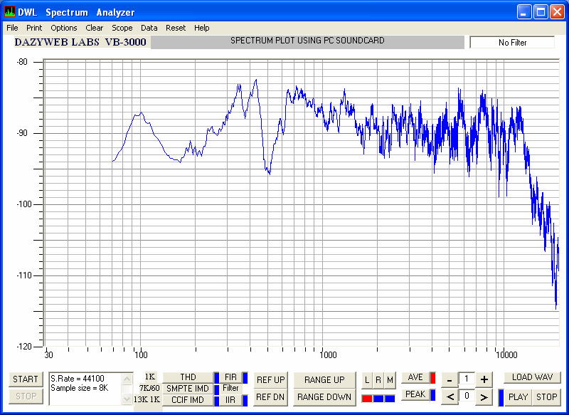

Hi all. I ran a frequency response test on the first ESL panel today. The peak at 100Hz seems to confirm that the stretching tension was correct.
I'm not sure what's causing the dip at 500Hz. The ESL was set up roughly parallel to and 25" from a wall with the microphone 12" from the center of the speaker. 7' to the back wall and 10' to the front wall. The wavelength of sound at 500Hz is about 27", the distance from the ESL panel's edge to the nearest wall, or twice the distance of the narrow dimension of the inside of the ESL. More testing showed that it wasn't caused by the wall.
Well, it looks quite nice.
The suck-out at 200 Hz probably is phase cancellation because of the lack of an enclosure. Putting 'wings' at the back of the esl may give some improvements. I've tried that with my full range esls. Subjectively it improved but I could not perform any measurements. Since you can, it might be an interesting subject to investigate.
Regards, Martin-jan
Regards, Martin-jan

500Hz
Hi Bill,
as You already mentioned, the wavelength of 500Hz correlates with the panel´s dimensions. You should experience the problem of a standing wave here. As a measurement You might try to add some damping around the inner rim of the panel. You could use for example small strips of foamed rubber (preferably not black!!) thats been sandwiched between stator and diaphragm (cut in irregular shapes like triangle, half-elliptical a.s.o). Another measurement could be to place some silicone drops around the inner rim (in case of a fully built panel)

I found out it's also the distance from the bottom edge of the ESL to the floor.
MJ Dijkstra writes: The suck-out at 200 Hz probably is phase cancellation because of the lack of an enclosure. Putting 'wings' at the back of the esl may give some improvements. I've tried that with my full range esls. Subjectively it improved but I could not perform any measurements. Since you can, it might be an interesting subject to investigate.

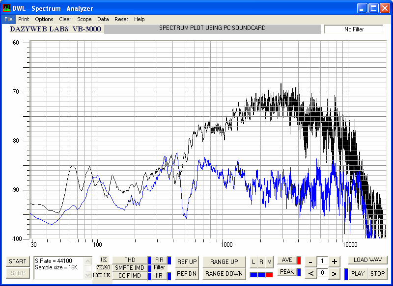

The second ESL is finished. This one has a bead of silicone around all the sharp edges of the perforated stators to try to cut down the high voltage leakage. It helped, but I think there's leakage somewhere else. This one is running with no crossover at all and it's way more efficient than the first one with the crossover.
The picture below shows the frequency response of both panels. The blue trace shows the first panel with crossover and the black trace is the second panel with no crossover. The no crossover version plays loud enough for me, even when listening to one ESL. It's 'brighter' sounding, but a little harsh sounding in the nearfield. Some EQ should take care of that. It sounds better the farther away I get from it.
Both of the ESL's frequency responce graphs show a drooping high end, more about that later. If I had to pick my favorite now it would be the no crossover version.
Since there is so big difference of efficiency of two panels , something is wrong. I think it might be one of these possibilities(or even something else) :

Yes, flatter but way less efficient. The crossover sure seems to even the response out, though.isn't a flatter freq response what your looking for, the blue is flatter for sure.
It could be the leakage. The more efficient panel has silicone sealant applied to the edge of the stators to stop leakage from the sharp edges. The coating is the same on both panels, so I don't think the surface resistance is the problem.1. Leakage problem(diapraghm not allowed to charge);
2. Surface resistance too high
Yes.Are you measuring the panels at the same potition in room ?
The next step is to try the more efficient panel with the crossover. I just have to swap the panel from one frame to the other. That should determine if it's the crossover or the leakage causing the low efficiency.You should try to measure both panels without a crossover.
I've decided to redo the first panel while it's out and add the silicone sealant to it, too.
