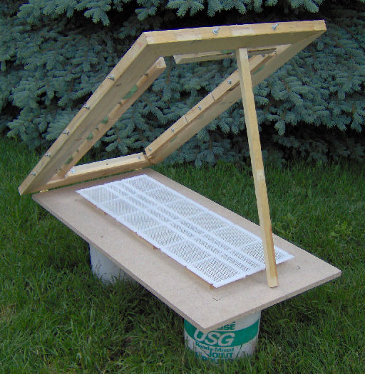

Here's a photo of the stretching jig v1.1.
Thanks to all for your ideas and suggestions. I think you'll see many of them used in the latest version of the jig.
The v1.0 moveable parts on the long side have been divided into three pieces and the holes they are mounted to have been slotted to allow up to 5/16" of movement while stretching. I've added some foam blocks between the moveable parts and the main frame to stabilize the moveable parts.
There's no film in the photo. When it's in place, it will be held to the moveable parts with double sided tape. The splines in v1.0 just didn't work out.
In the center of the jig is a table used to apply the graphite. The table is removeable and sitting on six 3/4" thick MDF blocks that are attached to the baseplate. It's made of 5/8" chipboard with 1/8" masonite glued to it and a top layer of white paper. It's hard to see, but there are guidelines on the paper. There's a rectangle the same size as the ESL stator, and two other rectangles, each 1/4" inside the other. The middle guideline is where I'll put masking tape on the diaphragm to end the coating. The inner guideline is in line with the inner edge of the stator as a reference.

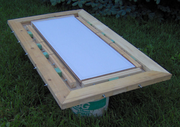

Here's a photo of the v1.1 jig with the frame opened, the table removed, and the stator in place as it would be for gluing to the diaphragm. There's two hinges in the back that hold it all together.
There's no diaphragm in the picture, but it would be on top of the top section.
Shortly before I took the picture, I knocked the stick I was using to hold it open and the top hit me on the head. I'm lucky I made contact with the frame and not the threaded rods sticking out of the frame.

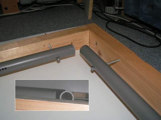

my small contribution to the subject of stretching jigs:
Instead of wood I use pvc tubes for the moving inner parts to which the mylar must be attached. This solves the problem of obtaining a good strong bond between the jig and the mylar during stretching, which in my experiences can be troublesome with (unpainted) wood. I use small strips of double sided adhesive tape which sticks very well to both tubes and mylar. Also the rounded surface increases bonding and reduces risk of tearing.
In addition the tubes are mounted in such a way that they extend from the surface of the jig, I hope the picture clarifies.
This allows me to place the mylar on a flat surface and use some tape to lay it out flat without wrinkles (no tension applied yet). Then I place the jig on top of that, tubes facing down, "picking up" the sheet from table to jig.
For measuring tension I draw a rectangle on the untensioned mylar and carefully measure it's dimensions whlie stretching, which allows for pretty good reproducability. Because the tubes can flex a little I can evenly distribute the tension over the entire surface by adjusting the various screws.
About coating: various kinds of glue seem to work as well (dilute and apply by airbrush). Haven't tried it myself no no idea about long-term stability
Just some more ideas..
