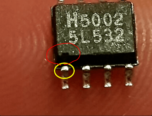

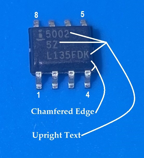

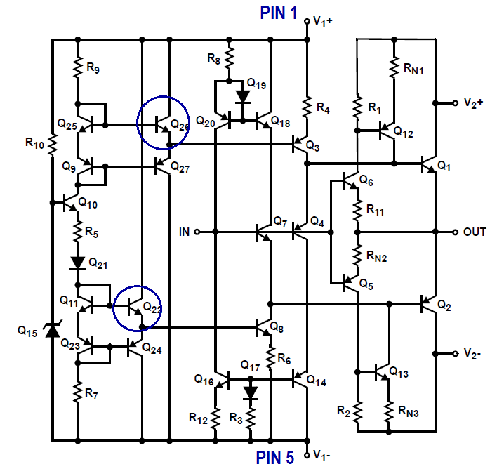

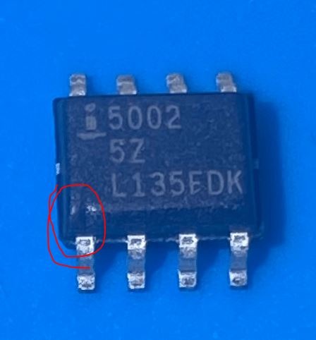

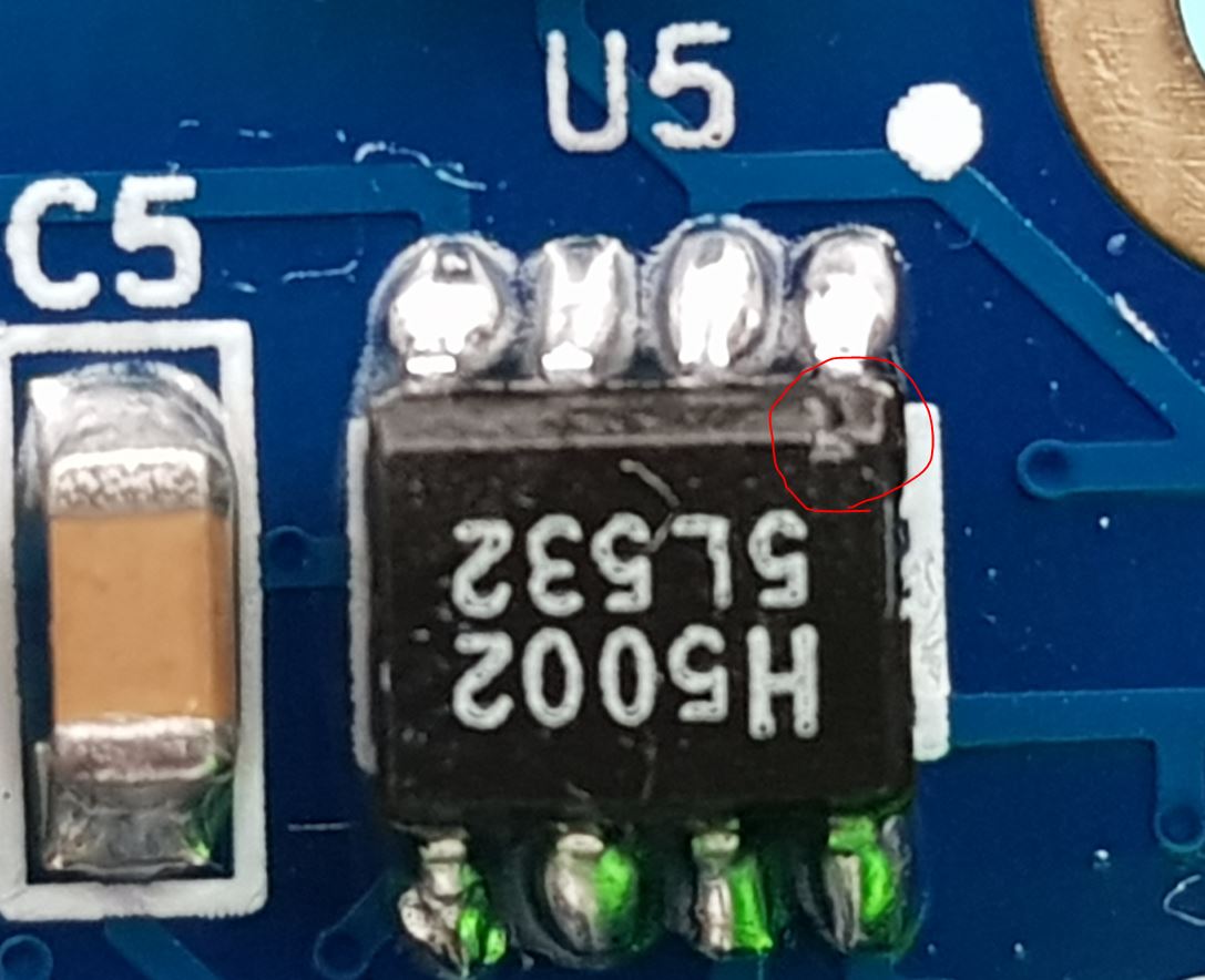

To buzz it out, notice that the collectors of Q22 and Q26 are N-doped silicon, forming PN junctions with the P-doped substrate. So you can diode test between suspected-pin-1 (cathode) and suspected-pin-5 (anode) of the HA5002.
Other ways of finding pin-1 are shown in the photo below.

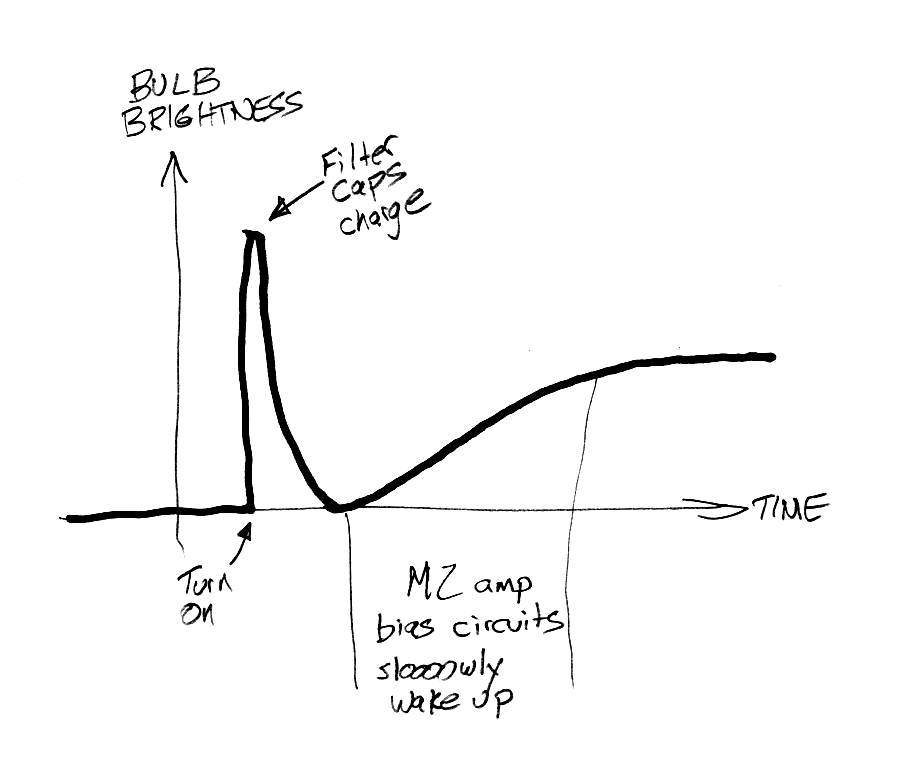

You may have to "fly" with some faith you did it correctly - the M2x will not power on correctly with a DBT (current limiter) in place. See the graphic below, I had a similar question when I first turned my amp on with a DBT and Mark provided this graphic showing the power-up sequence and why the DBT causes issues. This graphic is posted throughout the thread, but I couldn't find a post# to link to.
