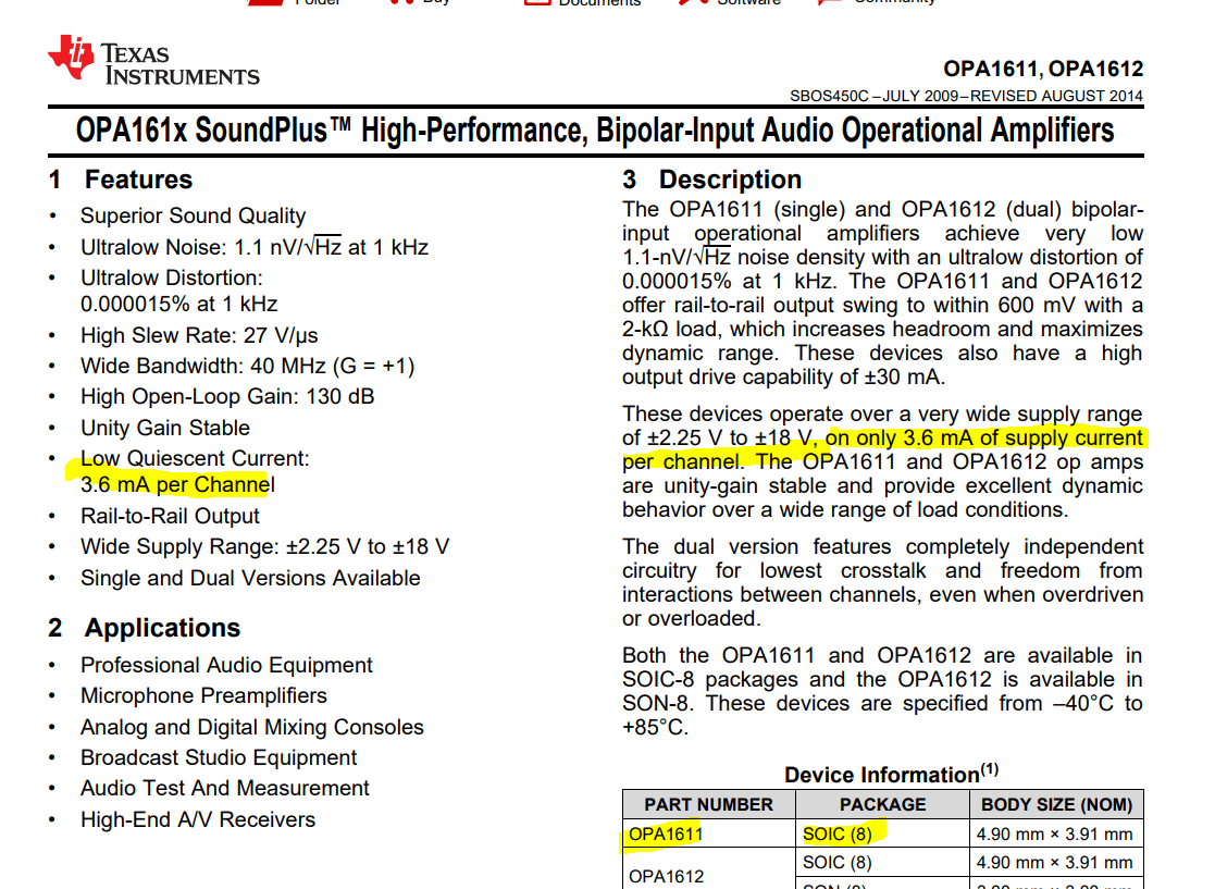

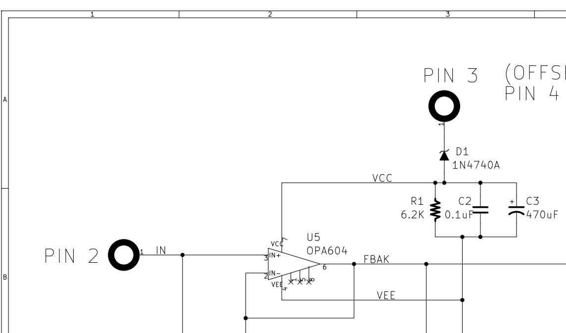

Quick question:
Tuscon daughter board, R1 (6.2k):
Well, I missed this on my order. My personal inventory has a 6.04 and a 6.8k. Close enough? I could also parallel other resistors I'm sure.
And my not-quite-there-yet circuit diagnosis skills wonder at the purpose of the R1 C2 C3 portion of the circuit. My guess is the capacitors for further smoothing/cleansing of VCC rail and R1 would keep the current of that filtering low. Am I even close?
In related news, I successfully (if my macro-macro phone camera's telling me the truth) drag-soldered my first SMD in U6 OPA1611. Not so bad. Had a practice SMD soldering kit I practiced on a lot first to get the hang of it.
The R1 resistor is there to ensure that D1 and D2 are fully turned on. It helps provide a stable voltage at the opamp supply pins.
Each diode drops 10V, so if the supply rails are 23V, there will be 26V across R1. Calculate the diode current from there. The quiescent current through the opamp should be small compared to this.
Thank you. I had to read it twice and give it a think, but am I getting it from the below?
Assumed VCC of 23V - 10V from the zener = 13VCC remaining
And VEE of 23 - 10 from zener D2 = 13VEE remaining
R1 straddling the VCC + VEE 26v / 6.2k = ~ 4.19mA? at pin 7 and 4
So a 6.8k R1, 26/6.8k = ~3.82 mA
or a 6.04k R1, 26/6.04k = ~4.30mA
Would I look to the Opamp's specs to see if these Iqs would be in an operating range?
Looking at the product spec sheet (OPA161X), it has a 3.6 mA Iq:
Would the 3.8mA iQ predicted assuming a 23V Rail be cutting it close?
I would probably opt for 6.04k for R1.
The job of C2 and C3 is to absorb current variations, and provide a steady voltage for the opamp.
The OPA1611 should be a good one. I tried the OPA604 in my Tuscon and didn't care for the sound. I have been intending to try others in its place, but am always busy with the next thing in other amps
Success last night. Which means my drag-soldering skill is sufficient. Huzzah!
Thank you @TungstenAudio for the educational guidance. I understand more now.

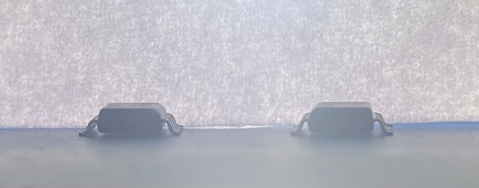

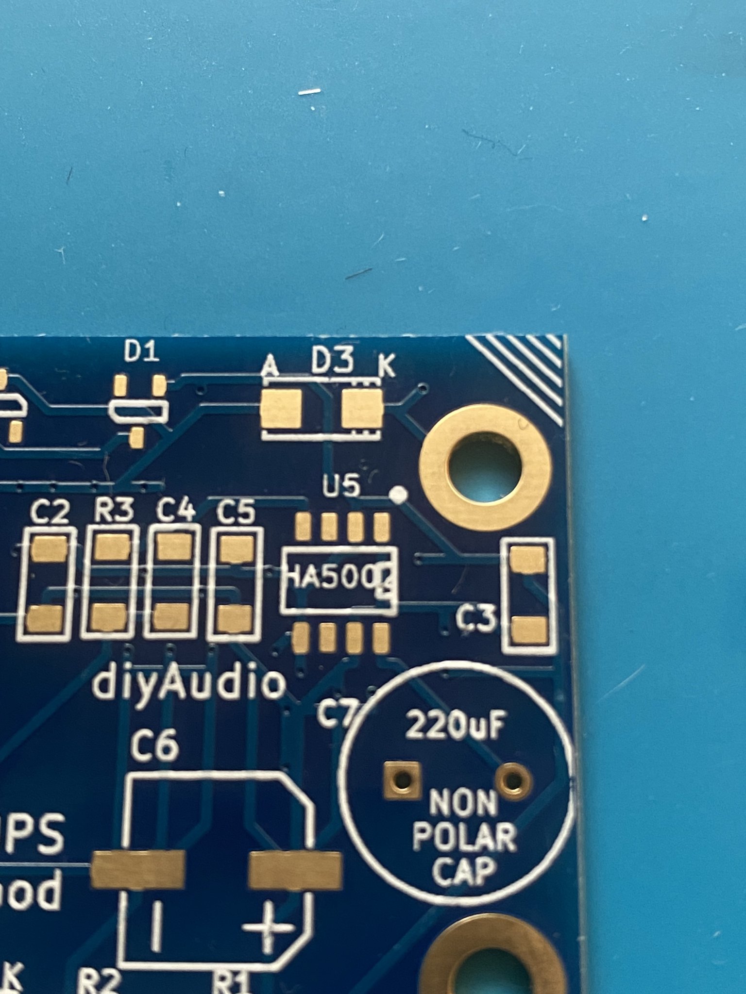

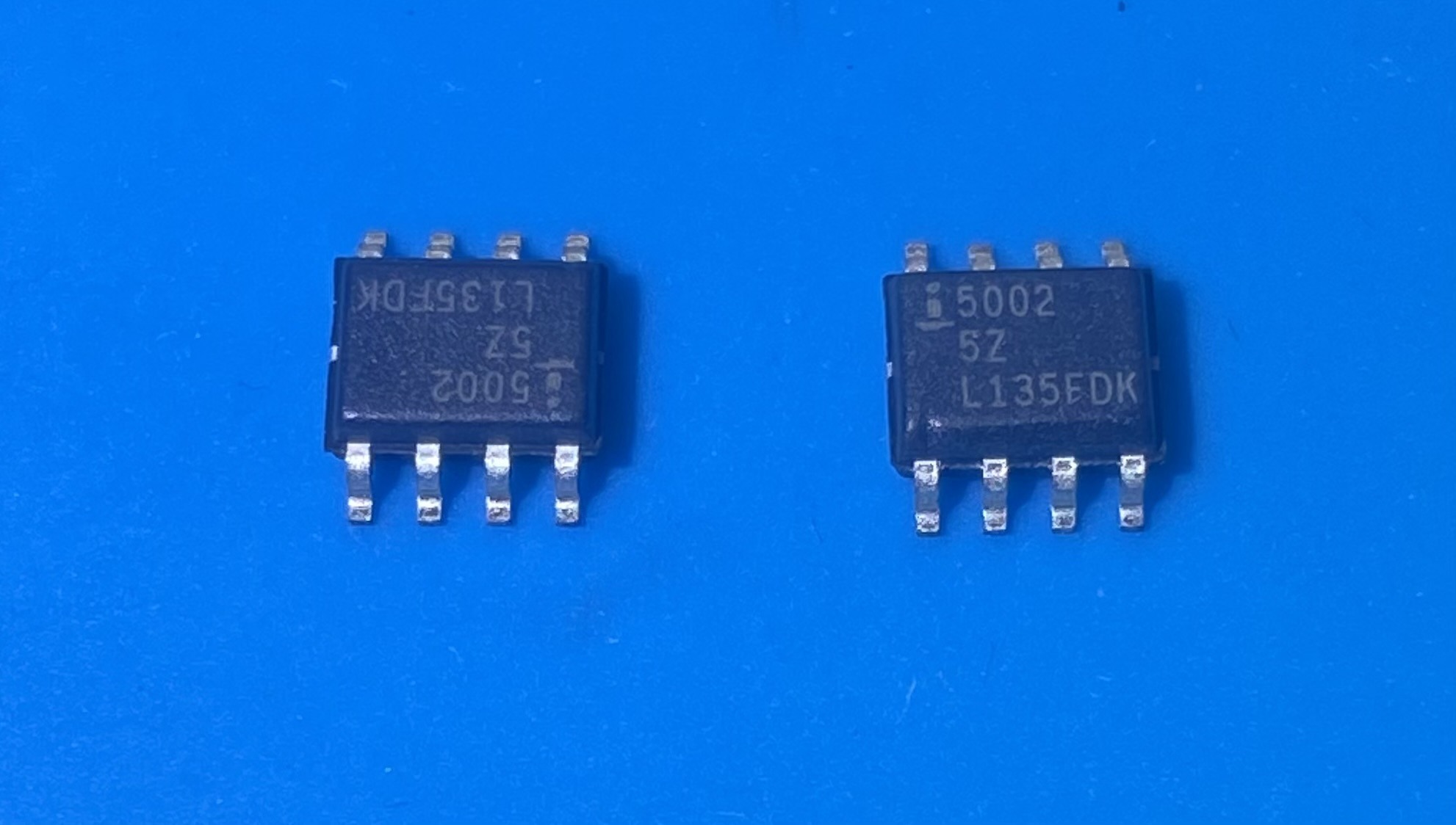

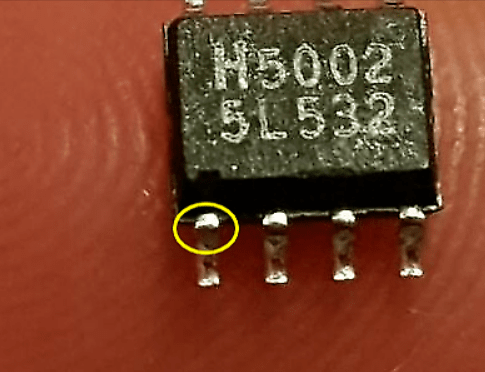

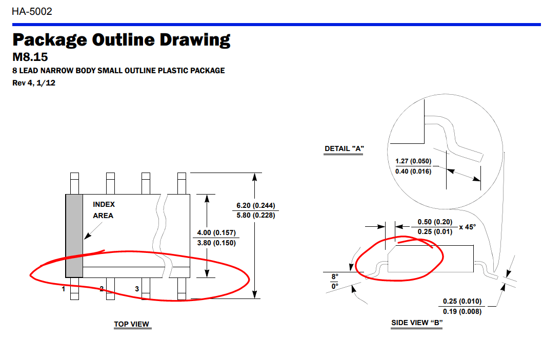

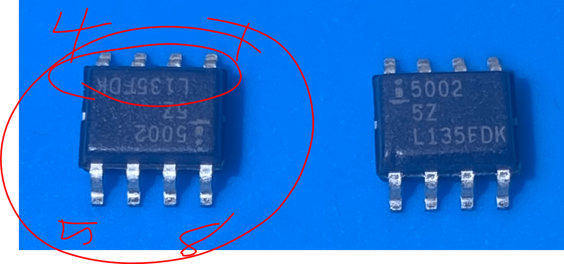

I need a little help with orientation of the HA 5002 on the board.
I can't tell which side of the actual chip is notched.
Which orientation (as pictured) would work with the board as pictured? Stencil on package right side up or upside down?
Thanks!
Thanks!
As best I can tell from the manufacturer's spec sheet:
The beveled edge from the side view above is this side when looking at it visually, but boy is it close when looking at the devices physically, even from the side. The orientation below would also support the theory that the "i" in front of 5002 is the "dot":
A picture taken from the perspective of side view B would help confirm. However, at first glance, your labeling looks correct. I don't have any on hand to review in person.
Man, it’s close. Even with the iPhone camera, which is almost an electron microscope in its own right.
But what looks like a slanted edge matches up with the spec sheet
From that view, it seems more clear to me...
Left unit - bevel on the right side.
Right unit - bevel on the left side.
When in doubt... beep it out. See the schematic in the spec sheet and run a few checks to confirm.
