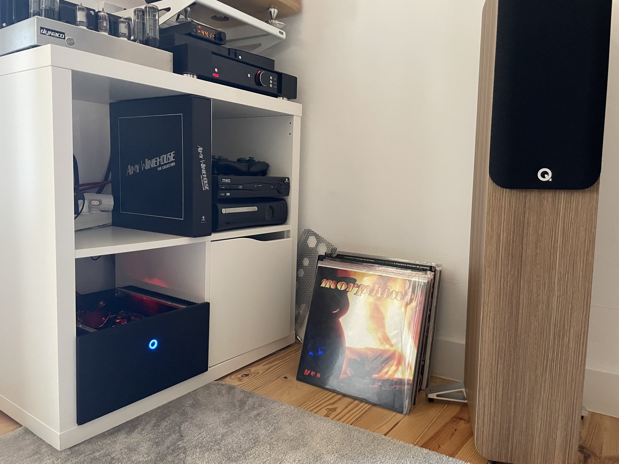

Great to hear that you are enjoying the music - at the end of the day, that is the most important thing. 🙂 The DIY M2 gets a lot of praise from happy builders, thanks to Mr. Pass for sharing the design with the DIY community! 6L6 has been a champion for DIY, and his build-guides act as reference for most of us. And MJ's coming up with the M2X has possibly resulted in a lot more people going for the build, and actually building this amp.
If you don't mind, can you share some more details about your system - source, preamp, speakers?
I have a modest set-up in a small office (10’x13’). Desktop PC usually running Spotify premium, with optical output to an Outlaw 975 pre-amp, with analog outputs to the M2x, playing my own DIY SB Acoustics 2-way creation (5” woofer, 1” dome tweeter), sometimes supplemented with DIY 10” ported sub.If you don't mind, can you share some more details about your system - source, preamp, speakers?

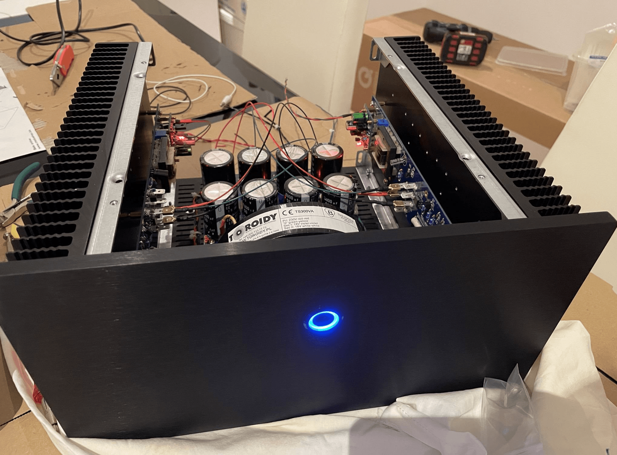

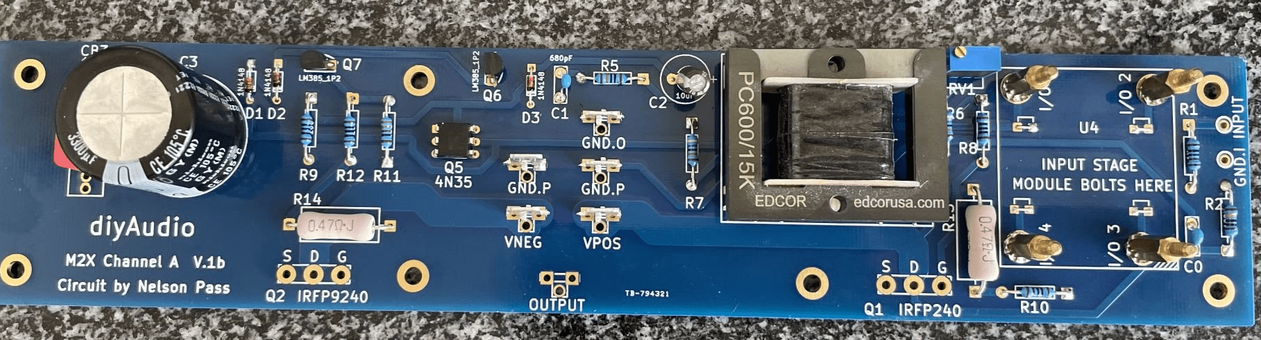

New member here (although registered a long time ago), although this thread already has a lot of information, I'm sharing my build experience from someone who doesn't have a lot of experience in electronics.
My last build was a Dynaco ST70 tube amp back in 2015
Planning:
1. Study the project, the schematic and the BOM for each PCB, take your time, I took three weeks in this process constantly reviewing my Mouser shopping cart and replacing/removing/adding parts; (read all the posts on this thread and you'll be able to anticipate and avoid a lot of issues on what parts to use and how to solder and wire things)
2. Choose a chassis for your build.
3. In your planning include also the bits and pieces needed to assemble the pcb's to the chassis, cables, switchs, jacks, tabs, screws, etc...
(aliexpress is a good source for this small hardware bits and pieces
4. Order everything
Assembling:

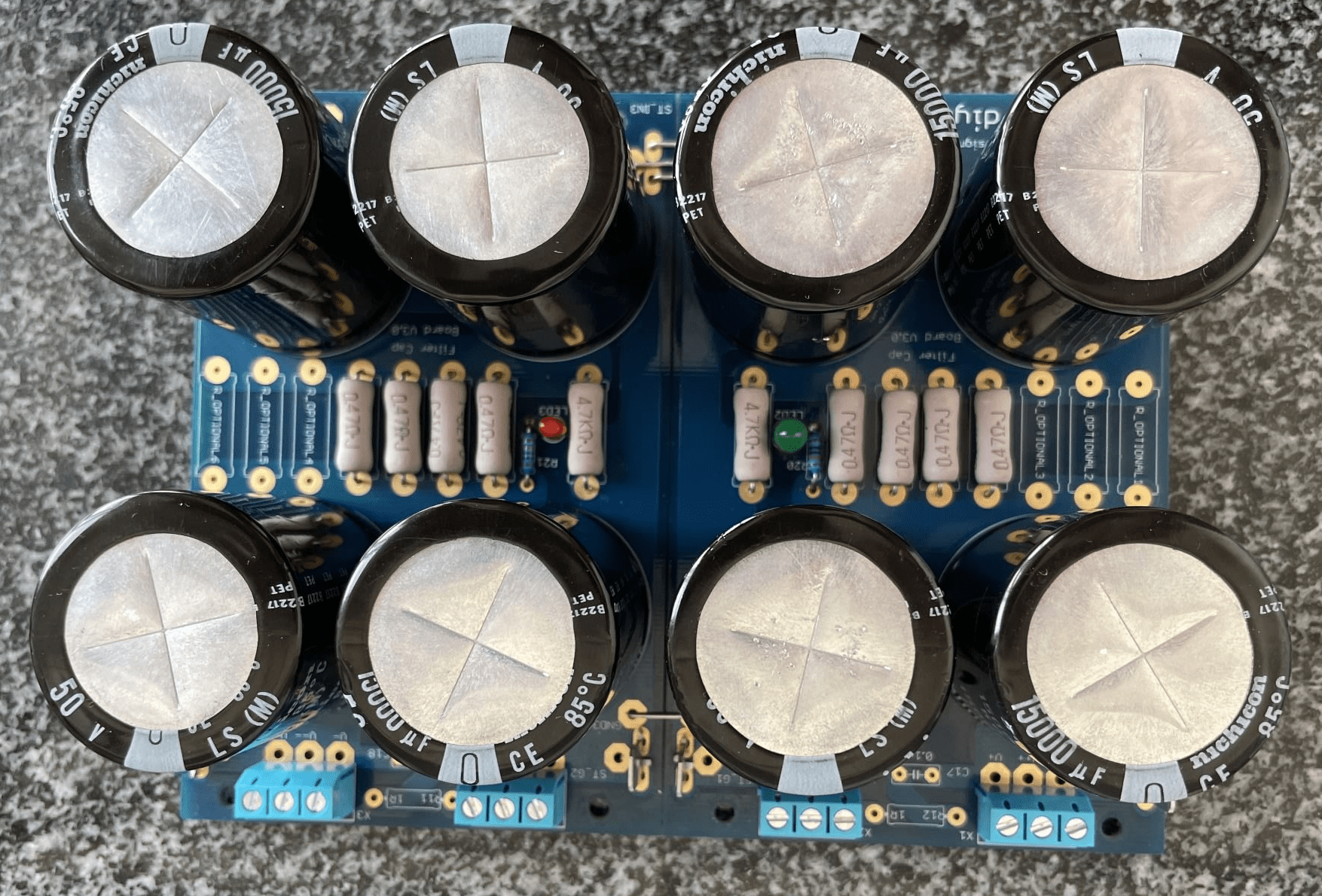

1. Be methodical, measure every component before soldering, make sure you're soldering the correct component on the correct place and with the correct orientation (polar capacitors and transistors)
DO NOT ASSEMBLE IRFP240 and IRFP9240 at this stage
After the boards are complete (minus IRFPs), clear solder flux with isopropil alcohol and a toothbrush.
2. Take photos, the ones I share below helped me identify that I missed some connecting tabs and also check resistor color codes when testing:

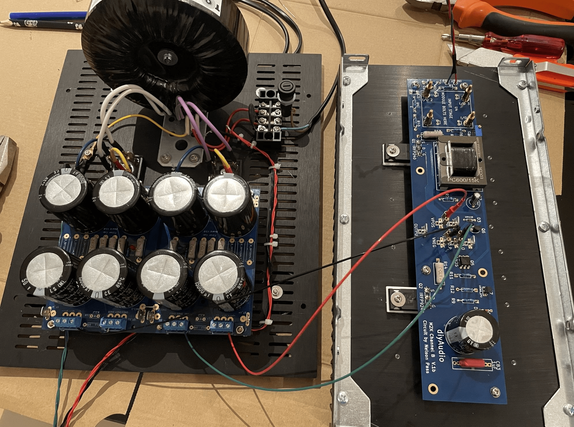

2. I ordered a Mini Dissipante 4U300 with pre drilled holes, it only has 240mmx300mm useful space inside, not much space to work after every parts are assembled,
3. Plan your chassis layout for the bottom plate and do all the drilling beforehand, plan the cable routes, attach the mounting tabs, etc... this is the order I did things:
a. Power switch clearance (mine is front mounted)
b. Transformer;
c. Rectifier bridges:
d. PSU Board;
e. Junction tab
f. Wiring and grounding scheme
3. Assembled transformer, rectifier bridges (I used thermal paste between the bridge and the bottom plate, works quite good), psu pcb and junction tab, connect trafo to bridges and bridges to psu, prepared all the primary connections (CL60, .0033 cap) on the junction tab.
4. PSU test OK, 25.3V unloaded.

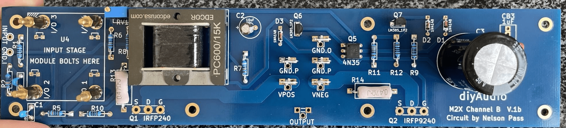

5. Amp Boards assembly: start by assembling the IRFP240 and 9240 to heatsinks, I used AAVID 4180G thermal pads and Genesis Silicon 851 thermal paste, I applied paste between tab and heatsink and between IRFP and tab. Attach firmly to heatsink and use your DVM to make sure there's no continuity between each leg and the mounting screw.
6. Attach the Amp Boards and solder the IRFPs from above. Make sure everything is OK, you want to avoid removing the IRFPs from now on.
Now let's to do some smoke tests:
1. Insert your choosen output board;
2 Shunt the input with input ground;
3. Connect V+, V- and ground to PSU;
4. Breed in, breed out and connect your trafo to mains (make sure you use a fuse in case something goes wrong)
Test one side, if no smoke and everything measures OK, disconnect and test other side.
Key points to measure:
1. V+/V- when loaded are around +- 23/24V
2. V on R13 and R14 is around 610mV, monitor this value when connecting, if it rises way above this value, turn off immediately.
3. Check DC offset and try to get it to 0V by turning Rv1 one side or another.
In my case everything went fine, did 30m smoke test on each side with no major issue, the only issue I have so far is I cannot set DC offset to 0V.
After some inspection I found the culprit, I went for R6/Rv1 combination of 37K/20k but mistakenly soldered 47K instead of 37K
(I failed miserably my recommendations 1 and 6 above)
To avoid removing the Amp Boards and IRFPs from the heatsink I soldered a 100k resistor in paralell with R6 (47k) all of this from above, this gave me around 32k on R6 which was enough to allow the DC offset to be set to 0V
Now that everything is tested, on the next few days, I'll put the chassis together and finish all the connections.

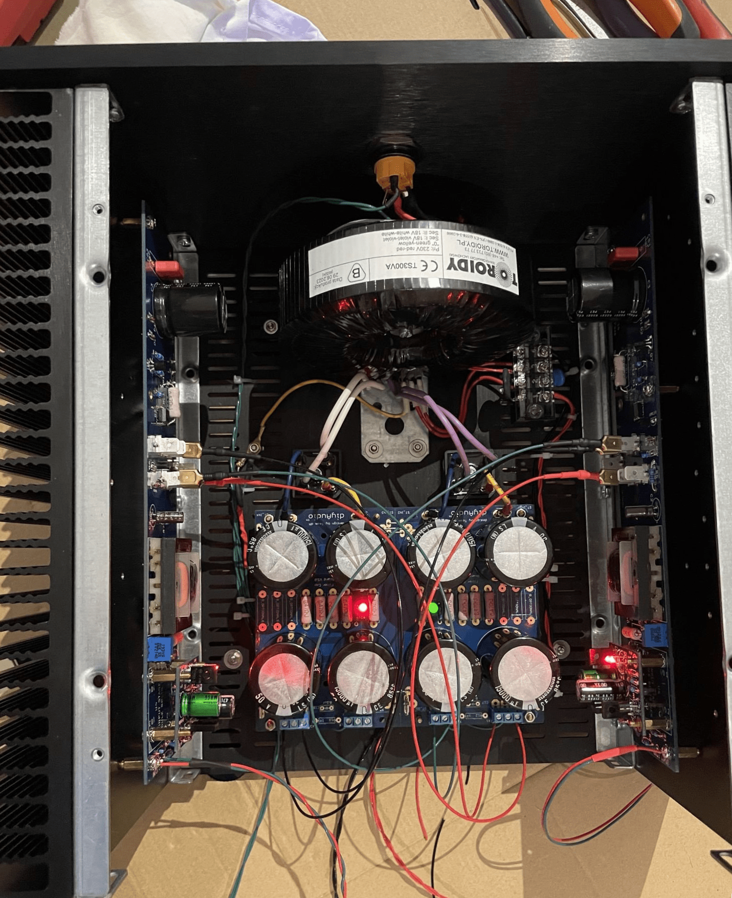

^ Some fantastic stuff! Thanks for sharing your experience.
Not second guessing ... b/c it sounds like you've read everything and made informed choices.
With that said, I'm not saying you will experience hum, but consider the relationship / proximity of the signal transformers (the Edcors) to your power transformer (the Toroidy).
Many people choose to put their power transformer at the front of the chassis to assist.
Maybe I've misinterpreted your layout... that's also been known to happen. 🙂
Either way... lovely, just lovely!
Congratulations and enjoy the tunes!
Edited to add - you specifically call out that your power switch is front mounted... yep... I misinterpreted by only looking at the picture. See... LOL! 🙂

hehe, That's correct, the transformer is front mounted, the fact that the heatsink on the right side is on the wrong side (for testing purposes) might be what caused the confusion.
I left some space between the transformer and the rectifiers so that I can use a transformer cover in case of HUM.

Yesterday evening assembled front, heatsinks and bottom plate and did another 1h smoke test.
My notes:
1st attached heatsinks to front plate
2nd attached bottom plate to heatsinks
3rd did the internal wiring
After 1h on, re-measured bias and it was stable around 1 or 2mV, heatwise, the heatsinks get really hot but I'm able to keep my hand on the fins for quite sometime, need to get a thermometer to check temps.
