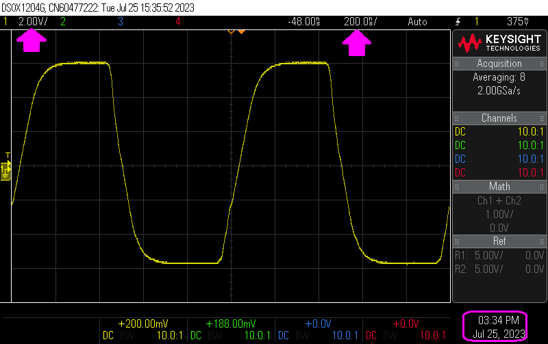

Joined 2011

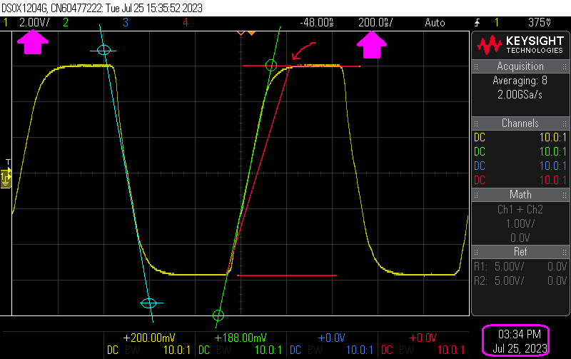

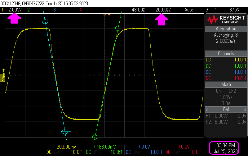

Operating my little daughter card test harness kludge at plus-and-minus 23 volts supply rails. This test comfortably exceeds the Edcor + M2x OPS requirements.
For jollies, measure the slew rate on the photo.

Hi
Slew rate is Voltage change per second.
Voltage: 6divisions from V- to V+, at 2V/div (if i understand correctly the legend)
Time: 1.25division to go from V- to V+, at 200nano sec /div
Slew rate = (6*2)/(1.25*200*10^(-9)) = 48 000 000 Volt/sec roughly...?
(first time doing this, hoping there is not something i misunderstood, so good opportunity to learn from feedback)
Slew rate is customarily answered in Volts/microsecond. So if you did your calculations correctly (it appears so), then the answer would be about 48V/microsecond.
So happy that MJ has a Keysight scope!
By chance, is that a 1Mhz test signal? Frequency = 1/T; where T = 5 period divisions on your scope picture for one full square wave, and each period is 200 nanoseconds.
Best,
Anand.
Joined 2011
Blue delta_Y = 7.2 vertical divisions = 14.4 volts
Blue delta_X = 1.0 horizontal divisions = 200 nsec
Blue slope = delta_Y / delta_X = ________________ volts per microsecond
Green delta_Y = 7.0 vertical divisions = 14.0 volts
Green delta_X = 1.2 horizontal divisions = 240 nsec
Green slope = delta_Y / delta_X = ________________ volts per microsecond
Higher than the slew rate of an OPA1611, the recommended SMD opamp for the M2x Tucson input card.

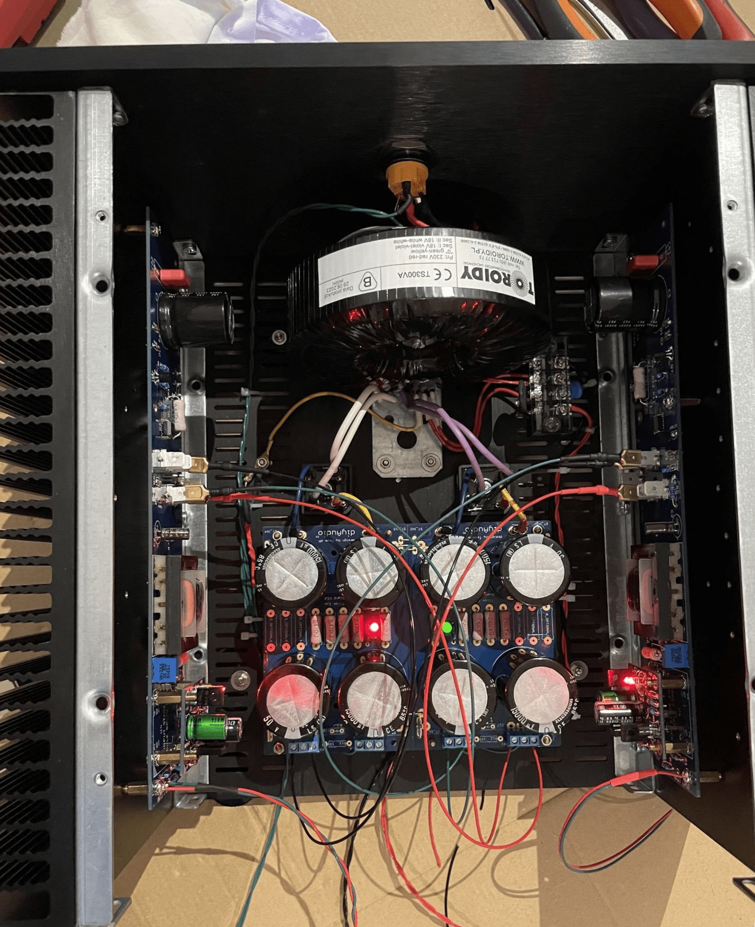

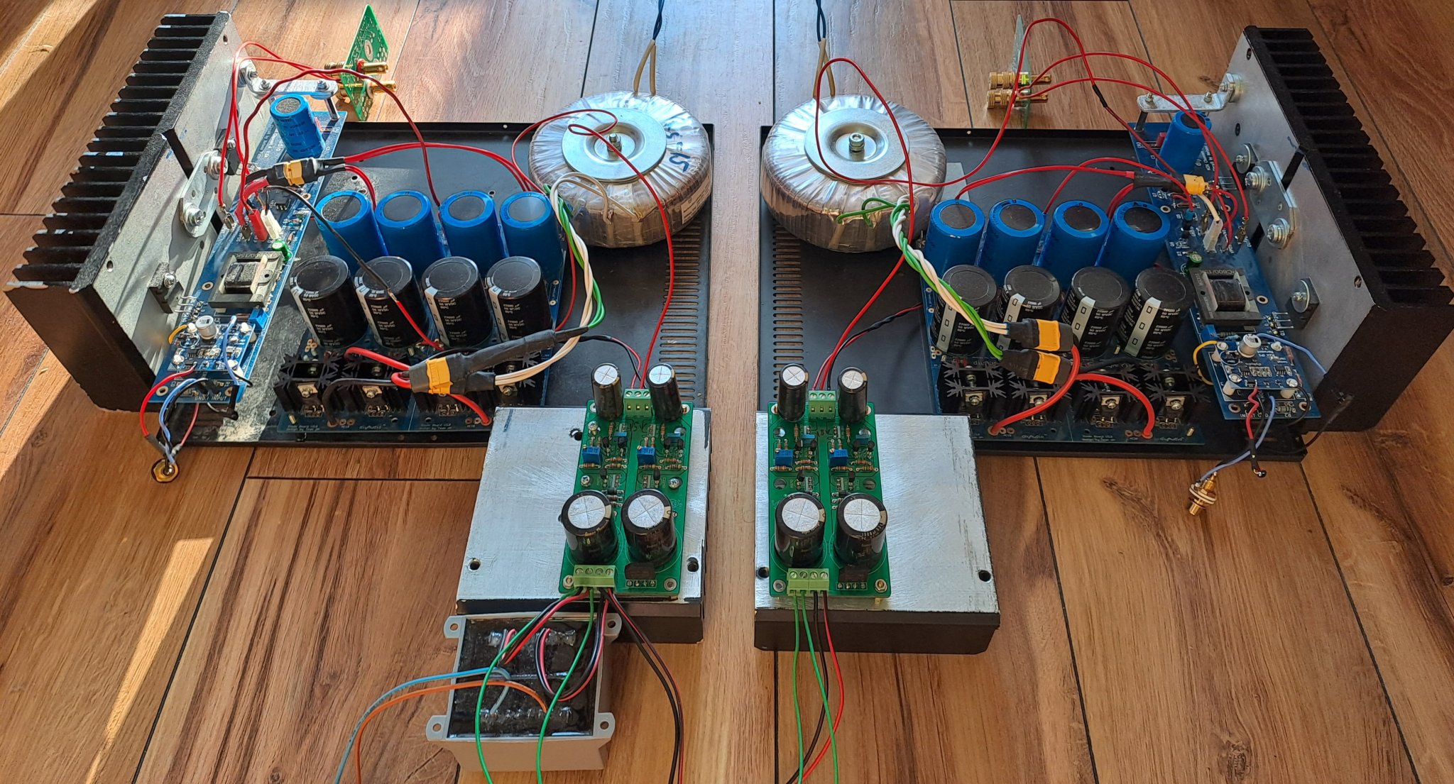

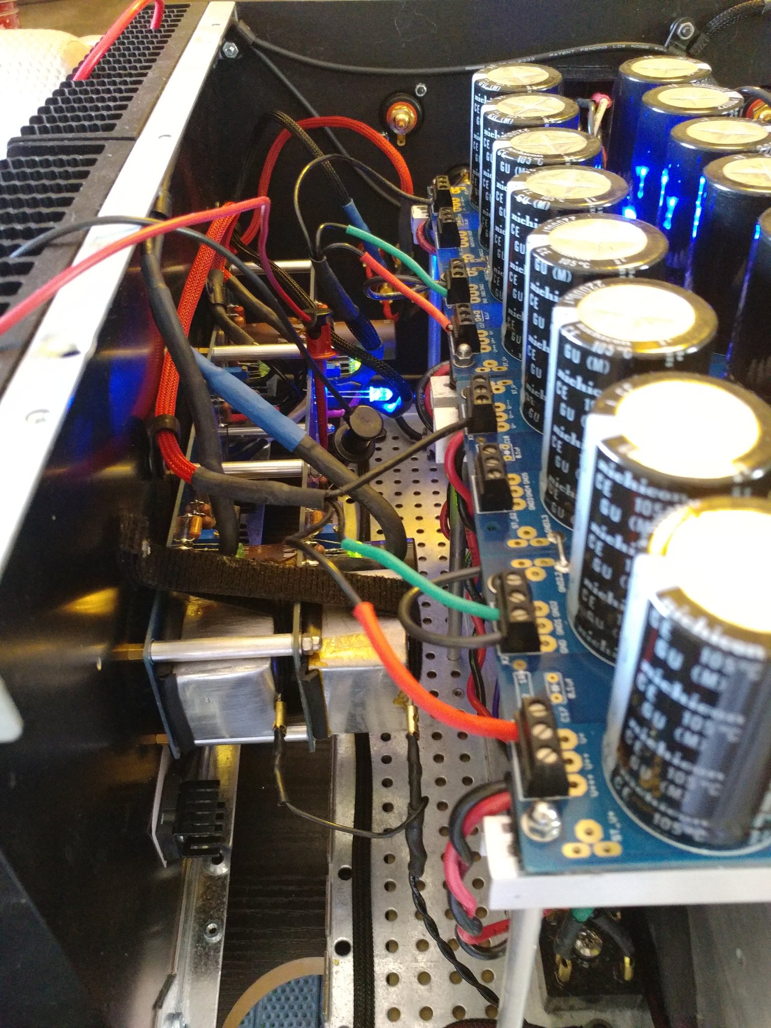

First of all, I would like to thank Nelson Pass for publishing M2 , and Mark Johnson for the daughter cards and useful advice.
My own M2x is almost finished, just some minor mechanical work to do.
Parameters per channel:
Monoblock design
300VA toroidal transformer
2x24V DC
128000 uF (4x22k-R-4x10k)
1.7A bias current
2SK1530/2SJ201 Mosfet transistors
Norwood daughterboard
Specials, sound quality tunning
1. Separate transormator per channel and dual stabilized power supply for Norwood daughterboard (clear sound quality improvement compared to normal power supply)
2. Dual power supply (ebay - quality of capacitors questionable)
Changed the capacitors to Nichicon KG S.T. and Muse and the difference was even more impressive.
3. Omitting Zener diodes
Thevoltage of the stabilized power supply (+/-15V) is sufficient to feed the Norwood directly, I skipped the Zener diodes. This change did not result in any improvement or I did not hear any improvement.
4. Norwood C7 220uF Nichicon bipolar capacitor
Their crossover is also positive and audible in my opinion.
I've been listening for about 1 month now, but I like it so much that it's finally worth it to replace my old speaker with a more serious piece (Audio Solutions Figaro B). My hi-fi chain has been taken to the next level (source Ian Canada Q3+Reclock, dual DAC, LL I/V, Uc + Salas-L and batteries).
I attach some pics, here is still using to rail Norwood only one transformer, but it's too big, won't fit in the box, will be replaced with low profile and lower power.
I still want to bypass the Nichicon capacitor on the M2 main panel with another better quality bypass capacitor.
Interesting fact:
I tried powering the Norwood with LiFePo 26650 batteries (3-3) Crystal clear..., of course not usable in practice.
Reactions: 1 users

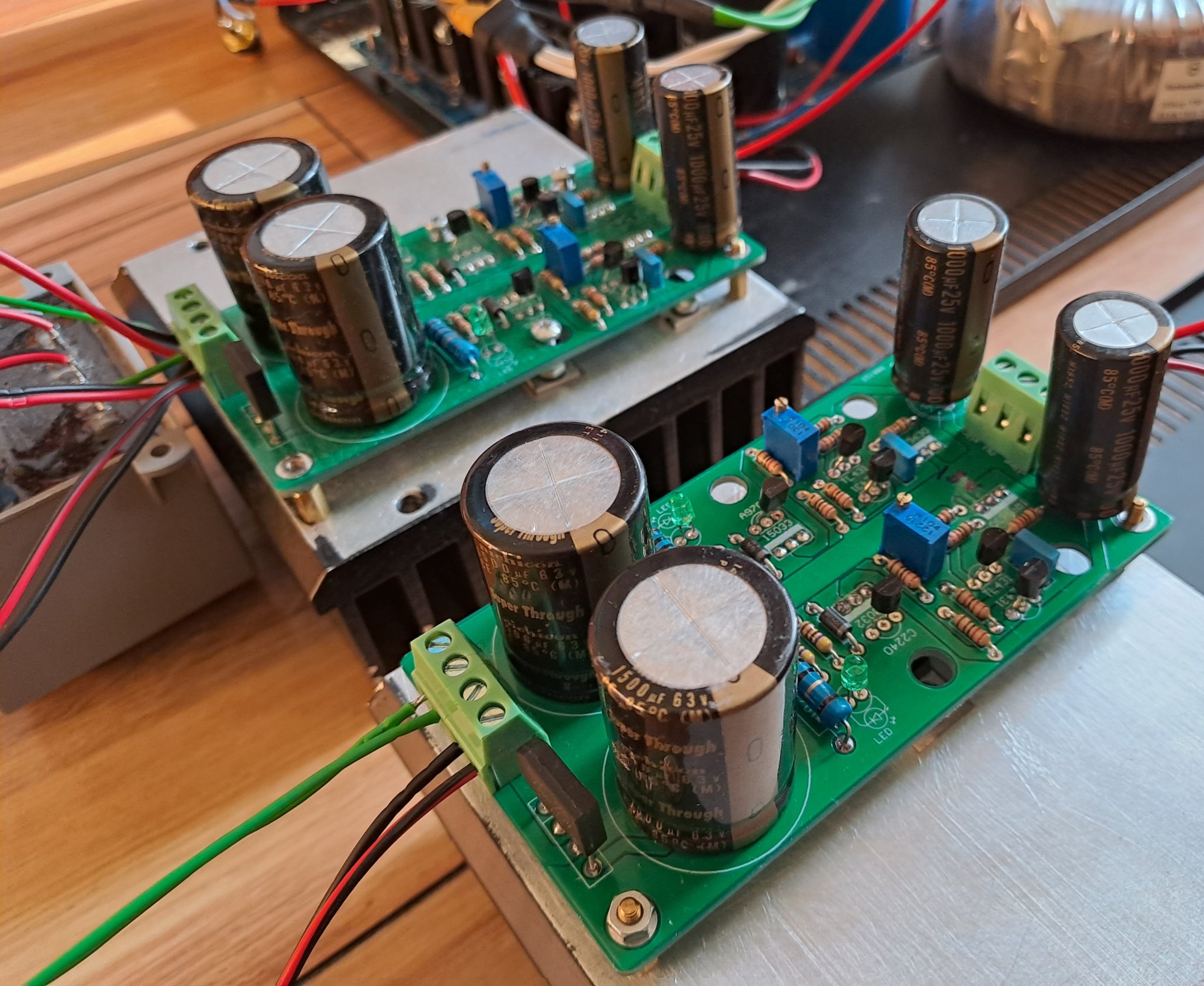

Joined 2011

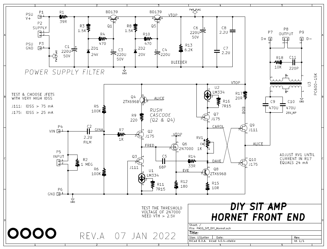

Perhaps even better than a dedicated power supply to feed both channels' front end cards, is to install a dedicated voltage regulator (or two voltage regulators in series!) on each front end card. Now the front ends are isolated from main amp channel power supply noise, and they are also isolated from each other.
Most M2x daughter cards don't have enough room for this (but see "IPS7" for an exception). However Lottery-VFET and Ship Of Theseus front end cards allow abundant space for on-card supply regulation and filtering. Check out "Dreadnought" in the diyAudio Store. And here are two more examples from the Ship Of Theseus. Have your circuit designer friends put one of them or both of them into a simulator and measure the power supply rejection ratio. Cowabunga.

"48V/microsecond" yes and i was in fact going from an "average slope" (=not the slew rate def) to go from V- to V+ (red lines on the attached image)
Whereas the real best instantaneous slope = slew rate are depicted by MJ
Blue slope = 72 volts per microsecond
Green slope = 58.3 volts per microsecond
Thanks for the little homework
Having built my M2x with two different power supplies, I can definitely say it sounds better with separate supplies for each channel. In its current form, each channel has a separate 250VA transformer feeding a PSU with synchronous rectification and a CLC filter. There is still a small amount of 120 Hz hum that is noticeable with my ears close to the speaker. This seems to be magnetic coupling between the power transformer and the Edcor signal transformer. Nevertheless an improvement over a single 400VA transformer enclosed in a matching steel case from Antek feeding both channels.
Once each channel is fed from a separate PSU, the next question is whether to build a shield for the Edcor, to employ extra filtration / regulation for the input signal buffer, or maybe both. We should probably note that FirstWatt built M2 amplifiers include shielding for the Edcor transformers.
For my part, I am inclined to try some shielding, then maybe a variation of one of the opamp input stages (inherently high PSRR). Then look at ways of adding capacitor supply filtration near the input stage.
Reactions: 1 user
