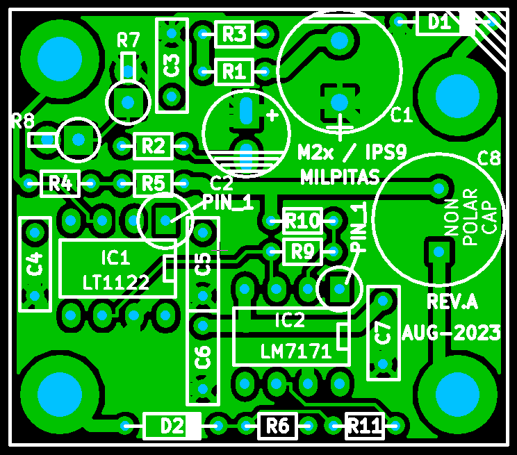

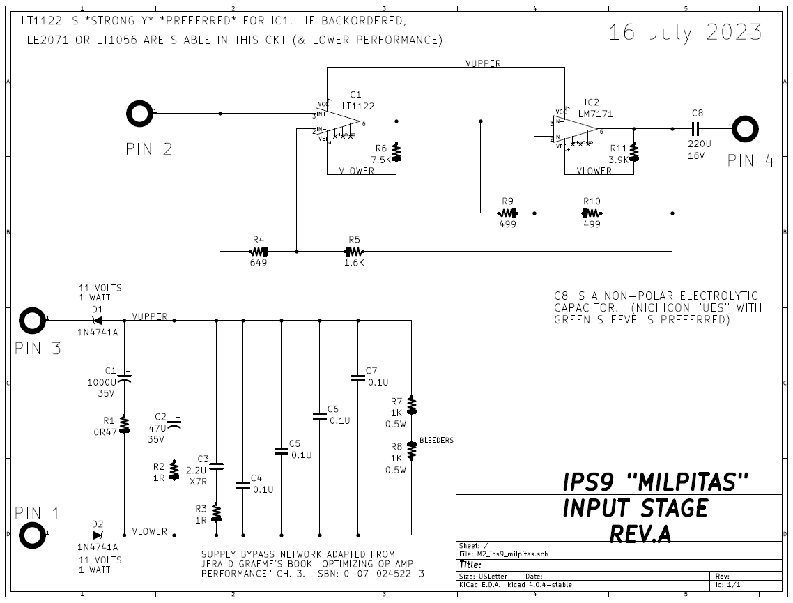

THE MILPITAS INPUT STAGE FOR M2x

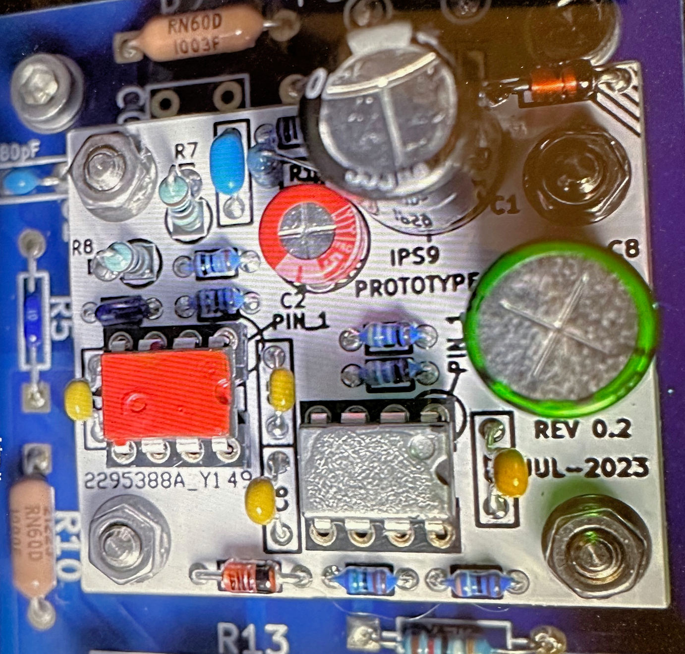

It's a delight to present the newest member of the M2x InPut Stage daughter card family: MILPITAS. This is my ninth diyAudio IPS card, so its alt-name would be "IPS9". The principal semiconductor device on the board is made by Linear Technology's fab in Milpitas, California.
Milpitas is a thru-hole-only upgrade of the Norwood card that ships in the M2x board set from the diyAudio Store. Milpitas intentionally uses readily available, on-the-shelf-today ICs, arranged in the same general topology/architecture as Norwood. Unfortunately the Norwood chips are on 45 week backorder at the moment.
Both Norwood and Milpitas are composite amplifiers, having two individual amplifiers enclosed within the same global negative feedback loop. Composite amplifiers are notoriously prone to oscillation; to avoid this, designers must carefully tailor the frequency response of each individual amp in the composite pair. Thus "Opamp rolling" within a composite amplifier is certainly not a good idea, as it will lead to degraded stability or oscillation. That's very bad for your tweeters.
The Milpitas circuit includes capacitors for power supply bypass (C1-C7) and for AC coupling (C8). But it has no capacitors for frequency compensation. No "Miller" capacitors, no "Lag" capacitors, no "Pole Zero" capacitors, none. Instead, the individual opamps within the composite are carefully selected for complementary frequency responses, reducing phase lag around the entire NFB loop at all frequencies below the gain crossover. The topology looks a bit unusual, and appears in very few textbooks, but it works well in practice. See the scope photo in post # 6424-6428 of this thread for more.
CONSTRUCTION NOTES
Milpitas uses 1/6 Watt resistors everywhere except R1, R7, and R8. 1/6 Watt parts are significantly smaller and make PCB layouts more compact. However, R7 and R8 dissipate plenty of heat, so 1/6 watt resistors aren't beefy enough for those. But what about R1? R1 dissipates ZERO power: why 1/4 Watt? The pedestrian answer is, Mouser doesn't carry any 1/6 Watt resistors with values below 1 ohm. So we buy a 1/4 watt resistor for R1 and mount it vertically.
BTW you really want a Mega328 Component Tester or a good quality digital multimeter when you're building Milpitas, so you can measure each resistor's value before stuffing and soldering. Attempting to read the color codes on 1/6 Watt resistors will drive you nuts.
The Detailed Parts List attached below, includes a line-item for DIP sockets. I struggled with this; the circuit works better when the DIPs are soldered directly into the PCB with no socket. And DIP sockets may encourage misguided builders to attempt opamp-rolling, which would be disastrous. On the other hand, sockets allow builders to easily remove the not-inexpensive chips from a failed or mis-assembled Milpitas board, and use them again in another attempt. So, with reservations, I included socket part-numbers on the Parts List. But I hope you don't use them. (Full disclosure: I did install sockets on the IPS9 prototype boards sent out to reviewers for listening evaluation. This was merely conservatism: if IPS9 sounds great WITH sockets and all of the parasitics they introduce, it will definitely sound great without sockets).
I suggest you take photographs of your bare PCBs before you start assembly. Then as you install components and they begin to obscure the text on the PCB silkscreen, you can view your photos to remind yourself: what goes where, which is the "+" terminal, etc.

Three pairs of IPS9/Milpitas boards were sent out to volunteer reviewers, three weeks ago. Each reviewer installed the boards into their M2x amplifiers and noted the strengths and weaknesses of the new input stage. Overall their evaluations were enthusiastic, and I've encouraged those reviewers to post their written reviews here in this M2x thread, if they are comfortable doing so. My executive summary of the three reviews is: 3X two thumbs up, overall average score was 1.3 where 1.0 is best-possible score and 9.0 is worst-possible score. "1" means best sounding of all M2x input cards and "9" means worst sounding of all M2x input cards.
However, M2x is a platform for experimentation which allows each builder to form their own opinions, uninfluenced by other people. Others have their own preferences, and you have yours. Try some IPS cards and listen for yourself, you may violently agree or violently disagree with what other M2x owners have to say. Don't let anyone talk you out of listening to whatever pleases YOU the most.

BUILDING SOME MILPITAS INPUT STAGE CARDS OF YOUR OWN
The PCB Gerber files for board fab are attached below. I recommend you use the price quotation service www.pcbshopper.com to get an idea of PCB cost, for your ship-to address in your country. Milpitas is 40x35mm, two layers, and I suggest you get quotes for 11 business days shipping, as that seems to be the sweet spot of price versus delivery delay. Then you can refine the quotes after getting initial ballpark estimates, to see how much extra you must pay to get faster shipping. Or to see how much you can save by accepting an extra week of delay.
Also attached is a Detailed Parts List showing what's important and what's not important, when you select parts for Milpitas. This includes recommended part numbers from Mouser.com. I also recommend you train yourself to use the super handy website www.octopart.com to check prices and available-stock-on-the-shelf at dozens of distributors, all at once. You can see who has the lowest price, who has the biggest stockpile, and who offers the best discounts for purchasing in quantity. You'll love octopart.

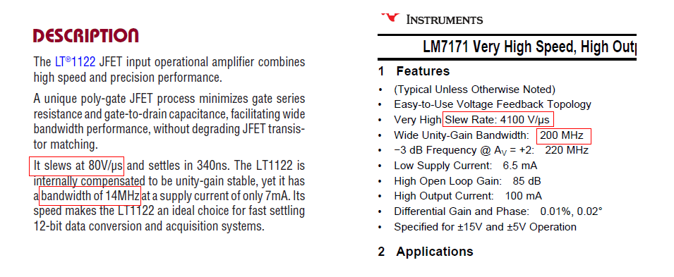

If you do build Milpitas cards and install them in your M2x, you'll be listening thru 200 Megahertz opamps (!). Not unity gain buffer chips; opamps. 200 MHz opamps. Almost certainly, none of your audio buddies can make the same claim. You'll have bragging rights.

Four Thousand One Hundred Volts per Microsecond slew rate??
