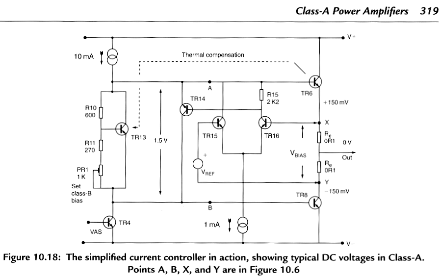

... what ties it all together in the end, is this which Nelson invented ~35 years ago while at Threshold {US Patent 4,752,745}
To be fair, Douglas Self published a similar but non-infringing autobias design in May 1995, within his Trimodal Amplifier project. Self's circuit eliminates the huge variability of optoisolator Vfwd and Current Transfer Ratio, however it does occupy more area on the PCB.
(notice that he drew TR8 incorrectly! Oh Doug...)

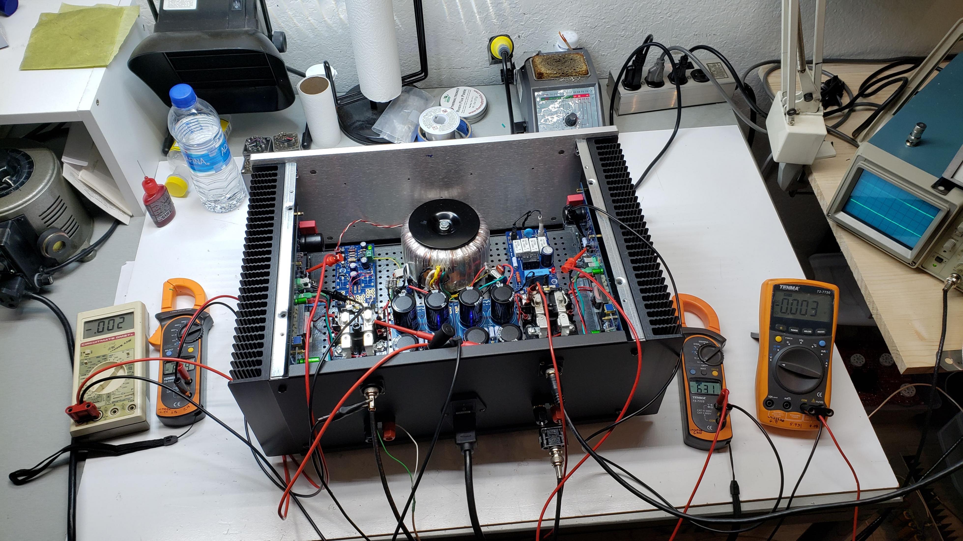

@Eslheadphone - my amp progression is similar to yours: tube, ACA stereo then dual mono, now Aleph J. Just ordered M2x boards and bits, Ishikawa will be first up with Toshiba Jfets. Question: what are the boards residing between your power supplies and amp boards? Thanks in advance! Jim
https://www.diyaudio.com/community/attachments/20210401_132530-jpg.942485/

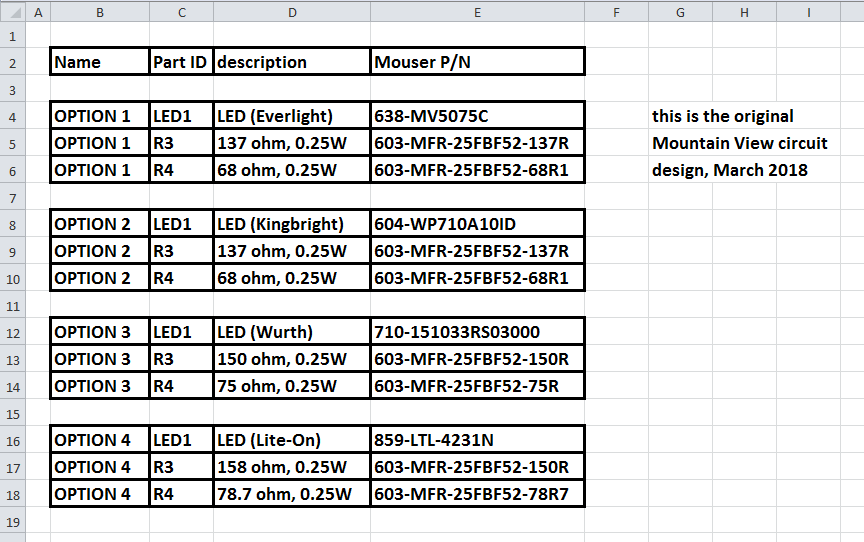

Ahem. Some people may not automatically and reflexively read post #1 of a thread when they have a concern or a doubt about part numbers, substitutions, alternate sources, and so on. Let me quote post #1 of this thread, the one you're reading now, and underline a section which might be useful in today's context. Feel free to double check post #1 yourself to verify that this is an actual quotation and not some kind of malarkey shenanigans, fabricated by me to deceive or mislead members.
MOUNTAIN_VIEW uses single-ended, class A, discrete circuitry and no feedback. If you are a big believer in single ended class A, if you love this quote from a famous article by Nelson Pass: "For reproducing music as naturally as possible, push-pull operation is not the best approach. Air is not symmetric and does not have a push-pull characteristic. ... Only one linear circuit topology delivers the appropriate characteristic, and that is the single-ended amplifier. Single ended amplification only comes in pure class A," then you probably are interested in listening to the Mountain View input stage. Parts note: please see post #3318 in this thread if you're having trouble finding a few MV5075C LED parts. That post suggests alternatives.
One board is the soft start and the other is the speaker protector, both available from the diy store. Those monster relays are part of the speaker protector. Tyco prd-11dy0-24. The relays came from allelectronics.com who unfortunately announced a going out of business sale. I will miss them.

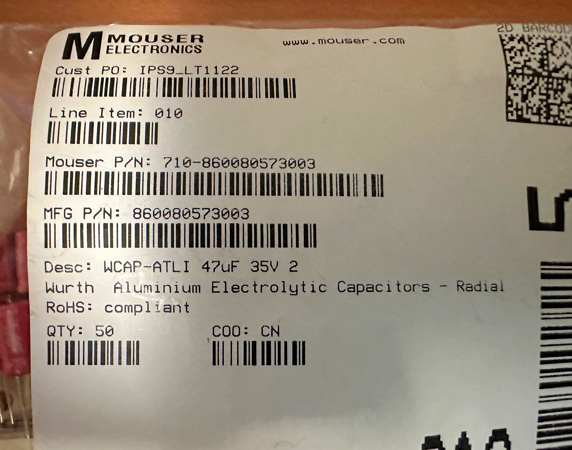

An eagle-eyed builder has spotted two mistakes in the Detailed Parts List (.xls file) for the new Milpitas / IPS9 daughter card.
1. The smaller electrolytic capacitor's part number was wrong! The correct part is shown in the photo below. 47uF / 35V / 6.3mm case diameter / Mouser 710-860080573003 . See whether you can decode the purchase order number
2. The optional-and-I-hope-you-don't-use-it DIP8 socket part number was severely incorrect. One of the appropriate Mouser parts is number 437-1108730841001101 although you could buy a bag of 50 or 100 milled-pin DIP8 sockets on eBay or Amazon for not much money at all. Mouser's sales page for the above part, has unfortunately attached an incorrect photo but if you click on the Datasheet link you'll see the socket itself is correct.
Here are some nice gold DIP-8 sockets for $0.25 each (ebay link) -- if you trust eBay
Sorry for the errors! --MJ
