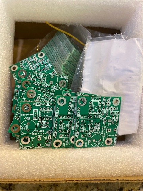

@Mark Johnson first would like to recognize you With Gratitude for Milpitas. Sequiturs for me include working there in Silicon Valley for a medical imaging company in the 90's (nuclear medicine gamma cameras with vacuum tubes in the detectors 3D SPECT image processing via Sun Micro 32 bit RISC computers)
Purpose of this post is a slight potential additional correction to the BOM xls file. Seems to me qty in Row 7 should be 2 not 1:
Also thank you Audiobear in advance for the boards.

@JKiriakis
Great catch, sharp eyes! I probably didn't notice that because I always buy 10, 25, or 100 when I buy inexpensive resistors. It made me chuckle to buy 25 499 ohm 1% resistors when I have a bunch of 500 ohm 1% resistors of the exact same brand and series.According to DHL tracking the boards are in Portland, OR since yesterday. Now we'll see how long it takes to get them across the river to Vancouver,WA. I hope they aren't using "Smart-p-o-s-t" (the reason I wrote it that way is that the spell-checker changes what I type to smartest which it definitely is not).
Nice catch! Yes you need two 499 ohm resistors, so you can populate both R9 and R10.
I checked the EIA standard component value tables (link) and "500" is not listed as a standard value in any of their series, not even the E192 (which has 192 values per decade). The E192 standard values include ... 475 481 487 493 499 505 511 517 523 ... but not 500.
You are correct! What I have labeled as 500 are 1/4watt 500K Yageo resistors (MFR-25FTF52-500K). Great reason to check the value of every component before stuffing it in a board.

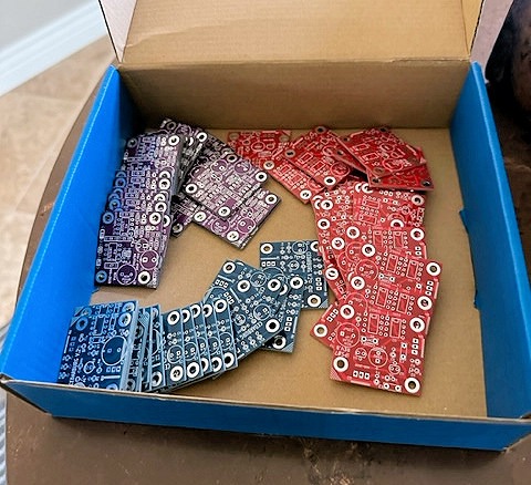

they arrived and are nice looking. IPS7 are red, IPS8 are blue, IPS9 are purple.
_
... I bought 20 IPS7 boards, plus 20 Cedarburg (IPS8) boards, plus 20 Milpitas (IPS9) boards, in various not-green colors of the rainbow ... I like to always keep a supply on hand because I enjoy sending out M2x IPS boards as little thank-you gifts when someone does me a big favor.

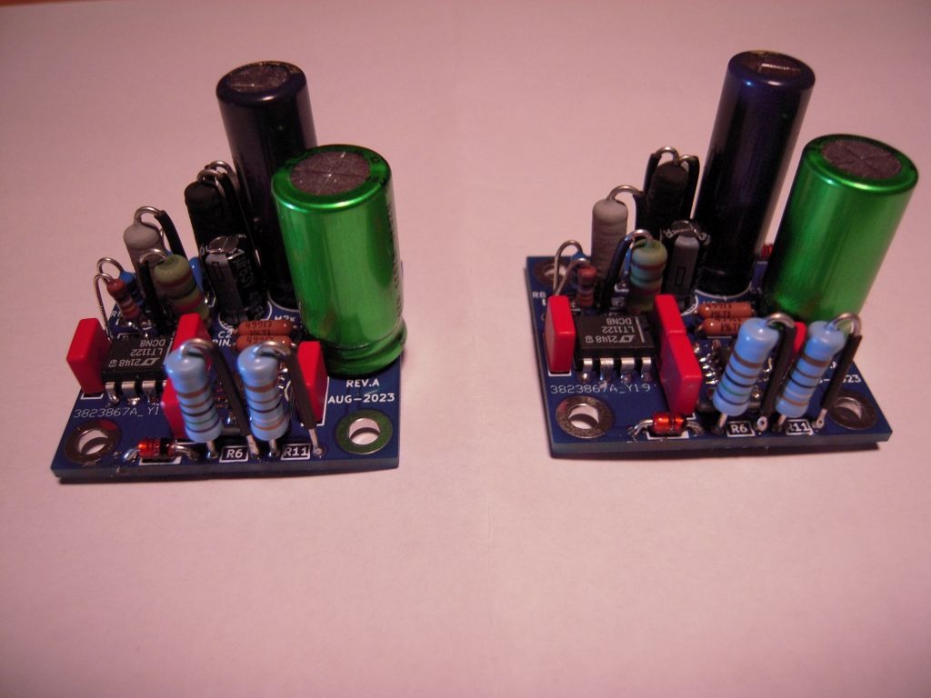

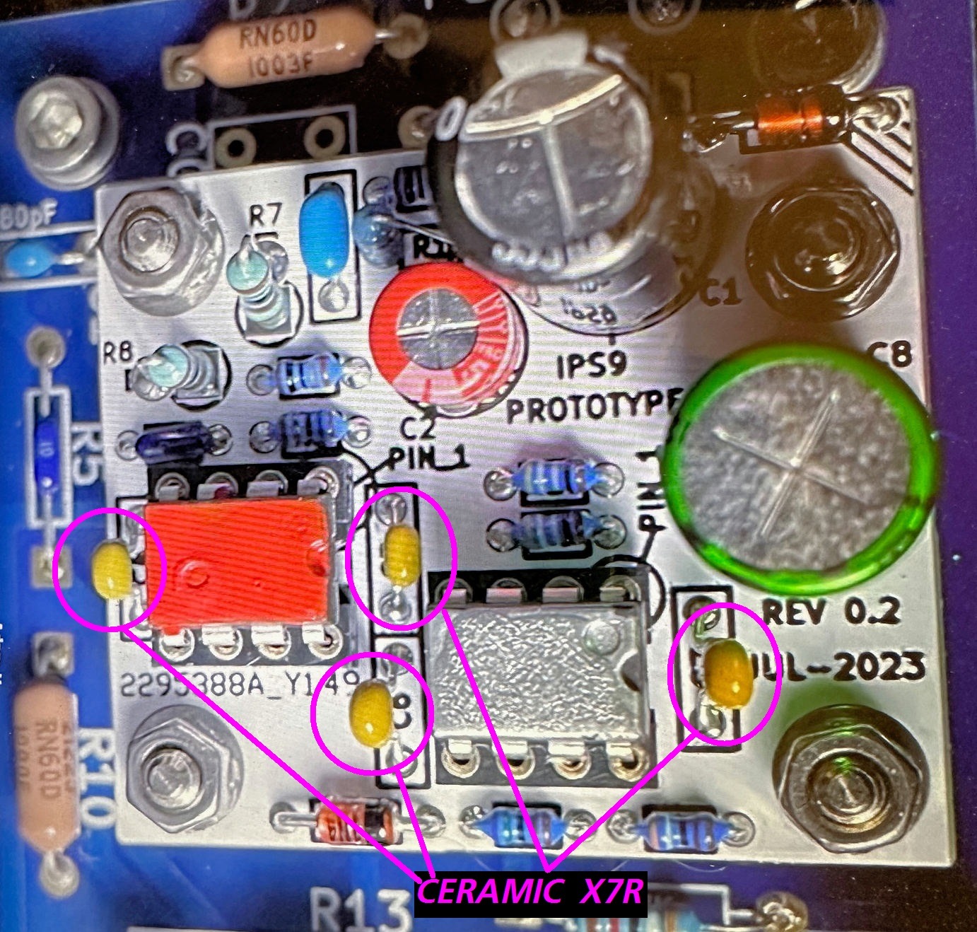

Those red film capacitors at either end of the VHF amplifier ICs, are not the best choice. Milpitas' Detailed Parts List recommends 0.1uF ceramic capacitors (50V, X7R) in positions C4-C7. Preventing the power supply network from oscillating, is no trivial task with 200 MHz bandwidth opamps.
Good morning, MarkJohnson!
I understand, that ceramic caps would be the better choice.
