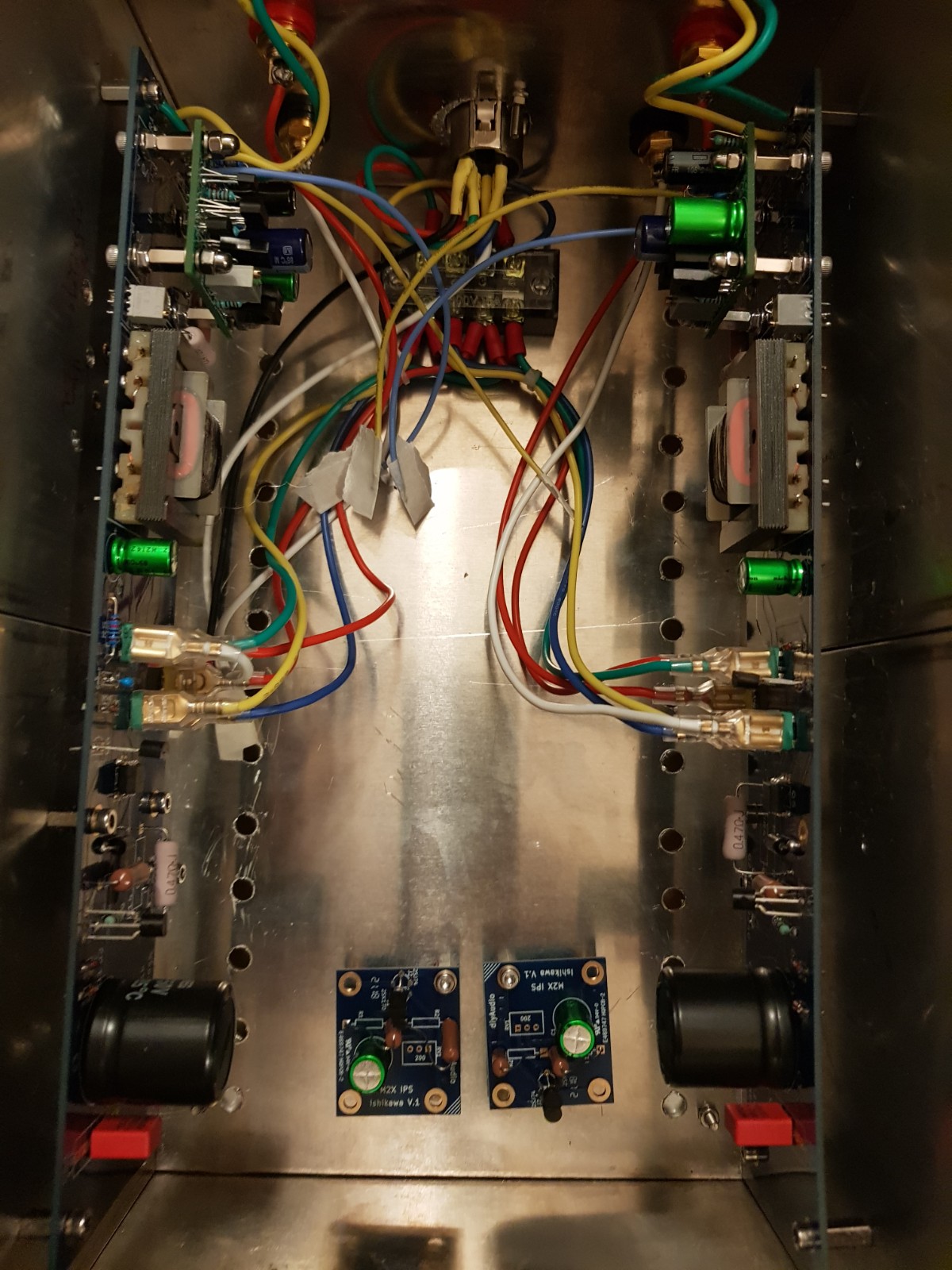

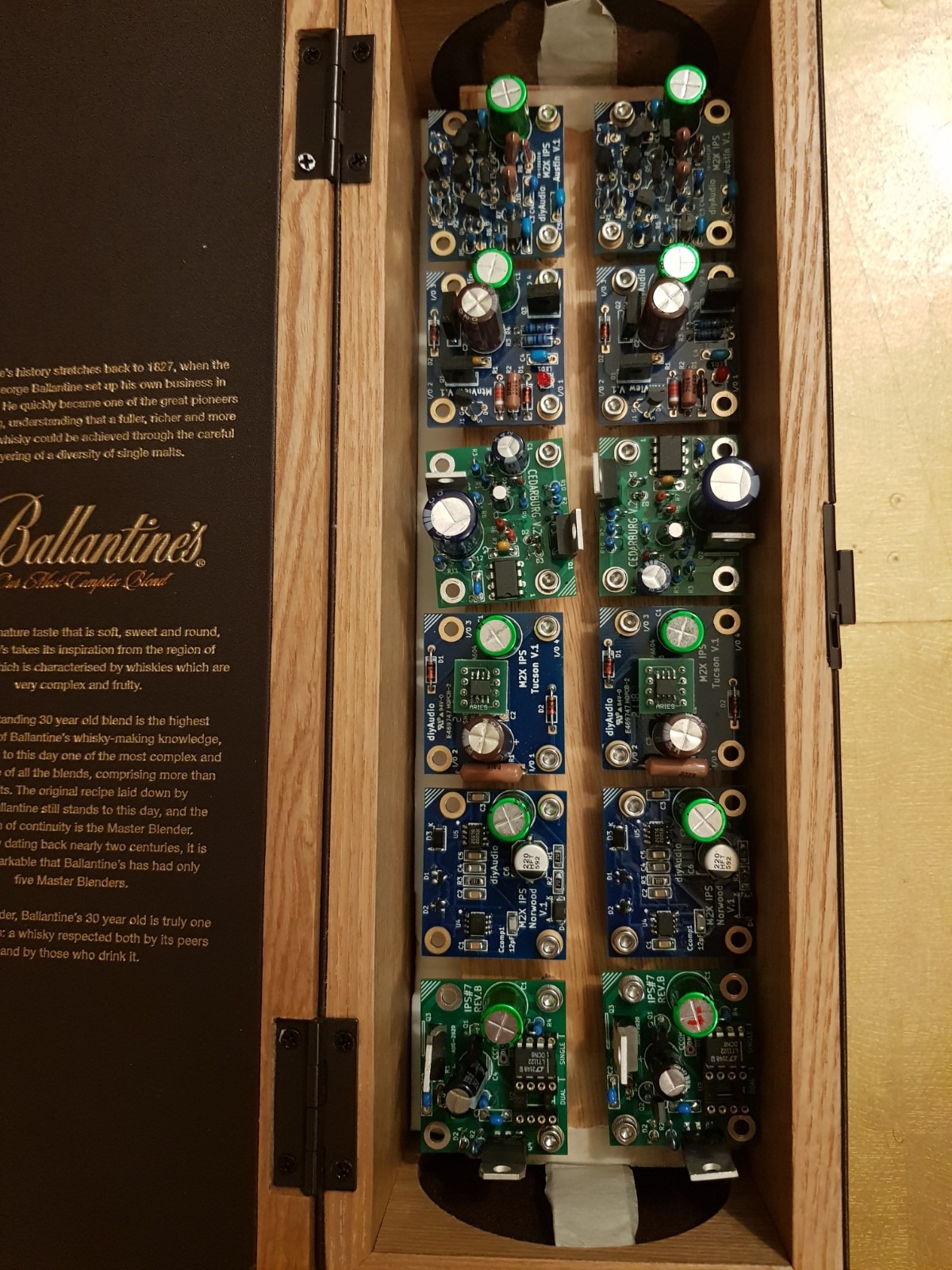

Finally, I've built all 8 daughter boards.
Thanks all of you, special to Mark Johnson.

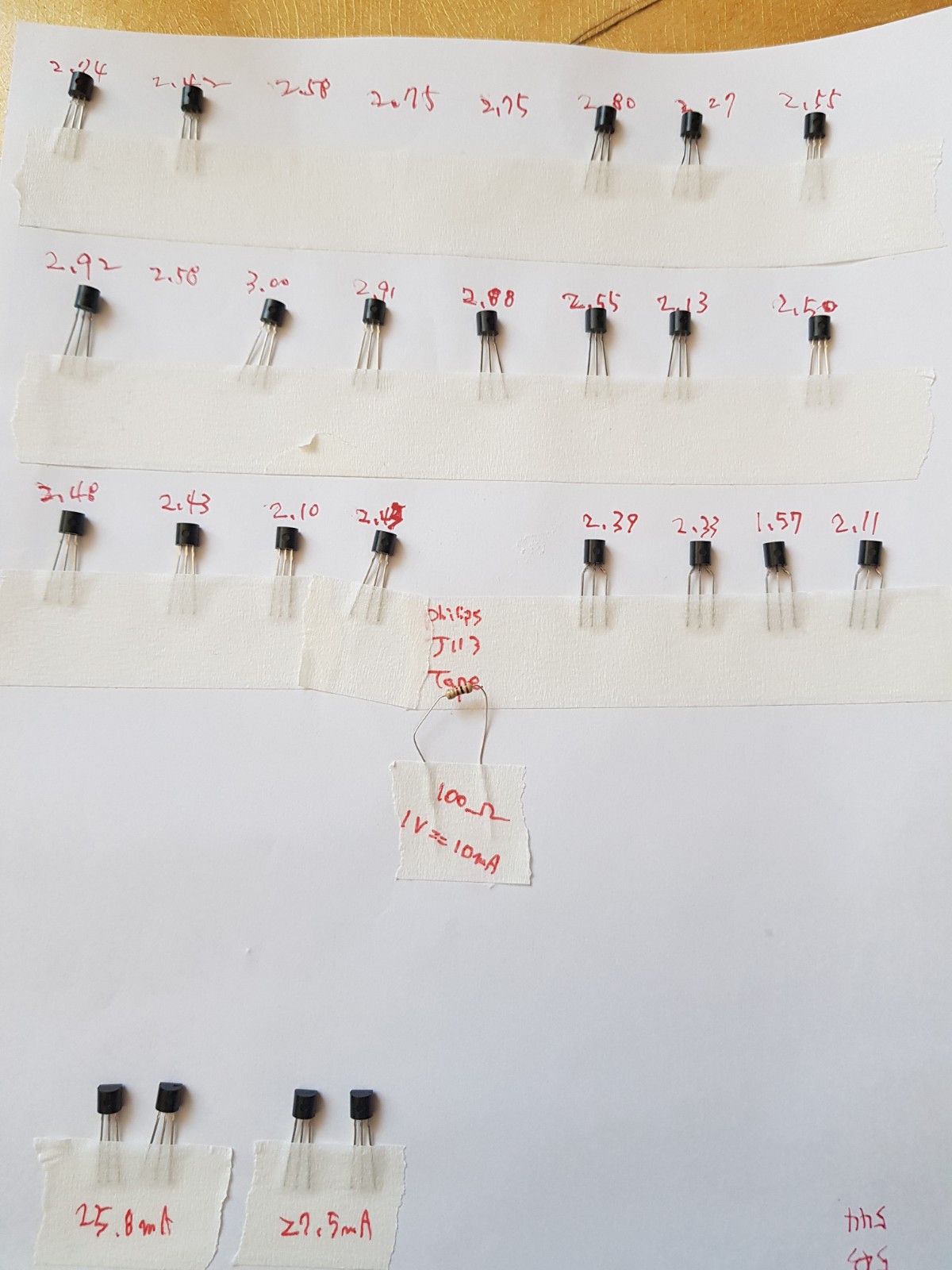

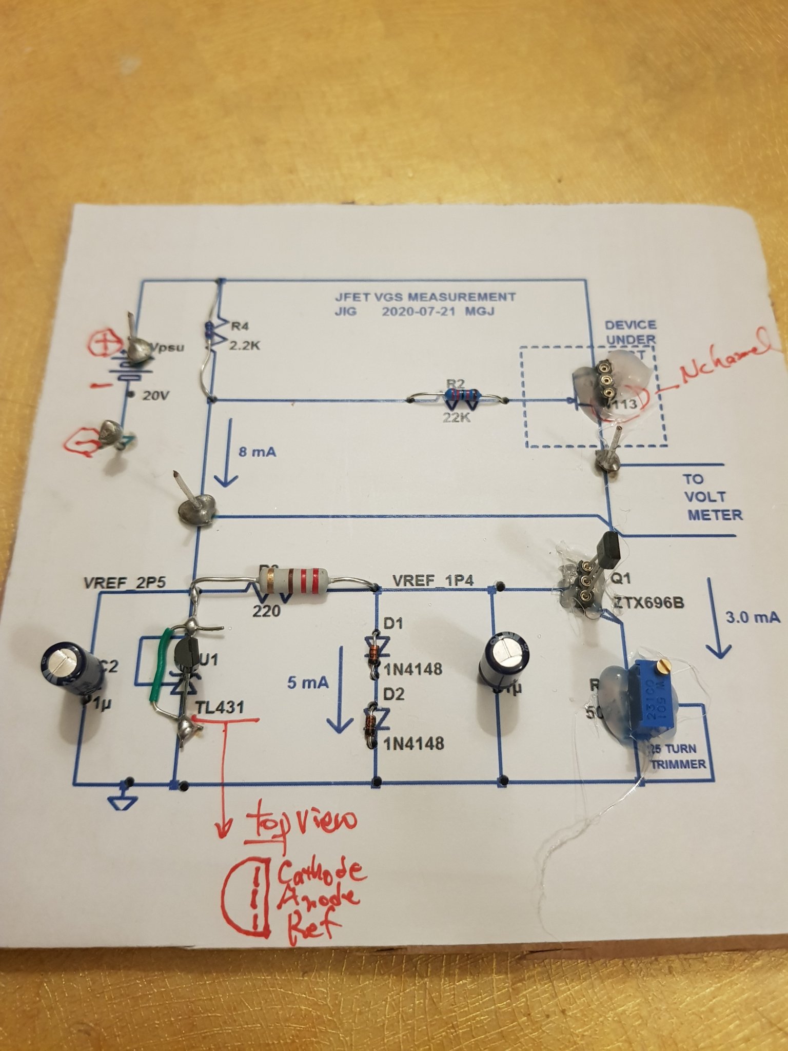

I've made the test jig circuit by Mark Johnson but did Idss matching for J113 of IPS6.
Fortunately, I could get 2 pairs from 24 pieces.

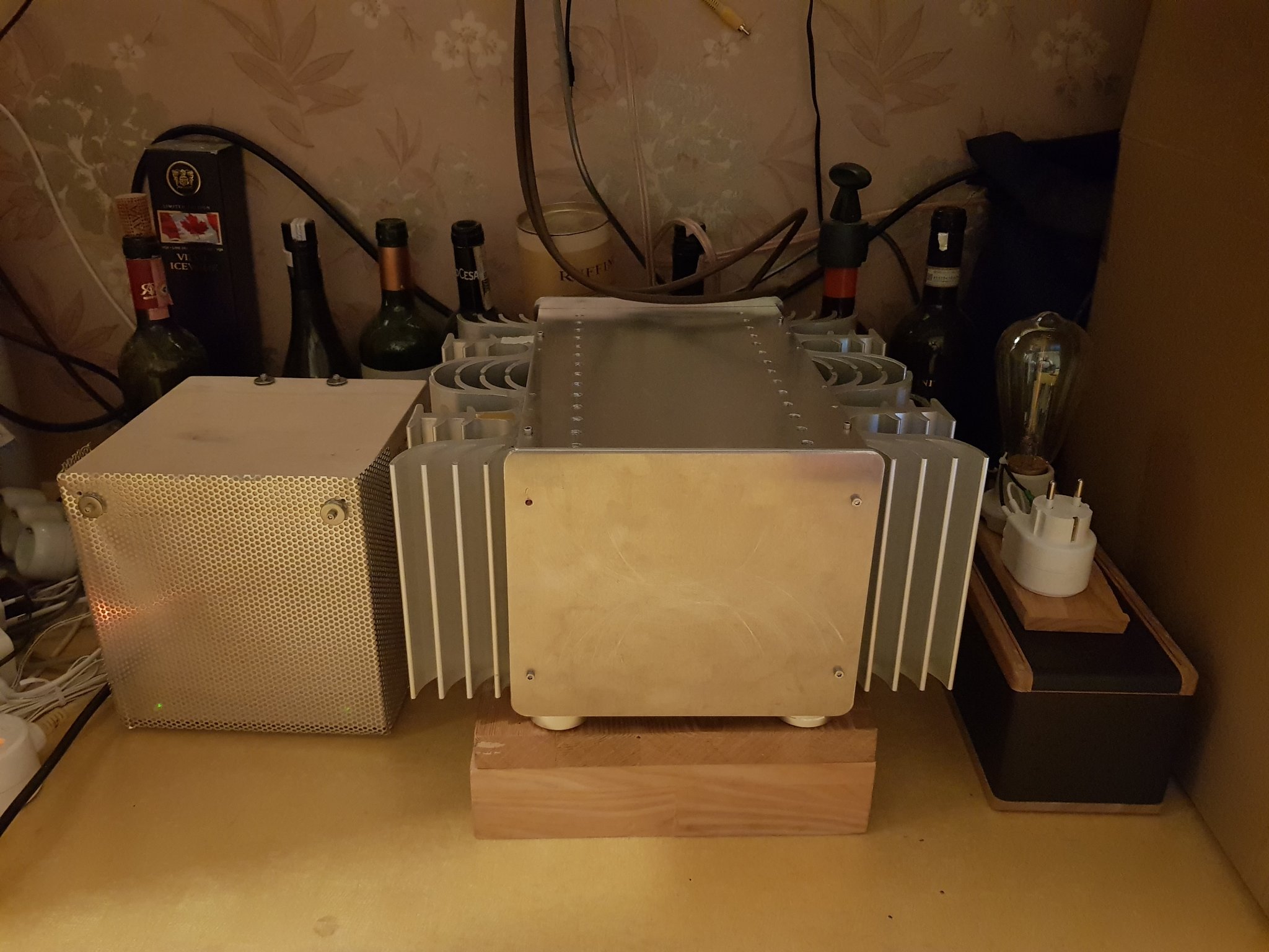

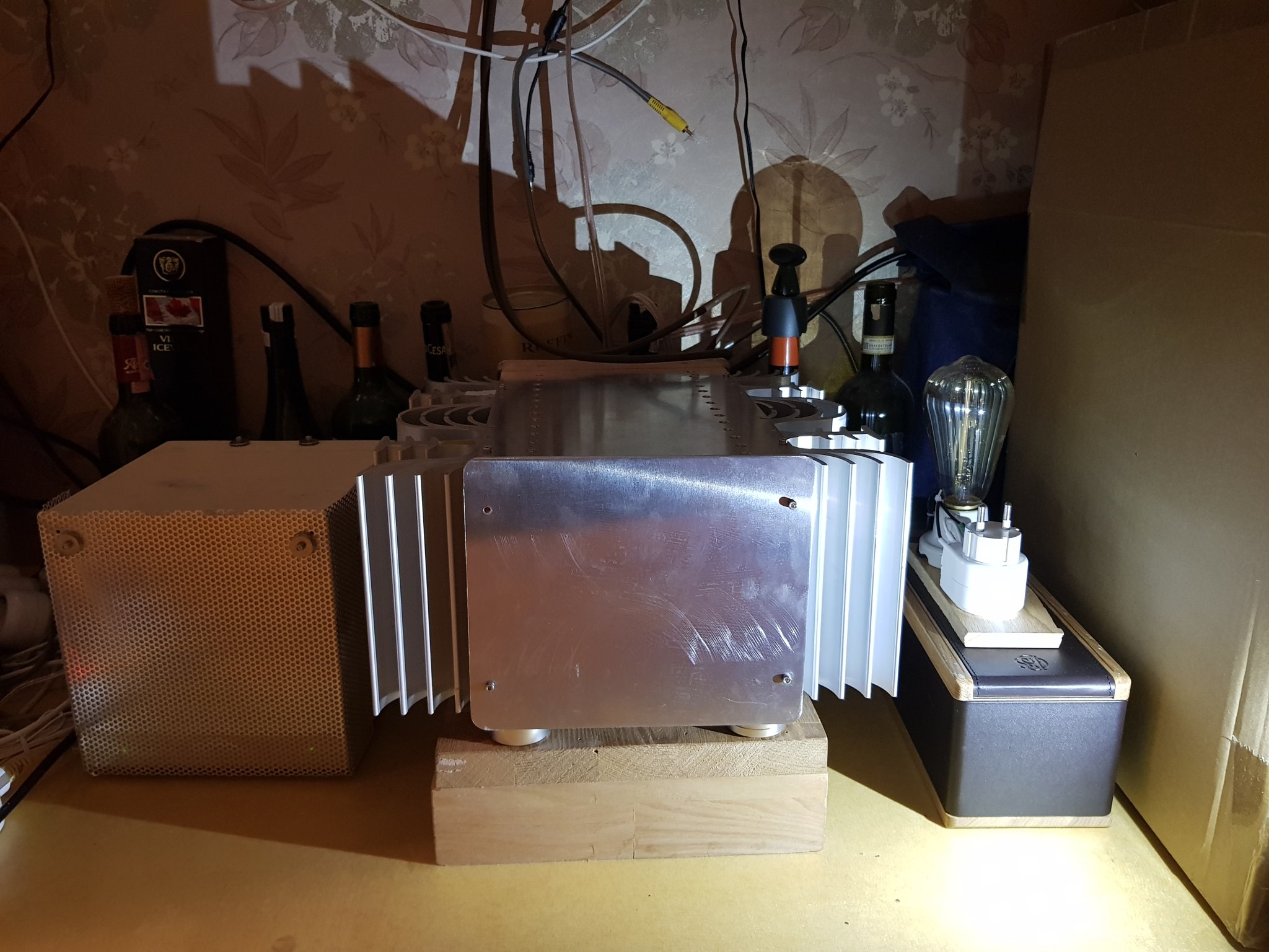

My system is a near field PC(desk)-fi like below.
PC Tidal source -> Savitech USB driver coaxial output -> Soekris dam1021 R2R DAC (1.4Vrms raw output without output buffer) -> Wayne's 2018 linestage + Muses 72323 Digital Volume control -> M2x -> SoundArtist LS3/5A speaker
Ishikawa - some weird sound character on my system. The center imaging is far below of my desk. I don't know why.
Mountain View - It has so strong its own sound character. so a very wide soundstage. rich and full body sound. so full feeling musical presentation.
Tucson - with OPA1611. easy listening.
Austin - I can’t find any pitfall.
Norwood - very clean and super mid high freq detail but narrow soundstage and no bass.
IPS6 - They say that the sonic character seems like Norwood.
It’s definitely not similar to Norwood.
It is superior than all others daughter boards in all about sound aspects - wide soundstage, better instrument seperation, more transparant, superb 3d imaging, super super super details, musicality.and controlled bass.
It makes M2x as another upper level amplifier.
I could not hear so great sound before on my humble system. WOW!!!!
It’s so good to me.
IPS7 - They say that LT1121 opamp sounds so good. Detail and HF is so good but on mid, mid-high it feels some muddy. With LME49720 it sounds better, well balanced.
Cedarburg (IPS8) - I can find some peace of mind. The depth is very narrow but the sound is so silky, well balanced, not fatiguing and easy listening for a long time.

Congratulations on successfully building an M2x and eight different input stage circuits!! I'm sure other M2x owners (and potential M2x builders) will be very thankful for your listening impressions of their sonic character.
Fantastic job, lovely build, good on ya!
-- Mark Johnson
-- Mark Johnson
@namghiwook What a wonderful project! Very well done and congratulations!
I must mention, I think you are the ONLY builder to have built all 8 of the cards (Aside Mark, of course…) what a fantastic process it must have been! Having the ability, time, and opportunity to thoughtfully compare all the cards is great fun, thank you for sharing your observations.
It is definitely good to hear other builders' impressions on the different M2x input stages. Sometimes I wonder if I am crazy for having such strong preferences myself. My personal faves were the Mtn View (with voltage reference in place of red LED) and Austin. I liked Austin so much that I replaced the stock front end in my F6 with a tweaked version; TTC004B and TTA004B as output transistors to drive the Jensen signal transformer.
There are certainly differences in the input stages… I strongly prefer IPS6 and Norwood, followed closely by Mountian View. I have not actually built Austin and now am even more curious from these most recent comments.
The thing worth repeating is that there are no “bad” input stages and they all work perfectly and each sounds very good - however some sound ‘better’ in a way that’s hard to describe other than I like it more.
The M2 output stage is responsible for the vast majority of the sonic signature of the amplifier, I personaly would be quite content with any of the input cards.

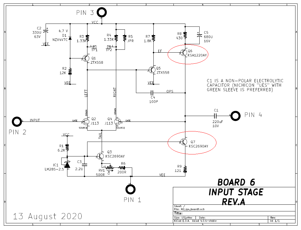

What's different about the IPS6 daughter card? {maybe that might partly explain why it sounds good, in some listeners' opinion?}
IPS6 is a transconductance ampifier, a voltage controlled current source, with a very high output impedance, driving a step up transformer. This is a bit unconventional, usually power amp front end circuits are voltage controlled voltage source amplifiers, with very low output impedance. Other front ends using the transconductance topology include Dreadnought and Kitty Hawk. Both of them drive a step up transformer, just like IPS6.
And finally, Lexington is a transconductance amp, operated from a DC-to-DC voltage boosted power supply, so it omits the step up transformer entirely. Lexington's transconductance amp directly drives the power amp output stage.
note: Dreadnought, Kitty Hawk, and Lexington are front ends for a different, non-M2x power amplifier, called "Ship Of Theseus". S.O.T. divides the amplification job among two circuit boards (same as M2x), namely Front End and Output Stage. The physical circuit boards are not interchangeable between M2x and Ship Of Theseus, but the design ideas have a lot of commonality.
