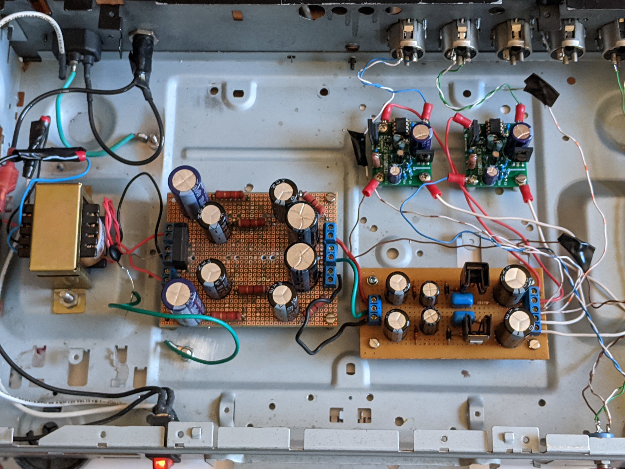

In complete contrast to the beautiful work in photos above, here's the temporary rat's nest I have just finished to try the Cedarburg cards as a buffer preamp, in the style of the B1. Works just fine; I'm listening to it now and it sounds pretty good at first hear, so to speak.
Pretty much everything except for the parts on the buffers themselves is recycled from my junk box or from old abandoned boards. PSU is a 24V EI with centertap, followed by a CRC (pay no attention to the extra resistors) and then a version of juma's "Easy-Peasy" Cx, built with whatever I could find lying around and not really adhering to the original values. Gives about +/-20.5V, which I could tweak up a little easily enough if I wanted to, I guess. Wiring is obviously not done with any attention to detail, just hooked up to see if things work OK, which they definitely do.

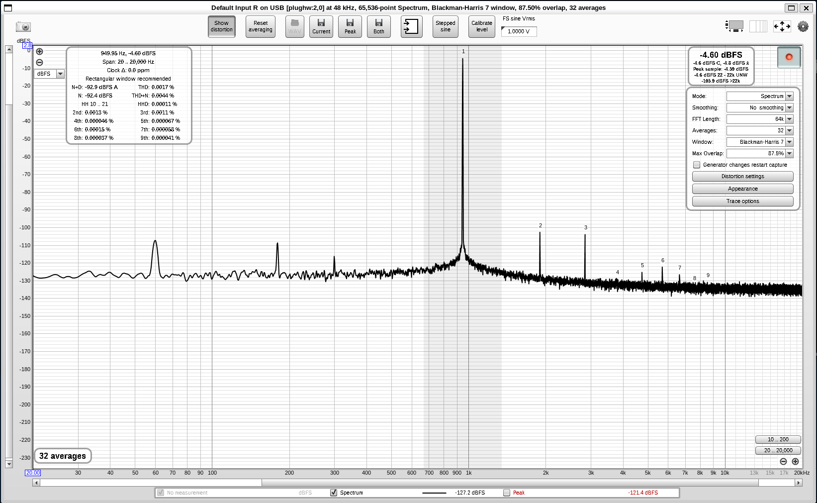

I'll post anything that's interesting enough... Hope this meets the bar: a plot from REW for the right channel (I didn't measure the left). Input as close as I could get to 1V, volume set around where I would usually expect to have it in use. Not too shabby, I'd say, considering the minimal effort put into the PSU and wiring...
