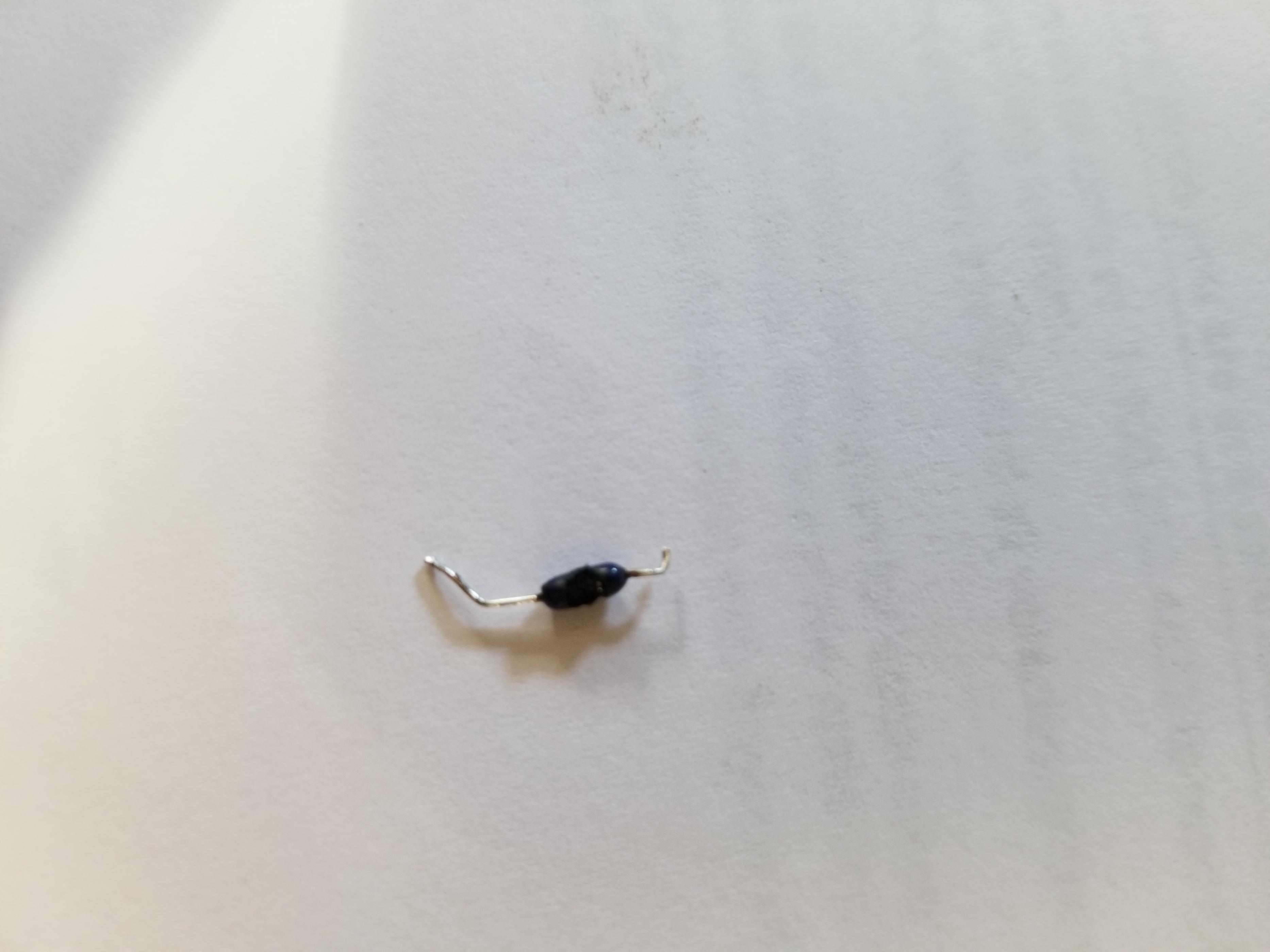

Eric: removed the hair from the position you noted and it made no difference -- the left channel is hosed. Attached is a picture of R12 -- the resistor that burned almost in half. Would like to know what other board component(s) could have caused this or whether it could be the result of the RCA short. If anyone has any suggestions, thanks.
Am ordering replacement components for the board and would like to make sure I get all of the possible offenders replaced. Can this type of failure be the result of the transformer?
Am disinclined to try the RCA DC offset adjustment on the other channel because of the first failure. Can any one this site tell me how they have succeeded with this calibration?

Found the problem with the trouble board. The two mosfets had been switched -- user error. Will redo them and replace with upcoming parts from Mouser. Wonder how many other components this could have affected. Some of the resistors were certainly ruined,

Good find, Craigl59! Covering the mosfets with big washers makes visual inspection difficult to perform. I was going to suggest next that you make sure your mosfets are actually electrically isolated from the sink. Using soft silpads (kerathem) leaves you vulnerable to tiny metal shavings from hole tapping that can pierce the pad and cause a short. Also, be sure to deburr the hole after drilling to get rid of the raised lip that will result. This is an invisible problem when it happens. I’ve started using ceramic aluminum oxide pads and thermal paste instead of silpads. They are thick and rigid, transfer heat better, can’t be pierced, and cost less. Check out Mouser for part number 4180G. You can also get them on ebay for less money. Since you are rebuilding, it’s worth the effort. Silpads cannot be reused.
Mount your mosfets to the sink first. Take your dmm and check for continuity between the center pin (tied to the metal pad on the back) and the sink. Should be open circuit. Any resistance reading at all means you have a problem -remove and inspect. Only when you are SURE there are no shorts should you mount the mosfets to the board.
