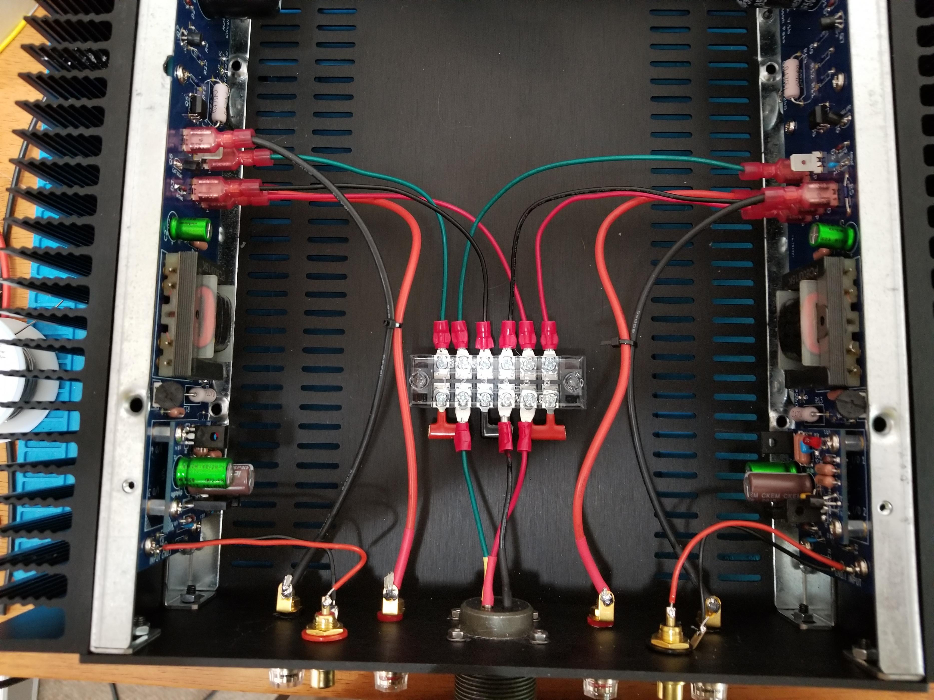

Craigl59, I can only strongly second 6L6's request to only use stranded wire for an umbilical. I understand that you have ordered stranded, silicon-sheathed wire for the umbilical now, but I feel the need to emphasize this point for the benefit of others reading this thread and thinking about solid wire.
- In most countries' electrical codes, solid wire is only permitted for fixed installations. If cables are moved around, solid wire will break sooner or later.
- You can't securely crimp solid wire. It will not give a reliable connection in the first place, and loosen with movement. NASA forbids this in the work done for it as well: CRIMPED TERMINATIONS GENERAL REQUIREMENTS

chede: Duly noted...however...my initial question was, simply, to find out the amp draw of the M2X boards. Earlier in this thread it is reported as 1.3amps, apparently a constant draw. The remaining issue that I cannot find addressed on the web is what ampacity does a certain gauge of stranded copper wire have? Know this for solid wire but do not know it for stranded wire and this spec is not given by any of the vendors I have ordered from.
AGAIN, assumed above that stranded wire might be variable here because of the number of strands AND that it will be less than solid. But I have found no hard data on the Internet.
To come back to your emphasis: yes, you should use stranded wire for safety and reliability reasons. But what ampacity will be provided by the 18awg cable ordered above? Don't know.

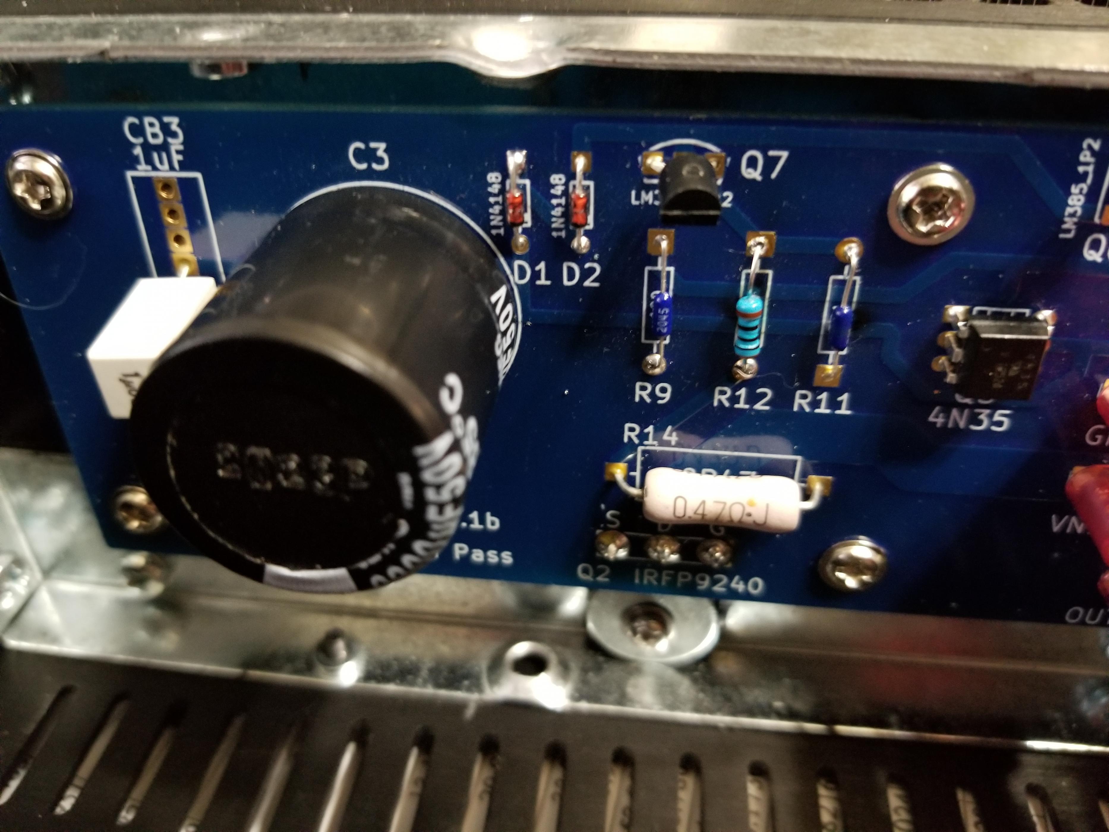

Got the PSU done with Paul's help and it works fine. Just finished the M2x and got it all setup for the initial calibration. Checked with posts above and Paul and shorted out the left channel RCA, attached the voltmeter to the speaker inputs, and turned on the PSU.
Smoke from the front of this left channel board, from the resistor area R9, 12, and 11. Turned everything off and checked the board -- Paul was kind enough to call with assistance. Saw that the resistor R12 was burned almost in half and when checked, registered 34 ohms.
Hooked the M2x back up and (without RCA shorting) checked the other channel. It works fine. Then plugged the damaged channel in as well and it makes music but with a lot of background hiss and static.
Had a 100 ohm resistor around and replaced R12. Made no difference. There is a small black/burned spot under R11 but do not have a 221 ohm resistor lying about.
Q5, Q6, and Q7 attach to these resistors and Q6 got bent slightly askew during construction -- it might be damaged. The mosfets are in their correct position, triple checked.
So, the trouble channel tries to make music but clearly has some damage. Will start replacing the various components around these 3 resistors and would appreciate advice from the knowledgeable pundits onboard.
Paul noted that the Vishay/Dale resistors I ordered were the very small blue ones and might be a problem. Ordered 1/4 watt resistors as best as possible and do not know if another wattage or type would be ideal.
And thanks for your help. Got 2 ACAs built trouble free, one linear PSU (works great), and half of a M2x. Now to see if I can get the other half...(LOL).

Check from the bottom to be sure that no leads from the bottom of the board are hitting your sink and causing a short. Did that on one of my ACA builds…
Edit: whats going on with that 9240? Looks like it is mounted ON the chassis rail. Be sure it is electrically isolated from the chassis.
Soldering on top leg of R12 also looks suspect. This should be reflowed with a bit more solder to completely fill the hole.
Yes, all of the transistors were carefully checked for orientation when assembled. Thanks for asking. The diodes are also correct in polarity and will check their values individually. Do not think they are the problem, however.
Again, both boards where assembled the same and the right channel works fine. This leads me to think that the problem must be either 1) the RCA shorting and testing process, or 2) the bent transistor Q6.
Am ordering replacement components for the entire section of the board and the mosfets as well just to be prepared. With the holiday delay, won't have them until late next week. Will offer even more desoldering practice, and I have learned the pleasures of a quality solder sucker.
The close proximity of the mosfets to the support rail is the result of having ordered a 2U chassis from HiFi2000 using their published height specs -- that led me to believe the board and mosfet would fit. In fact, it is very tight. However, the washer is to ground as is the rail and the heatsink. So don't think that could be the cause. Have ordered replacements, anyway, and will hope they work.

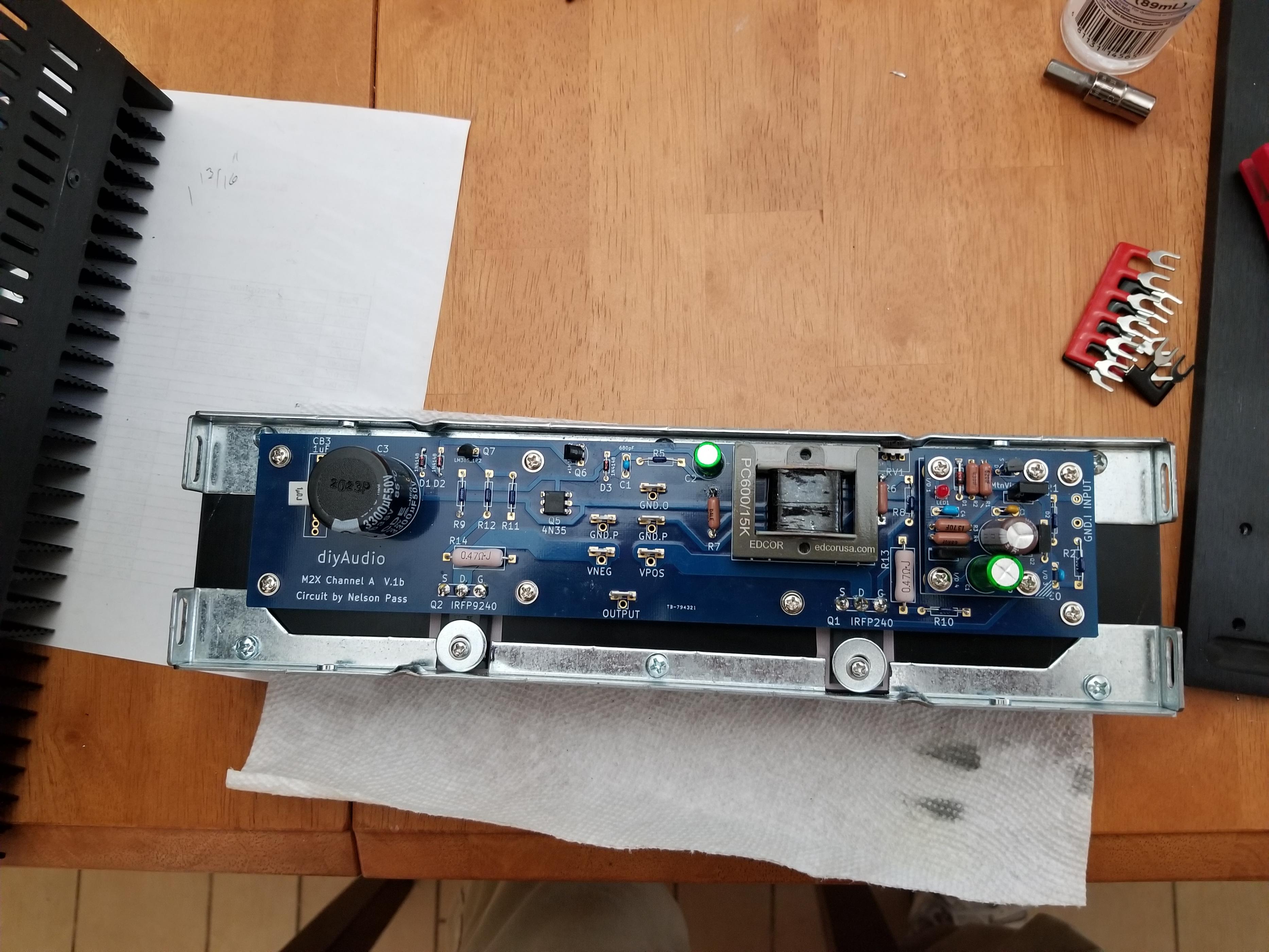

Here is a pic of the initial heatsink/circuit board combination.
Eric: The rails had to be cut in order to make room for the mosfets. Upper rails needed massaging as well. Bottom line: order at least the 3U chassis for the M2X.
