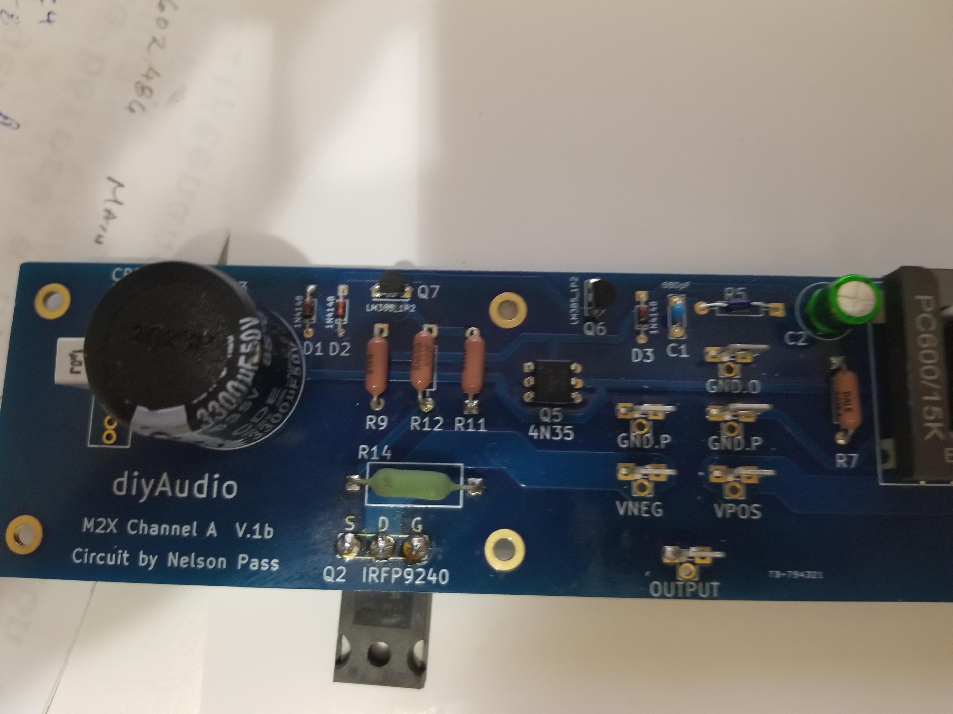

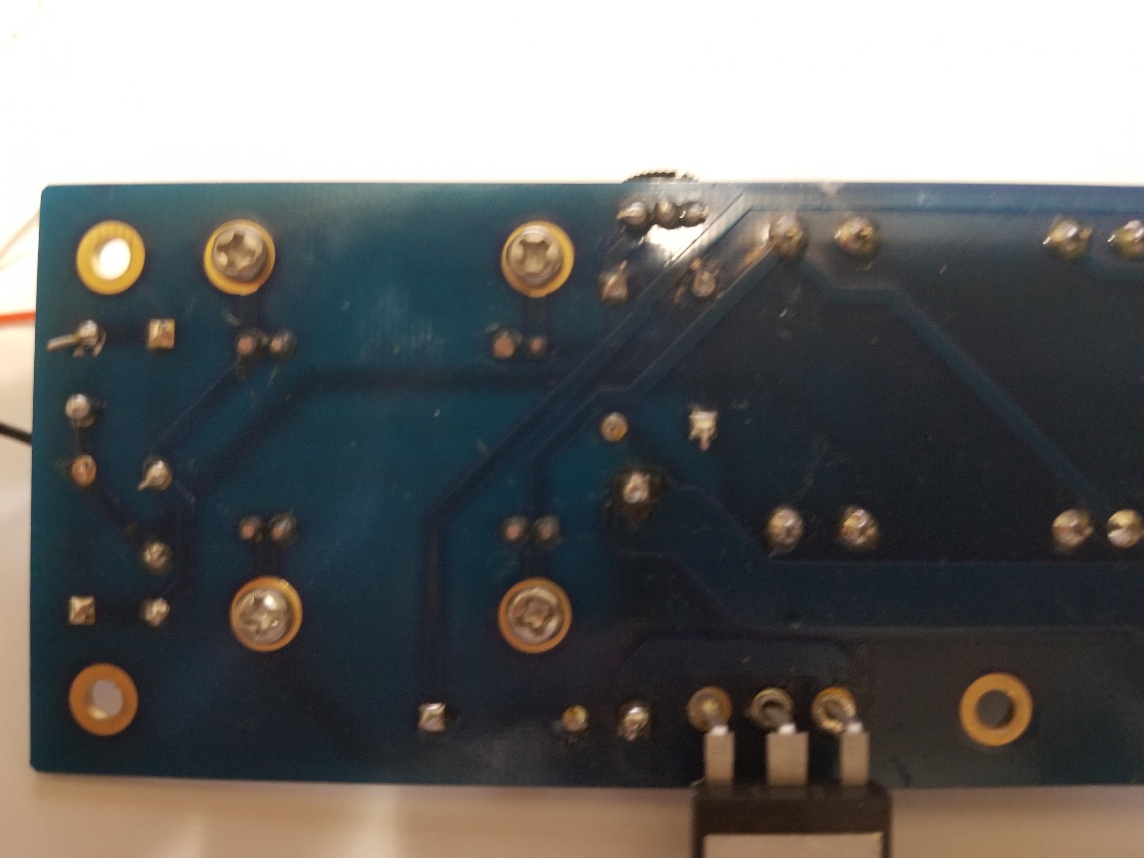

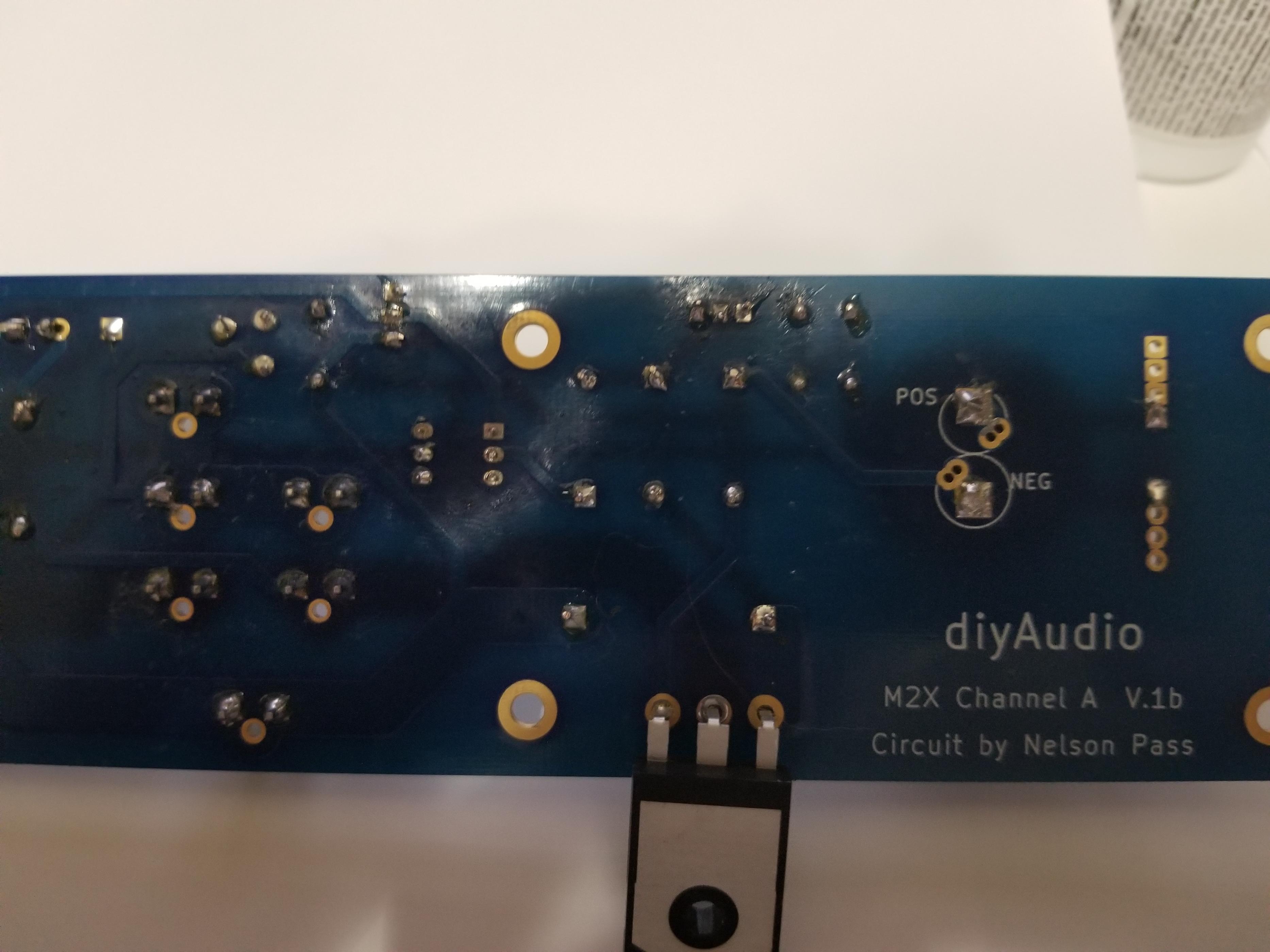

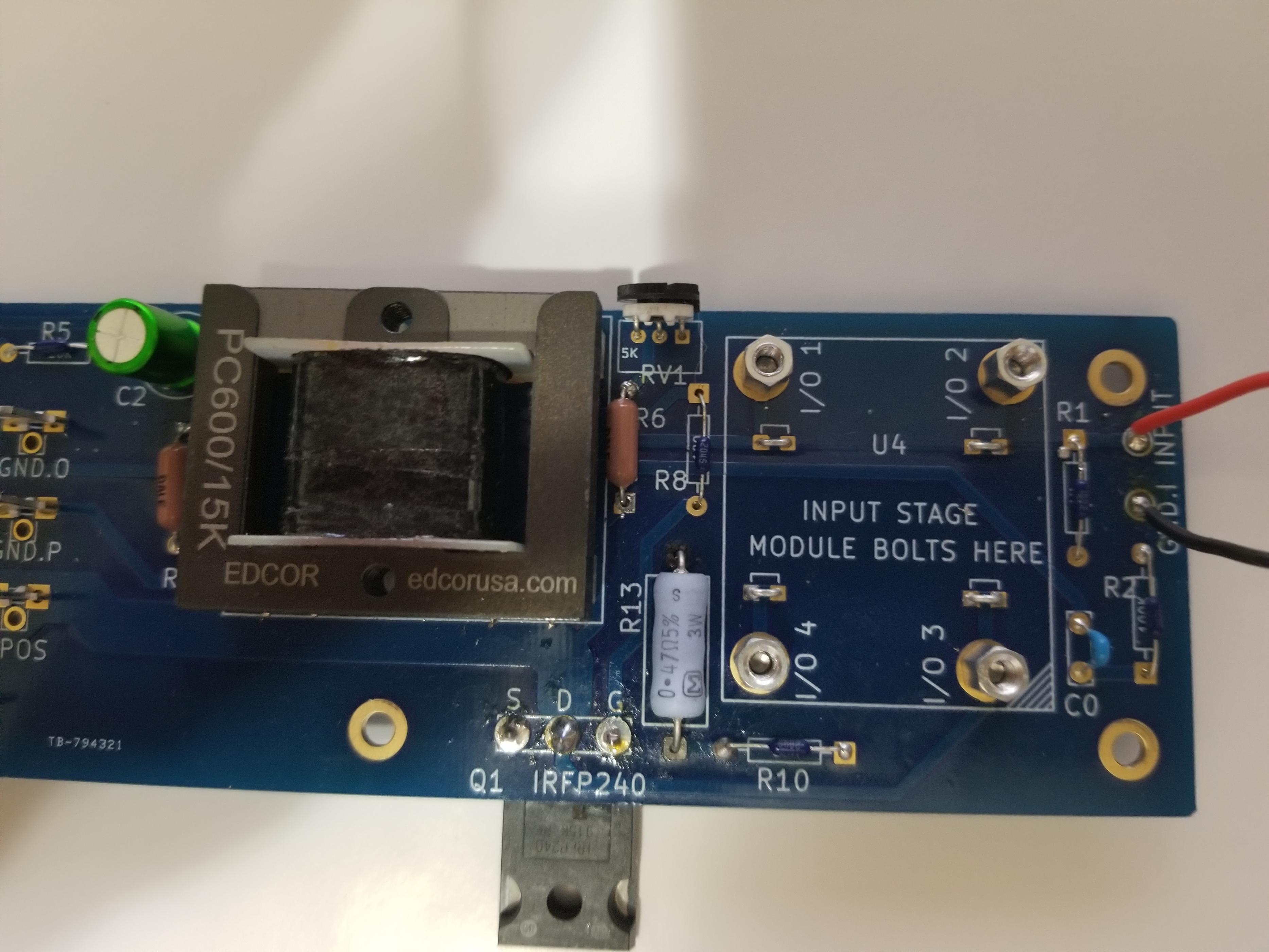

Got the parts today and rebuilt the entire section over the misplaced mosfet IRFP9240 where the smoke had first appeared and 3 resistors were fried. Replaced the 4 resistors and the 3 transformers nearby and checked the diodes -- they are all OK. Then reassembled and started the amp. Worked OK for a minute or two, then smoke started (again!) coming out of the other side of the board -- from the upper left of the daughterboard. The .47R 3 watt resistor was also stressed at this time. Replaced that resistor and tried it with no daughterboard. Made no smoke. Then put a different daughterboard in (Tucson) and started it up and, again, smoke started. Stopped, took Tucson out, and checked to see if it would run OK without any DB. It did. So, checked it with a speaker to see if any sound would come out. Nothing. No sound at all.
So, when you add the daughterboard, it starts smoking. Does this indicate the transformer has been blown?
Am getting frustrated with this trouble board and think you have to start over with a completely new main board when the mosfets were switched initially.
Any suggestion would be appreciated.

Might need some pictures, to assist. You don’t mention it, so you should take a step back and build a dim bulb tester (DBT) and always use it when powering any amp for the first time. It will let you “see” if there is a problem and pulling excessive current before it damages things.
Got it and it's on the to-do list. But this was not a first-time turn-on.
Do not think that photos will help -- the board looks just like it did in the photos above except the mosfets have been replaced and switched to the right places and resistors and diodes have been all either replaced or checked for accuracy.
What would cause daughterboards to be distressed and start smoking once they are added to the main board is the remaining problem and the choices are 1) the Edcor transformer, or 2) any of the capacitors. Can check the capacitors after removal but not sure about how to check transformers.
If anyone want a specific picture of some section of the board, just ask and it will be supplied.
