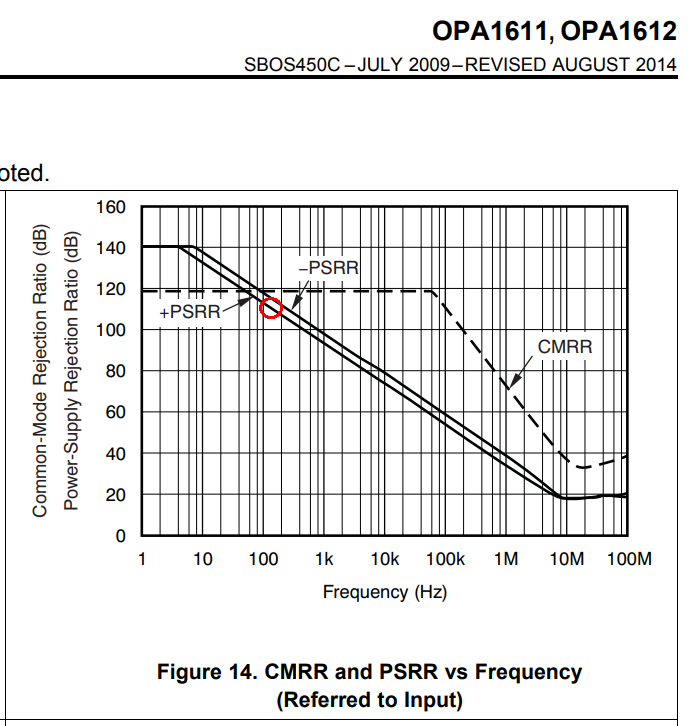

IPS7 actually includes bootstrapped supply rails, a stunt which increases PSRR by at least 30 dB. So if you've chosen the OPA1611 opamp, whose PSRR at 120 Hz is 110dB all by itself with no bootstrapped rails (see red circle),
... putting that chip into an IPS7 board raises the PSRR to at least 140dB. Every volt of noise on the supply rails becomes 0.1 microvolt of noise at the input.
If you've set your volume control so your M2x is delivering 1 watt into 8 ohm speakers (sqrt(8) volts output, 0.47 volts input), supply noise + imperfect PSRR establishes a noise floor at -133dB. A little less than one part in (2 raised to the power 22).

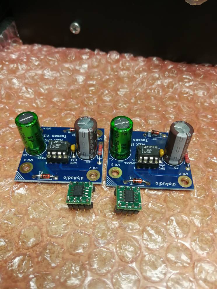

IPS7 will be my next input board project. I have put OPA134 in the RS-Component basket along with some other components. Today I will build a small low distortion 1 kHz oscillator for noise measurement. It uses a LME49720 this one:
https://docs.rs-online.com/1fed/A700000006723661.pdf
It looks as it could be interesting to try also.....don't know if is exists in a single opamp version also but IPS7 can take both types.

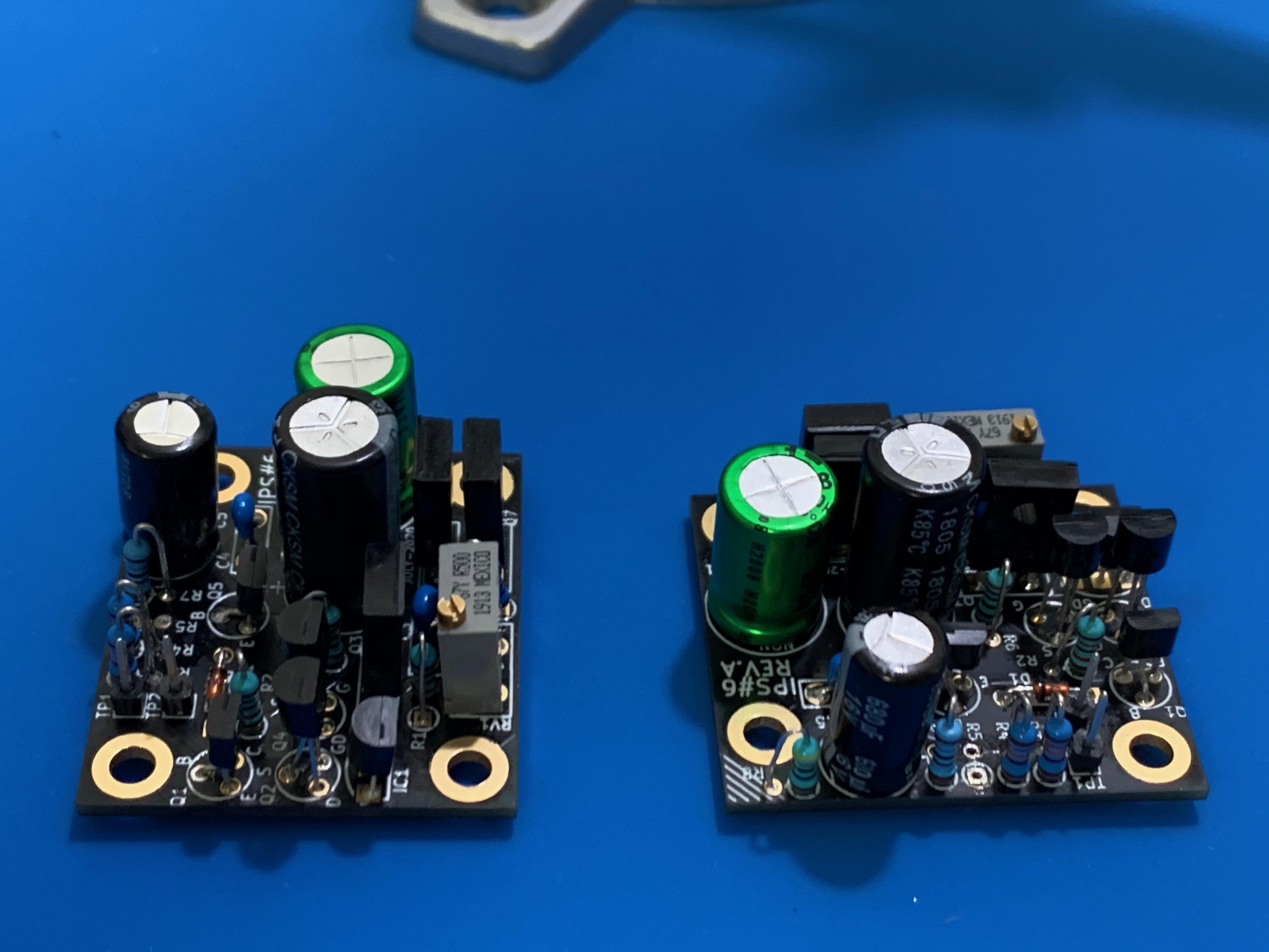

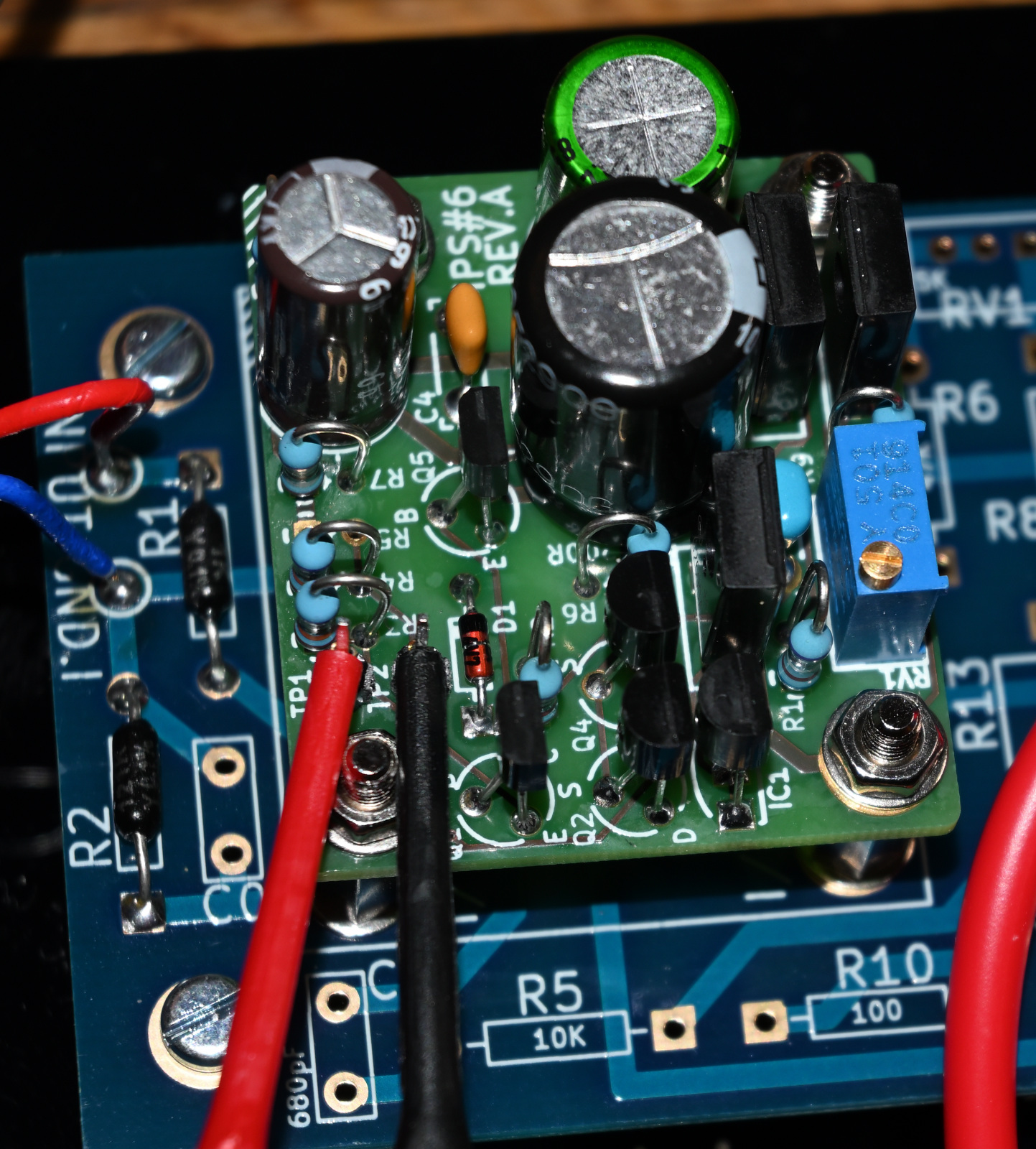

I cannot seem to tune my IPS6 boards. I am getting 5.12 Vdc at across TP1 and TP2 and does not move as I move RV1 CW and CCW up to what I thought the end of the range. One of the pic is showing R5 with a jumper, but I already cut the wire for both boards and R5 is now open.
Suggestions anyone? Thank you!
Abe
It seems you need to turn your 2 x J113 JFETs 180 degree....the "flat" side has to face in direction of the potentiometer. All of the small TO-92 transistors face same direction.
Abe
Check and re-flow solder pads on the bottom of the little PCB, especially around RV1.
Will do!
Can I test the IPS6 by just applying VCC (+5V) on Pin 3 and Pin 1 to GND?
Thank you! I will replace them.
Abe
By "replace" you probably just mean "mount them correct"......as I assume you have spent some time on matching the JFETs?
Yes, replace. I have 4 match JFETS (J113) that was given to me by gracious M2X owners here. I also have bipolar supply so I will test the boards before mounting them this time. Thank you so much!!
Abe

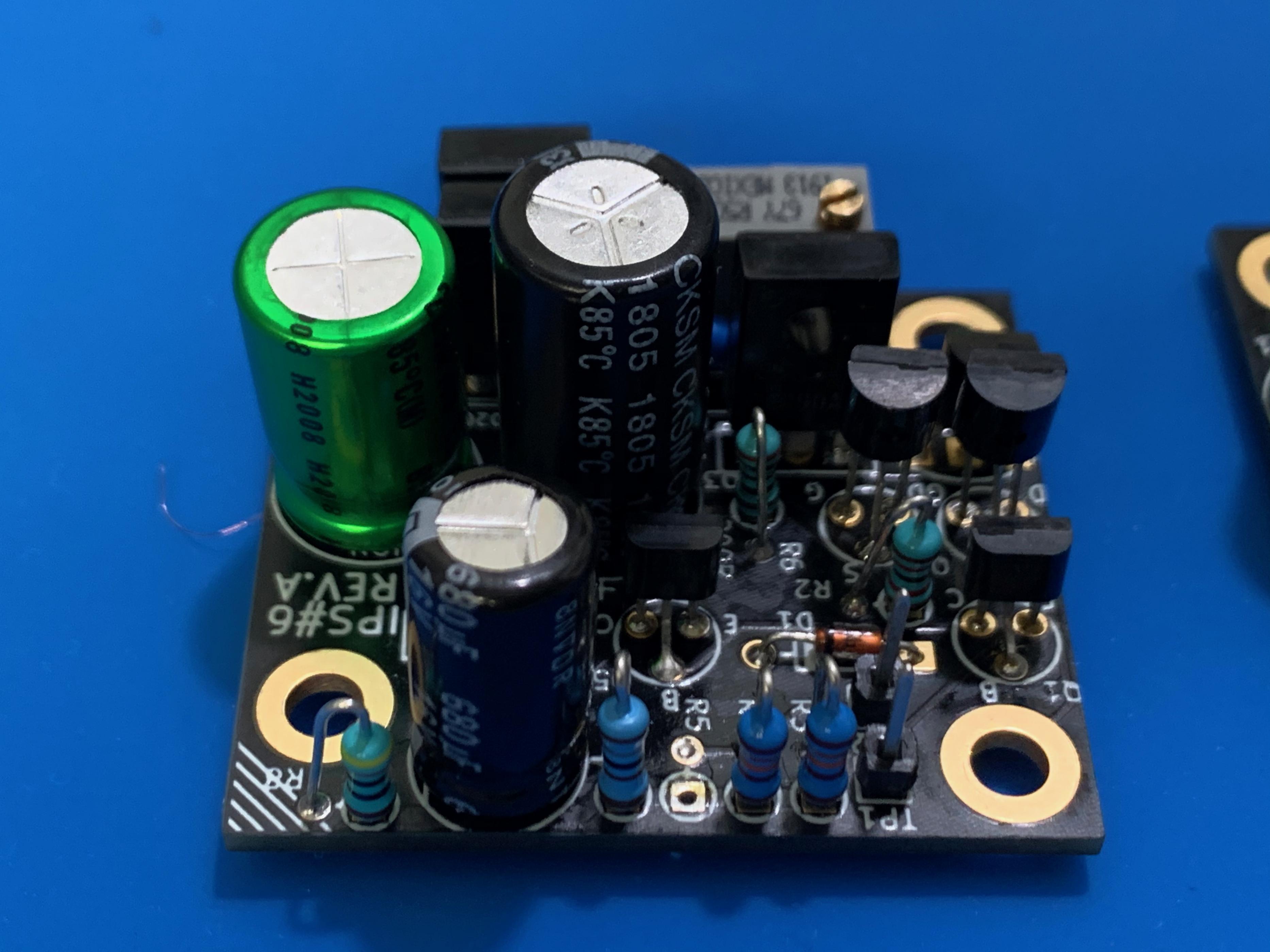

My IPS 6 still does not work. As soon as I mount it, theres a loud hum in both channels. I tried one channel at a time and hum is always present and I cannot see a change (0.07 mV on both channels) on TP1 and TP2 twirling RV1.
My IPS7 is quiet and works properly (installed in the amp at present).
I already replace J113's as it was oriented wrong earlier. How do I check it outside of the amp? Please see photos and let me know what I missed. Thank you!
Abe

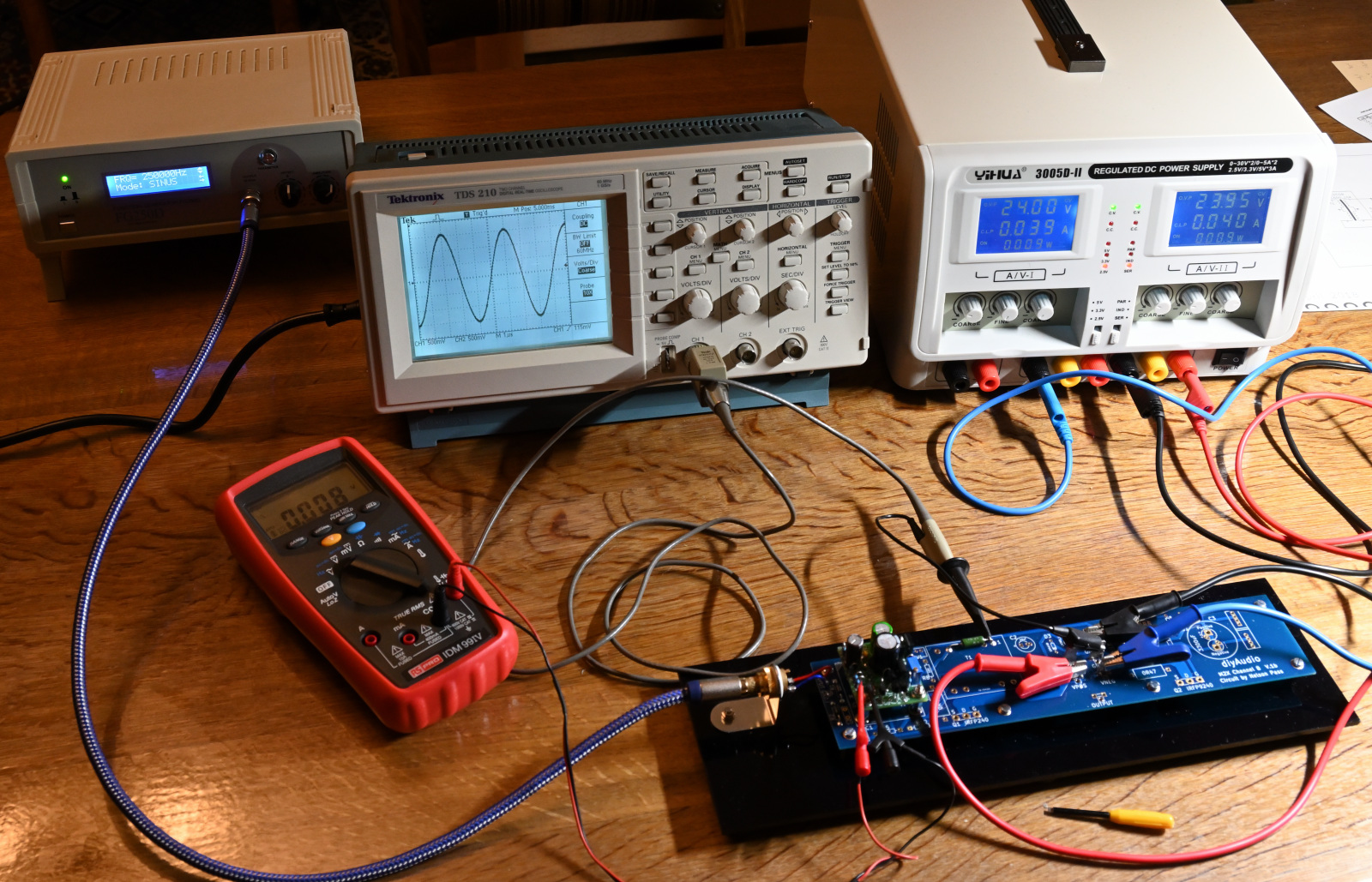

I built myself a input board "test bench" using a spare M2X amp board as picture shows and only mounted what necessary to test the boards. Works perfect.
Did you test the JFETs before inserting them into board....e.g. using one of the cheap component testers from China?
Maybe check all resistor values.....as it is easy to insert a wrong one....
