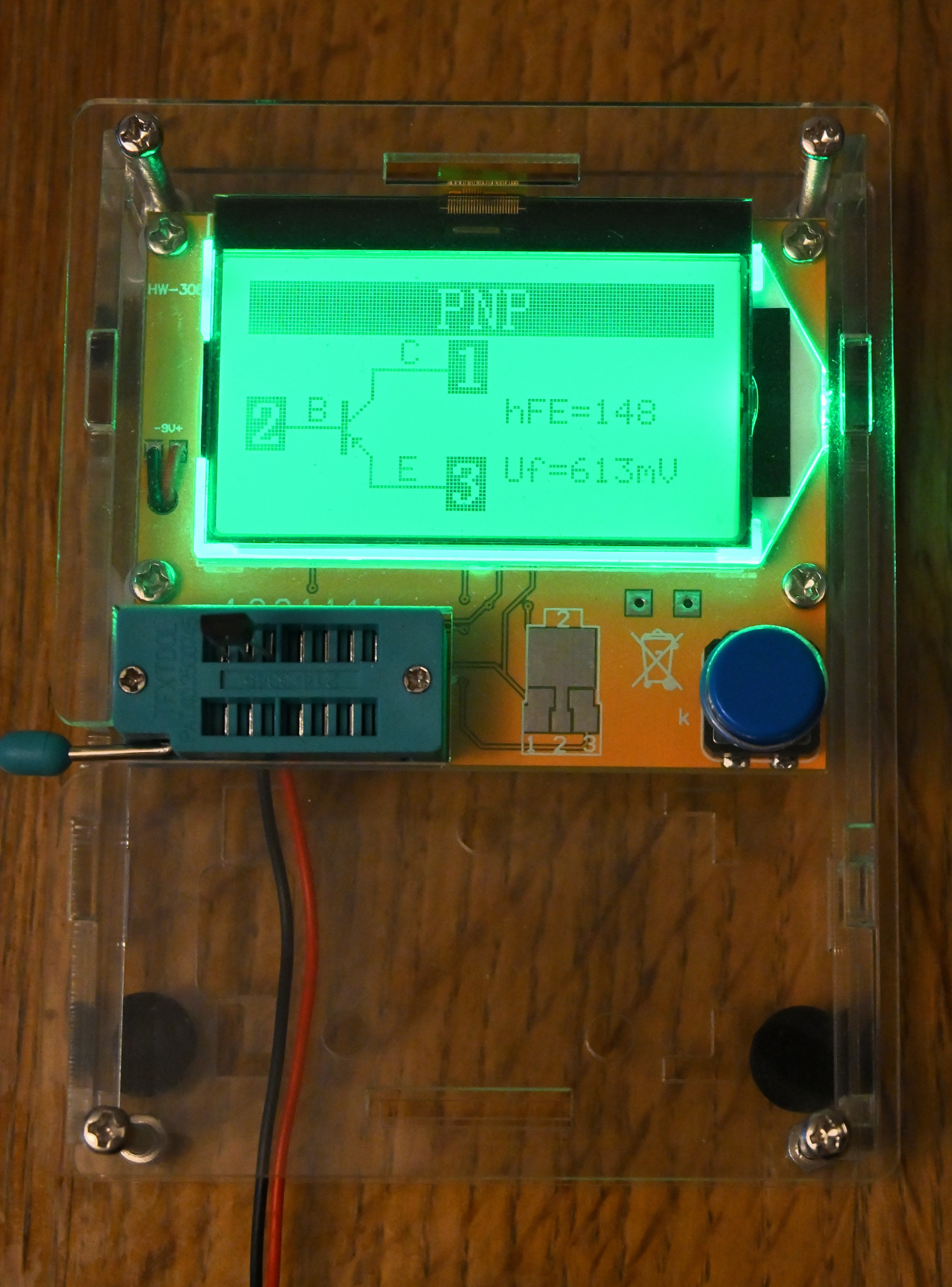

Checked all resistor values, and transistor orientation. I then started pulling transistors to verify. With the ZTX558, I got the following reading for one transistor
and the other
Strange, I am thinking I got a bad batch of the transistors as both boards (L & R) behaves the same in circuit. I have not pulled out the pair on the other board however.

This is how one of my ZTX558 measures straight from the "box". My are from RS-Components and I am quite sure that the "Made in Germany" printed on "box" is a "mis-labeling".....as everything is usually made in China.....or at least in "far east".
