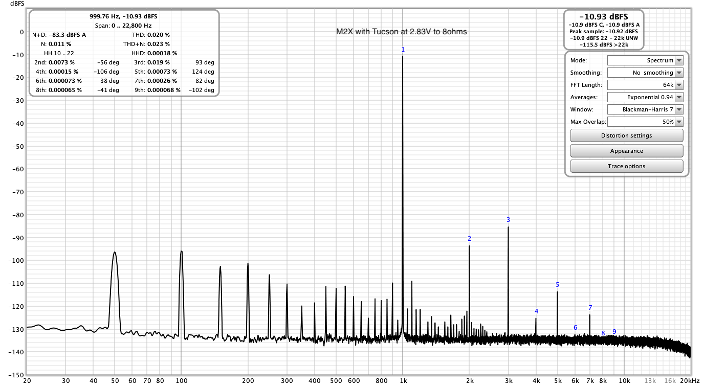

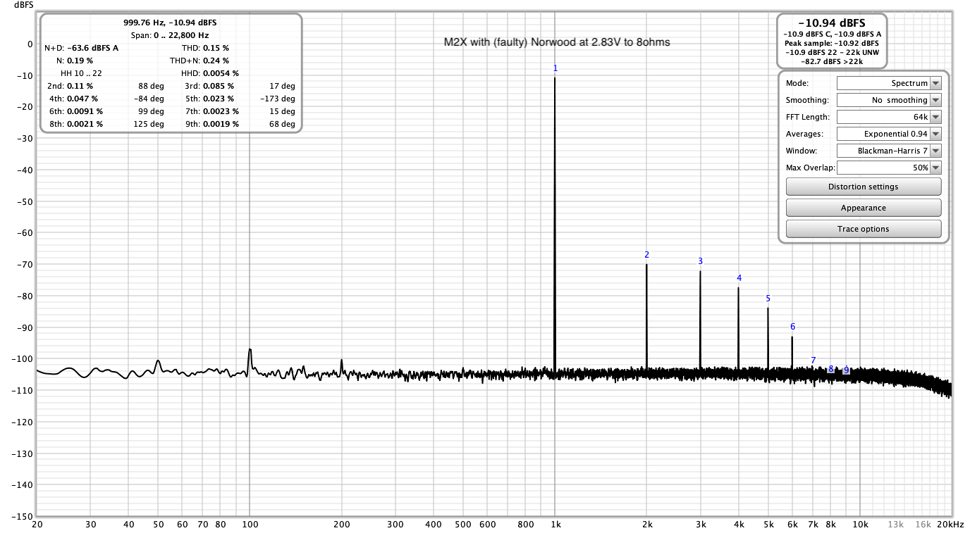

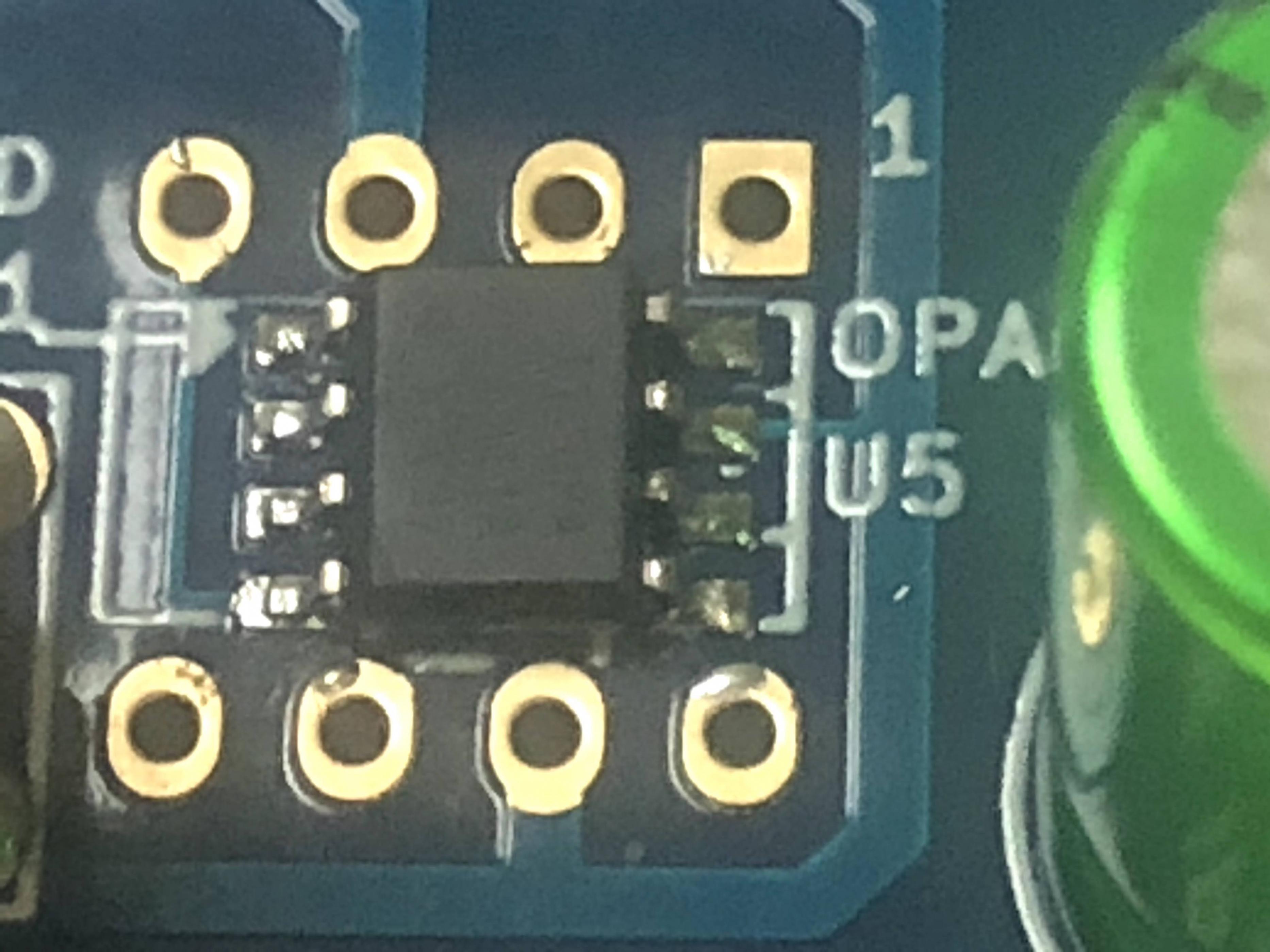

Also, I have some problem with my Tucson card - one of them has much higher noise floor than the other (-105dB compared to the normal -135dB). I could not hear this, but I saw this when measuring. I am sure this is the faulty card, these measurements were repeatedly confirmed with this one particular card.
Did anyone had any time similar problem with OPA1611? Could it be a faulty opamp? Or did I fried it when soldering? I hope I did not, but that was some first experience with the hot air gun. There are just so much parts on Tucson, so I suspect opamp first.
Pictures attached if somebody would like to comment.

If you have checked that solder connections are ok then I would check if opamp gets correct -+10V. It is powered via two 10V zener diodes. If both plus and minus voltage is correct I would replace the opamp and see what happens. You need a Gnd reference at amp board. If measured at board only you should measure about 20V but I think better to check via a Gnd-ref at amp board. Be sure not to short anything during measurement 🙂
You could also build a "test bench" for input boards and test board as "stand alone". I did that.

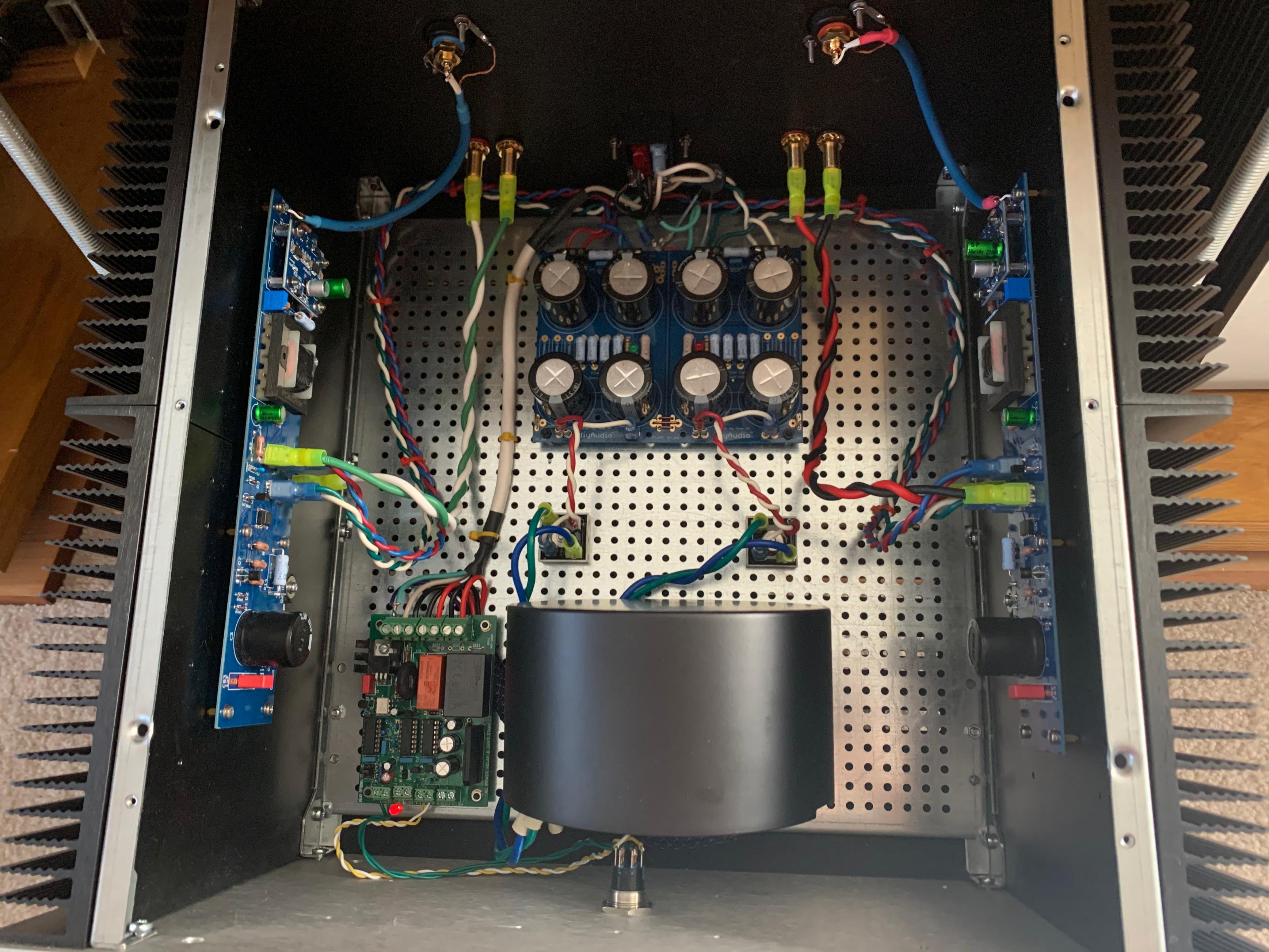

When I was building the amp, during testing, I did not mount the trafo (400VA 18-18) permanently and connect the speakers out to an Altec 416-8B (98 dB)drivers. I then experimented on the transformer positioning for what I perceived as quiet. My brother who was building the Aleph J at the time did the same and we end up mounting the trafo, with shield, as shown. I will probably try the mu metal shield later on. But at this time, I have no inclination to do so. M2"N" (Norwood) on the left and F4 on the right.

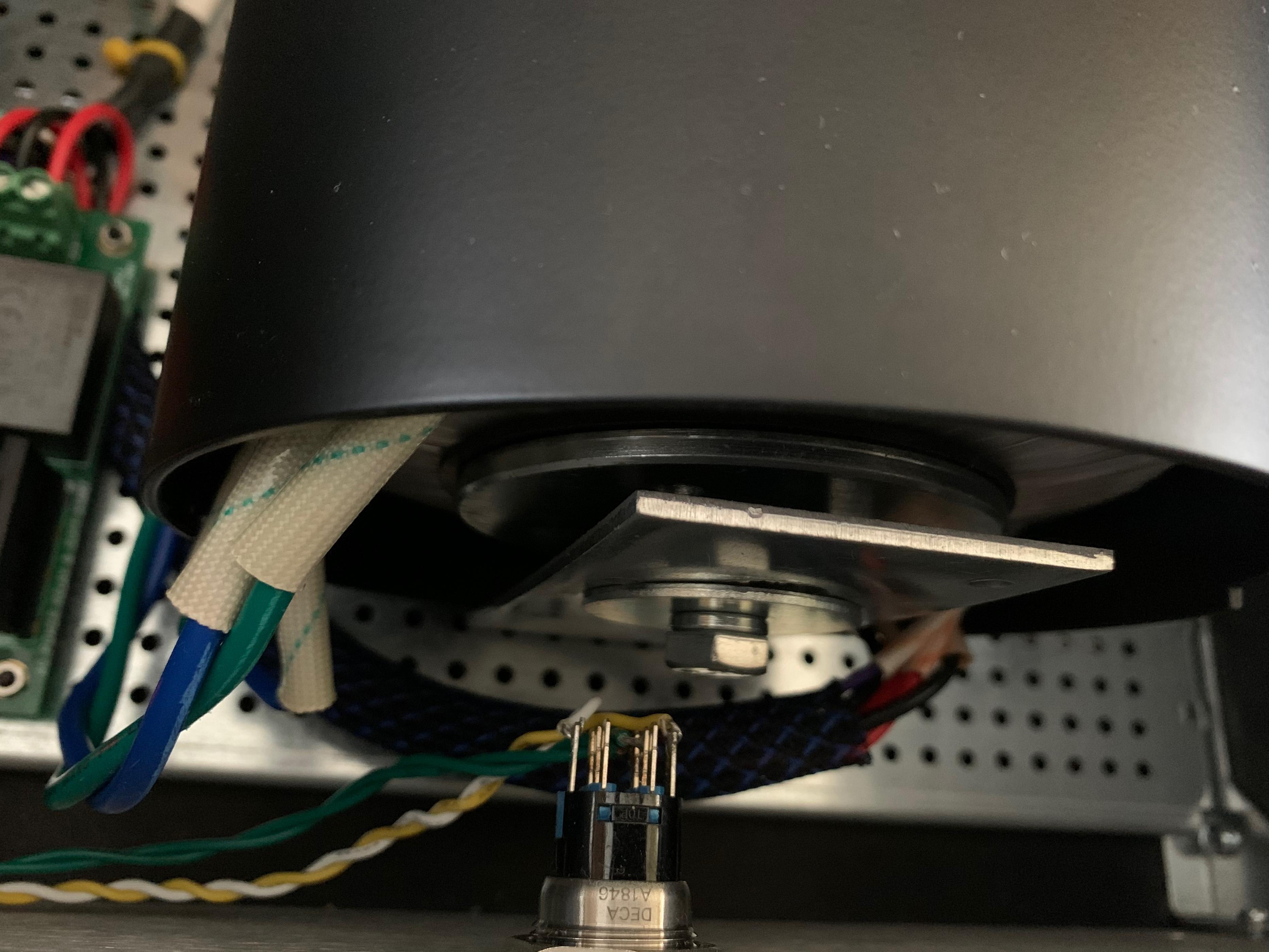

Thank you for posting that layout. I am just assembling an M2X with Mark Johnson's soft start board--the only difference I see is my switch led is RED-BLUE. My question is how do you secure the transformer in the upright position? I don't see a bracket. For my last build I attached it to a vertical riser panel. Works ok but doesn't satisfy my need to overbuild.
BTW, I used the Mu-metal box around the Edcor and steel case around the Antek 300VA xformer and there is zero hiss or hum.
Hello Bruce!
There's a metal bracket holding the trafo. I bought it at the local hardware store (Lowe's) for $2.00 use for securing joist.
