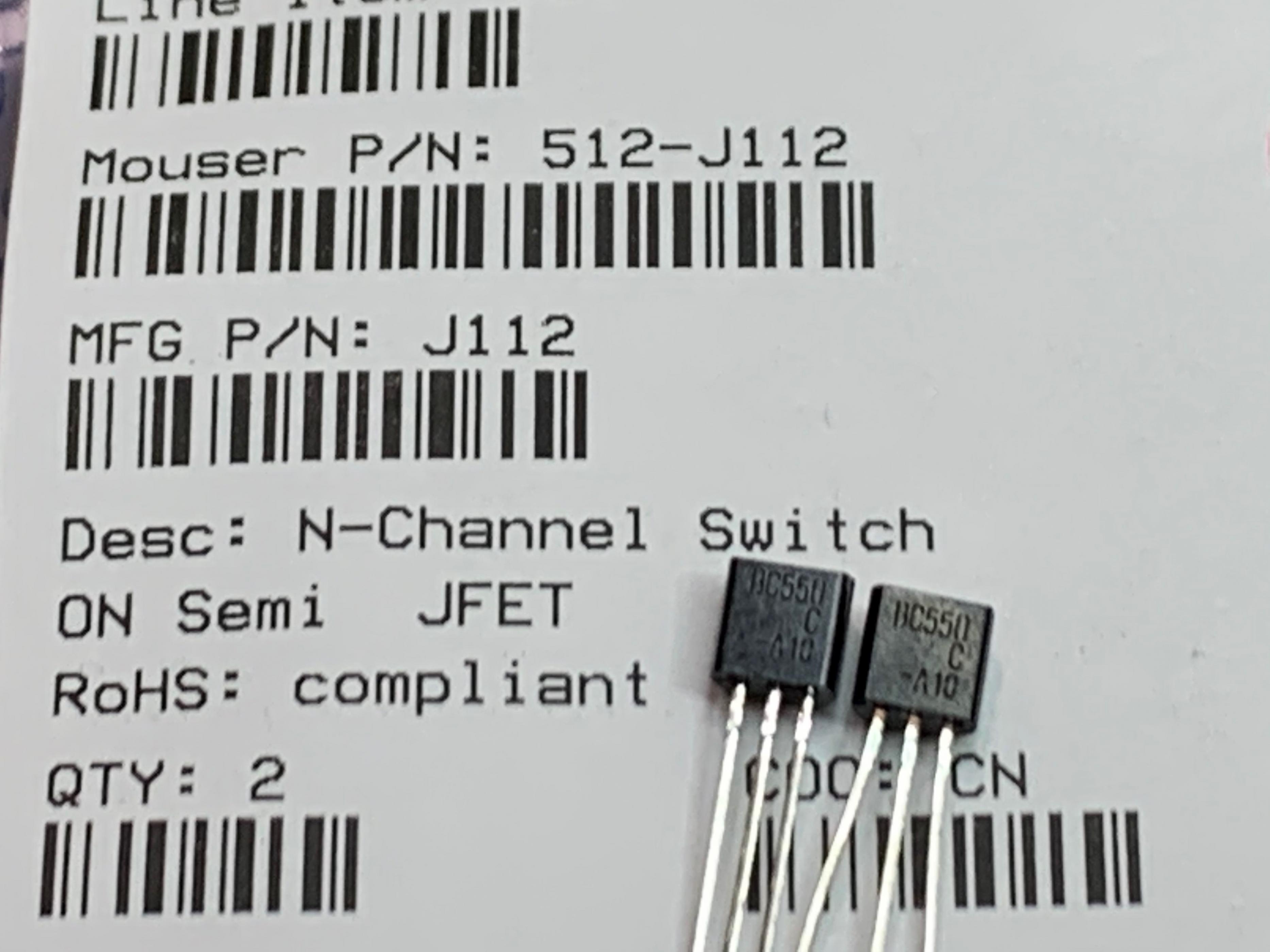

J1 in Mountain View? J112 is a JFET, and it is the correct part.
What schematic are you using? I'm not sure what you're asking re: the BC550.
Edited to add - I should have zoomed in on the picture. DOH! I see they shipped BC550 in the bag. Nice catch!!!!!
Will not work. Ask Mouser Team peoples is an error, they need shipp you J112 🙂 Good luck
Thank you! I already fired an email to Mouser.

Great catch! You've proven once again why it's so important to positively identify every part and test it before stuffing it in a board.

This is probably the problem if just sending the pre-fabricated "Mouser BOM"?

I’ll be interested in their reply. When I built my Pearl 2 in the spring, Mouser twice sent me the same two similar parts in the wrong bags. So two different pulls, same error. I never heard back from them after emailing support.

I got two emails from Mouser, promptly. Since the part is not available anymore, I was given an option for refund for credit or treat it as backordered item with availability in February 2021. I only ordered a pair and combined, cost less than a dollar. I choose credit, then ordered from a competitor instead.
