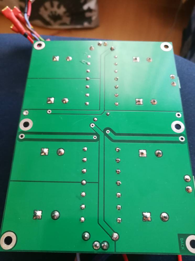

The two mounting holes are also connected to the gnd points as described in the photo and there is 0V IMG_20201219_231815.jpg

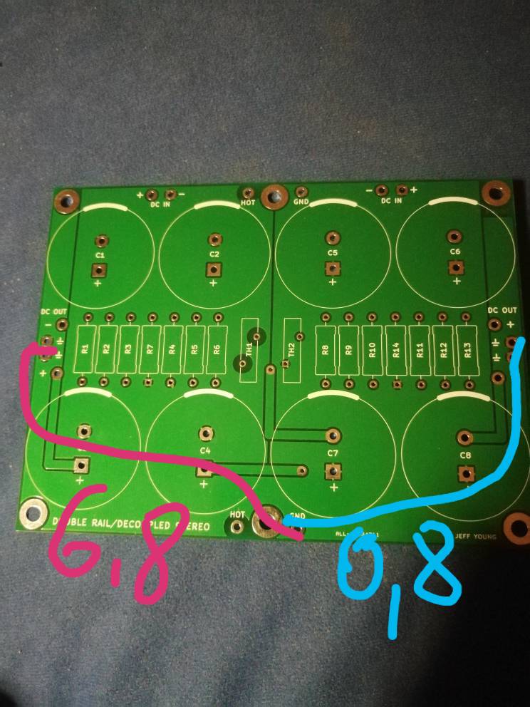

4 I turned on with both channels. No improvement, so 6.8mV on the right and 0.8mV on the left channel.

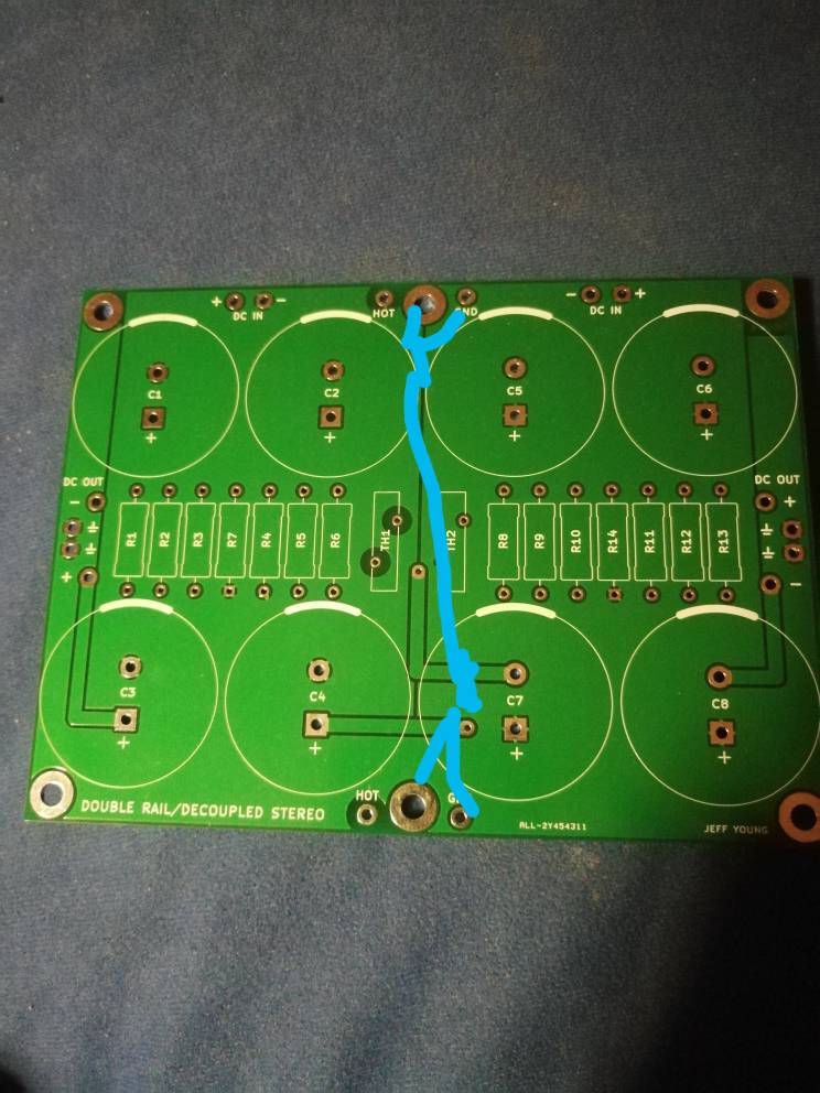

But between the two gnd-points.....20 cm from each other ......they are connected together via the PCB ground plane?
I can only thing about a bad connection.......
What is the voltage between the two gnd-points?
It must be zero......unless there is a very large current flowing between the two points...

I would try to also re-flow the solder joints for the capacitors. There must be an "unbalance" somewhere. When charging these caps very high current is flowing and if one has a bad connection you will have much more current flowing in one part of the PCB which can maybe cause a difference in voltage between the two gnd-points.....
Yes, and I would say that it can only be caused by an uneven current flow and my guess is it could be a bad solder connection of caps, filter resistors etc.....some kind of "unbalance" between the two channels. Maybe connection to the bridges......

Ok, but if you have 0 ohm between all the Gnd-points on PCB then regardless of which Gnd-point you measure from to chassis......it should measure the same. At least in theory. All Gnd-points on PCB are connected to each other via the PCB ground plane so you should not have any voltage drop in that ground-plane. Of course the world is not ideal....but here I think it should be "ideal enough".
Maybe try the DiyAudio Store universal PSU PCB next time :)
I can only confirm. All audio gnd points on both amplifier boards are 0R (cheap meter shows 0.3R) All gnd audio points to the chassis are 10R. Maybe I will ask the designer in his thread.
