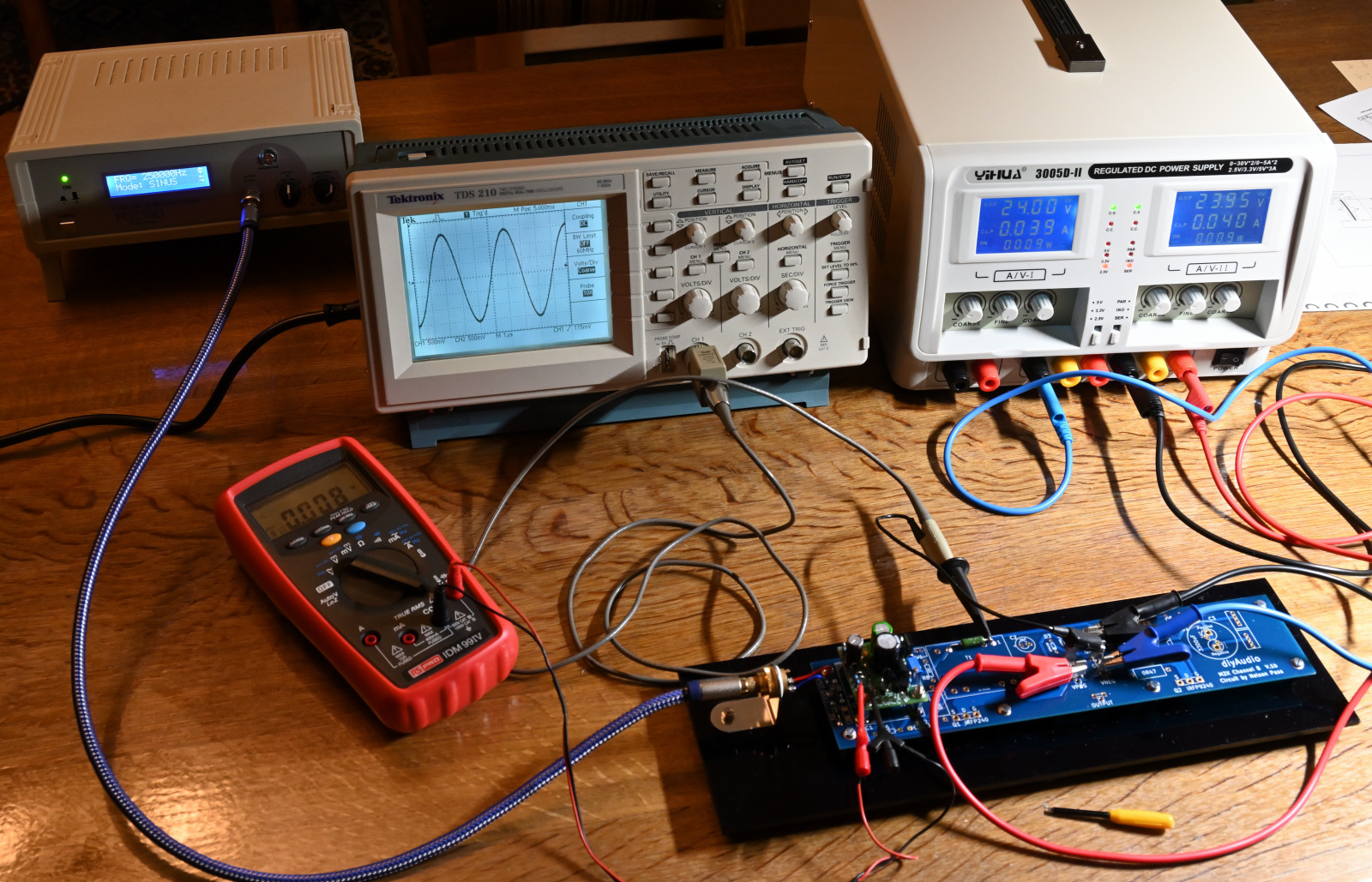

Here is one of the IPS#6 boards under test and adjustment.
250 kHz sine is not a problem and same with square wave. Scope trigges better on square wave than with Tucson when I magnify the rising edge. It is 100% stable.....but I don't know why. It is also just for fun I set the frequency to the generator max.
It consumes a lot more power than Tucson. -+24 V DC and 40 mA. It is about 2W and the large output transistors gets a little bit hot. Will see how stable I can get the 0V adjustment after 1/2 hour warm up or so. The final adjustment will be in amp. First IPS#6 seems to work as expected.

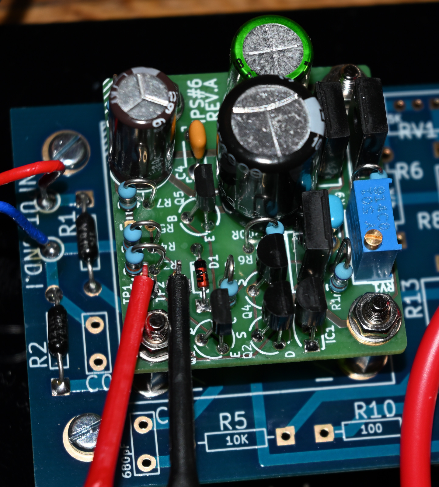

I made permanent test pints for the two test points. I use small hooks on the pins. Small good quality hooks are nice.

Regarding the temperature of the IPS#6 output transistors with -+24 VDC rails I used an IR gun and it showed just below 70 C where I got the max. reading.....so it is a little bit hot. What the junction temperature is....I should be able to calculate.....but I guess much below the max. temp it can handle.
The other IPS#6 board behaved exactly as the first one. 40 mA consumption at -+24 VDC and both boards are now adjusted and ready to go into the amps for final adjustment. The vertical position of the boards in the amp and that it is a closed box could change the working temperature a bit. I guess a few mV between the test points are ok.

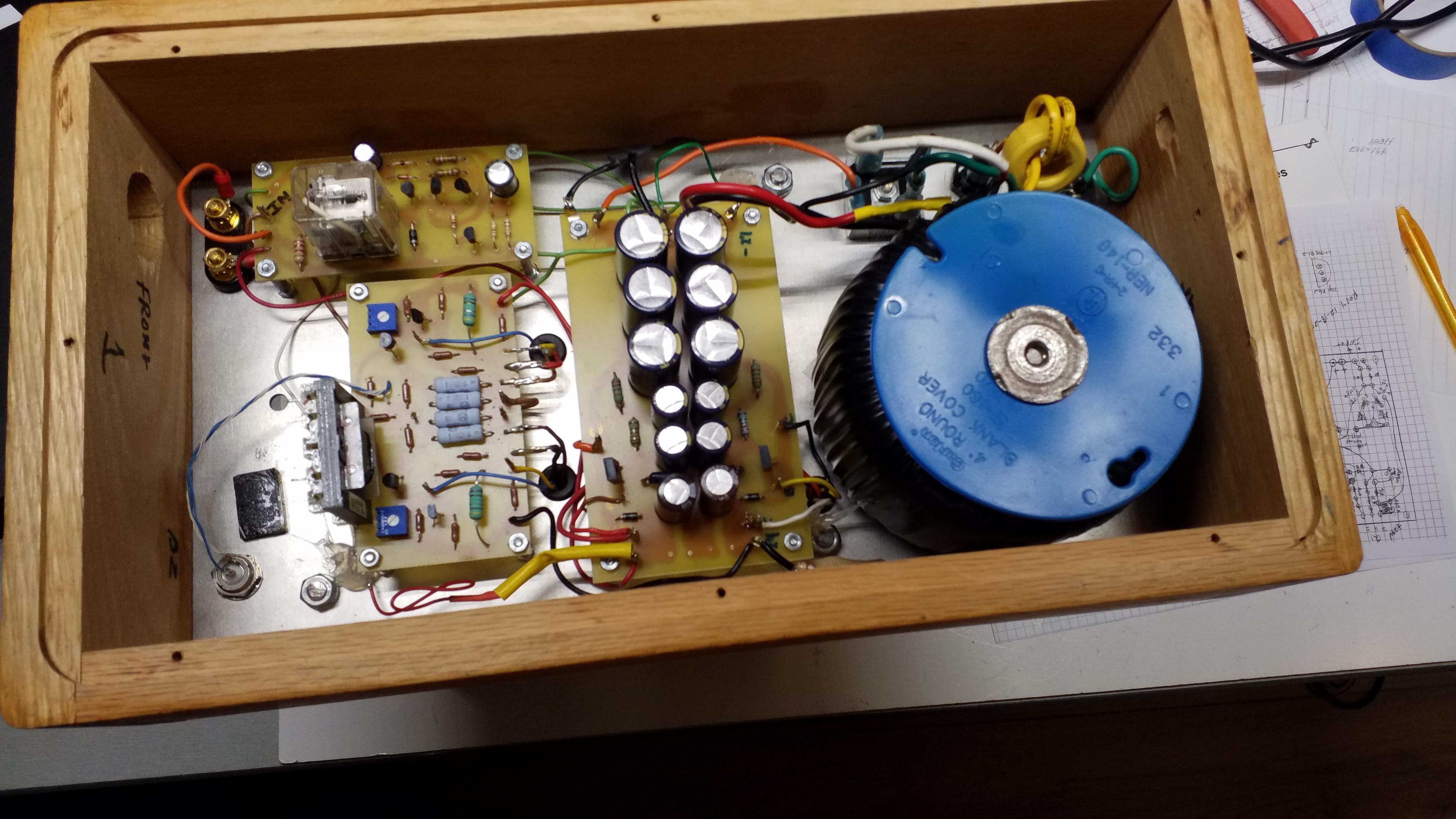

My Edcor transformers arrived today. I am retrofitting a pair F5 Mono-blocks I custom built years ago . My plan is to build a custom P.C.B. and do a board swap. I soldered the transformer to a test lead and hooked it to my oscilloscope . I then set it for maximum sensitivity. With the F5 powered up I moved the transformer around the chassis looking for minimum noise pickup. Minimum noise was found with both the toroidal and Edcor coil openings pointed in the same direction. The new board will have the transformer sitting on end.
