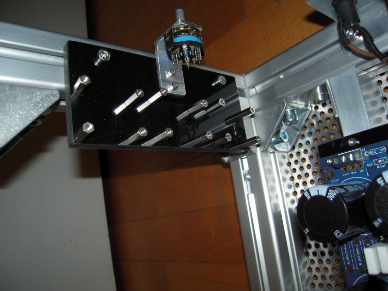

Depending if you have male or female thread for the input board mounting bolts......what about just using either "finger screws" or "finger nuts" then no tools are needed for swapping. I guess the contact pressure should be good enough.
I have seen some use a kind of smart mini connector so it is just to pull out the card and push another card in.

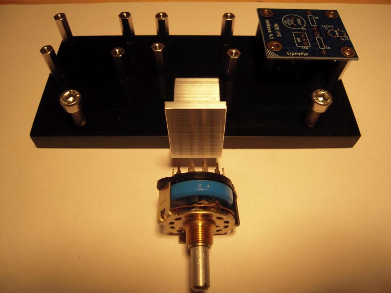

M2X- switchable inputboards
Hello M2X-builders,
I made a plastic - board with mounting studs (same pattern as on the M2X-main-pcb) for 3 inputboards and added a 4-pole - switcher.
Works beautifully for more than one year now. But I only switch between the
input-boards if the amp is off. Not during operation.
Greets
Dirk

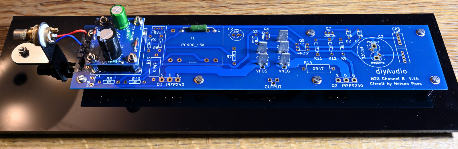

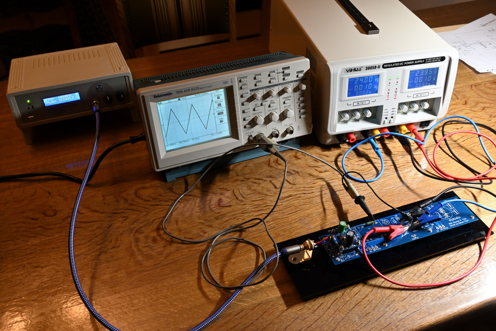

I spend a few hours making my own "test bench" for M2X input boards. I used a spare M2X amp board and just soldered in the "front end" and PSU connectors. Instead of Edcor I placed a 1k load resistor. This also to be able to have an easy contact point for a probe. A real Edcor as load will of course be much more realistic. But just to check/adjust DC and a functional AC test I think it is ok. On picture a 10 kHz saw-tooth is the input signal from a cheap generator. Output shown on a TDS 210. I used a Tucson input board for testing the "test bench". The real purpose is for IPS#6 which will be next.....
