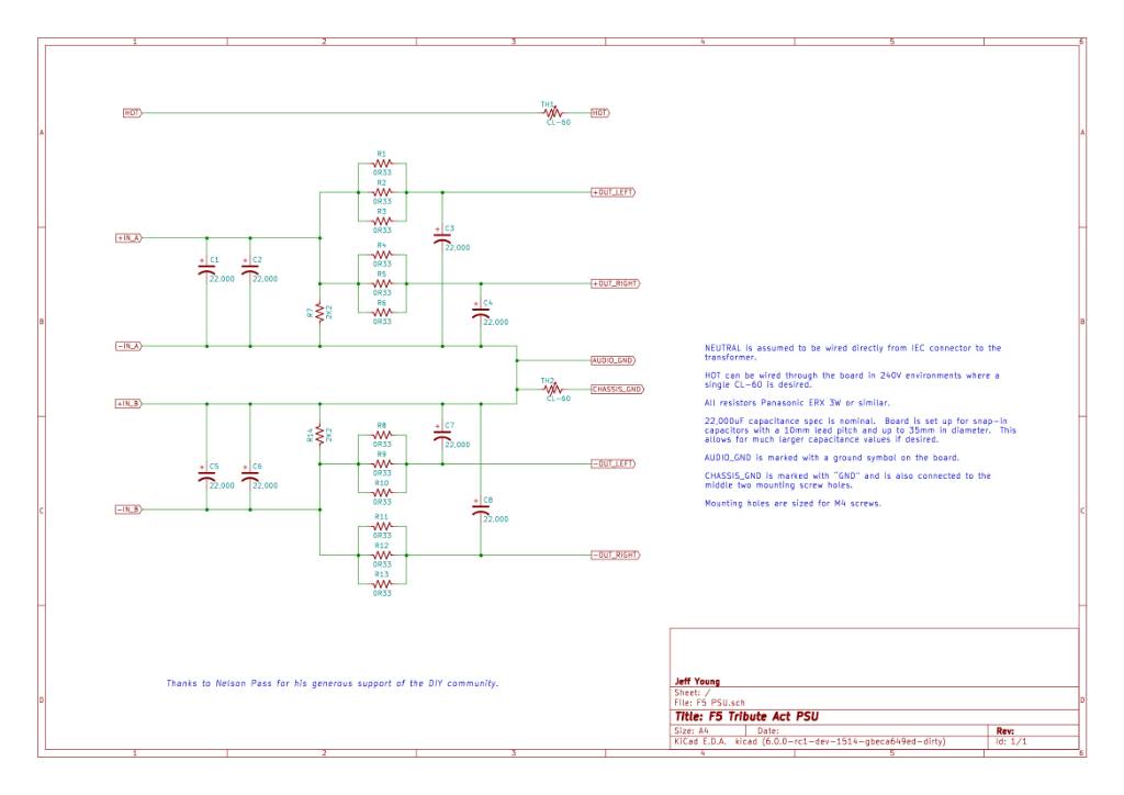

My crc filter I show here:
The diyAudio First Watt M2x

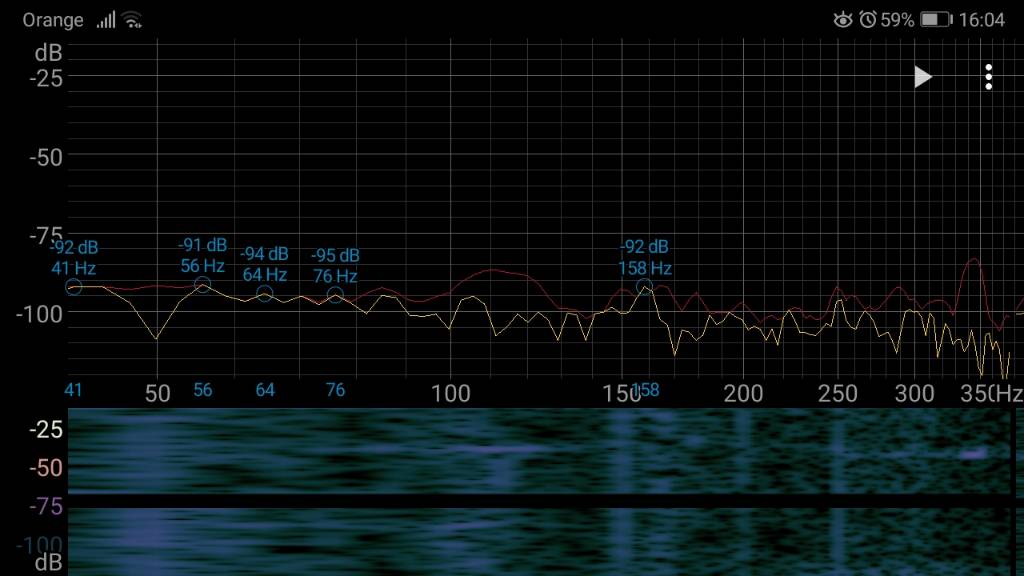

This is probably not the problem of the power supply, since Mountain View causes a 100hz hum. There is a little more noise from both channels . The pictures for comparison (phone about 3-5 cm from the speaker):
1-MV one channel
2- MV both channels
3 - Ishikawa one channel
What should I do to fix this?
1-MV one channel
2- MV both channels
The Ishikawa has a symmetrical design with a matched N and P channel JFET and is good at suppressing ripple noise on rails.
Mountain view seems to be not as good to handle this issue......and if I look at output stage Mountain view is not symmetrical. The 100 Hz noise is from PSU. So with the amount of ripple you have in current PSU you need good ripple rejection and Ishikawa is good at this and probably Tucson is also quite good.
Do you still think there is a problem if Ishikawa is used as input boards?
The only fix is to reduce noise in PSU......I have no better suggestion.....

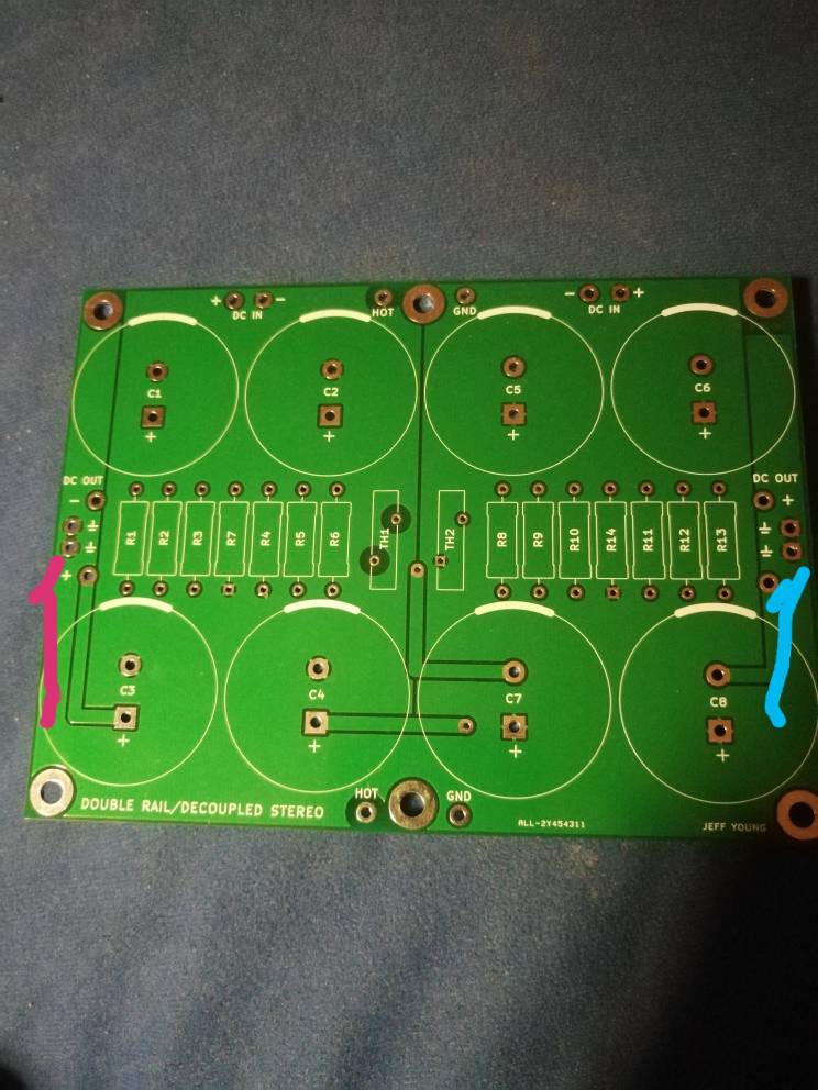

Following your advice, I checked the voltages and all points were 6mV. I thought about the chassis and found an interesting thing there.
As you will see in the schematic, gnd PS connects to the chassis through a thermistor. Here's what I measured:
Left 6.8mV to chassis
Right 0.8 mV to chassis
Can the thermistor be damaged? Or something else? One time something went wrong when I connecting the board and three resistors R1, 2 and 3 burned. I replaced them.What else might be damagedg- bleeder? caps?

OK, so you measured signal Gnd to chassis?
I thought you measured left signal Gnd to right signal Gnd?
But you should measure exactly same values......signal to chassis....left and right. So you have a "resistance" somewhere in left channel.
I think a CL-60 is hard to damage.....you would see sign of that kind of damage. It probably measures about 10 ohm?
