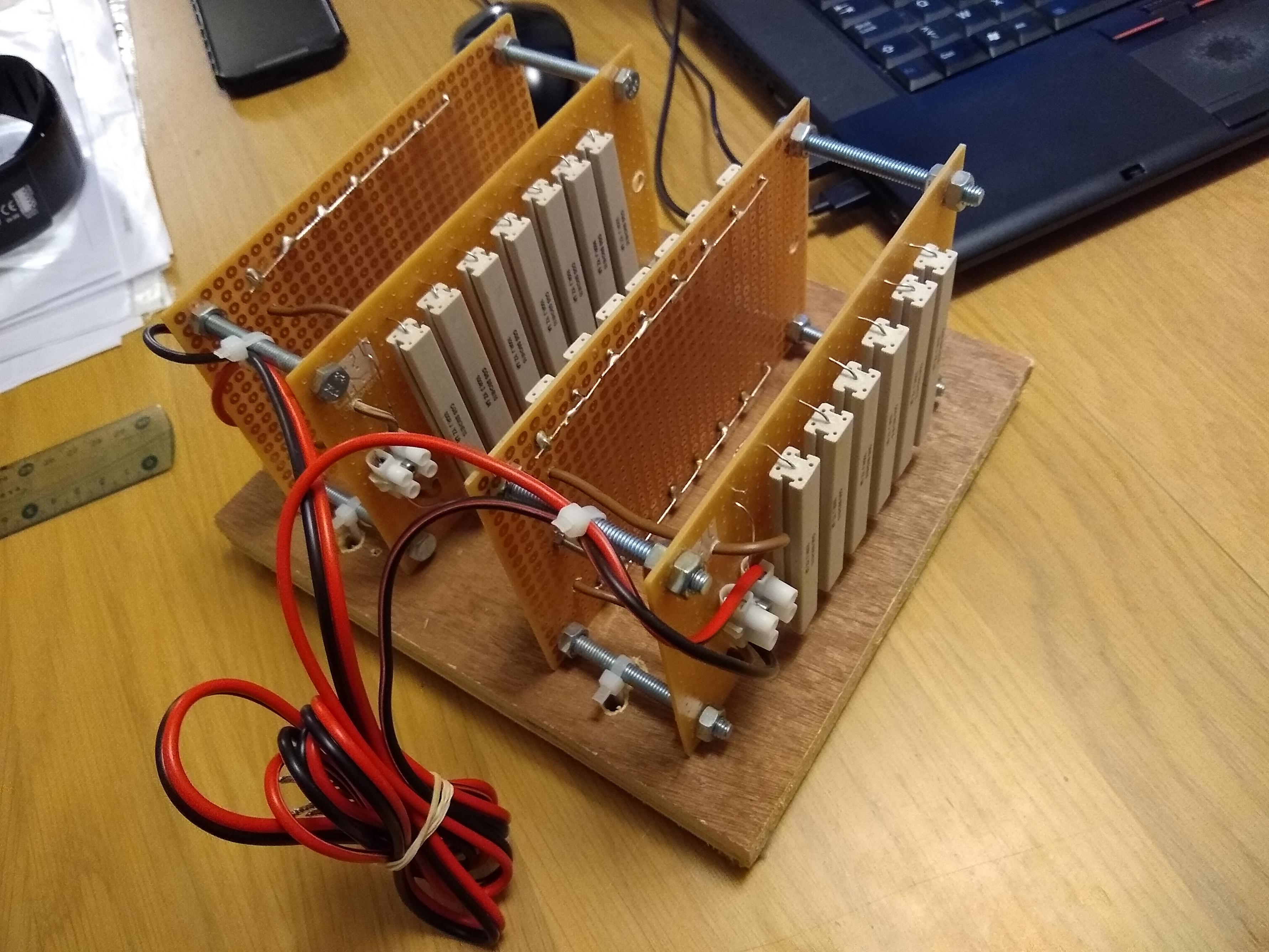

Recently completed my M2X, I build Ishikawa (like official M2) and MtView boards.
To me the Ishikawa and MtView sound pretty similar (but I dont have the most revealing setup), removing C0 from the main board made no audible difference to me.
No hum, dc offset at -55mV and -88mV . Did load testing (I build a stereo 7.6ohm load with 13x15W ceramic resistors/channel) at max power. No blown fuses or anomalies.

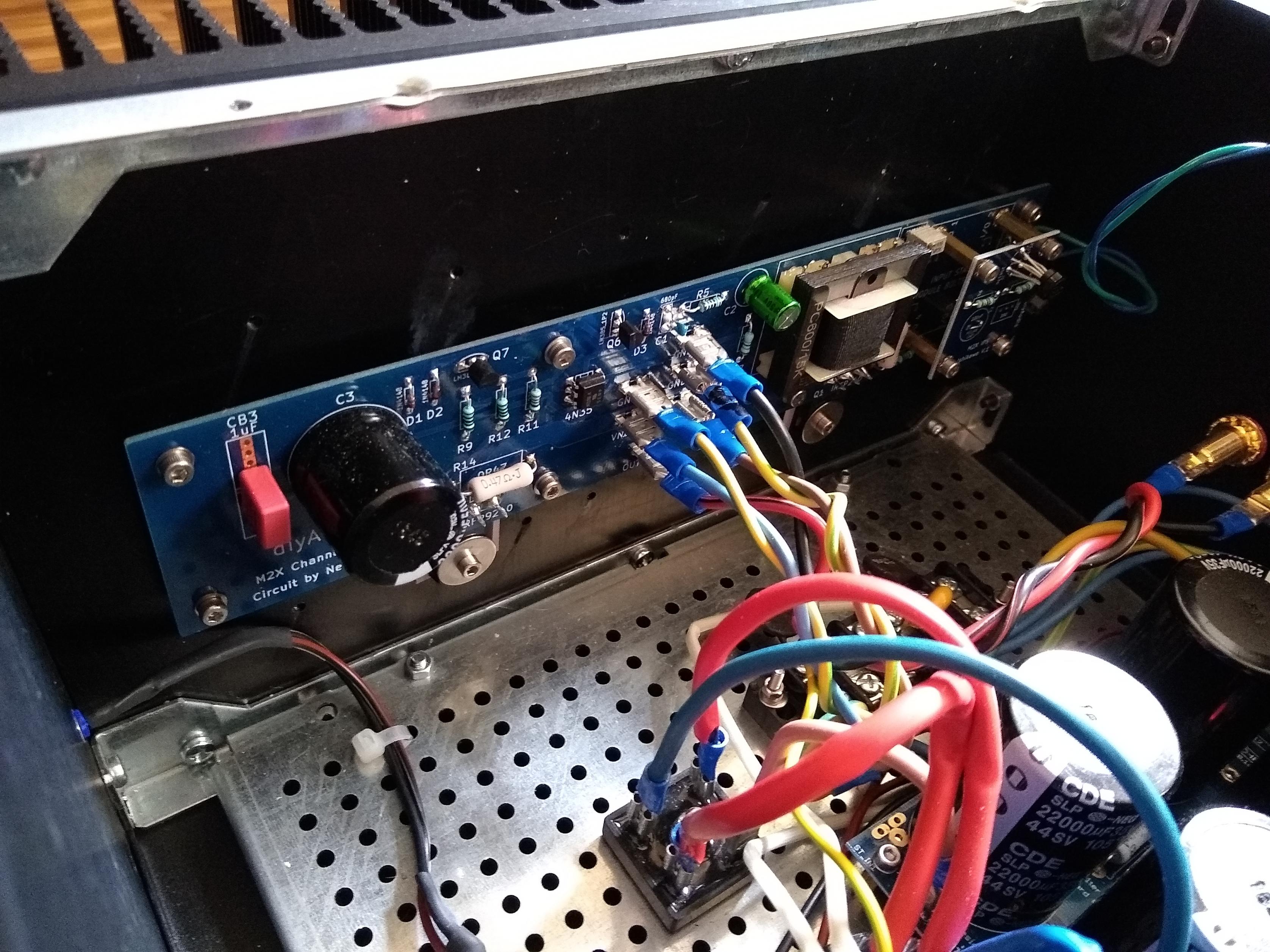

I have been working on this for a while now and still can't figure it out. I have checked and rechecked everything. It all seems to be correct. I probably missed something. I have one working board and one that won't bias. I took off the input stage just to be sure , but that didn't change anything.
I have included a picture of the schematic with the measured board voltages. The bad board voltages are highlighted in red. The voltages were taken after the good board comes up and the voltages drop from +/- 25V to +/- 22.7 V. If I unplug the good board the rail voltages stay at +/- 25V for the bad board.
The good board MOSFETs turn on the heat sink heats up. I was able to zero out the output and run signal through it.
Hopefully someone else has seen this. I'm sure I will say duh! after I find the answer. Any help or advice will be greatly appreciated.

Thanks for the reply Zen Mod,
Of course I figured it out shortly after I posted. The voltage between R8 and Q5 was the same as between R7 and Q5. So the CB3 cap must be shorted. I think I probably heated it up too much when I installed it. The 1uF cap read 20 ohms with the multi meter. I replaced it with another cap and now it works.

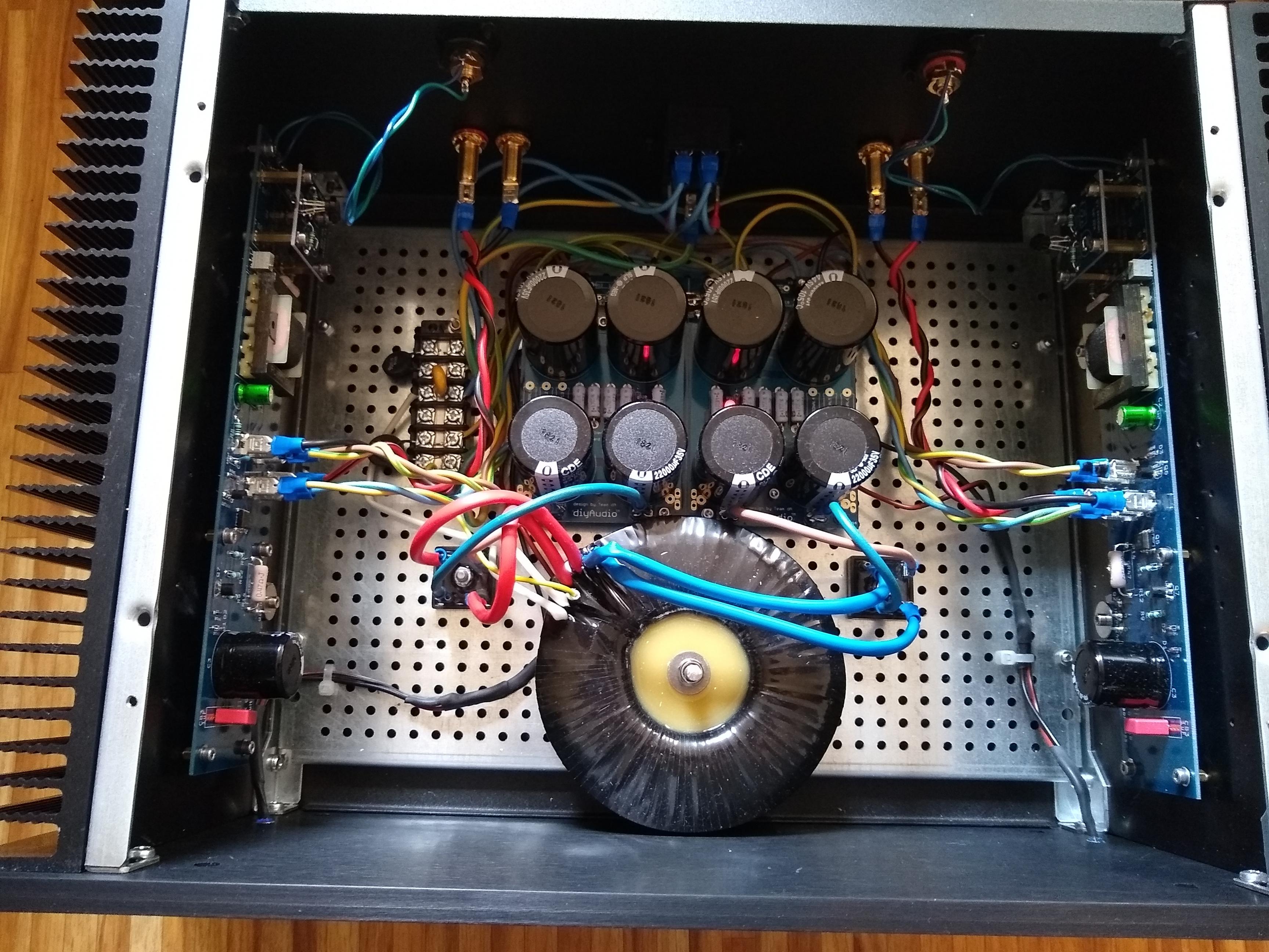

I just finished my M2x and have little bit hum too. I think that edcors picking power tranny hum. So my next step is to try Mumetal shielding.
I ordered this Trafo shielding sheet, 14,90 € and no more hum. i like MountainView input stage.

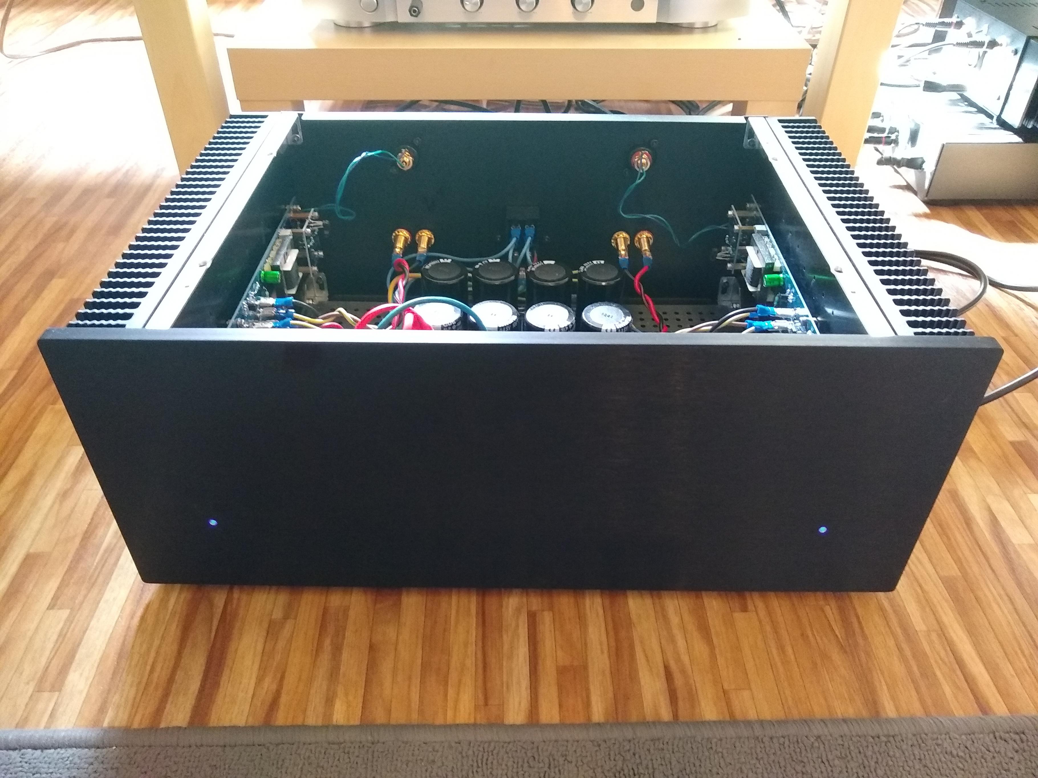

After about a months worth of spare time on the bench she is now warm and breathing music in my system. It has a Mountain View input buffer. None of the top end clinical harshness of the F5 just smooth creamy music.
Thank you Mr Pass for your generosity to this forum and Mark Johnson and 6L6 for making his generosity comprehensible and straightforward for us mere plebeians. If anyone is thinking about building a First Watt amp I can definitely recommend this one.
