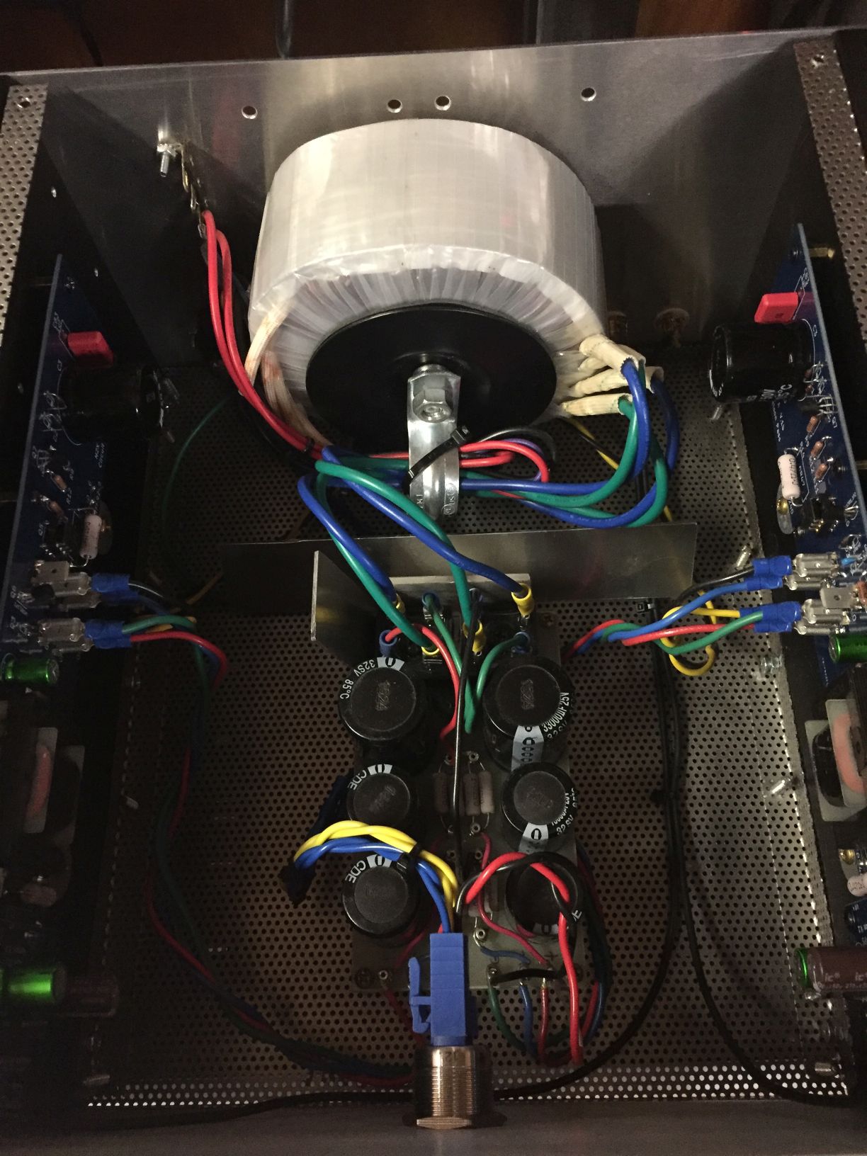

with no grease on GBP , in original FW case , there is hardly 55C on bottom of the case , ditto where bridges are bolted
same applies if you mount bridges on Modushop case perforated base plate , no goop

The dataseet figure is shown below. At 18 amps average current, the bridge rectifier will be just fine if you keep its case temperature below about 95 degrees C. Of course it will be very happy if you keep its case temperature far, far below 95C. But it will thrive and prosper and meet its specifications even at 95C. Conservatively._
Went back and took more careful measurements. I measured 72 deg C. on the my mounting bolt heads and 62 deg C on the aluminum. Then I went and added a few more bits of scrap aluminum and some arctic silver between all the critical surfaces. I now measure 60 deg C on the bolt heads and 55 deg C on the aluminum. Much better. I measured 38 deg C out near the ends of the wide piece of aluminum so I don't think the extra metal needed to be as wide as it is.
Note: bottom panel of the Pass Labs M2 appears to be brushed, black anodized aluminum, a much better conductor and radiator than the diyStore galvanized steel base plate

Hello avdesignguru, I think you are wise to be skeptical of thin, steel, mega-perforated bottom plate as a heatpipe / heatsink. Certainly I myself am skeptical.
But measurements beat opinions every time and you've got measurements. Continue kicking buttt and taking names. Proceed!

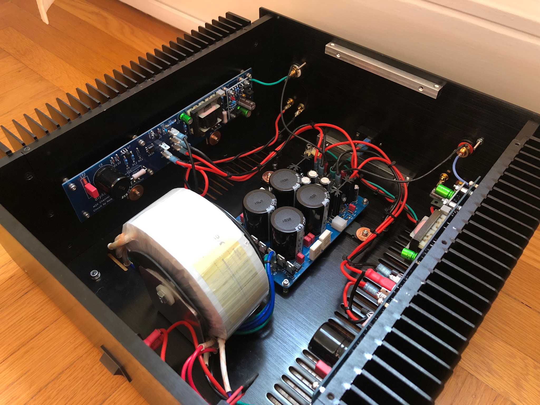

This was a nice build of the M2X by SLK23 (post#2272)with the SLB power supply.
The diyAudio First Watt M2x
