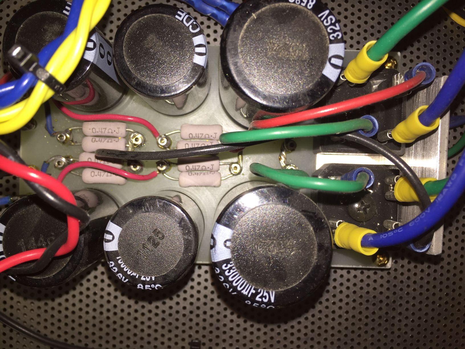

Bridge Rectifier Heat Sinking
It's hard to see in the photos, do you mount the rectifier diodes to the perforated floor plate? If so, does it provide enough heat sinking that the diodes run acceptably cool?
Mark
Took some temp readings. The chunk of aluminum under the rectifiers is a bit smaller than I remembered. Aluminum measures 55 deg C at idle, 61 deg C with one channel loaded with 1KHz input at 10VRMS output into a 3.2 ohm power resistor load. I will probably substitute a larger piece of aluminum and use some arctic silver to see if I can get the temp down for longer term reliability.

Do I understand correctly: the assembly of the rectifier bridges on the perforated mounting plate is insufficient to cool them?
Hard to know for sure. In Batty's post #2461 he noted 80 deg C mounted to the perf plate. Since it is steel, it's not that great a heat sink. Some type of thermal compound might help.

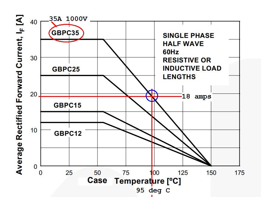

The GBPC 35 series bridge rectifier data sheet ratings are at 55 deg C which implies a need to de-rate the device above that temp. But 35A is very conservative for this design. Data sheet also states a max diode junction operating temp of 150 deg C. Seems getting the bridge down to 55 deg C is a worthy goal.
Not sure if 6L6 or others are reading this and have also taken measurements and/or want to weigh in on the diyStore chassis sub plate adequacy as a heat sink for the bridges.
https://www.mouser.com/datasheet/2/308/GBPC3506-1301062.pdf

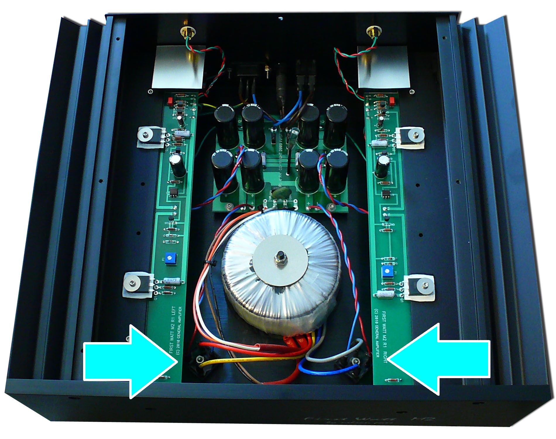

My M2x uses two GBPC3510 bridge rectifiers, mounted to the chassis floor with nothing more than a bolt and some heatsink grease. When I look at photos of the original First Watt M2 amplifiers that were built by Nelson Pass and sold to customers for real money, I think I see the same thing: GBPC bridges bolted to the chassis floor. (Blue arrows)
According to the First Watt user's manual on their website, the M2 amplifier draws less than 160 watts from the AC mains. Thus each of the two transformer secondaries delivers less than 80 watts. The secondaries are 18VAC (RMS) so the current in each secondary is less than (80 / 18) = 4.5 amperes (RMS).
Applying a very conservative 4X margin-of-safety, I'll check the datasheet's max allowed temperature when the bridge rectifier current is (4 times 4.5 amps). Namely, 18 amps.
The dataseet figure is shown below. At 18 amps average current, the bridge rectifier will be just fine if you keep its case temperature below about 95 degrees C. Of course it will be very happy if you keep its case temperature far, far below 95C. But it will thrive and prosper and meet its specifications even at 95C. Conservatively.
