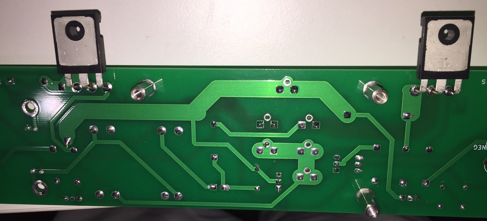

Here is an M2x amplifier board removed from the heatsink and turned upside down.
The picture shows the electrically conductive backside tab on each of the power transistors; the IRFP9240 datasheet calls this tab "Pin 4" and tells you that it is internally connected to "Pin 2" which is DRAIN. You can also see that there is quite a large gap between Pin 4 and the hole in the plastic where the mounting bolt passes through. When the bolt is correctly installed, there is no way for the bolt to short to Pin 4.
I suspect that there are one or more regions of the Pin 4 metal tab, which do not have Keratherm insulator below. Either due to misalignment, or due to a pinhole in the Keratherm.
I bet if you connect one end of your ohmmeter to the heatsink (perhaps using the mounting bolt of the other transistor), you'll find that this transistor's drain is shorted to the heatsink even when its mounting bolt is completely removed. Unscrew the bolt, use your thumb to press the transistor down onto the Keratherm, and make the measurement. I bet you'll find that drain is still shorted to heatsink. Which means the bolt is not the problem. Keratherm is the problem. You can verify this by temporarily sliding a 3 inch by 3 inch piece of copier paper between the transistor and the heatsink. Reinstall the bolt (it will easily pierce the paper) and tighten it down. Has the short between drain and heatsink disappeared? I bet it has. Yet the bolt is there. So the bolt is not the problem. Keratherm is the problem.

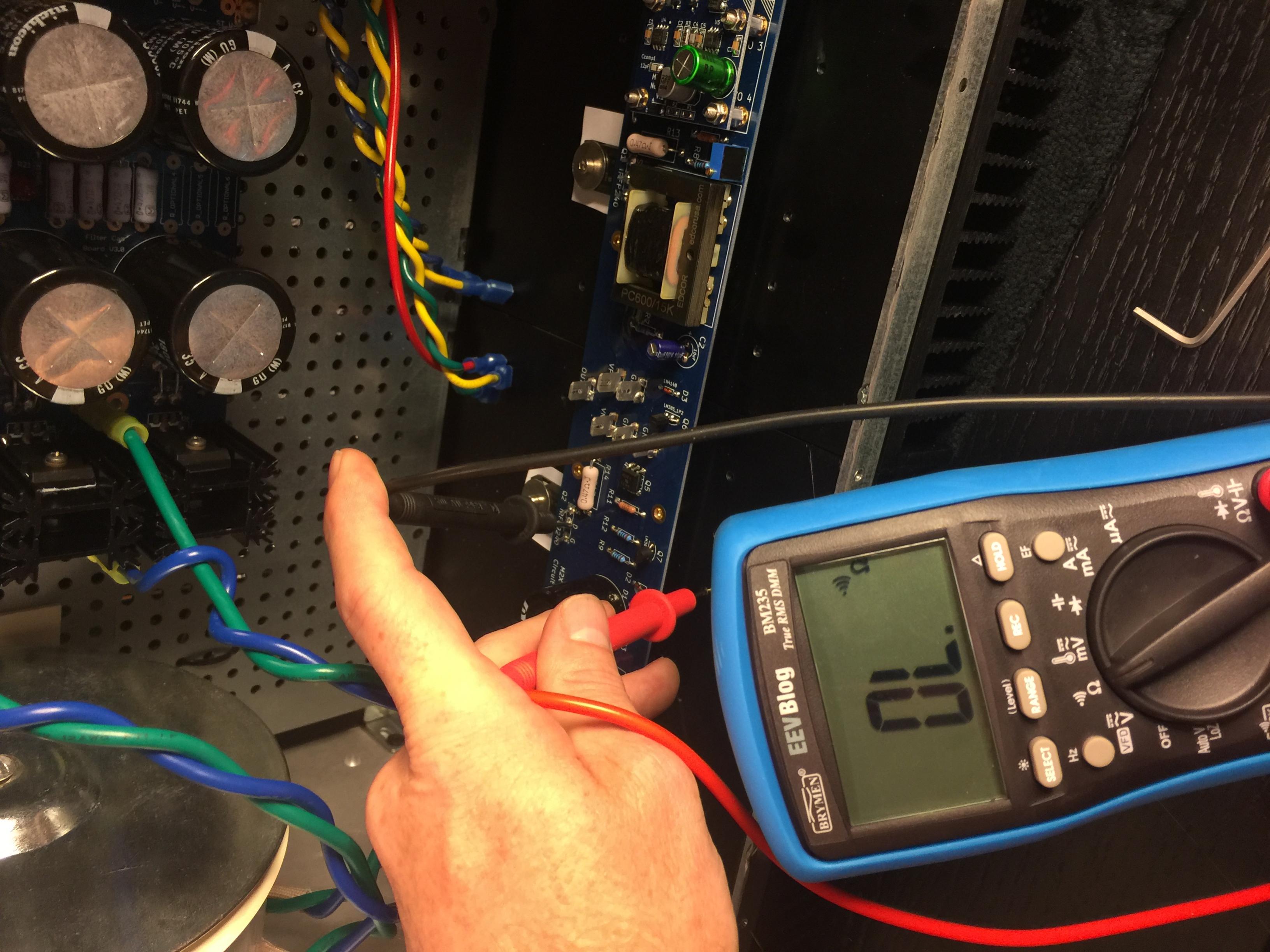

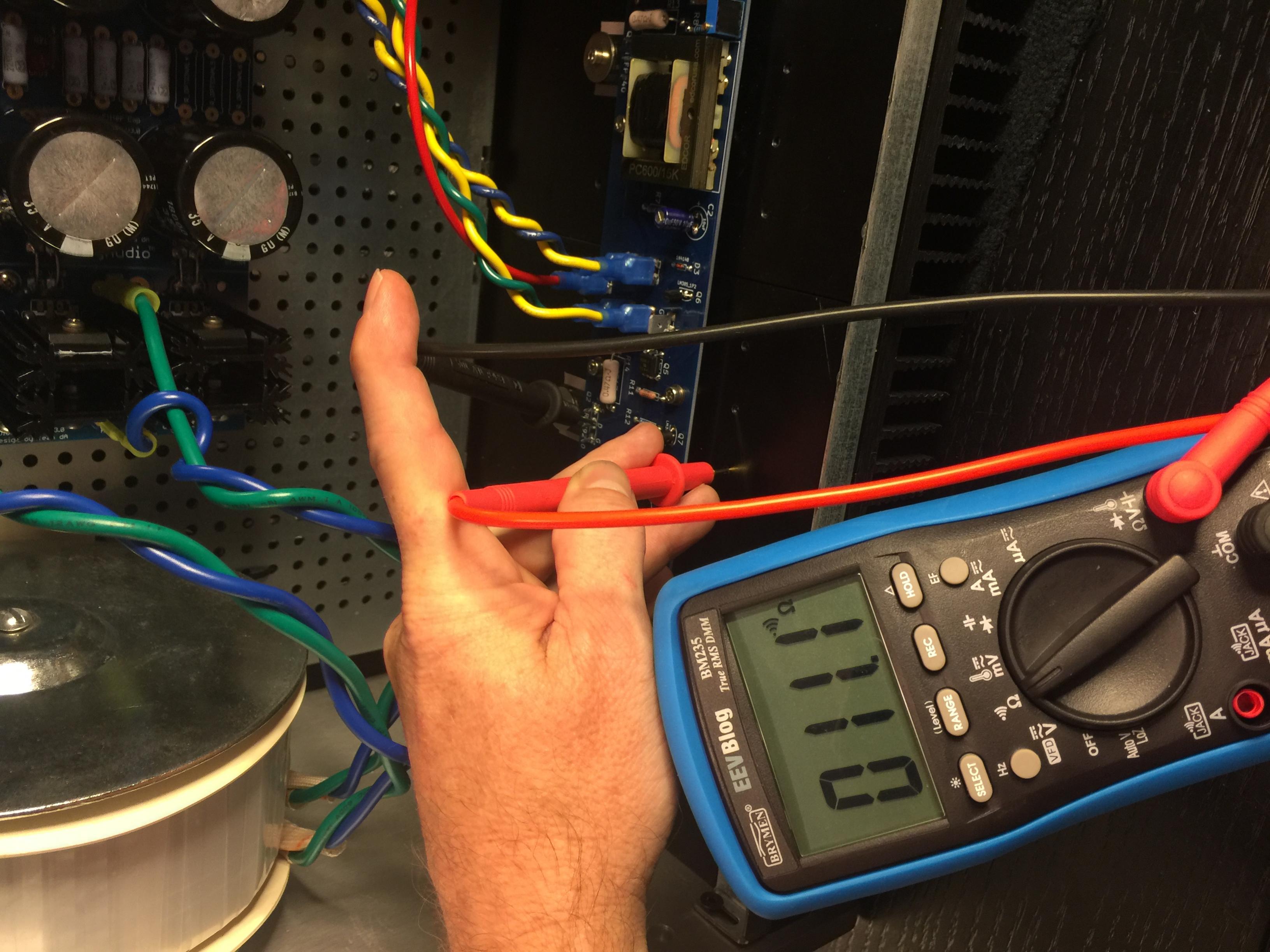

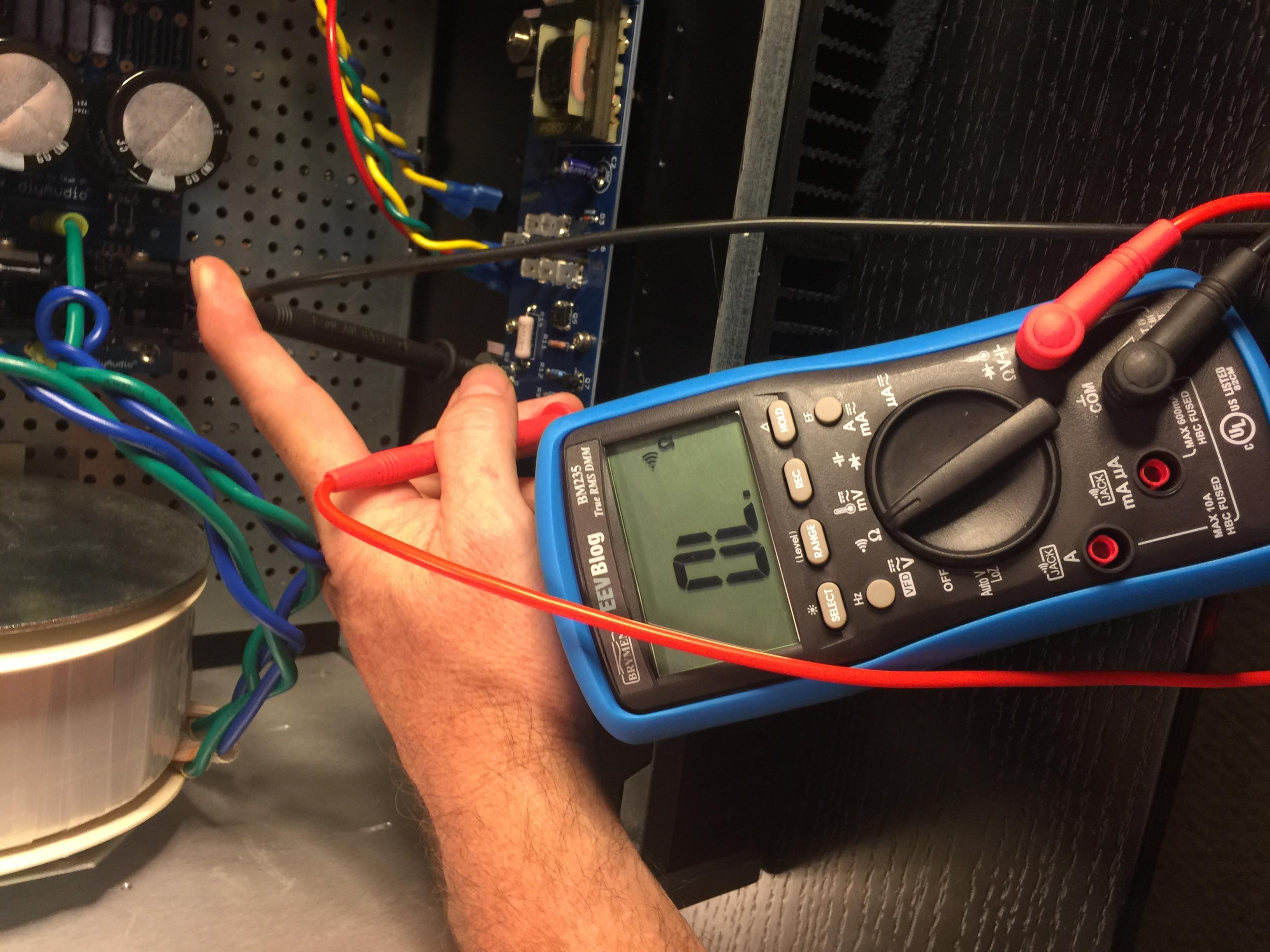

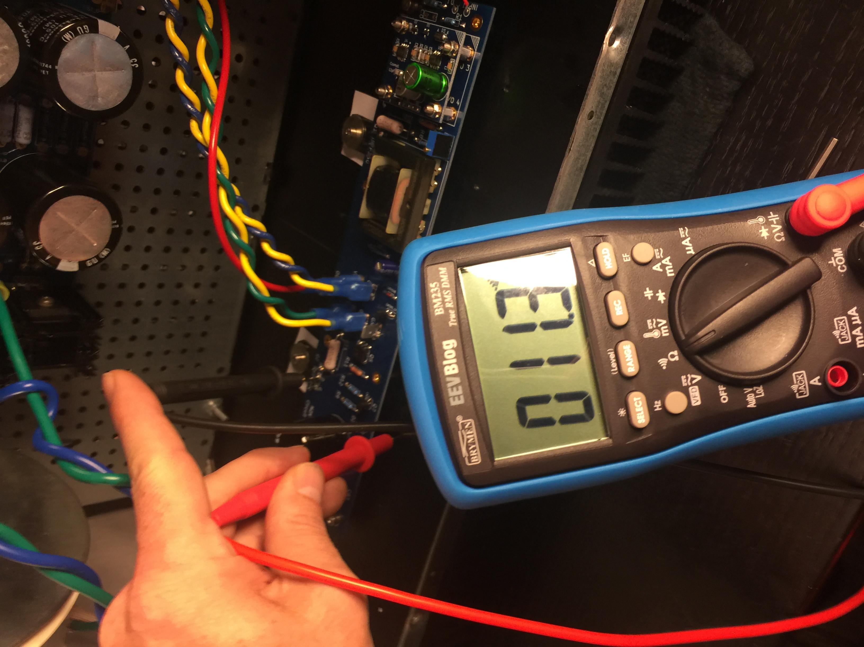

Pictures may be more clear than my explanations. I was simply using the bolt as a substitute for the heatsink since it's easier to get good contact. In the pics below, I ensured I had good electrical contact with the sink through a mounting hole and the drain for Q2.
Sadly, they're rotated 90 degrees, but it should be clear.
The first picture shows the behavior with the new Keratherm with all the standard leads attached to the board - continuity. Resistance from drain to heatsink (11 ohms)
The second picture shows the behavior with the same Keratherm with the connections removed. No continuity.
The third picture shows the behavior with the paper with all the standard leads attached to the board - continuity. Resistance from drain to heatsink (11 ohms)
The fourth picture shows the behavior with the paper with the connections removed. No continuity.
As always your guidance is appreciated.
My forum skills are lacking - edited to show pictures.
