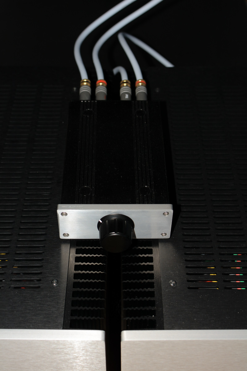

I think one of the reason my M2X mono blocks is a success is that it is easy to drive using a passive pre and this gives me the perfect amount of amplification. When passive pre is set to 2-o'clock it plays quite loud when playing blues, jazz, rock etc. and perfect loud when playing classical music. So depending of mood and time of day the vol. settings is from 11 o'clock to 3 o'clock which is perfect. Then I don't add additional noise from an active pre. If I should experiment I could try just a B1-bufffer but I don't feel the need for it in the moment (it will just add noise). It is very dynamic as is. I have never felt that a passive pre "kills" the "dynamic". My RCA cables are also on the short side (75 cm) and my Bluesound node has a good output driver. I like RCA connectors that you can "twist lock" (like WBT). I have experienced bad RCA connectors even on quite expensive cables. The Supra cables I use are just perfect (price/quality).

I have a Korg. He is "sleeping" in the moment. It sounded really good with MoFo but with M2X the amount of amplification was way too much. The 10k 24 step Goldpoint attenuator is a much better combination. Input board in M2X is Tucson with OPA604. Next input board to try will probably be Norwood. Until now Tucson is the only one I have tried.

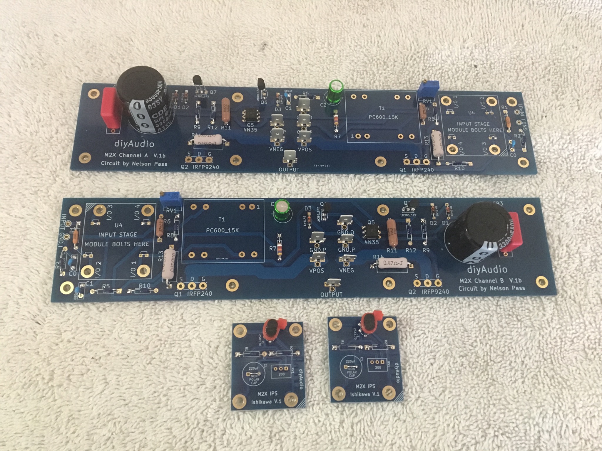

I've been getting ready to build a few additional FW designs, but the M2x is still getting a ton of play time. Since it was my first speaker amp project, I've been a bit paranoid about monitoring how well it holds up (related to my build quality).
I am currently swapping out C2 for the recommended Nichicon cap, and I was swapping over to the Austin boards from Norwood. Every time I get inside the amp, I check everything over. I started with the left channel. Since I had to remove the boards from the heatsinks to swap the caps, I checked for continuity between all three legs of the 9240s and the heatsinks after remounting the board. My observations trouble me. Since memory is a tricky thing, I need some help, please.
It may help if I denote the 9240s Q1R, Q2R, Q1L and Q2L. Keratherm pads and the mounting kit from DIY store were used, and the amp has been a total delight with no issues to this point.
1) Observations after re-mounting the left channel (after the cap swap).
The drain leg of both Q1L and Q2L are shorted to the center bolt / washer holding the FETs to the heatsinks and thus to the ground on both the amp boards and chassis ground. I see no holes in the Keratherm or anything that would give me pause.
2) Observations for right channel. This channel was untouched and has been running this way for months. I have not unmounted the board.
The drain leg of ONLY Q2R is shorted to the bolt / sink / etc. Q1R shows no continuity to the heatsink / center bolt.
I went through all my build notes, and could not find the appropriate section... but I thought NONE of the pins should short to the heatsinks.
Could someone please confirm and/or comment. I do not want to proceed w/o furthering my understanding. Any thoughts for troubleshooting are greatly appreciated. It seems odd to me that the amp has been functioning without flaws and sounding great for months with this potential "defect". I know I checked for continuity during final assembly.
With thanks as always.
Edited to add - if it helps, the resistance between the mounting bolts and the GND 0 tab on the boards is roughly 11 Ohms for the 3 FETs showing a short.
Edited to add again - SHEESH - I hope my goofs help some others. Because I didn't want to disconnect everything to take out the boards, I left the output signal wire and the PSU attached to the boards. DOH! I found my notes, and I checked continuity BEFORE powering up the boards and hooking up the power supply and outputs. So, looking at the schematic explains the drain to ground continuity. However, any reasons or concerns that Q2R drain does not show continuity like the left channel with the amp wired to operate (with PSU and output connected)? Thanks again!
