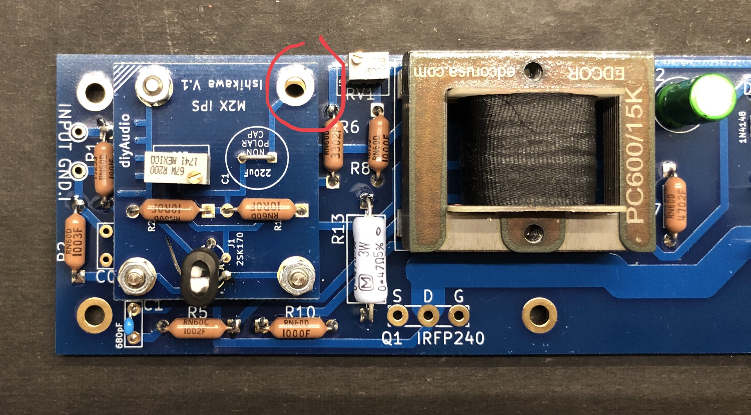

RV1
Not sure if this has come up before but RV1 in the amp board BOM is specified as a TT 64WR5KLF. W-series has offset pins. Y-series has straight line pins. The BOM correctly describes it as "three pins in straight line" but just blindly ordering the part number gets you the wrong part. I know, I did just that.
The correct part number would be 64YR5KLF (or 64YR20KLF if doing the modified version of the circuit).

I agree, the part# field of the BOM is wrong but the description is correct. Thank you for pointing it out! I will find out what we need to do to make the correction, and to get the updated BOM loaded here.

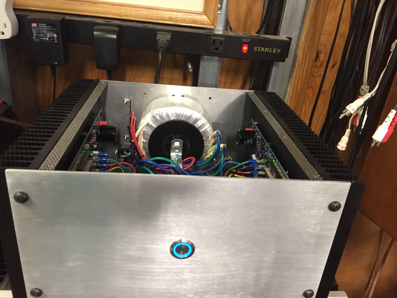

Just finished my M2x. Loaded some Tucson boards, let 'er cook awhile until stable and zeroed out the DC on the loudspeaker terminals. Initial impression, very favorable, and it's not even burned in yet. The auto-biased outputs are running cooler than my F6, at around 45 - 47 deg C. I had to bias the F6 at 1.6 A (almost 60 deg C) to get it to sound good. Could not stand to listen to the F6 at the initial build guide 1.05 amp bias. The Tucson/M2 sounds a bit cleaner and more forward than the F6, not quite as laid back. Burn in may change that. Now I'm looking forward to comparing the sound of the other M2 input modules to my reference F6.
Side note: I was re using some 4RU 300X165 diyStore heat sinks from another build and wanted to limit the number of new holes to drill and tap so my M2 boards ended up offset to one end of the heat sinks. This is about an inch off center, horizontally. Interestingly enough, that makes a measurable difference in the mosfet case temperatures. 47.8 deg C for the devices 1" off center and closer to the edge, 45.0 deg C for the devices with more heat sink available horizontally. So layout is critical, even on the big heat sinks.
FYI, the power button is a 22mm latching push button w/ blue LED ring, where the ring moves with the button. Much nicer than the 19mm by the same manufacturer, where the ring is fixed, making the button effectively even smaller. Well worth the extra $3.60. I used an extra 15K ohms external to the LED to add to the internal resistor rated for 12VDC supply. A casual look at the specs make it seem this switch only has 12V rated contacts but the expanded specs show 250V/5A. A 10A rated version is available for a few dollars more.
Amazon.com: API-ELE [3 year warranty] 22mm Latching Push button Switch 12V Angel Eye Ring Light LED Waterproof Stainless Steel Round Metal Self-locking 7/8'' 1NO 1NC (Blue): Automotive
That is a good looking build! I like the 22mm illuminated power switch, and the fact that it's rated for 250VAC as well as 12VDC. Thanks for the lead.

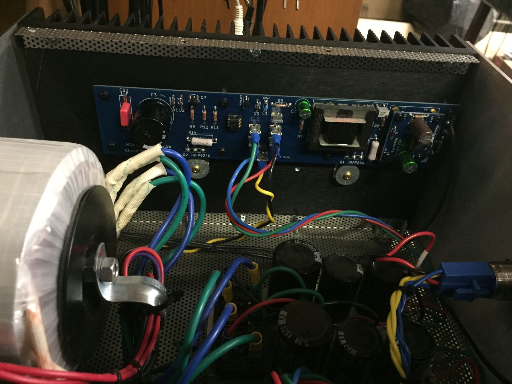

I used a smaller chassis for my M2x, about 2.5U tall and 400mm deep. I wanted to place the Edcor transformers as far away as possible from the big power transformer, so the boards are not centered on the heat sinks. Yes, the rear of my amp runs noticeably warmer than the front, but bias and offset are stable, and it sounds wonderful. I also used IRFP9140s for the P-type to get a closer match to the transconductance of the IRFP240s, so letting the 240s run a little warmer may just add a little H2 warmth to the sound.
Congratulations on a lovely build! The front panel looks stark and imposing.
It's hard to see in the photos, do you mount the rectifier diodes to the perforated floor plate? If so, does it provide enough heat sinking that the diodes run acceptably cool?
Mark
Power supply is built on old school 1/8" fiberglass G10 board with staked hollow turrets. The board is up on standoffs. That allows wiring between the turrets above and below the board, like a double sided PCB. Wire wrapped and soldered to the filter cap snap-in terminal lugs on the board underside keeps the caps tight to the board on the top side.
The 35A bridge rectifiers are mounted at one end of the board with a full width piece of 1-1/4" X 1-1/4" aluminum angle sandwiched between them and the board for heat sinking. I have not measured temp under load but will do that, report and send a better pic.
Total investment in the empty chassis is under $100 including the $70 heat sinks. It consists of a 0.125" plate aluminum front, a 0.063" plate aluminum rear and some 20ga perforated steel sheet metal. Aluminum is cut on a standard table saw with a carbide blade by clamping the aluminum between two pieces of plywood and being very careful (kids - don't try this one at home). Perf metal top/bottom support "angle irons" are made by clamping the perf edge between two pieces of wood and bending 90 degrees. Perf metal cuts with tin snips. Feet (not seen) are from my 3D printer. The heat sinks are strong enough to hold everything together with the front and rear panels bolted on tight. Front panel was "brushed" with a belt sander. Have done a better job with that in the past.
