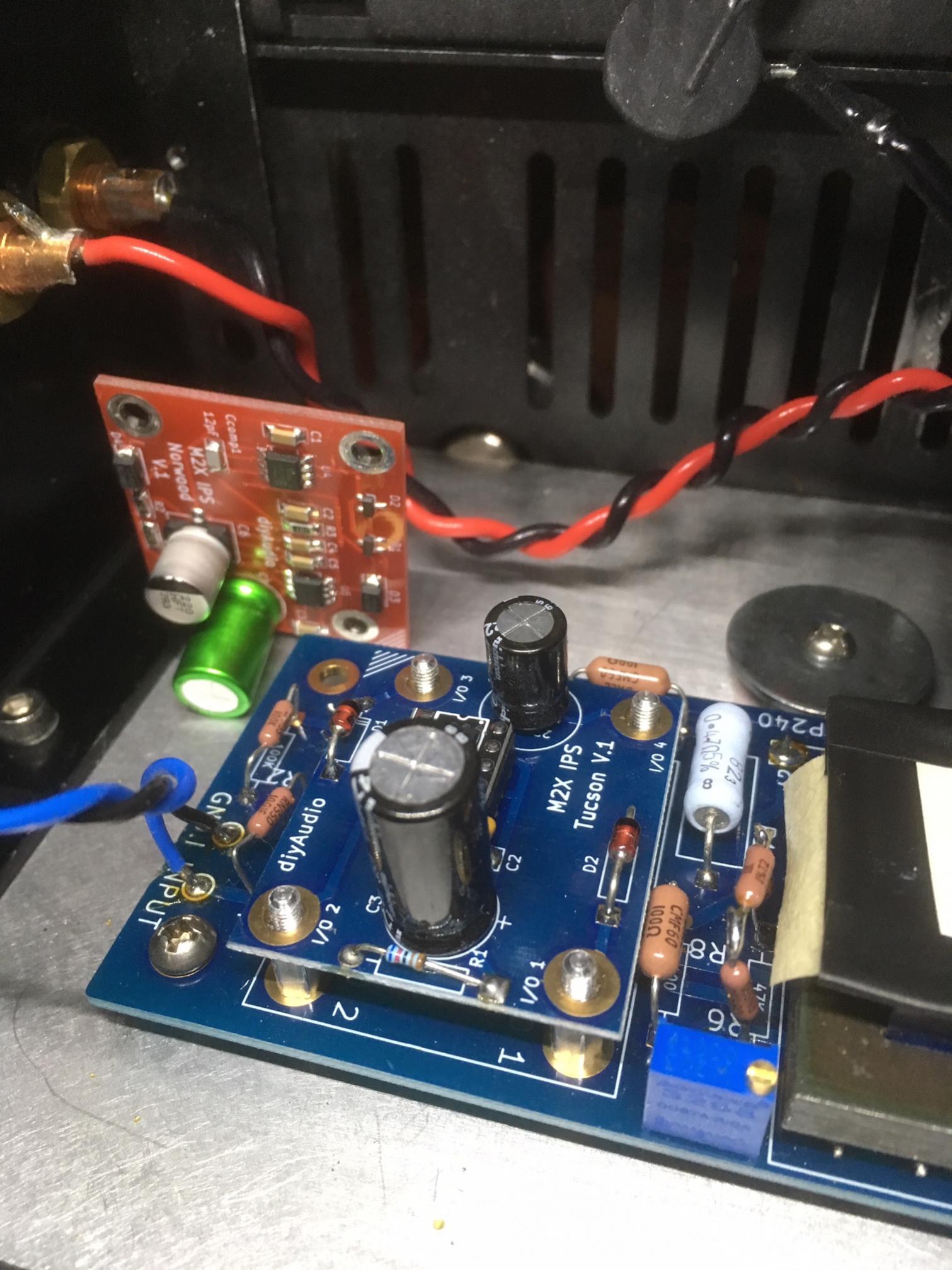

Just spent the last month listening to the Norwood board and enjoyed it. Found that some classical albums were handled well with clarity between sections and a soundstage that was wide and deep. Also able to keep up with some of the fast tempos of some orchestras without smearing.
Went back to the Tucson with the OPA1611 and was reminded of the character I first enjoyed. Maybe not quite the clarity of the Norwood, but the same music presented itself more intensely, emotionally(?). Soloists seemed to pop out into the room.
Both boards are fantastic in the M2x. Am waiting for some FG or Muse caps for the Ishikawa.
