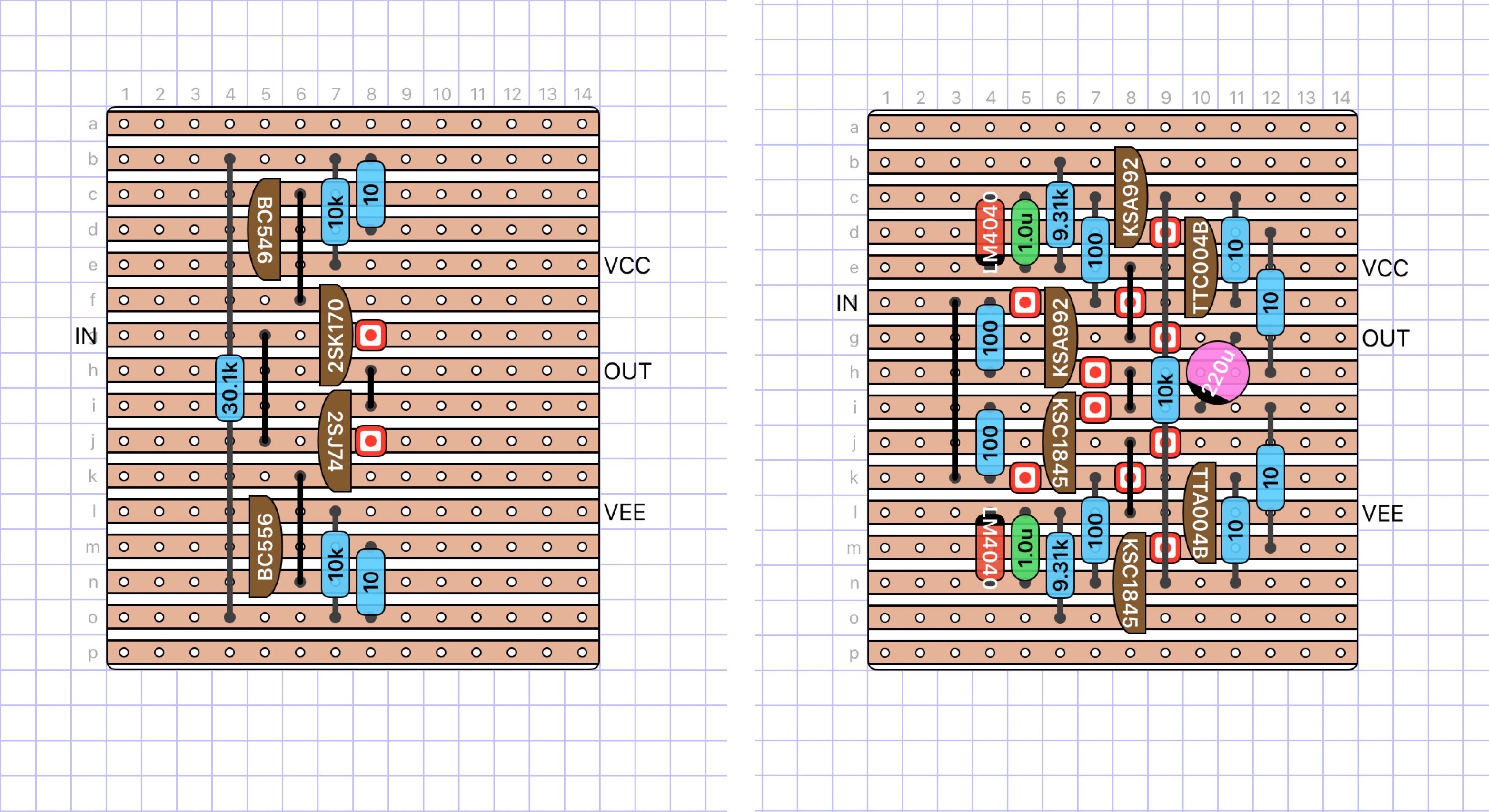

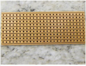

Another way to get more Tucson boards is to build them yourself on Stripboard / Veroboard. Earlier this year an M2x builder named "Tungsten Audio" posted his Stripboard place-and-route for all five M2x daughter cards. Naturally Tucson was one of them. He showed an early example in post #1743 and I think he refined it a couple of times after that.
And of course the riskiest way is to un-solder the existing DIP from the existing Tucson board, and replace it by a socket.

611243d1492038130-pleased-veecad-software-stripboard-veroboard-what_is_stripboard-png

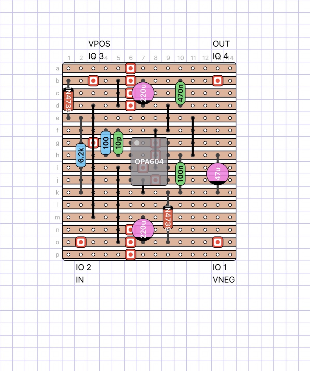

Yes, it so happens that I was revisiting my Vero board design with the new opamp in mind. Here is an updated version of the Tuscon THD layout. It has provision for a simple compensating resistor and cap in the unity gain feedback loop, which may not be necessary in most cases. The 100 Ohm resistor may be replaced with a jumper wire, and the 10p cap deleted.

I have been exploring some alternate layouts for a couple of the input buffers. These have some advantages from rearranging the I/O and power ports. The ideas started when I was designing alternate input buffers for an F6 amp with increased power rail voltage. There is also potential for adapting these to the M2x, perhaps with the help of a mezzanine interface board.
One is a cascode JFet buffer with no source degeneration on the JFets. This might be a higher voltage version of the Ishikawa IPS. The second is an alternate layout of the Diamond buffer, which addresses the borderline high power dissipation of the output devices. I haven't tried either of these yet, but the JFet cascode will probably appear first in my F6. These might be fun for some of the more intrepid amp builders out there.

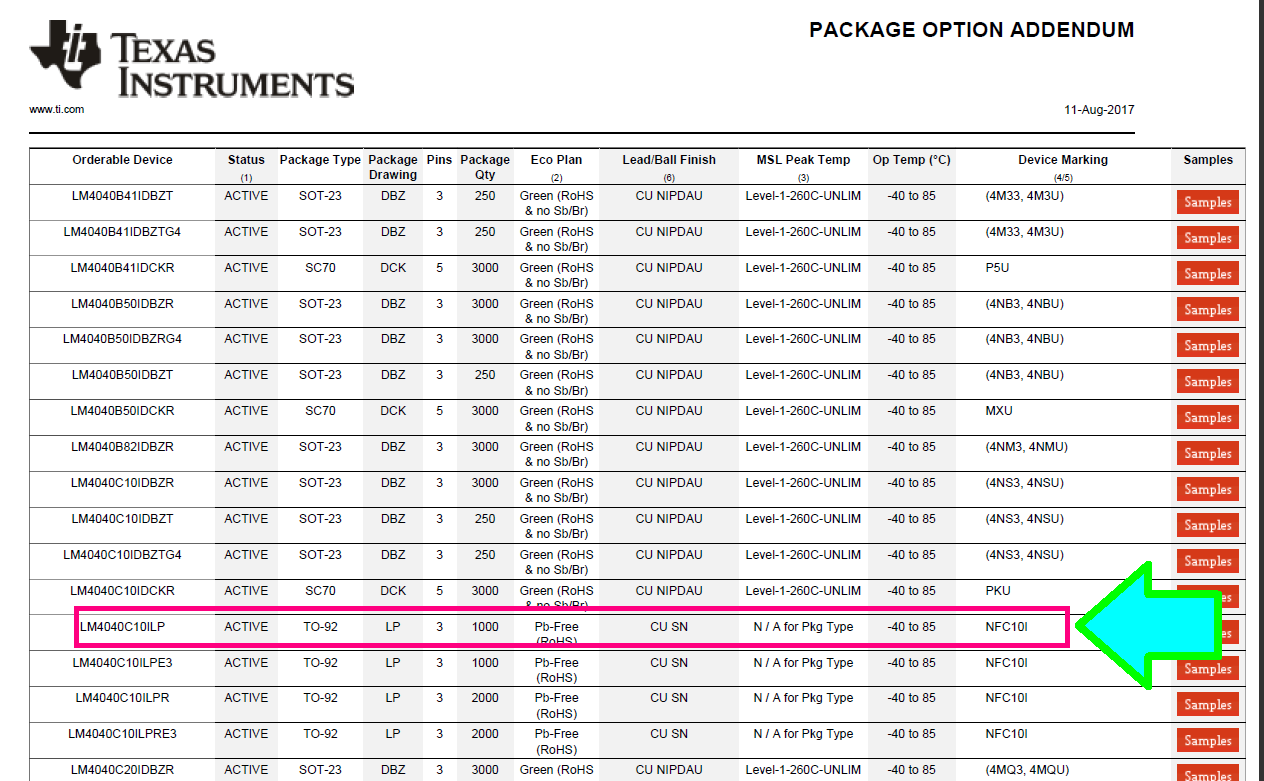

I purchased the components for the Austin daughter board from Mouser and instead of LM4040C10ILPR Voltage refs, as the packing slip and envelope indicated, i got four of the following: 7CM395E NFC10I TI
Mouser has yet to get back to me. Is this an equivalent replacement? Have googled but get no results. Thanks for any help.
If "7CM395E NFC10I TI" came from the device itself vs. printed on the bag - cross reference it with the spec sheet. The specs should list the proper device marking.

I purchased the components for the Austin daughter board from Mouser and instead of LM4040C10ILPR Voltage refs, as the packing slip and envelope indicated, i got four of the following: 7CM395E NFC10I TI.
Yes, see posts #371 and #373 in this thread.
The final pages of the datasheet say: (attached)

Thanks to the two of you. Good to understand the difference between Series names and device names. I was not aware of that. I will check those posts out. Though surprised that in the google universe there was no memory of the 7CM395E series. Thanks again. Anxious to complete the Austin board.
Joined 2019
Any time. I believe 7CM395E is the lot trace code. See the .pdf I linked.
