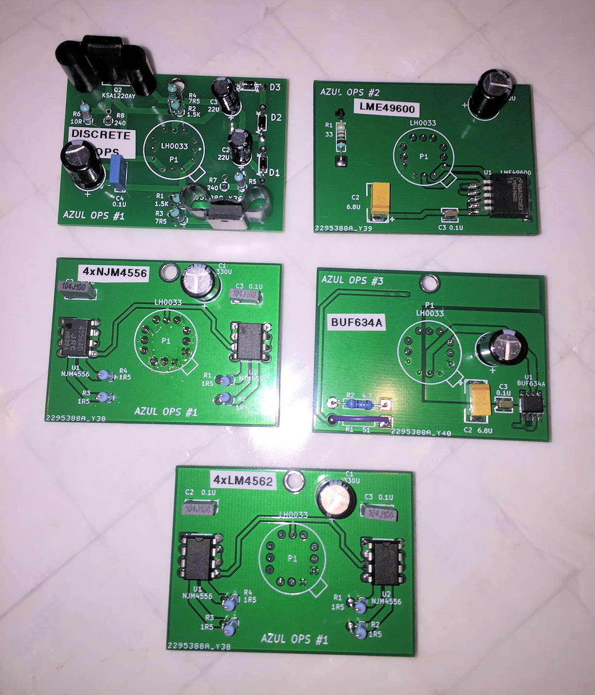

Good old 6L6 reminds me that the output stage of the "Azul" headphone amp presented at Burning Amp 2019, would make a very fine daughter card IPS for the M2x amplifier. It would use the multi chip module called LH0033, first sold in 1971 (!), to implement an M2x input stage buffer, on the same daughter card form factor as all the other M2x IPS cards.
Besides offering wonderful sonics (according to the folks who listened to Azul at Burning Amp), the LH0033 offers many of the characteristics that rabid audiophiles require:
  • It is out of production
  • Vendors of New Old Stock offer it for nosebleed prices; check octopart.com . A month before Burning Amp 2019, I purchased another two LH0033s as emergency spares, and paid $25 per piece. Plus shipping.
  • It is housed in a 12-pin TO-99 circular metal can package. Audiophiles are convinced that circuits in round metal can packages sound better than in epoxy DIPs.
  • It is built in an old & exotic technology (a dozen discretes in bare die, wirebonded to a ceramic substrate), in this case called "Linear Hybrid". That's why the part number begins with LH
  • Its datasheet (attached) says that it is part of the family of Damn Fast buffers. Who dares to argue with that?
  • Its bandwidth and slew rate are enormous; ridiculously excessive for audio
You could build it as a standalone buffer, somewhat resembling Tucson. Or you could build it as the back end of a composite amplifier, strongly resembling Norwood. Or both!
I successfully implemented a 12 pin TO-99 "socket" for the LH0033 on Azul, using 0.1" breakaway pin SIPs, Mouser.com P/N 437-3108716441001101. Putting these on M2x daughter cards would let you move a single pair of (expensive!) LH0033s from one set of cards to another. You could try several different circuit designs and pick the one whose sound pleases you most.
I also exhibited a few "LH0033 emulators" at BAF. These are pin-compatible with the LH0033, but built with active production, cheap semiconductors. These let me debug the Azul motherboard without worrying that I might damage an expensive and hard-to-replace LH0033. As M2x owners will readily observe, they ALSO gave me a headphone amp with interchangeable output stages. Just like M2x but on the output not the input. More listening experiments. Oh boy!

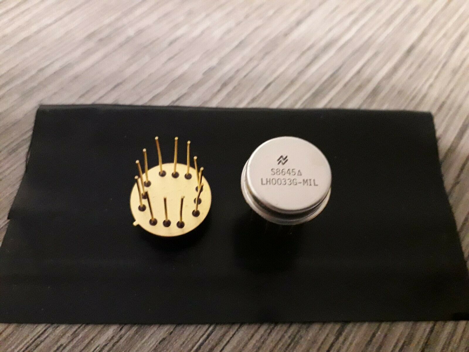

I took the chance and got some LH0033 on ebay. I avoided sellers from China and Hongkong as the devices they sell did not look as NOS.
I got 10 of the G-version which should be ok at a reasonable price. Then I have something to play with...…..when I have finished all the other "projects" in the pibeline :)
But what about the LH0063? …...6 kV/us or 6V/ns risetime.....I like that….now 1500V/us is quite low......and just at the limit for audio?

Great, have fun with those! If you want to horse around with the LH0063 as well, I certainly have no objection. That hybrid is built inside a big TO-3 package, whose lead wires probably need much larger diameter holes in the PCB and/or socket.
I started fooling around with the LH0033, simply because I have had six or eight of them in my parts drawers for at least 25 years. I finally decided: c'mon, let's Build Something!
