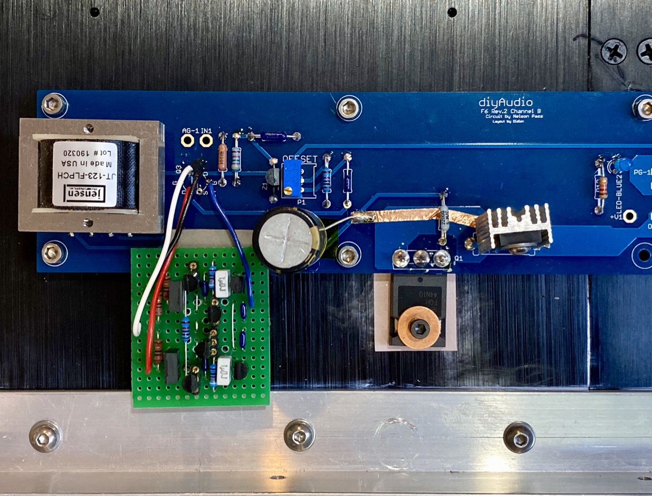

My F6 is finally up and running. And sounding way better than it has a right to after such a short break-in period.
Why am I posting this here in the M2x thread? Because I created a challenge for myself by extending the design parameters of the amp to the point that it needed a different input buffer. Based on experience with my M2x, I chose to use a variation of the Diamond buffer, basically a tweaked Austin input stage. In order to run safely at +/– 26.4 V, I designed the output stage around a pair of Toshiba TTC004B and TTA004B bipolar drivers. Their TO-126 package is somewhat more thermally efficient than the E-line package of the ZTX parts used in Austin. I added 10 Ohm base resistors and used 10 Ohm emitter resistors on those devices, and haven't found it necessary to add heat sinks.
Remarkably enough, it all fits on a Vero board that is the same size as the Austin PCB. Eliminating the M3 mounting hole pads frees up some space. The keen observers may notice a couple other changes as well. Once I've taken a couple more pictures and possibly made some measurements, I will post a proper write-up in the appropriate F6 thread. But for now I want to thank MJ and 6L6 for making the M2x, and this extension of the F6 possible.

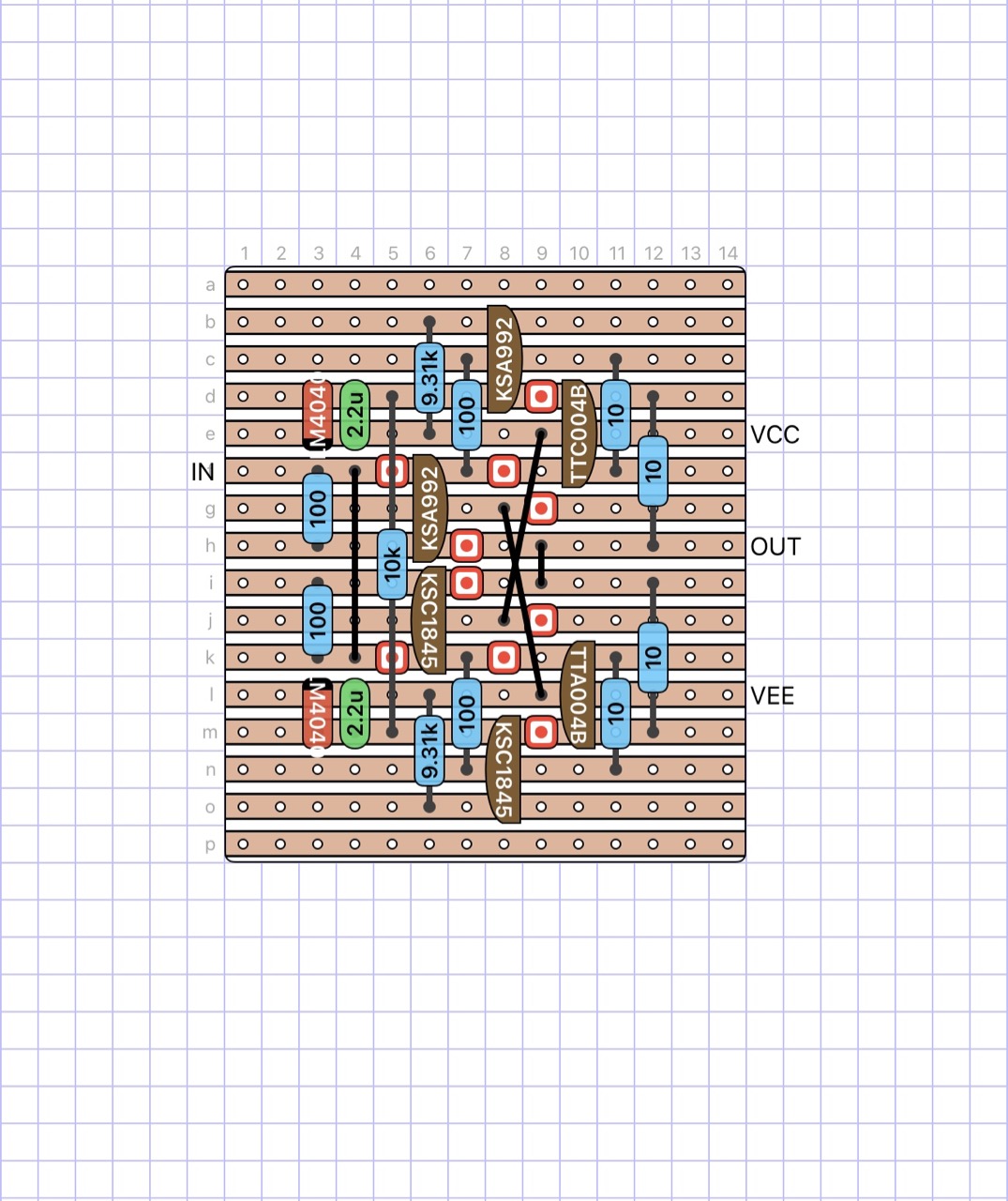

Socketed the first stage BJTs (2 x (EF + CS)) but not the second? Possibly because the second stage's TO-126 package pins are fatter than socket holes and, unmodified, are on a pitch of 0.085" rather than 0.100" like the stripboard and socket?
The LM4040 ICs are also housed in three-lead transistor packages, but unsocketed.
Omitting the pole-zero compensator might change the response to fast risetime square waves, using those Toshiba devices. Either for the better or the worse. NP and I went back and forth on this question a couple times in early 2018.

Hi Mark. Yes, the socketed devices are as you have depicted in your schematic. When I installed the LM4040 ICs, I removed the unused leg and soldered them directly into the board. The TO-126 packages don't socket well into veroboard, so those were also soldered directly.
It is somewhat obvious that the photo and the vero layout drawing don't match each other. The photo was of the first implementation, an incorrect one that caused four resistors to be sacrificed in the name of science during the first channel board smoke test. The vero layout drawing shows the boards as currently built, where it was necessary to use insulated wire for the two power jumpers. It would be possible to un-cross those wires in a new layout, but that would require a different set of trace breaks. I decided I liked the look of the crossed wires, as they reminded me of the important power connections.
I did a little online research about diamond buffers before choosing to go with this one. I did run across some versions that used small value capacitors between the base pins of the output transistors to counteract a minority-carrier anomaly which showed up in high slew-rate square waves. (I believe whoop-de-do is the technical term.) Yours is the only one I've seen so far with an RC network. I simply reverted to an earlier practice of mine to install base resistors in front of drivers to control linearity and bandwidth. The 10 Ohm value is a placeholder for now, until I determine if another is more appropriate.

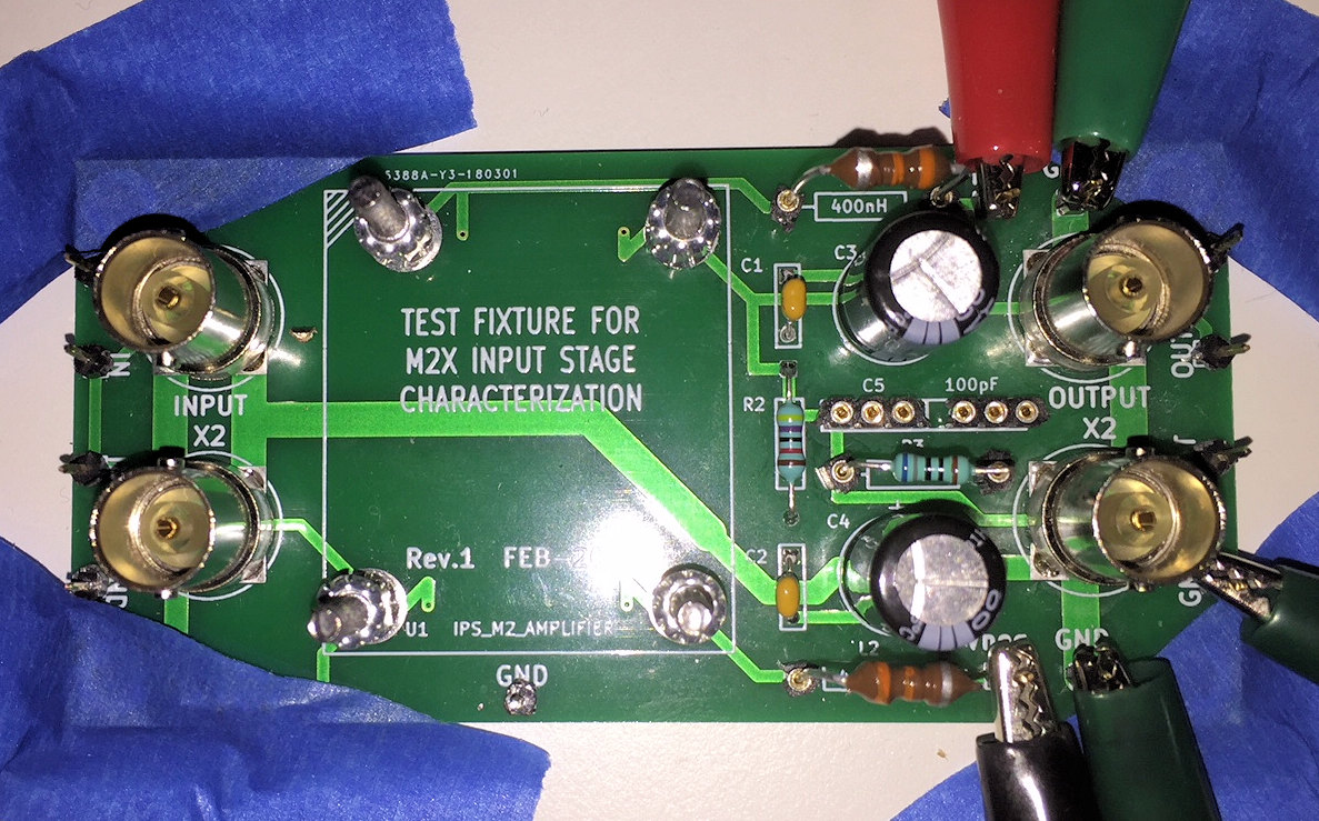

I use BNC connectors to get low-inductance grounds for inputs and outputs when doing 3ns risetime square wave testing. This picture is from post #439 in this thread. Signal generator input on the left, Oscilloscope output on the right.
693602d1532528331-diyaudio-watt-m2x-jpg

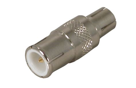

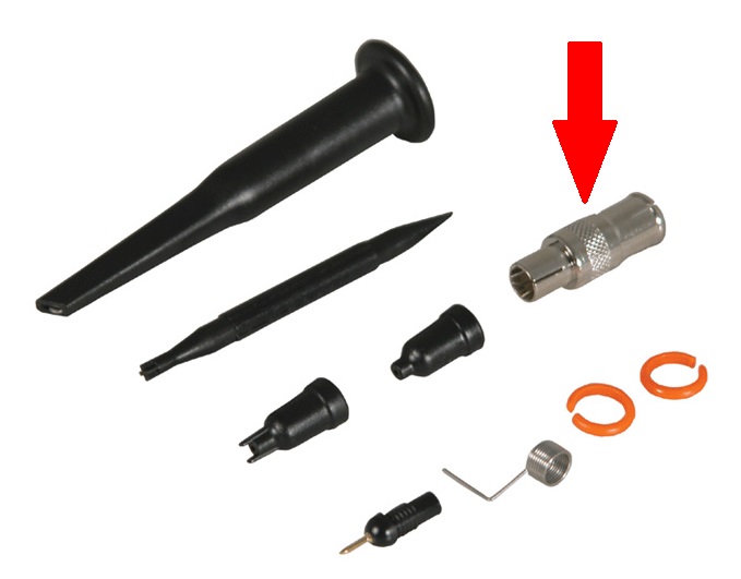

I install scope probe adapters that turn the probe into a coaxial plug whits fits perfectly into the BNC jack.

Most of the daughter card circuits are not able to drive a 50 ohm load; they're designed to drive the 600 ohm primary of the Edcor transformer. And if you omitted the terminator(s) on the BNC cable, reflections would ruin the nice free-of-ringing edges you're trying so hard to display.
