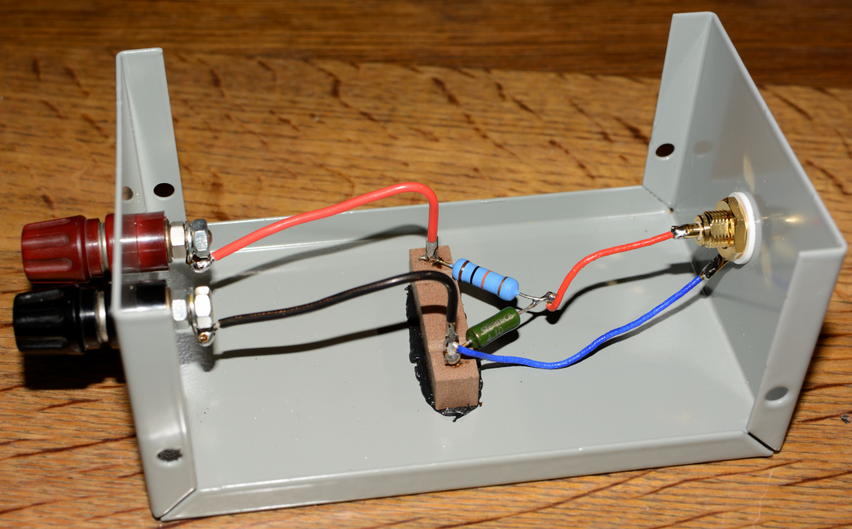

Few days ago I made a small interface box from power amp to Focusrite so level match and I don't burn the Focusrite input by a mistake. Same I used for first measurement (unboxed with long wires). It is nothing special and "quick and dirty" made.....but it seems to work. My theory is that I will get less noise pickup with shorter wires and mounted in a metal box.

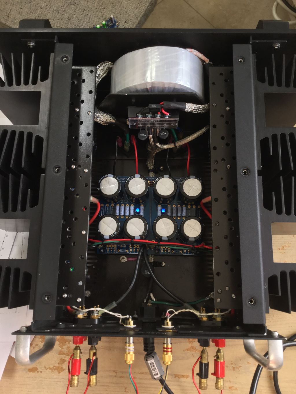

Along came a cast-off. Instant insight, no doubt fueled by what I was sipping - one man's cast-off is another man's...donor-chassis.
So, with no apologies for its living quarters, here's another M2X build.
Thank you Mark and Jim and all who've contributed to the First Watt threads, you've created quite a resource.
And to the One Wizard Who Rules Them All: as we say in this part of the world, 'Nuf Respect! Thank you for the education and the hours of fun. You, sir, are a generous man.
