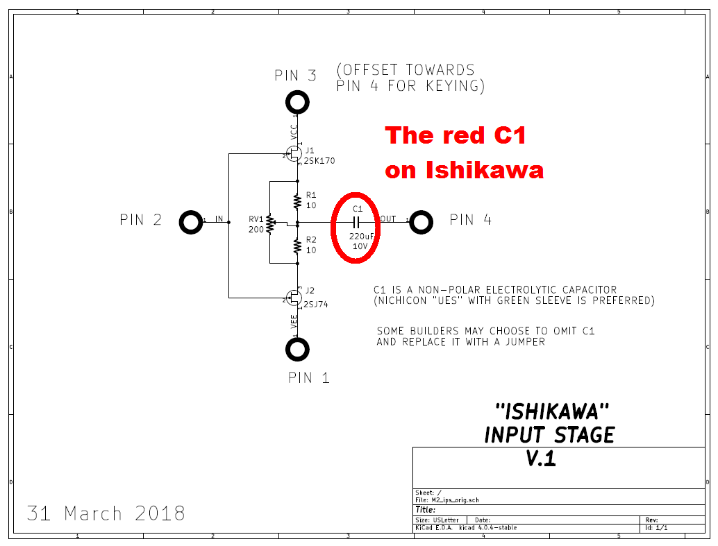

Short answer is "yes". You need a matched pair of K170BL and J74BL grades ( the store might be O.O.S. of the matched pairs or quads however)and mount them in thermal contact with each other on the pcb, either using a small zip tie to bind them together or heat shrink them together. See post #1 of this thread.
6L6
Moderator
Joined 2010

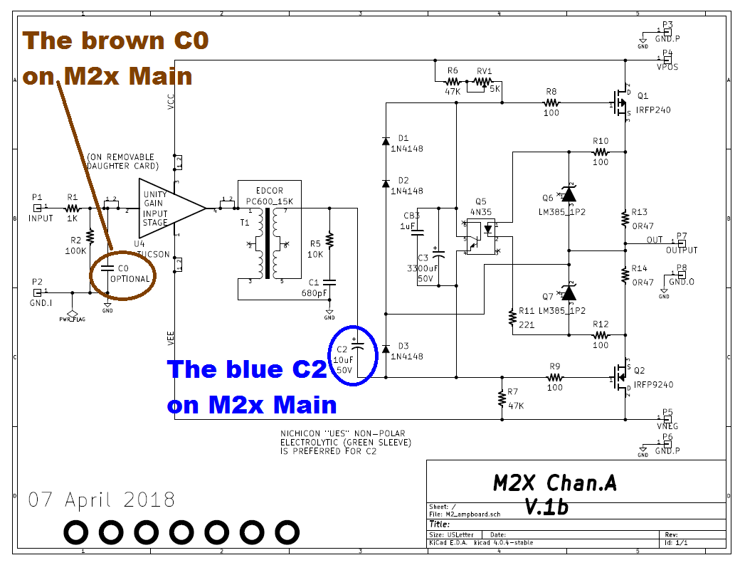

Ishikawa C2 is optional and can be replaced with a jumper. Yes, you could use a MKP as well. C2 was added in the case you want to add a coupling cap to ensure that there is zero DC on the core of the signal transformer. The original M2 schematic did not have a capacitor there, so omitting C2 and replacing with a jumper would be closest to the original configuration.
C2 is on oryginal M2 . Optional on ishikawa is C1.
My question is why can it be dc on edcore if i have matched fets?

Maybe these schematics will make it easier to decide which capacitors are being discussed.

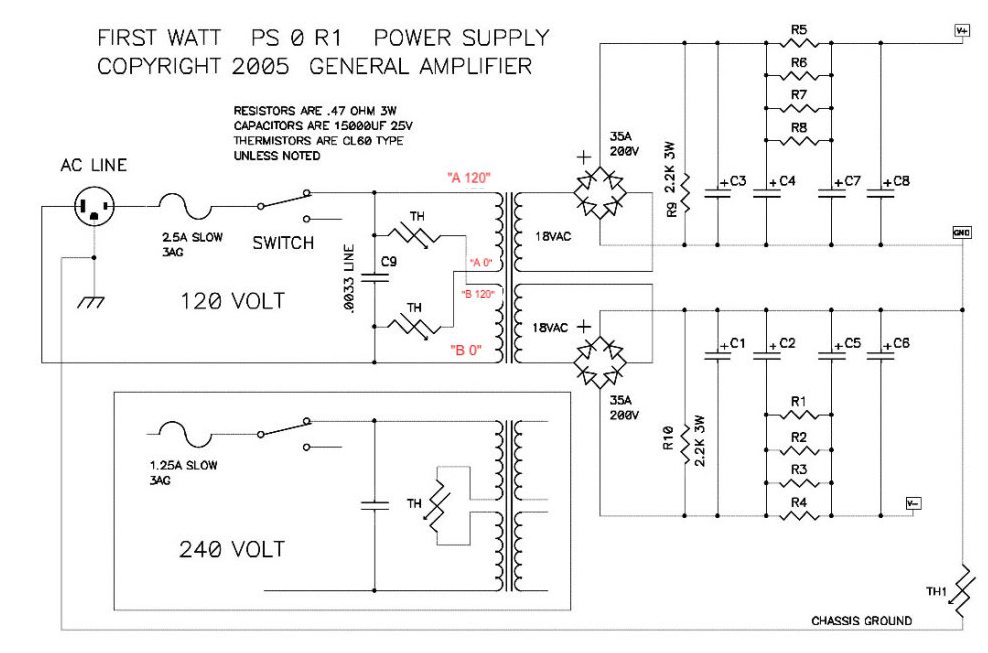

The transformer in my M2x is rated 300VA. It has two independent secondaries, each 18V (AC) @ 8.3 amps RMS.
My M2x uses the power supply circuit design by Nelson Pass, schematic in post #83 of this thread...... but I decided to purchase electrolytic capacitors rated for 35V (not 25V) just to have a little bit of extra safety margin.

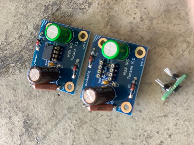

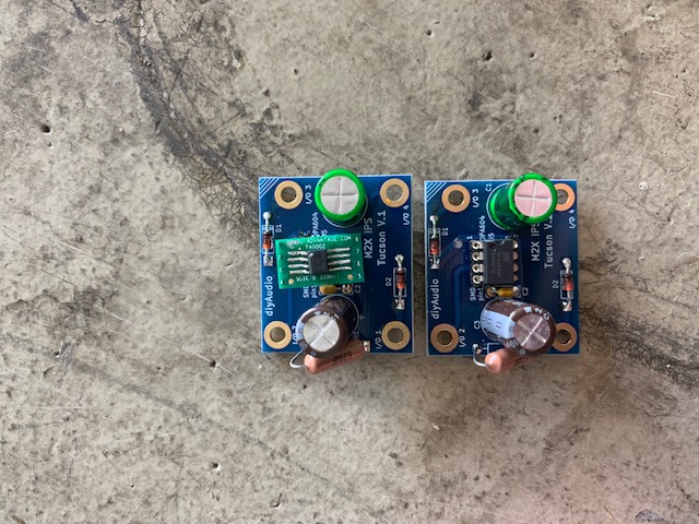

So the Tucson BOM lists two op amps, OPA604AP and OPA611. The first is a through-hole device and the second is an SMD. The Tucson daughter card allows you to use either. I wanted to try both, but was feeling particularly cheap with respect to buying two cards.Moreover, either Jim or Mark mentioned that there are many good audio op amps available as SMDs. What is a DIYer to do with so many options?
Short answer: solder tails and SMD adaptors. The images show how I used to the solder tails so as to be able to switch out op amps. I got the idea while building a Pearl2 whereby I wanted the flexibility to switch resistors and caps to vary the operation for different carts. For the Tucson SMDs I purchased an SMD adaptor and modified it. The modification, which used the thickest clipped leads i had in my e-waste bucket, was developed since the adaptor pins are WAY too large to fit in the solder tails I purchased, and I didn't want to purchase others. I used the template for aligning the pins that came with the adaptor to line up the clipped leads and voila! Now all that needs be done to try different SMD op amps is purchasing additional adaptors (cheap), and I can plug in any number of SMD op amps, or switch back to through hole varieties.
Not a great breakthrough by any stretch, but a very minor engineering application for a issue that didn't really need addressing. Fun though.
