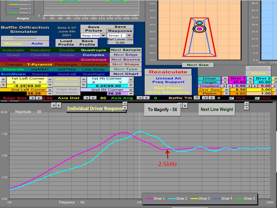

Neil Patel, Avalon's designer & illuminating spirit, understands why Harry Olson recommended using a truncated pyramid TM speaker cabinet back in 1950. I did a 5-minute sim of a 6.5" mid + 1" dome in a Avalon ISIS type truncated pyramid which shows that a 2.5Khz crossover can have modest tweeter cabinet diffraction wiggles and waggles. Mounting the tweeter right at the top edge bevel cuts yielded the smoothest SPL sims.
If sharp edges hurt your eyes, a wider baffle with large radius quarter rounds on all edges will support high SPL efficiency at a lower crossover frequency. The sound stage would change because a large baffle pushes more energy into the front 180 degree(2-PI) and less toward the sides(4-PI) for reflected ambience.

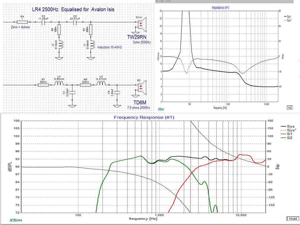

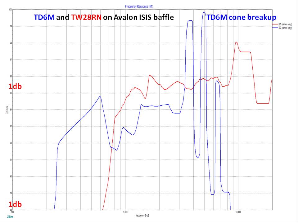

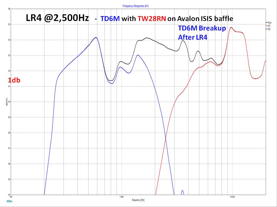

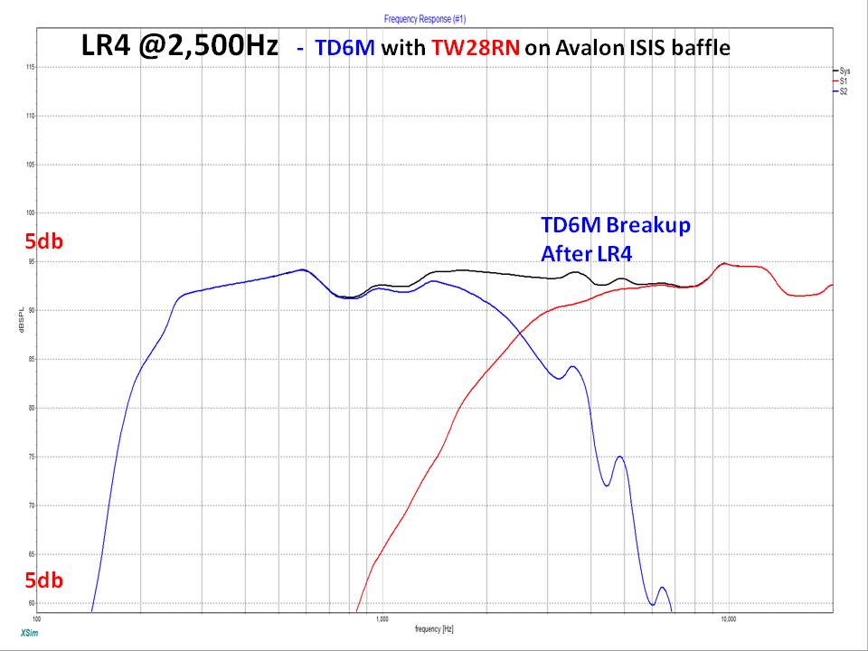

Attached:
1) TD6M + TW29RN curves equalized for Avalon ISIS baffle
---1db scale dramatizes TD6M cone breakup which miniDSP cannot correct
2) LR4 @2,500Hz on equalized curves 1db and 5db scales
Avalon's genius designer Neil Patel selected a dome tweeter for all Avalon speakers for polar response + dynamics + sound. Neil likes domes.
If you decide to purchase RAAL 70-40 ribbons, you will want to study alternate cabinet shapes which best match the ribbon's horizontal polar response in your listening room. Probably a larger baffle(10"-12" wide) with large radius quarter rounds for low diffraction.
