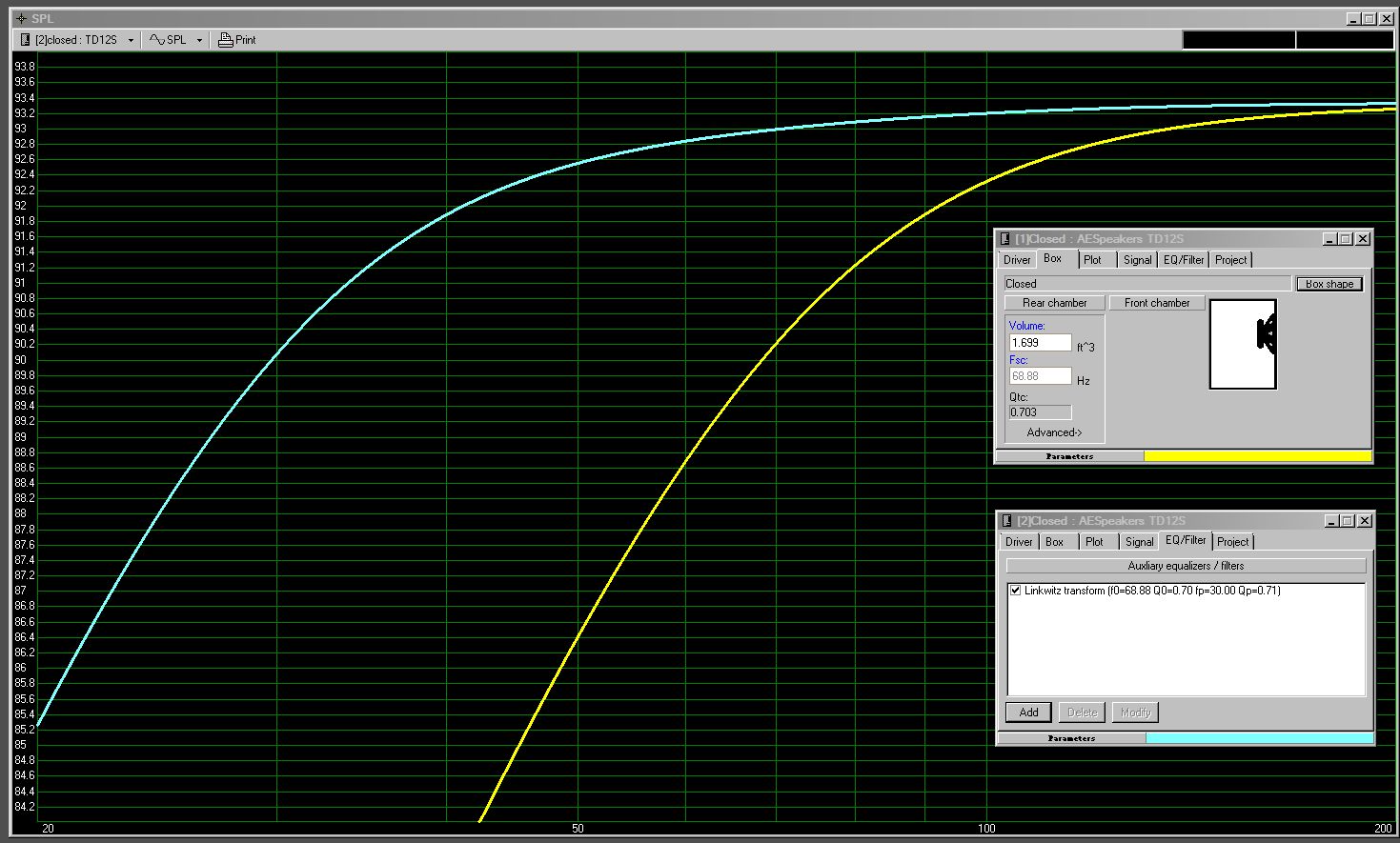

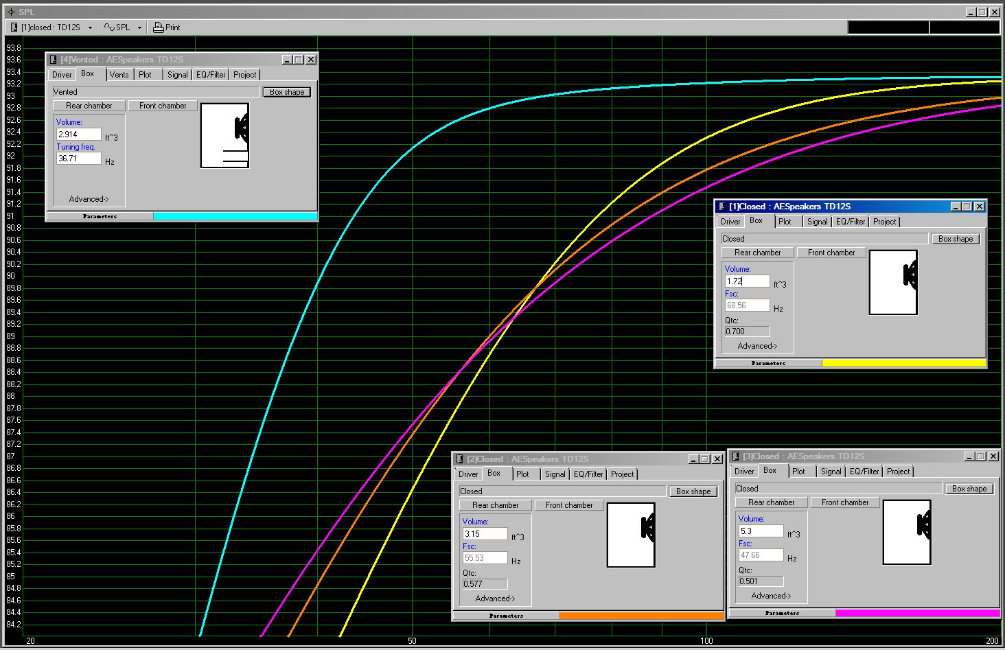

Using the TD12S woofer T/S parameters from the AES website I ran both sealed and ported box alignments.
WinISD simulation for the TD12S shows F3~69Hz in a 1.72f^3 SEALED Qtc=0.7 box volume.
WinISD simulation for the TD12S shows F3~56Hz in a 3.15f^3 SEALED Qtc=0.577 box volume.
WinISD simulation for the TD12S shows F3~48Hz in a 5.30f^3 SEALED Qtc=0.5 box volume.
WinISD simulation for the TD12S shows F3~37Hz in a 2.9f^3 PORTED box volume.
--A sealed box alignment will require substantial equalization to reach 30Hz bass...attached
--You could build a 3cuft PORTED box and plug the port for Qtc=0.577 SEALED. Flexible options.

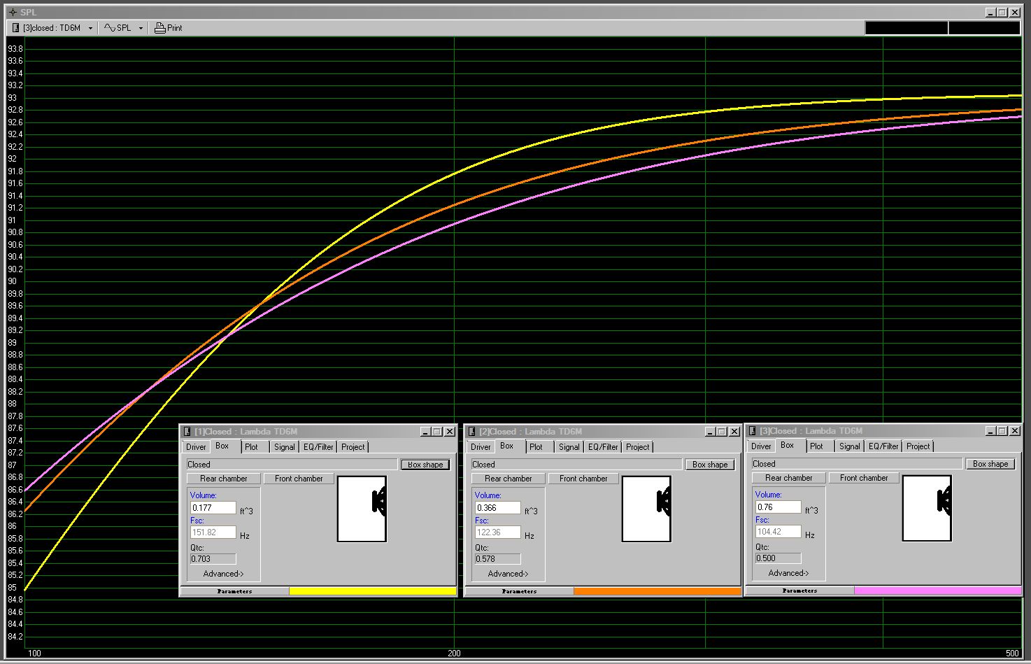

Using the TD6M midrange T/S parameters from the AES website I ran three different SEALED box volumes which illustrate the SPL/freq shape for:
Qtc = 0.7 Maximal flat Butterworth alignment 0.18f^3 F3~152Hz
Qtc = 0.577 Minimal ripple Bessel alignment 0.37f^3 F3~122Hz
Qtc = 0.5 Critically Damped alignment 0.76f^3 F3~104Hz
The Qtc=0.7 is the most common because it simplifies Butterworth and LR crossover slopes, and also blends with the efficient Qtc=0.7 woofer alignment. You can hear a difference if you experiment with box volume during your build.
Hope this data helps your design work.

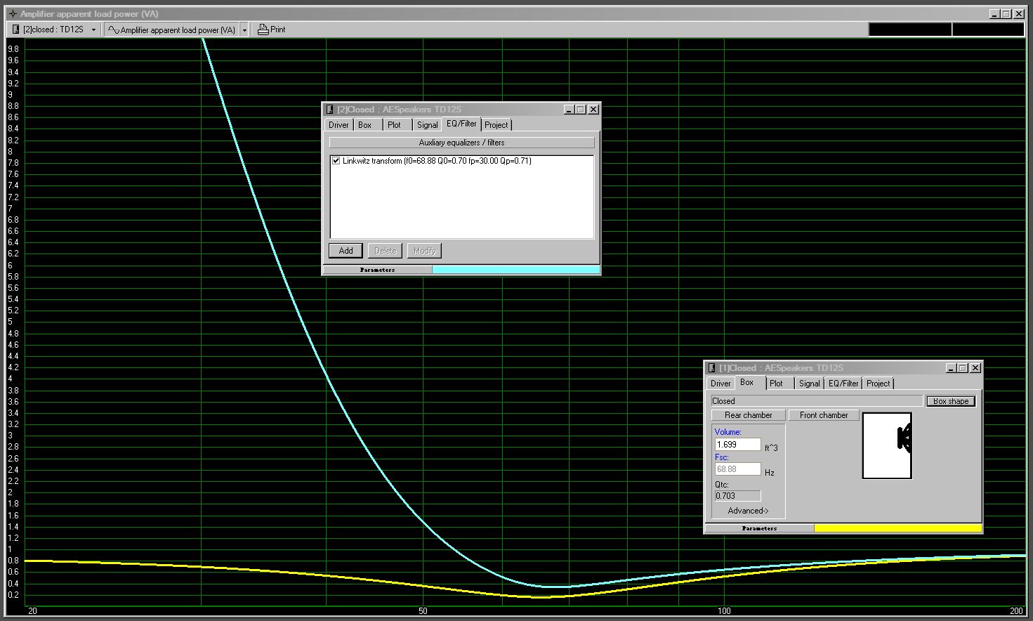

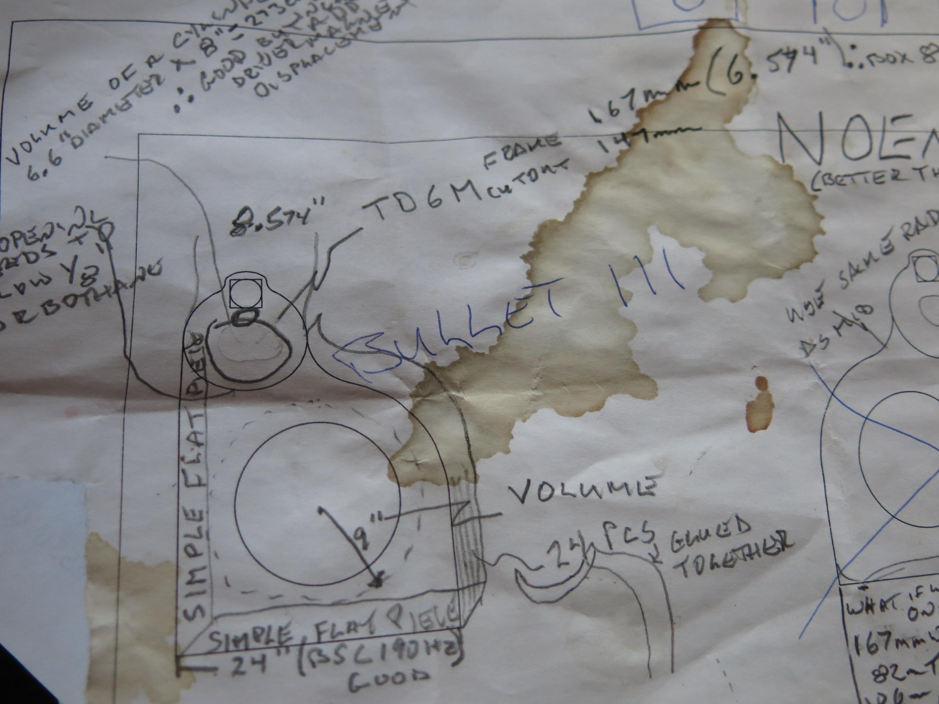

Not at this time. I am thinking more and more about doing a 2.9 cu ft ported. Looks like it would make more since, that way I could go back and forth between ported and pluging the port. What type of port do you recommend slot or tube type. Your knowledge is deeply appreciated. Thanks please help me out my friend.:)
cabinets sketches

No some ideas on cabinet design and sketches are deeply appreciated.

The SR-2 design from Pass Labs and a flat baffle Avalon style have modest construction complexity and popular style.

Simple front baffle screw-in option for ported vs. different volume sealed alignments. A light material like styrofoam could be used to adjust the internal sealed volume for Qtc tuning options.
Review earlier post with 10X bass power requirement difference between equalized sealed vs. ported. You never know when you might want to take this speaker off of the MiniDSP and use a passive Xover for single amp operation. Kids go to college. You might get rich and put these in the bedroom. TD6M + TD12S = lifetime $peaker.
