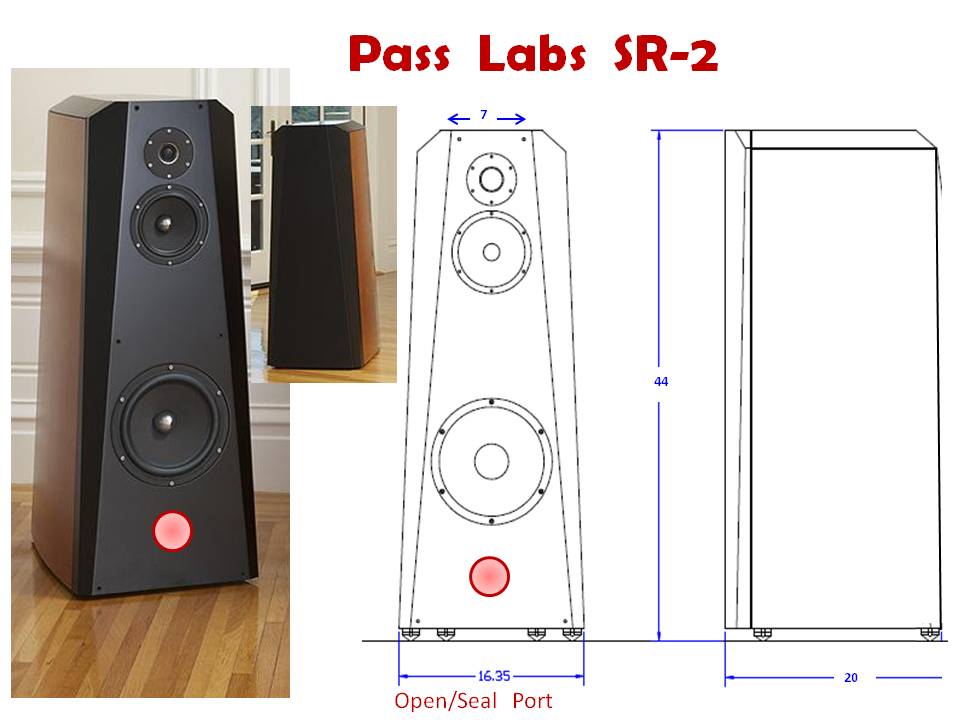

which cabinet is best for my speakers?
Jenzen ATS 3-way
What do you experts think about this design for a room about 14' X 20' in size.
PS: What changes would you make the this. Should I make the edges of the woofer enclosure the same as the mid to offset the baffle step issue.
Also should I make it a sealed woofer enclosure or stay with the ported. If I went sealed I could let my pair of Dayton Audio RSS315HFA-8 subs handle 60-70hz & down. Thanks for your input. I like the high tech look of these cabinets. Please chime in and try to find ways to improve on this design for my speakers. Thanks again.
My friend will do the CNC MACHINE WORK and another friend that does most of the custom auto prep and painting here in Oklahoma City for over 30 years will prep and paint the cabs high gloss "Piano Black" with like 7 or more coats.

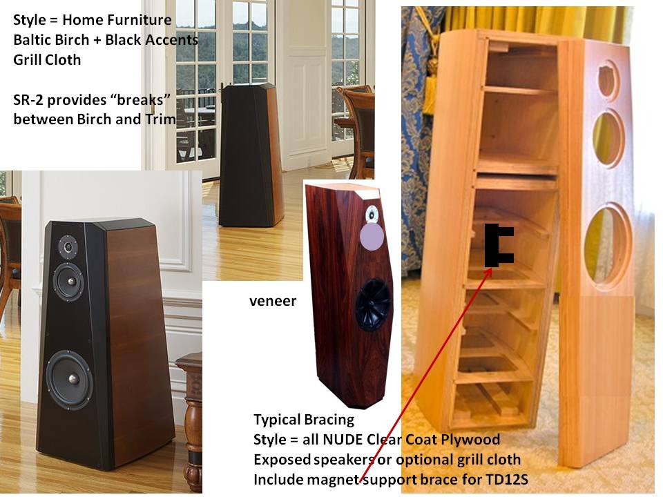

CABINET DAMPING
Following the kit is 2 sqm of ~8 mm grey felt and 1.5 sqm 30 mm acoustilux.
Bass cabs:
Bass cabs are added felt on all internal panels except front and bracings. At bottom 2 layers of 30 mm acoustilux.
Two rolls of 30 mm acoustilux is placed as seen on drawing.
Mid cabs:
All internal panels are added 4 mm bitumen pads glued with elastic vinyl glue. Be generous with the glue.
All internal panels further added ~8 mm grey felt.
A roll of acoustilux is placed below port, dimension 25 x 30 cm.
Bitumen pads can be ordered at Jantzen Audio too. Use 2 layers of 2 mm bitumen pads, "panel STANDARD". Be prepared for some additional shipping weight. Order 1 sqm for two mid cabs.
Bitumen pads are not needed for the bass cab due to extensive bracing.
I WOULD ADJUST THE VOL OF EACH CHAMBER TO ACOMADATE THE AE TD6M & TD12S.
OR IS THIS A BETTER DESIGN
THANKS FOR YOUR PARTICIPATION!

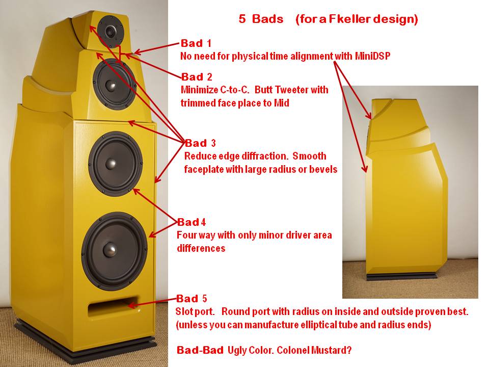

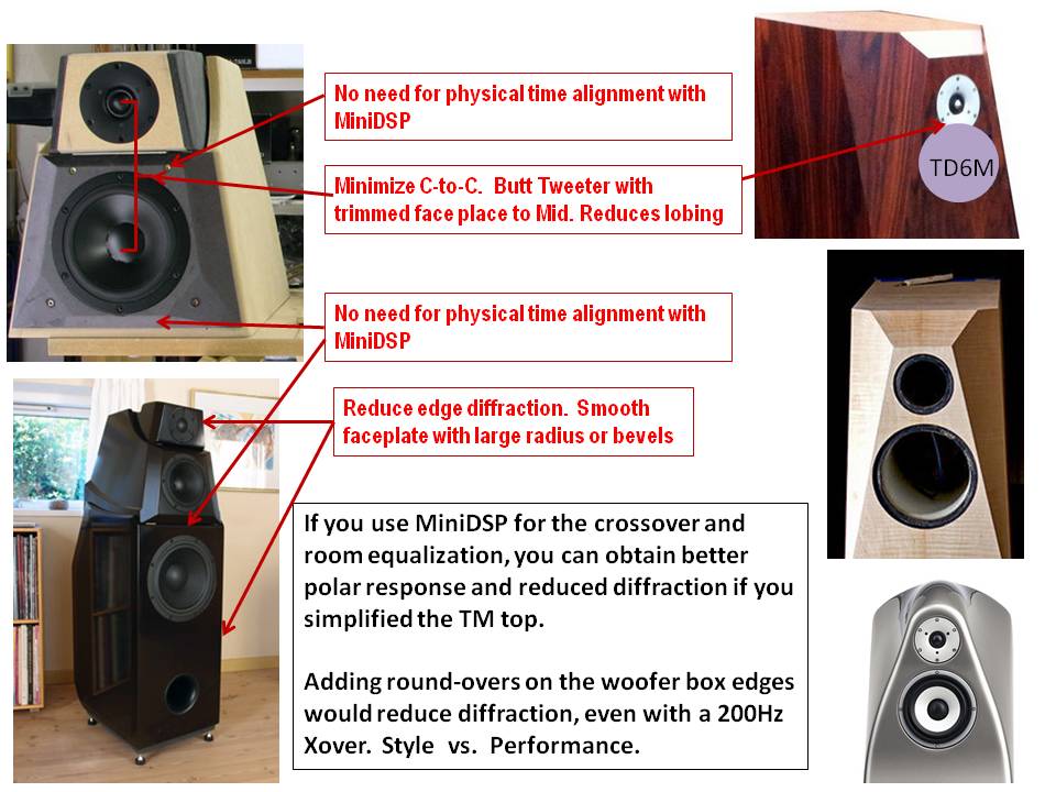

On the Jenzen ATS, if you use MiniDSP for the crossover and room equalization, you can obtain better polar response and reduced diffraction if you simplified the TM top. Adding round-overs on the woofer box edges would reduce diffraction, even with a 200Hz Xover. Style vs. Performance.
On the Jenzen ATS, the mid cabs hold an aperiodic tuning from having stuffed vents on the rear panel. Personally, I would only use a sealed box for the TD6M because of its T/S parameters(Fs = 83 with Qts=0.4 on TD6M vs. Fs=27 with Qts=0.23 on the Skaaning mid).
The bracing and construction techniques used on the Jenzen ATS are excellent engineering. There is still engineering required to transfer the best Jenzen ATS ideas into an exceptional MiniDSP + TD12S + TD6M + AudaxDome
Thanks for your excellent advice this is what I mean by mods. This will help me so much. Thanks again. You right with so many mods there is not need to go through all the trouble of building an ATS. I will not build the ATS, to much work and not enough reward. This is the kind of advice i'm seeking.Jenzen ATS 3-way

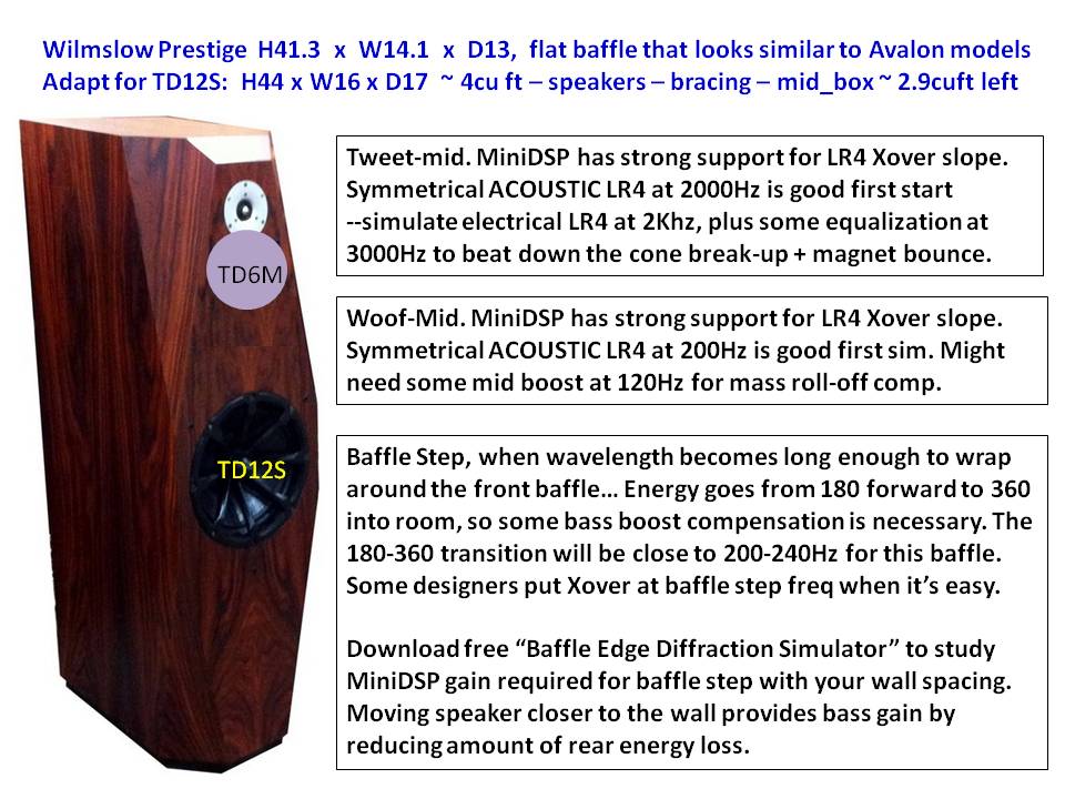

LineSource which design do you think is the best for my situation the Wilmslow Prestige or the Passlabs SR2. I can have any cabinet built. So out of all design possibilities which would you go with if it were you and building a cabinet wasn't a problem. It sounds like you have the expertise I am looking for on the project. Thanks my brother.
Avalon Eidolon Diamond
Does anyone have the cabinet plans for Avalon Eidolon Diamond loudspeaker. I think that this is the way I would like to go and modify for the AE TD speakers sealed or ported design. If they're are any negatives that you know of in build these using AE transducers please let me know before I start construction. Thanks your info is deeply appreciated.Thanks for your excellent advice this is what I mean by mods. This will help me so much. Thanks again. You right with so many mods there is not need to go through all the trouble of building an ATS. I will not build the ATS, to much work and not enough reward. This is the kind of advice i'm seeking.
Remember the "Indiana Jones and the Holy Grail" scene in the cave where Indy has to choose the correct cup to save his Father....
YOU must ... "Choose Wisely"
You will likely have to modify any design you find to fit the box volumes for your specific drivers. If you have settled on the Avalon style, it's time to create a CAD drawing for your drivers which the cabinet shop CNC can read. I gave you all the WinISD sim data you need. Study a few theads on cabinet bracing. Post your CAD design for peer review.
The Avalon Eidolon product uses an 11" woofer. It has a slanted baffle to provide some time alignment with passive crossovers. MiniDSP allows a superior imaging straight baffle.
TonyG Soup Ceramique Avalon clone uses an 8" woofer.
Avalon cut edges with all "nude" Baltic Birch with clear finish has a Euro-Tech look that some like.

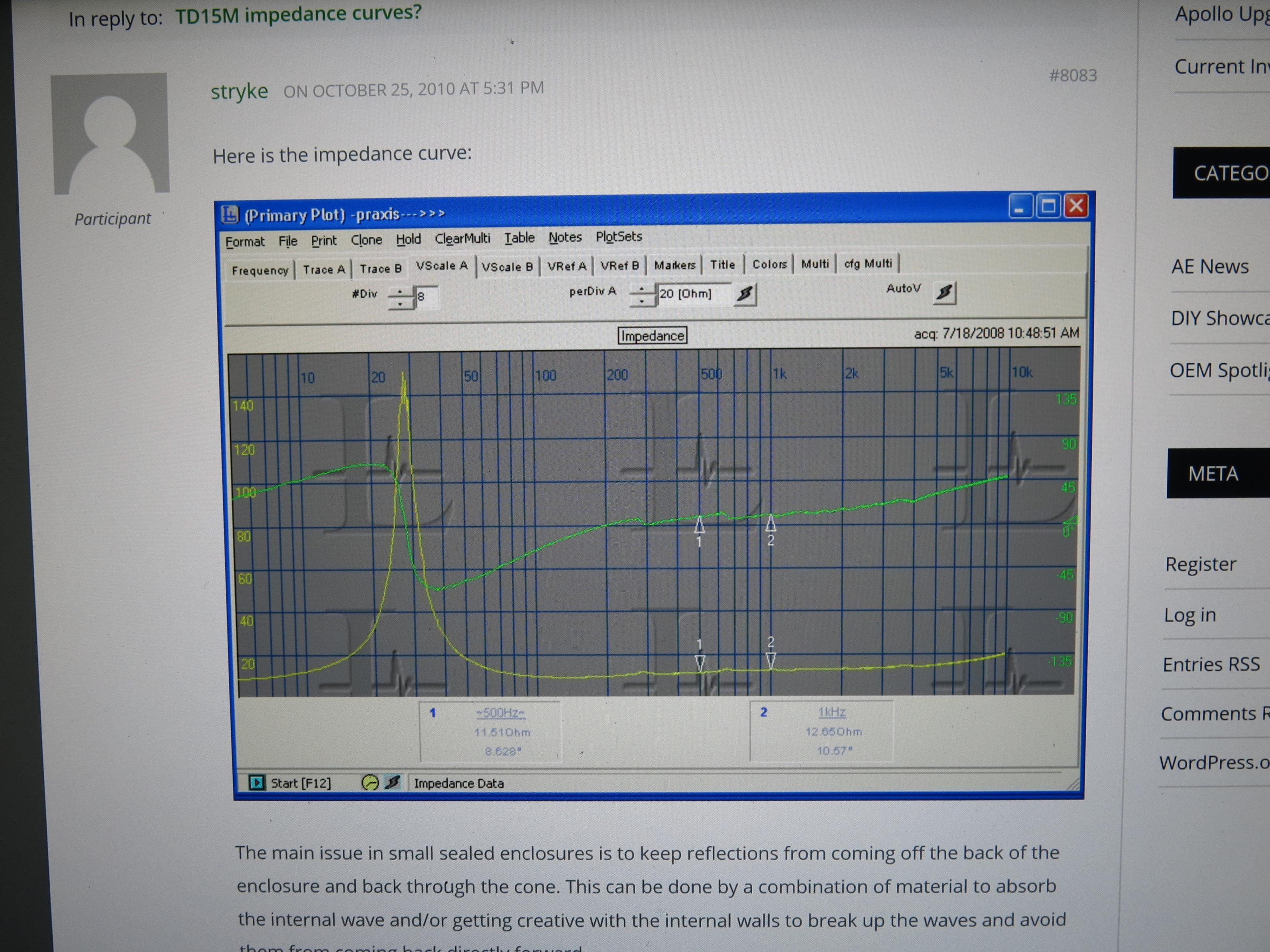

Here is the impedance graph for the AE TD12M. I know you have the 12S, but the graphs should be close.
At 50HZ, a single has impedance of 20 Ohms. Dual woofers 10 Ohms. Amplifier output at 10 Ohms, ~450 watts.
At 40Hz, a single has impedance of 32 Ohms. Dual woofers 16 Ohms. Amplifier output at 16 Ohms, ~250 watts.
At 30Hz, a single has impedance of 100+ Ohms. Dual woofers 50+ Ohms. Amplifier output at 50+ Ohms, ~80 watts.
At 27Hz, a single has impedance of 145 Ohms. Dual woofers 72.5 Ohms. Amplifier output at 72.5 Ohms, ~ 60 watts.
At this point I'm gonna do something really silly.
Why not;
1) run them in series, thus 'doubling' the impedance.
2) find a 100+ watt tube amplifier (for the woofer section).
100+ watts @ 8 Ohms
120+ watts @ 16 Ohms
130+ watts at anything above 32 Ohms.
Linear power means linear output.
Under 30Hz the tube amp will put out twice the power of a solid state.
Twice the power means +3dB of gain.
+3dB means twice as loud below 30Hz.
