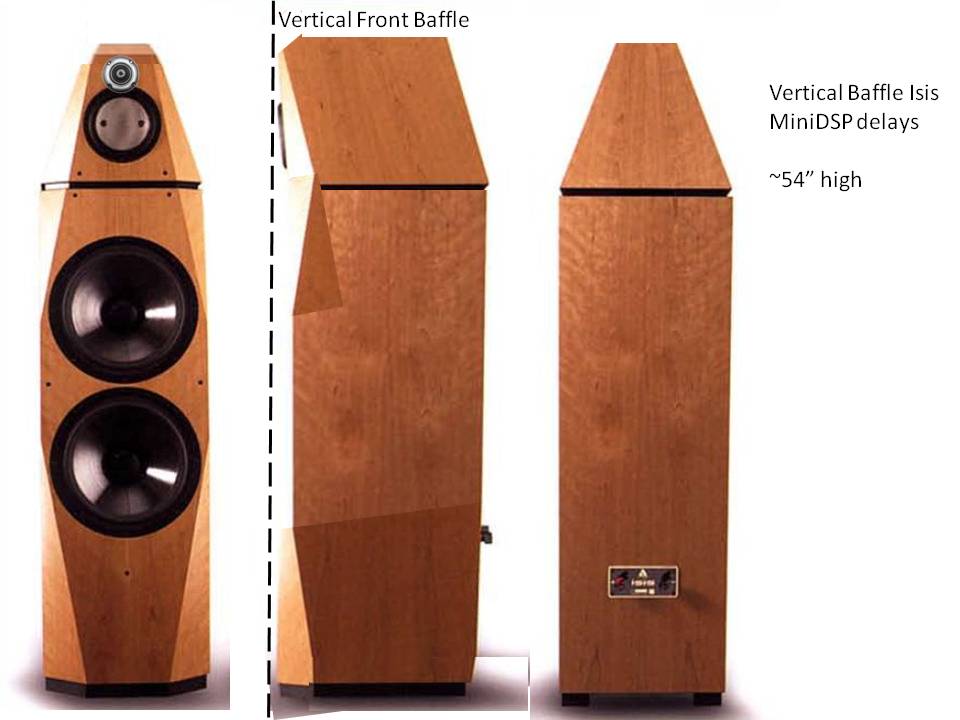

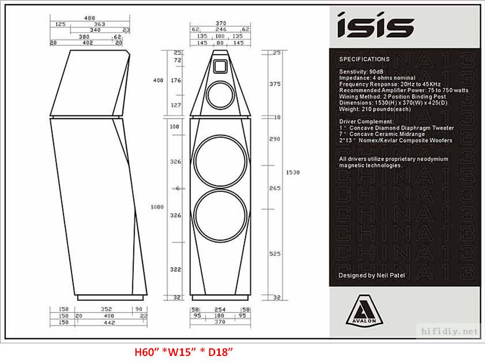

1) There are several Avalon Isis clone examples(including Galactica) which you can study for bracing and construction ideas
2) Using the MiniDSP for driver time alignment will allow you to use a flat baffle, which simplifies construction, but also changes appearance

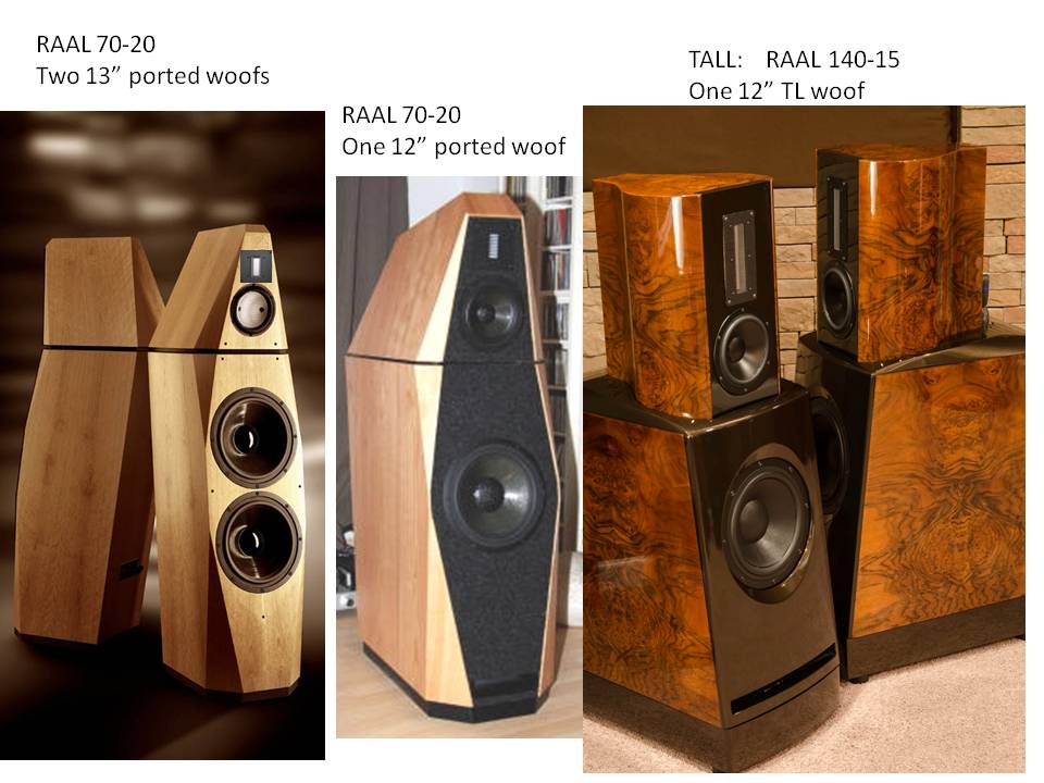

3) Some Avalon Isis clones use the RAAL 70-20 ribbon, which they purchase from an OEM directly
--70mm height allows shorter C-to-C
--20mm width allows slightly lower crossover freq
--REALLY TALL: RAAL 140-15
-----for Isis box shape, a dome tweeter might integrate better than a REALLY TALL ribbon
4) A single TD12S will have a superior bass wave launch over two parallel-wired TD12S woofers
--1 Sealed box TD12S with Linkwitz Transform +200watts can reach equalized 20Hz with 100db SPL in room
--A low wattage tube amp would require a ported box 2*TD12S for deep bass
------Avalon Isis uses a bottom ported two*13" woofer cabinet alignment
--Newer RAAL 140-15 designs from Vapor audio have selected single 12" woofer TL

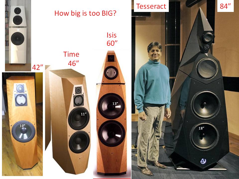

How big is too BIG for your home.
Avalon cabinet family:
ISIS two box design allows using different TM tops, but two boxes is inefficiency for creating the requried woofer volume. Isis is 60" tall, but easy to reduce to 54". NOTE: using MiniDSP for time alignment allows a vertical front baffle.
TIME single box design efficiently uses the volume behind TM for woofers for a 46" tall cabinet.

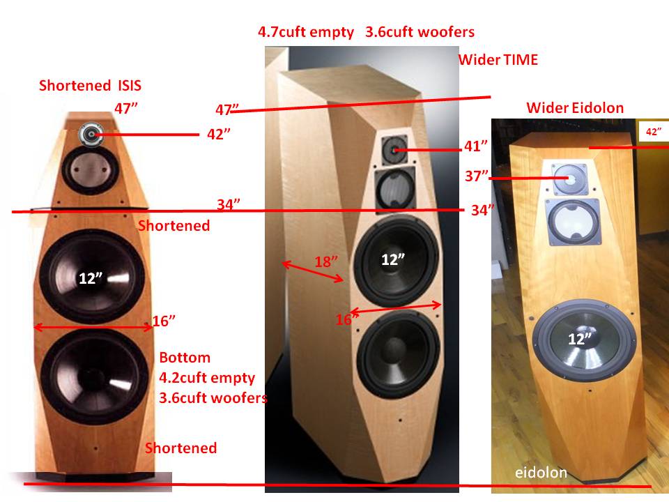

Since the TD12S uses ~1.8cuft for a sealed Qtc=0.7, it is possible to construct a "reasonable size" home speaker with two separate sealed 1.8cuft volumes. For optimal C-to-C TD6M-TD12S coherence, the top TD12S should be midbass, and you can experiment with a lower crossover frequency for the bottom TD12S to provide baffle+room equalized deep bass. Maybe just one inductor? Maybe you will get the best sound with just one TD12S. MUCH TO LEARN.
If you construct the 2-box (TM-WW) Avalon ISIS, consider a shorter cabinet with the tweeter at ~40-41" ear height. The single box Avalon TIME cabinet puts the tweeter ~38" ear height.

42" Ear Level
Early loudspeaker textbooks suggested locating the center of the tweeter at 1.2meters ~47" high as the best compromise for critical listening for a chair seated male, and casual listening for a standing male.
The dominance of home theater with a family seated on a couch now typically favors closer to 1meter ~39" -42".
Many tweeters are designed to maintain a flat polar response at ±15°, so the prime sound would be within ±15° of the tweeter height. At a typical listening distance of 10 feet, the 15° arc is 24 inches, so, at 10 feet the cone of good sound has expanded to a full 48 inches (±24"). Optimal at 42" ear level, and still very good from 18" to 66" at 10' listening distance.
The Avalon TIME cabinet best matches your artistic and audio goals. Just adjust size for two separate 12" sealed(1.8cuft) volumes.
A short-and-stubby Avalon ISIS style cabinet would allow swap-a-top flexibility, plus flexible DSP tuning from matched separate sealed 12" boxes. You could swap-a-top if you find a used pair of RAAL 70-20 ribbons. ISIS COST: More complex construction plus a deeper cabinet than single volume box TIME.
