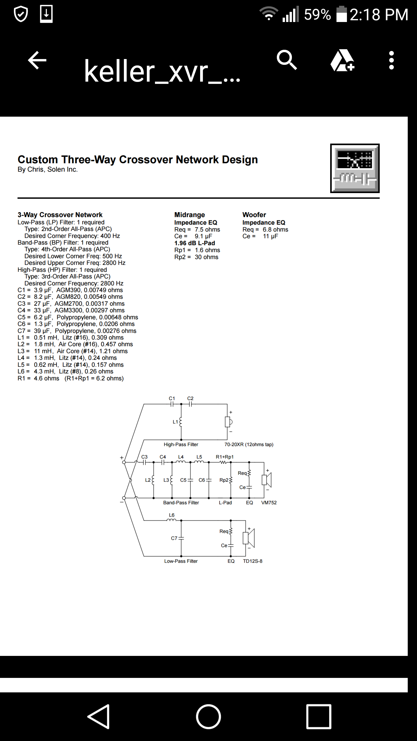

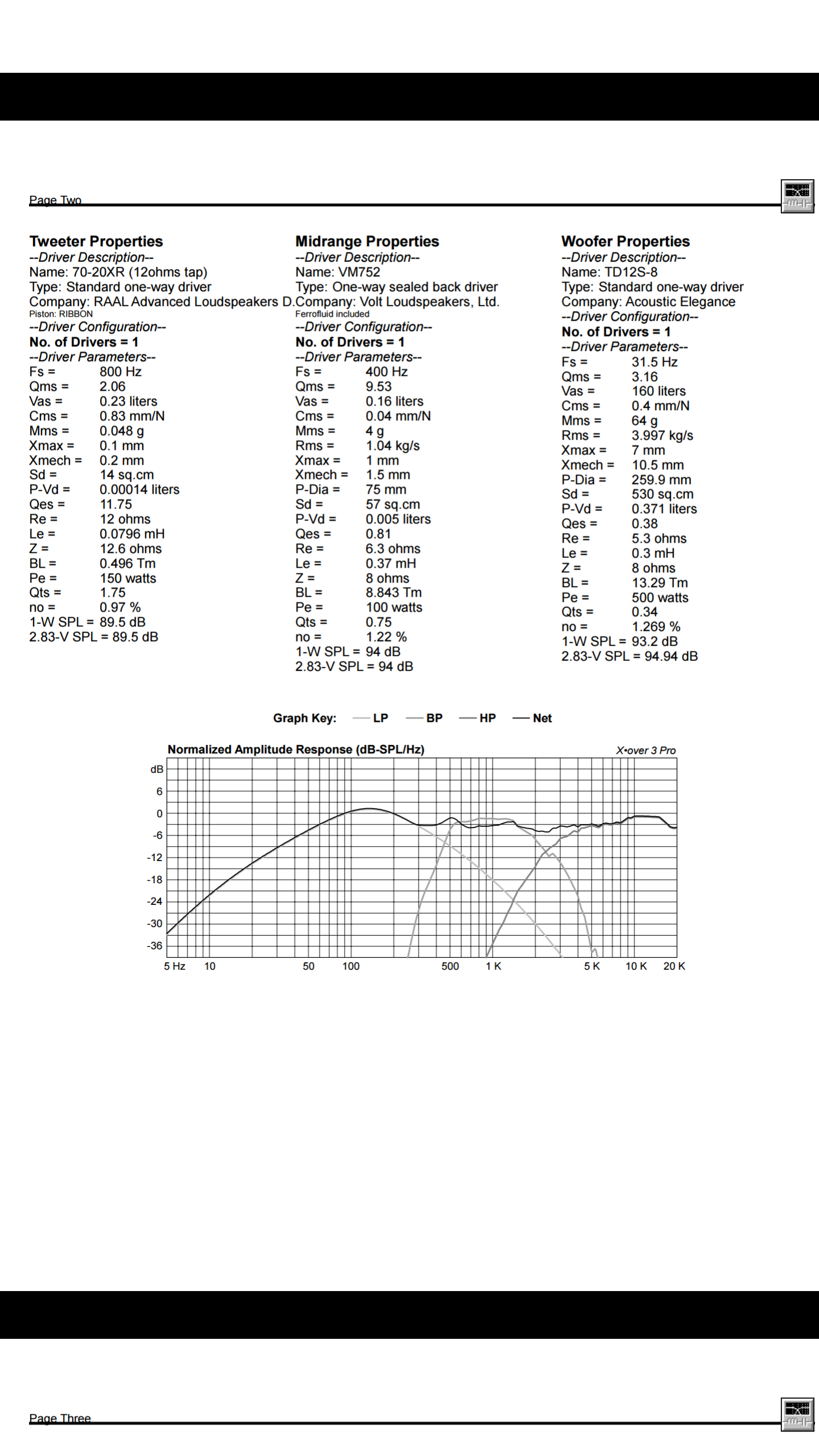

Here are the graphs on the VM750 in a 3-way please chime in.
As I said, I'd drop the entire crossover on the woofer, and do the mid as a simple lowpass. Do the woofer lowpass and the mid highpass in the Minidsp. This'll give you a lift in sound quality, an increase in efficiency as well as more flexibility. You can then fix the peak at 500 as well as other smaller eq like the peak from 10-14k in the treble.

Yes, I am planning on dying something like you suggested. The graphs is just to let you see the potential of the Volt VM752 and get you opinions as to weather it's worthy and a good match for the 3-way design. So to recap we would be pushing the VM752 down to around 375-500Hz and running the TD12S up to about 375-500Hz. Do you guys think that these two drive units are really the best candidates for this task. I can do wonders with the minidsp 4X10HD to find the x-over points that sound best to me, then design the appropriate x-over. First we have to use the best drive unit and this is what i'm asking help with. We looked at the ATC 3" mid and the Volt works better in this set-up. So if you know of another Mid that will compete or do a better job than the Volt 3" dome. State your ideas. Remember this is not a studio monitor design for studio use, this is get on it and jam monster that will sound great weather the volume is low or at concert levels.Thanks
The Volt has a reccomended frequency range of 500-4000Hz. I don't know that I'd go much below this. While it has good headroom for a home installation, and the MiniDSP can move the cutoff downwards, I believe you'll quickly run into rising THD.
The Volt 3" dome is a very capable driver, so it'll do the job.

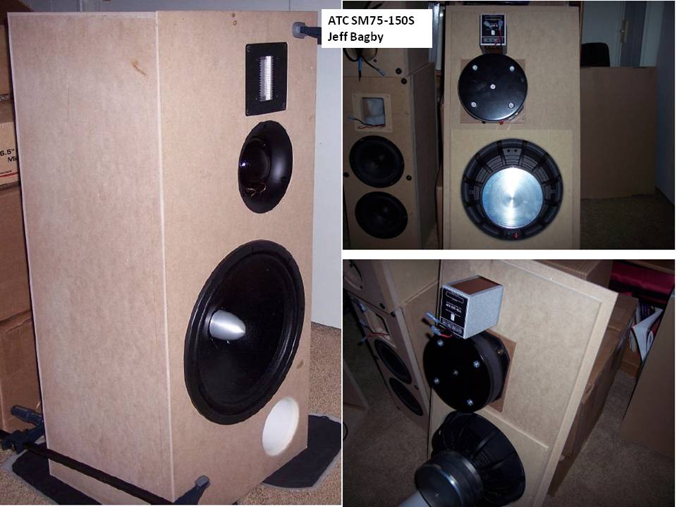

Worth a read..TD12H + ATC 150S + RAAL 70x40
The ATC SM75-150S Midrange Driver Review by Jeff Bagby
http://studio-hifi.com/images/ATC75-150S_JeffBagby.pdf
"Crossover of approximately 400 Hz between the TD12H and the SM75-150S, and an acoustic crossover of 3 kHz between the SM75-150S and the RAAL Ribbon."
