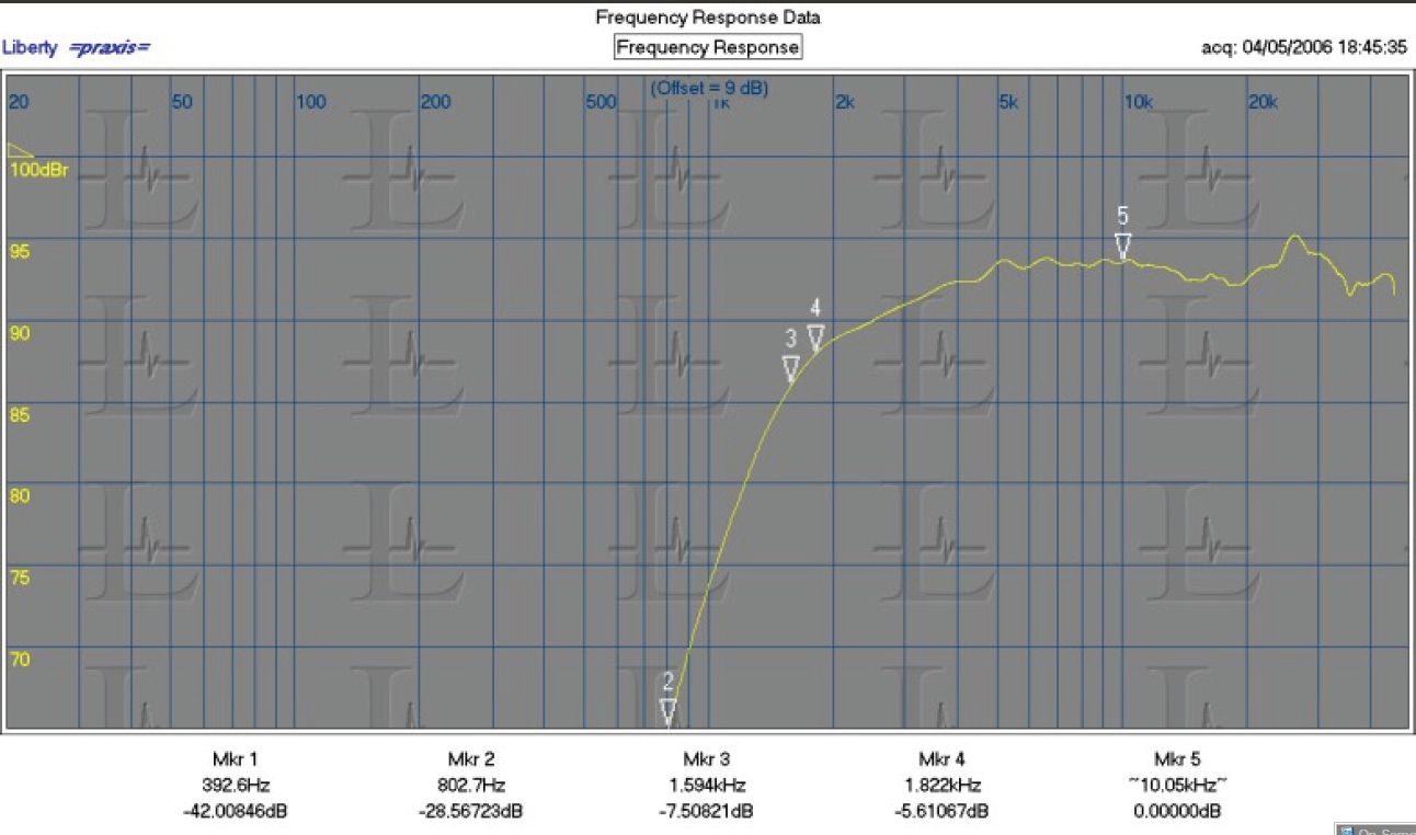

The Transducer Lab N28BER-G Pure Beryllium dome tweeters get excellent reviews. Meniscus sells them for $536/pair, so breaking the budget is probably your only risk. I have not heard the N28BER tweeters.
The "G" version uses a fiberglass voice coil former, Transducer Labs engineers say this allows the response to rise slightly more in the top octave, about 1.2 db. Transducer Labs says the "G" model has a more lively top end and is a bit more dynamic as eddy currents are at a minimal in the magnet gap due to the fiberglass voice coil former. This "G" version is also recommended for waveguides to partially compensate for the normally falling highs.
The "A" version has an aluminum voice coil former. Transducer Labs engineers say the "A" type is smoother sounding as there is some electrical dampening. The Aluminum former has good voice coil heat transfer, and the engineers favor it for high power applications. eBay has a pair of "A" version for $400.

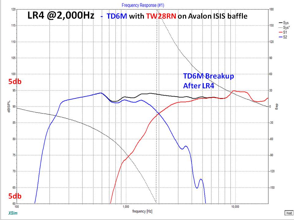

Both versions can cover the 2.5kHz crossover suggested for the TD6M with simple filter ckts...a higher crossover freq starts to bring out the TD6M cone break-up. A 2kHz LR4 crossover, which the N28BER can manage with a careful filter design, helps further push down cone breakup.

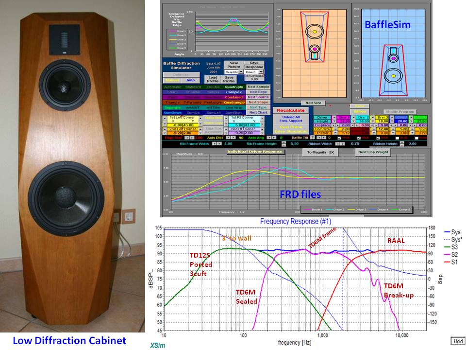

1) FINALIZE CABINET DESIGN using CAD + SIMULATION:
---Decision on the final shape and size required for internal drivers + bracing volumes.
---Run a few baffle simulations to understand diffraction plus baffle step plus TM-lobbing, plus polar pattern.
--------miniDSP cannot correct cone break-up, baffle diffraction, lobbing, irregular polar pattern dispersion
--------the simulation's FRD correction values describe the equalization complexity, and the required amp gain.
---CAD sketches with dimensions, cut-angles. External plus internal bracing.
2) You own a pair of Audax TW025A20 dome tweeters and DSP stuff....so...USE YOUR TW025A20 IN YOUR FIRST BUILD, but plan the TM baffle to accept all three discussed domes flanges. Paper ring spacers and plastic putty can create a smooth baffle.

Datasheet suggests Xover ~2.2kHz which the TD6M can manage with LR4.

I am building Midrange enclosures for the TD6m so we can run test on them to see if they will work for my DIY speakers which must be able reproduce the breath taking dynamics of R&B, Blues, Rock, & some Hip Hop with the emotion of being live and also have the finessee to be stunning on Jazz. I'm thinking the the Satori TW29RN and later the BN when it's available should match up well; but I just can't get the Raal 70-20XR out of my mind. So we'll see what the test reveals and go from there. If the TD6m is too reveiling and better suited as a studio monitor I will post them up for sale here. Now for those of you who own Acoustic Elegance speakers what tweeter do you use and what music do you listen to and how do like the Acoustic Elegance based speakers you built. Thanks
DJ Sugafree: Do you have any design sketches of the cabinets? Show us them BEFORE you take it to the CNC shop!
